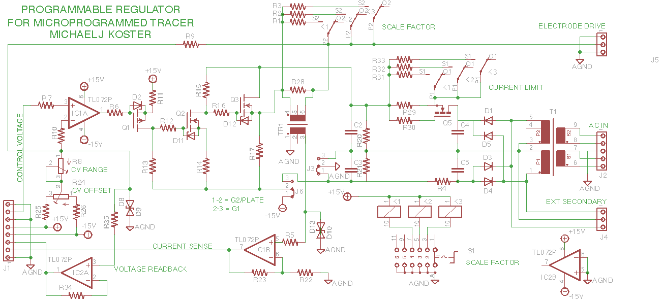

I think there are 2 distinct issues here; one is the possibility of the computer interface being energized through some colossal failure inside the tracer. The other is how to do current measurement safely.
Implementing isolated high side current measurement seems nice, but doesn't completely eliminate the HV risk.
Twisted pair Ethernet is balanced and transformer isolated.
Here is an iteration of the regulator using transformer isolation of the current measurement, plus current limiting and voltage readback. I think there is still an issue of C2 and C3 needing to be scaled for the measurement current.

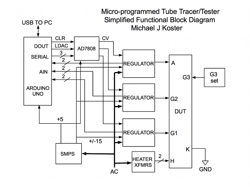

Here's the simplified block diagram.
All electrodes will be energized together using the LDAC signal. The CLR signal can be used to de-energize (restore to baseline voltages). The G2 and Anode regulators have a baseline voltage of zero and the G1 regulator has a range of -200 to +100 on the high range, and -20 to +10 on the low range. The raw supplies will be +/- 200V for G1 and +300 or +600 for G2 and Anode depending on the rectifier configuration.
Hysteresis and small signal gain can be tested using small steps as a separate measurement.
It sounds like you are considering measuring Gm or Mu under user specified conditions. Nice.
It would be trivial to hold constant plate voltage and change the grid voltage in small steps for a direct gm measurement. Likewise the plate voltage can be adjusted to maintain current for a mu measurement. Holding grid voltage constant and varying plate voltage in small steps gives a direct Rp measurement.
