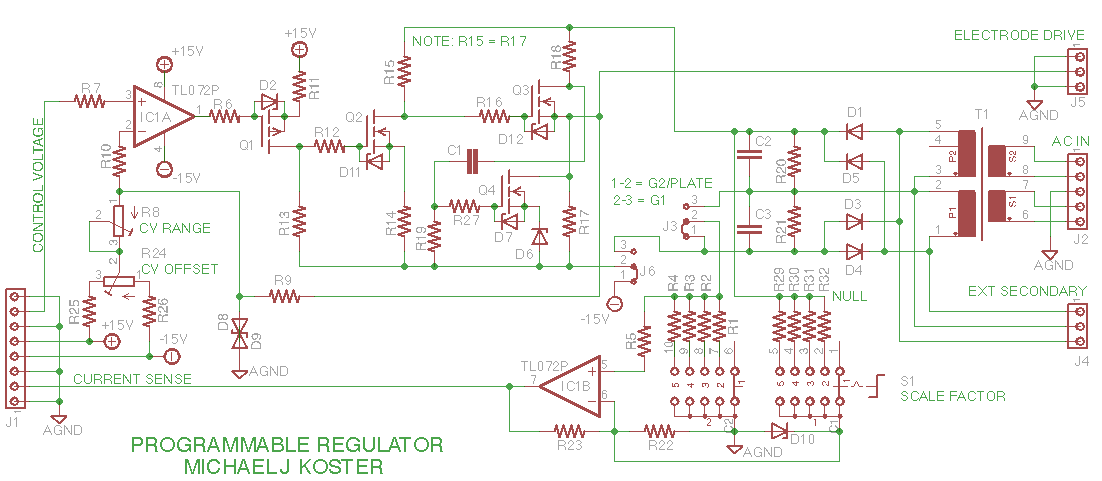

What I want to do is build a fully programmable tube tracer/tester using the Arduino microcontroller to control the measurement steps.
The design is very simple, consisting of the Arduino with an external 10 bit D/A converter, driving three programmable pass regulators (Vg1, Vg2, Vplate). The Arduino has enough onboard 10 bit A/D channels to measure all the electrode currents.
At each measurement point all three regulators would be pulsed on only long enough to settle and measure, then returned to a baseline state. The baseline state could produce some known idle dissipation if needed. The dissipation during measurement can be limited by limiting the duty cycle.
Producing a set of plate curves would involve running enough measurement points in any order such as to connect the dots and draw curves.
The electrode power supplies would each be isolated with shunt current measurement on the ground side. Safe, easy, cheap. All one needs is 3 separate secondary windings e.g. Antek toroids, etc. and relatively small ones at that (50-100VA should be sufficient due to the short duration of the measurement pulses).
The status of this project is I have the necessary parts and Arduino testbed, I have obtained an A/D converter (AD7808), and am currently prototyping the programmable pass regulator design. I plan to build one PCB for the Arduino D/A shield, and another PCB for the programmable pass regulator (3 regulators needed for each tracer). The regulator board will carry the rectifier, filter/storage caps, and current sensing with protection circuits.
The other part is some manual range selection so one can test power tubes and small signal tubes using the 10 bit A/D, e.g. electrode current ranges of 1mA, 10mA, 100mA, 1A. Grid voltage range 20V, 200V. Manual g3 bias setting would probably be sufficient but another regulator could be added.
I'm also intrigued at the idea of physical tube modeling, where Spice would provide inputs to the tracer, the tracer would make measurements, and provide the results back to Spice to use in the circuit model.
The arduino provides USB, serial, and IP interfaces, but it seems like USB would be a good method.
This project would be fully open hardware and software, allowing anyone to build it for any purpose including commercial products.

Good points. I do have a block diagram and know that the Uno has enough I/O. Today I'm documenting some of this in electronic form so I can post it.
Internal resources depend on how complex the internal logic needs to be, but my experience so far is encouraging for the Uno being able to run at least plate curves autonomously from start-stop-step parameters while pushing the data out the USB. Current idea is to make a measurement, then spit out the data before making the next measurement, which provides a cooling off period between measurements. A storage card could be added to store data sets etc. but I see most of the heavy lifting being done by an attached PC running python scripts. I wouldn't want to program heavy analysis using the pidgin C of the arduino SDK. It's mainly for sequencing and interfacing.
I looked at both serial and parallel and for Arduino it's really about a wash as there's no instruction to load a word to a port but good support shifting data bits out a serial line...
The AD7808 D/A has a global load so I can preload the data registers and then pulse the load signal to change all outputs together. On the measurement side, I don't think a few A/D conversion cycles will be a problem but I will let you know the timing when I have made a measurement later on. I still need to hook up the 7808 to the Arduino.
I should point out that one big goal is to keep it simple. At first all I care about is generating plate curves by importing CSV data into MS Excel. Manual range switching. Minimal programming. It's super easy just to download different arduino code sets for different tester/tracer functions. This can get way more sophisticated as time goes on and if others get interested in making improvements, commercializing, etc.

With this setup I can servo, in software a constant current or a constant voltage on one pin while the other pin is swept.
If serial DACs/ADC is used I'd look a the "mega" rather than the "Uno" version of Arduino because the Mega has hardware UARTs and you avoid "bit banging".
A big part of the design is the opto-couplers. I CERTAINLY want optos between the high voltage and the Arduino. It takes some effort to pass a linear analog signal through an opto. However serial data like I2C can work easy with an opto. I have yet to work out a parts count and cost for each method.
The other part of design is the user interface. I'm thinking of using a 2x16 character LCD and a rotary encoder, the kind with a push button on the shaft.

I've thought a lot of this through and concluded that using return side current measurement makes isolation not an issue IMO.
The beauty of this approach is that the horsepower of the engine is scalable from Uno level up to the Maple and other 32 bit variants. As I mentioned, I think most of the heavy lifting in SW belongs on a PC, but it could easily be done the other way.
Also I don't think Arduino has a built in D/A at all; there are some PWM channels. I plan to add a $20 8 channel 10 bit D/A that allows synchronous control of all outputs simultaneously. It hooks up to the Arduino using 3 signals.
I think that the regulator is also not so difficult to implement with a control voltage in and current measurement out. Attached is a basic design I'm using as a starting point. It can be configured for either bipolar operation for control grid, or unipolar operation up to 600V for plate or g2. I do think the range selection is needed to accommodate different power tubes and draw smooth curves with 10 bit A/D resolution. I need to measure plate current from 1mA to almost 1A to cover the full range of tubes.

One thing I'd add is "voltage measurement out". Yes you know the control voltage you send using your serial DAC but knowing the volts dropped would not be exact. It depends in the setting of the pots that control the feedback to the op amp. It would be easy to place a voltage diver (10:1) across the output and send it to an ADC.
I agree about a range selection. A relay and a multi-tapped power transformer would be ideal. My plan however is to use an existing bench B+ power supply and with the above "voltage measurement out" I would measure the incoming voltage from the bench supply.
If you publish this for others to build, everyone will use a different power transformer and you'd like the software to auto-scale.

Great comments, ChrisA. I'm not building a Pinto😱
I am planning for current limiting the power supply such that a short will not blow anything up. Pulse measurement allows me to limit the continuous current to the tens of mA range in the event the SW tries to continuously apply voltage to an electrode. Switching the range could also switch the current limit.
With proper current limiting and zener clamps there should be no problem with shorted tubes causing damage or safety issues. It should be pretty hard to even blow up a tube.
Readback of the electrode voltage would be useful to diagnose shorts or miswires. The additional A/D channels are available and it would only need another opamp for scaling the measurement.
I'm planning a single voltage range scaled by the feedback resistors for plate and g2, and 2 voltage ranges for the g1. Note that the g1 voltage scaling isn't shown on the regulator circuit yet. Someone building this would be able to scale things to their own needs.
Heaters will be powered by dedicated transformers which allows for isolation and a safe return path in the event of shorts or miswires to heater pins. The cathode will be grounded through a small value resistor for current measurement.
Additionally, with this design a low voltage can be applied to test for shorts before blasting the tube with 600V.

Can someone show me a rough sketch of how one of these isolator components being proposed would actually be used (for example) in a plate current measurement circuit?
It occurs to me that using the pulse measurement technique would enable a simple transformer to be used as long as the measurement interval is short enough to keep the core from saturating (!)
Michael
The Application Note from Vishay appears to be updated from the version which I have -- see figures 8 and 10.
http://www.vishay.com/docs/83708/appn50.pdf
The material is equally applicable to the HCNR200 -- there's a spice model for this part on the Avago datasheet (Avago Technologies Semiconductors Analog, Mixed-signal and Optoelectronic Components and Subsystems) -- used to be Hewlett Packard's semi biz.
Wouldn't it be a lot simpler to just put one opto set in the serial USB link?
I guess there was (is?) some backward compatibility issue with analog impedance on the USB line, but can't that be dispensed with now?
