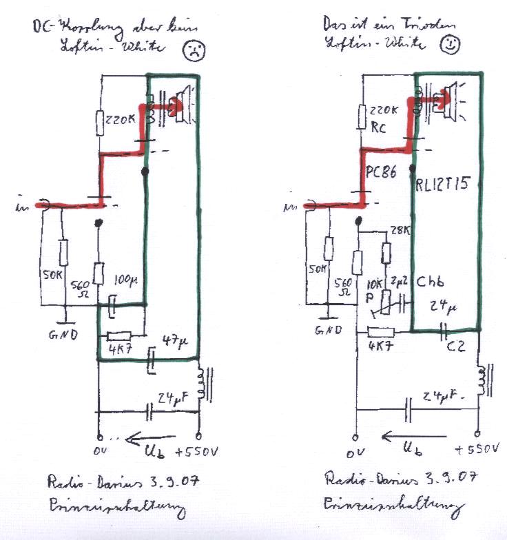

A bit pedantic, perhaps. These are direct coupled amplifiers, but not really "Loftin/White".
The original here: Loftin White: September 2007
It was based on a pentode input tube.
There's a simple schematic of a triode version, halfway down the page.
Note the connection from the top of the output cathode resistor, to the top of the Unbypassed input cathode resistor. That's the crucial difference, and it cancels power supply noise. I've built a 6SN7/801 version of this. It's quiet as a grave and uses only film caps throughout because it doesn't require a lot of PS filtering. Took me a while to get my head wrapped around the concept.
Back in their day, caps were large and expensive - relative to their capacitance. Note that the original version uses only a half-wave rectifier.
Sheldon
The one on the right embodies the LW principles. The green line represents the output AC current loop.

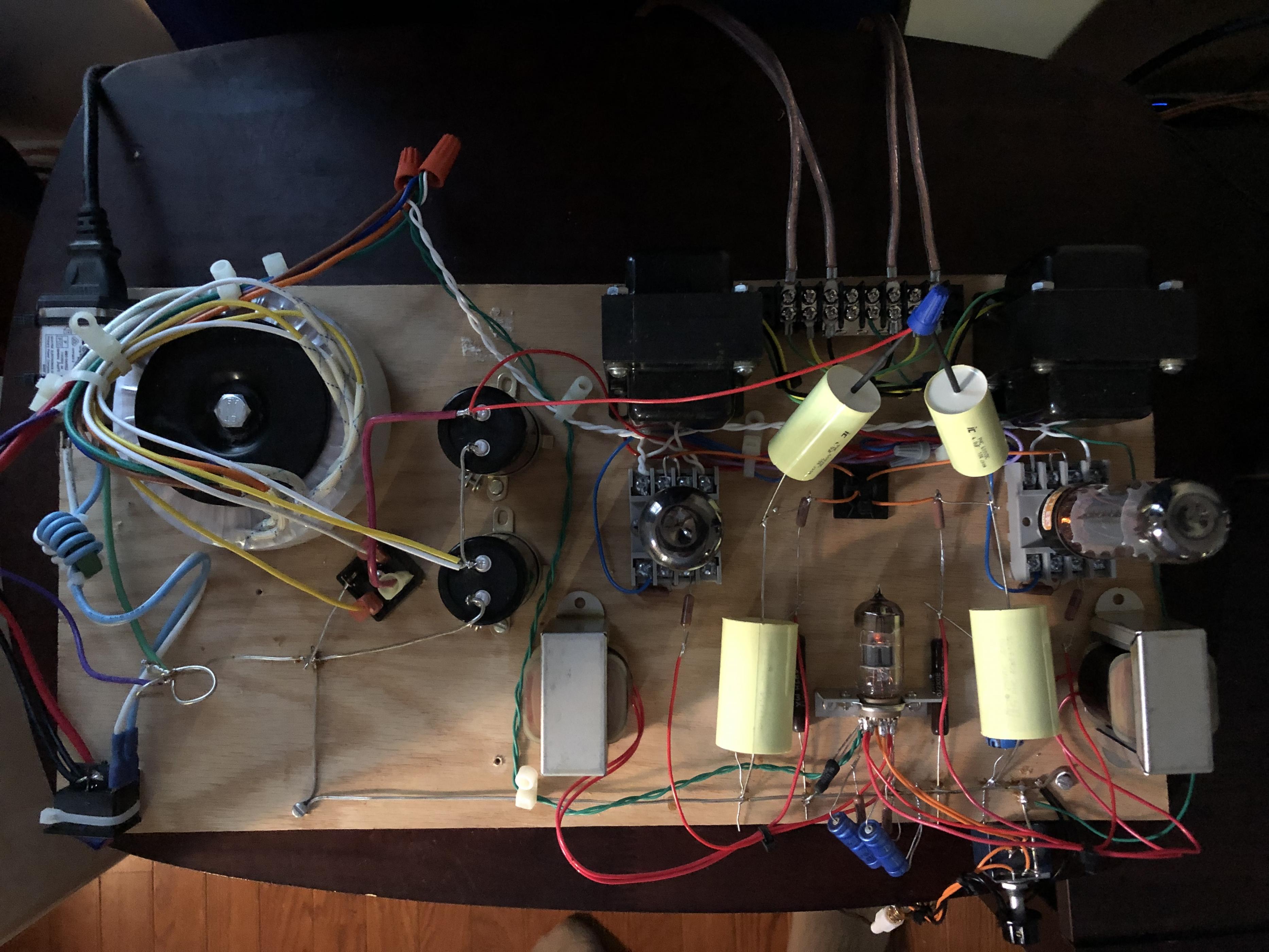

So I noticed a hum pretty quickly and just had time to troubleshoot it today. At first I thought it was heater realated (I’d forgotten to provide a ground reference) but it turns out to be power supply noise. There’s about 10mV of ripple at the speaker terminals. To mitigate it I’ll add a noise cancelling cap from b+ to cathode but I’ll need to wait for a parts shipment to do it. Beyond that I tweaked the values a bit so I have 90% dissipation with 375v across the power tubes. Output power seems to be about 7W peak. I also tried bypassing the e88cc cathodes but I didn’t hear a difference so then I added 6db of cathode feedback. The sound cleaned up quite a bit but I think I like the more “live” character of leaving it out. I’ll probably build a switch for it.
Next update: I swapped the 100uF cathode bypass caps for 40uF film and added 4uF caps on each channel from B+ to the cathode for noise cancelling. The cancellation is quite effective though I can still hear the hum if I get very close to the driver, overall I consider it successfull. I used a film for the large value because the tolerances are tighter. I probably should have gone with a 50 and a 4.7uF the better match the mu of 10.5 but started getting spooked over the size/price.
I think the prototype is done and I now need to turn my attention to a proper enclosure.
Just a guess on my part, but I think you'll find the hum will decrease once you re-build the amp on the final chassis and shorten up the wiring.

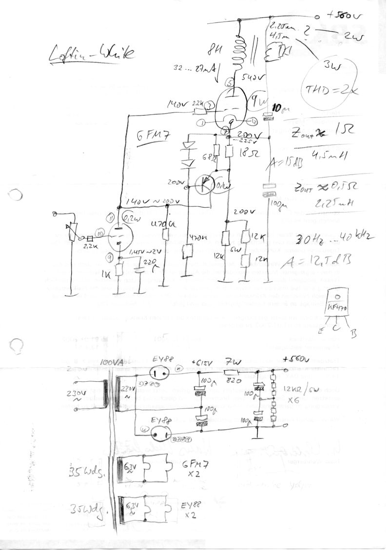

I actually prototyped the TubeCad LW Auto Bias idea, low power version though.
Tubes are just *one* compactron 6FM7 dissimilar triodes per channel. That's a veritable SPUD.
And - yak - a pnp transistor instead of expensive 300H+ choke.
DC bias stabilisation comes in for free.
Zout is 0.5 ohm but only 2W max.
Z out is 1 ohm with half the impedance ratio in the OPT at 3W but THD doubles.
