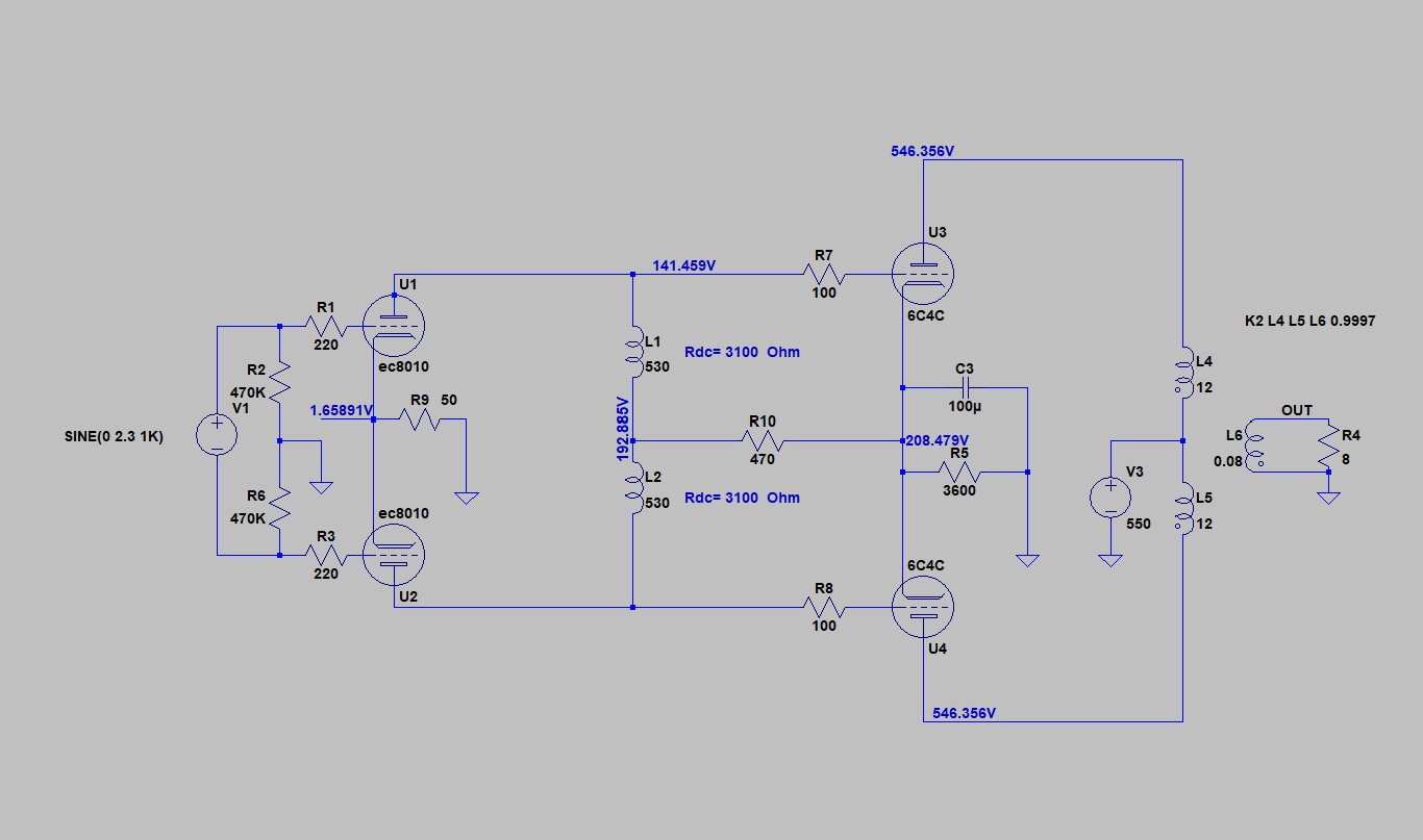

A bit pedantic, perhaps. These are direct coupled amplifiers, but not really "Loftin/White".
The original here: Loftin White: September 2007
It was based on a pentode input tube.
There's a simple schematic of a triode version, halfway down the page.
Note the connection from the top of the output cathode resistor, to the top of the Unbypassed input cathode resistor. That's the crucial difference, and it cancels power supply noise. I've built a 6SN7/801 version of this. It's quiet as a grave and uses only film caps throughout because it doesn't require a lot of PS filtering. Took me a while to get my head wrapped around the concept.
The one on the right embodies the LW principles. The green line represents the output AC current loop.

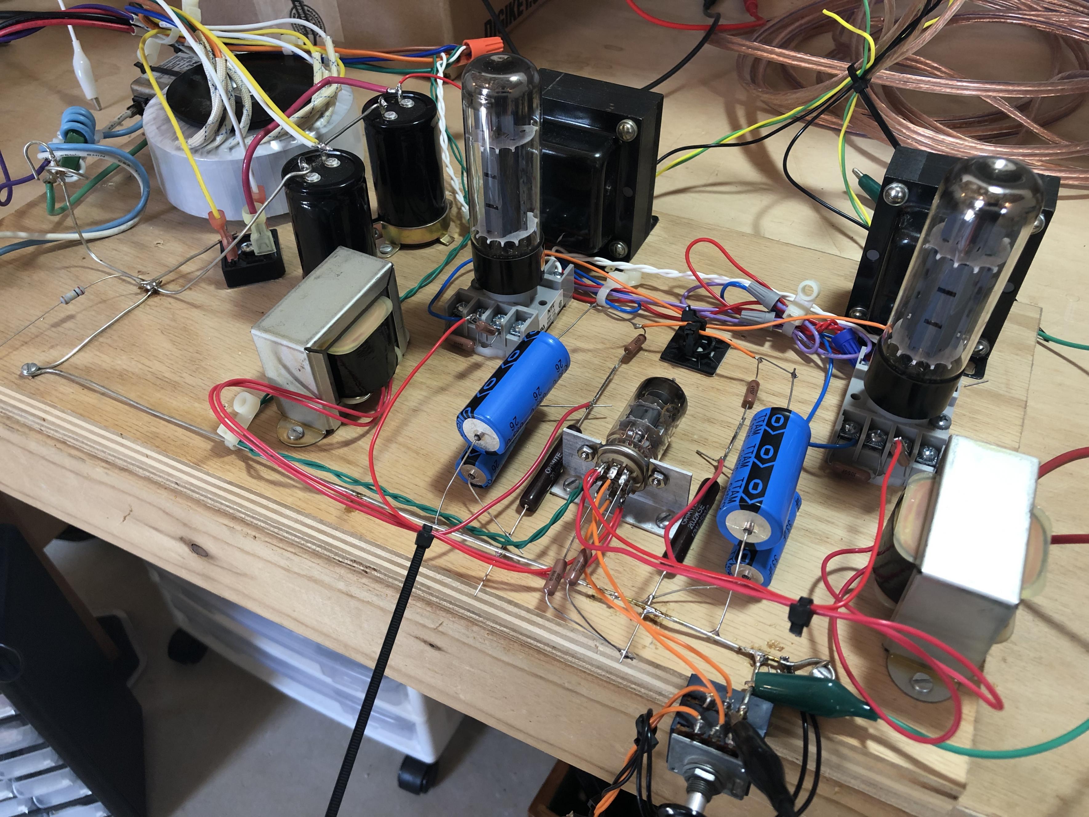

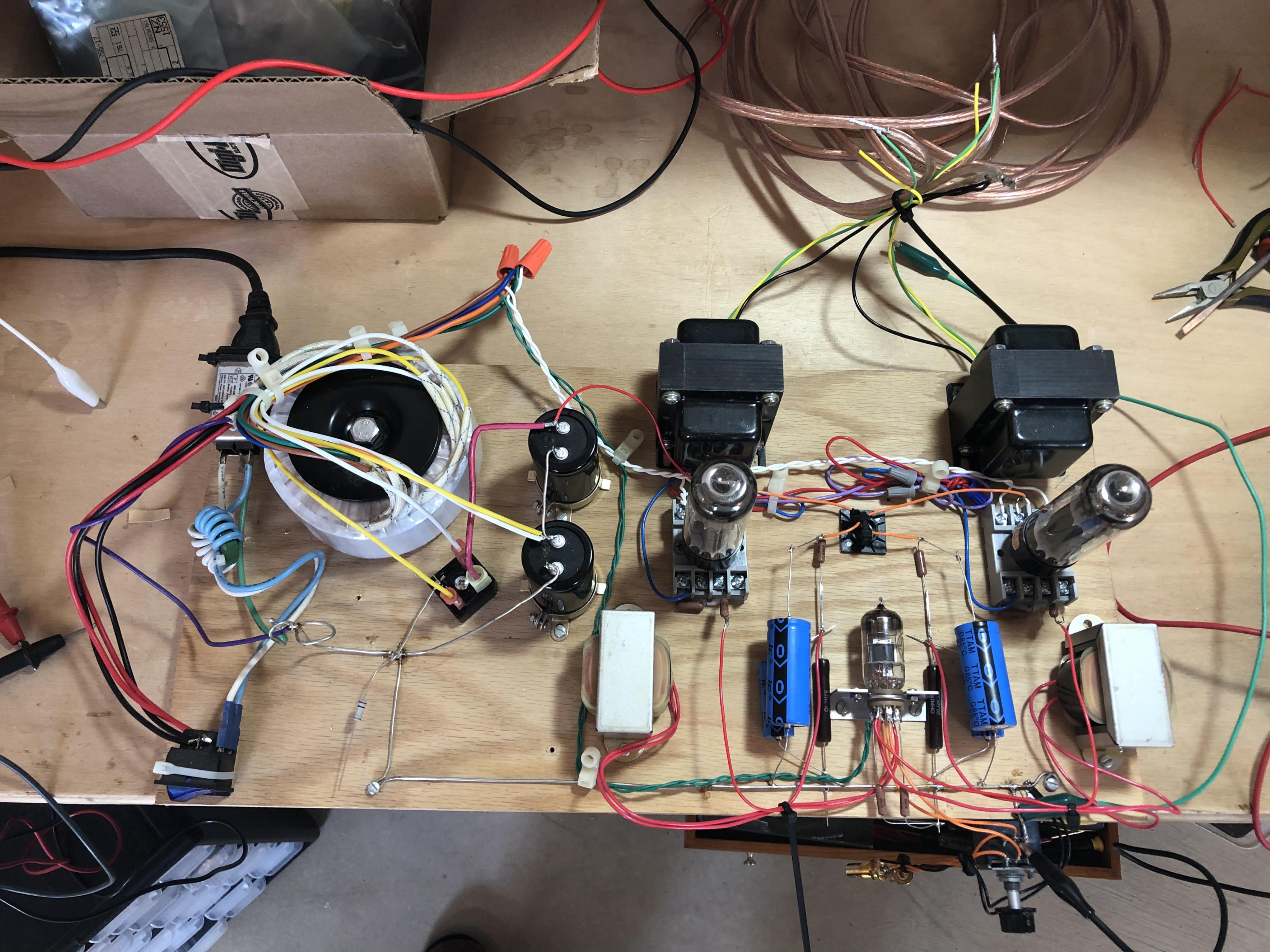

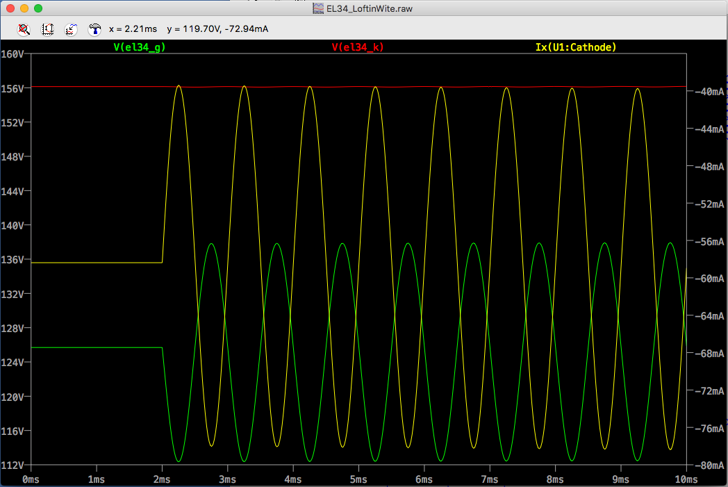

So I noticed a hum pretty quickly and just had time to troubleshoot it today. At first I thought it was heater realated (I’d forgotten to provide a ground reference) but it turns out to be power supply noise. There’s about 10mV of ripple at the speaker terminals. To mitigate it I’ll add a noise cancelling cap from b+ to cathode but I’ll need to wait for a parts shipment to do it. Beyond that I tweaked the values a bit so I have 90% dissipation with 375v across the power tubes. Output power seems to be about 7W peak. I also tried bypassing the e88cc cathodes but I didn’t hear a difference so then I added 6db of cathode feedback. The sound cleaned up quite a bit but I think I like the more “live” character of leaving it out. I’ll probably build a switch for it.
Next update: I swapped the 100uF cathode bypass caps for 40uF film and added 4uF caps on each channel from B+ to the cathode for noise cancelling. The cancellation is quite effective though I can still hear the hum if I get very close to the driver, overall I consider it successfull. I used a film for the large value because the tolerances are tighter. I probably should have gone with a 50 and a 4.7uF the better match the mu of 10.5 but started getting spooked over the size/price.
I think the prototype is done and I now need to turn my attention to a proper enclosure.
Just a guess on my part, but I think you'll find the hum will decrease once you re-build the amp on the final chassis and shorten up the wiring.

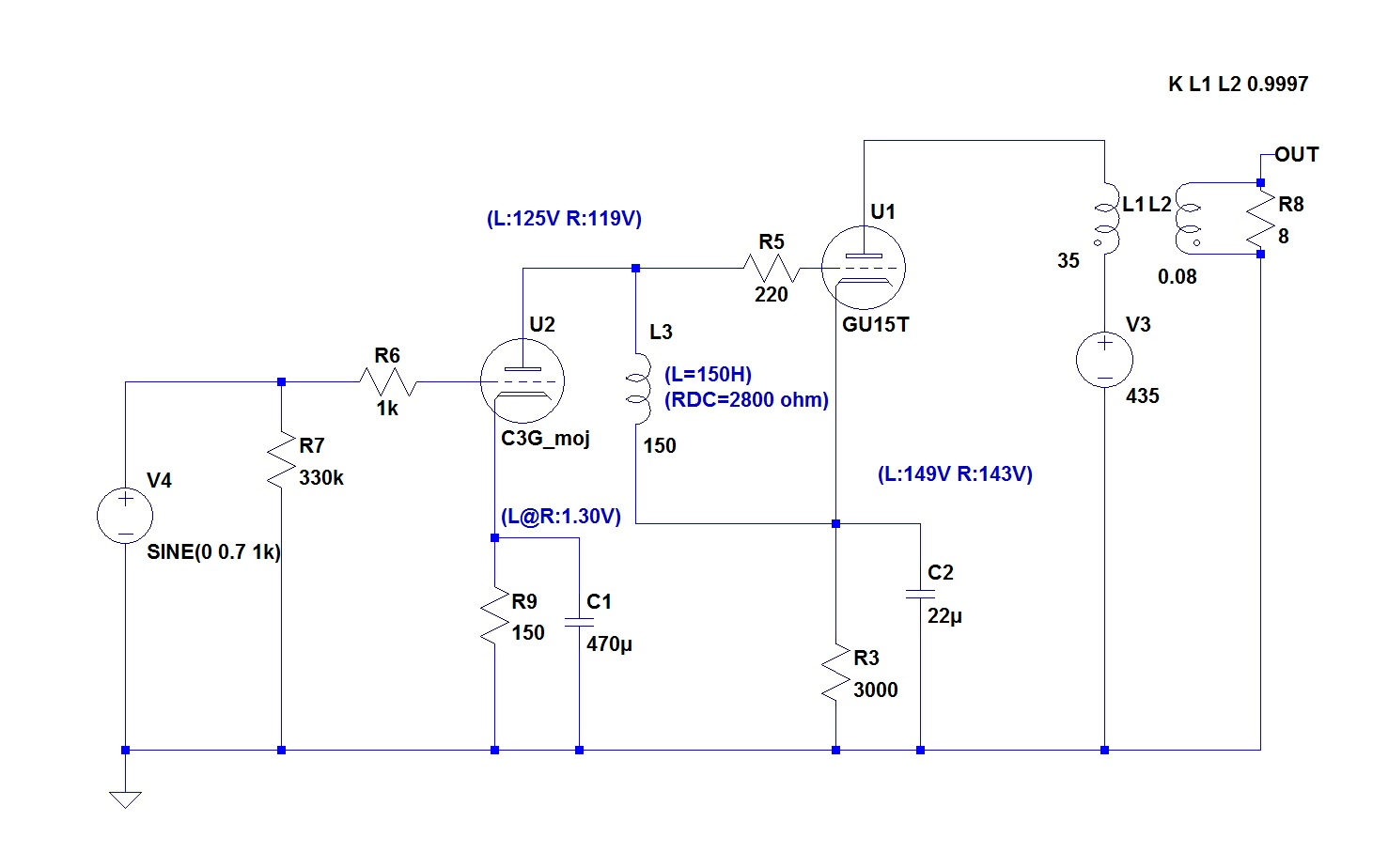

I actually prototyped the TubeCad LW Auto Bias idea, low power version though.
Tubes are just *one* compactron 6FM7 dissimilar triodes per channel. That's a veritable SPUD.
And - yak - a pnp transistor instead of expensive 300H+ choke.
DC bias stabilisation comes in for free.
Zout is 0.5 ohm but only 2W max.
Z out is 1 ohm with half the impedance ratio in the OPT at 3W but THD doubles.

I ended up with 80H choke from transcendar. With the low rp of the E88CC driver stage the -3db point was low enough for a tiny amp. If you are using a 12AX7 you need 250-300H. It also helps to bypass the drive stage cathode.

As an additional thought I have wondered if the transition into clipping would sound different between the ccs loaded driver and the inductor loaded version. I’d imaging the ccs would hard clip a little below the power tube’s cathode voltage; the inductor would try to swing above the cathode but be clamped by the power tube grids.
Sorento - do you know how many volts your ccs drops when properly set up? I bought the parts for a ccs version but didn’t attempt it yet.
There's 60 volts across the transistor at idle. Properly setup ... hmm ... don't know.
And yes, clipping of the CCS is hard.
In my case the feeble "power" triode is cut off long before the CCS, so the other half of a sine wave gets clipped first anyway ...
Ah, I’m being silly. Of course the drop across the ccs at idle is the bias voltage. 🙁
What I meant was what at what voltage it clips. How far below the cathode voltage does it saturate?

with a simple BJT ? 1.2 volts below the cathode. At least that is when the current through the transistor starts to wiggle ...
