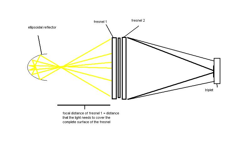

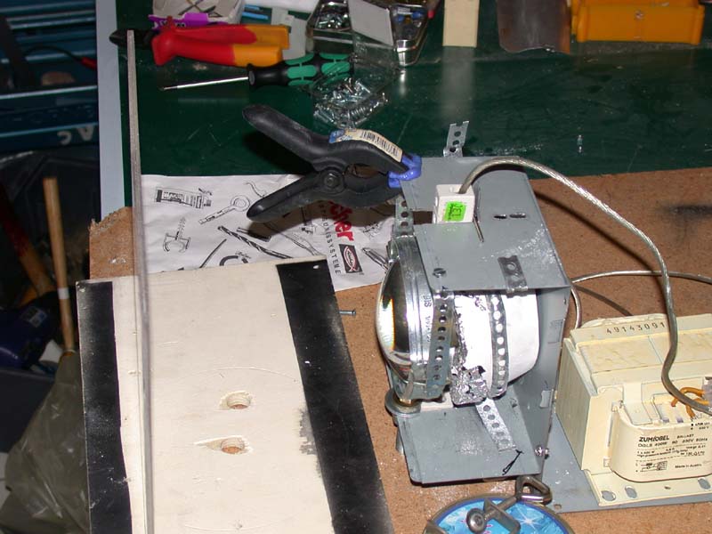

How does your projects go? I didn't have a lot of time, working on experimental reflectors, taking apart triplets and solve heat problems.. But, these are the experiences I get from the alluminium reflector:
- the focal lenghth of the first triplet has to be large. As we want to keep the reflector small (diameter 100mm), the angle of the light conus isn't wide. --> If you don't place the reflector too close to the first fresnel (a I did), it is possible to capture allmost all the light coming from the reflector/lamp in the triplet with a diameter of +/- 100mm. --> attached image
Unfortunately, I don't have such a huge triplet (it's a normal one, taken from a normal ohp) neither a long distance fresnel (that's why I had to put the reflector so close to the fresnel: It had an extremely short focal distance)
Now I'm trying something, found on a german forum: a goliath reflector (or goli), it's spherical. But, you lose a lot of light.. When I get new fresnels with normal (read longer) focal distance, I'll try to work with the ellipsoid reflector again.
About the reflector on the spanish forum, he made it in resin, I tried it too, but it melts by the heat.. 🙁 But maybe, the guy has a wonder-resin that can stand the heat.
There is some objection against the idea: the lcd diffuses slightly the light (that's why the second fresnel has to be placed nearby the lcd) So, will it focus all the light in the triplet? Or will it be diffused too much.. ? (I don't know, this was be written on the forum, don't remember if it was the spanish one)

hu? I don't understand very good what you are saying? Is this trough a translator? If you speak spanish, you put the original spanish version too? Gracias! 🙂
You did a good job then! Also made in fiberglass and resin? If you have some pictures, please post them!
