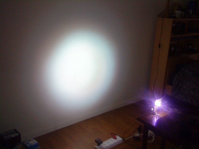

Here a picture of the result, obtained with the strong condenserlens setup. (it's not exactly the same, but it gives an impression)
When the ir/uv filter is here, I would like to test the three light setups (1. the wrinkled ellipsoidal 🙂 2. the "strong condenser" setup 3. the sperical setup), using three times the same (halogen) lamp, that can be replaced by a uhp or CDM-t powerball for the 'real' setup. It should be interesting to use different fresnels. Btw, the diameter of the lcd = 7".

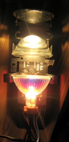

I tried something similar, I used a normal precon with focal length 90mm, diameter 72mm and an aspheric lens that came out of a LitePro 550 (no idea of the specs, diam about 65mm)
Unfortunately I did not get an even spread of light so I don't think my aspheric lens is correct lens to use here

I did not win original slide projector (it was hijacked from my bid, 5 minutes before ending time!) but I am getting another one which should arrive sometime this week, so I'll take it apart only then
I also ordered the following for about 35 USD incl shipping
http://www.surplusshed.com/pages/item/m2407.html
I'll see if I can use the mirror and lens in my assembly.

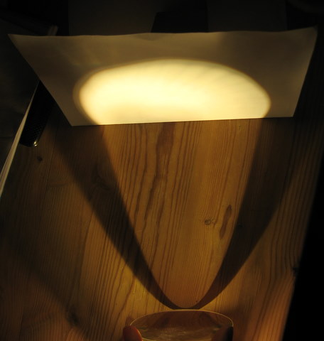

spherical vs. elliptical
I tried the two setups, with same fresnels and triplet-lens.
note: the elliptical setup is not so very sofisticated: aluminium foil coated shape of a half ellipsoid, in cement.
The not scientific but real results:
1. elliptical= brighter (can't tell in lux or lumen)
2. elliptical= more heat, difficult to handle, but there is a plan.
3. elliptical gives a "bigger" spot at the focal point of the second fresnel. The triplet (diameter: 6 cm) couldn't "take" all the light.
<-->With a spherical setup, the lightspot in the focal point of the second fresnel is much more concentrated, but:
the light output of the elliptical reflector is still higher, even when the triplet can't "take" all the light.
(a bigger triplet with a +/- 10cm diameter would be great.. But I don't know where to find those not-so-very-cheap lenses)
I'll try to handle the heat with a mirror-heatsink system. I don't know if it will work, we will see!

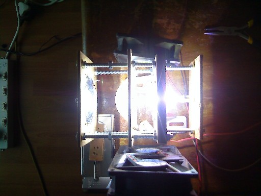

If you adjust the position of the lamp a little bit out of focus, the lightbeam widens a bit and the complete fresnel is lightened up evenly.
But the mirror-heatsink idea isn't that easy, it seems that I lose a lot af light. I don't know why.. The reflector seems te be really close to the fresnel, that is, in fact, very good. But the heat is too much and a IR/UV filter isn't 'strong' enough..
With the mirror, the distance between the reflector and the fresnel is increases..
And I just broke my lamp 🙁 , it was 'just' a 150W HQI-TS test lamp, but now I have to work again with the 35W hqi-t and the results of that lamp are not very "wow, what a light engine!"
I'll post some pics if the mirror-heatsink thing should work

got the 8mm slide projector in today, but there's practically no useful lenses or anything of use inside it. Just uses a fan for cooling and a "triplet" type zoom lens for projection. That's it. (sucks)
Lucky it was very cheap 🙂
So now I'm waiting for that light engine assembly to arrive and I ordered an concave lens as well to experiment with and see what happens. Also, have a spare triplet that I'm thinking of taking apart to see if I can use any of the lenses inside
