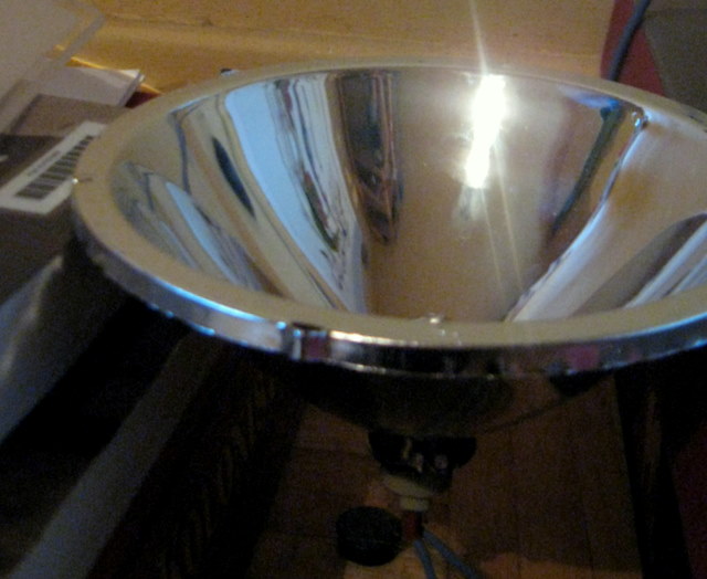

This is a nice reflector, is that the same one (cold mirror reflector) Giorgos18 is using? Did you do some tests with it yourself?

YES !they are same
40$ each include shipping, by post office
60$ each include shipping, by DHL/EMS
that is the exact same reflector I got for testing. It's a great reflector, just need to focus the lamp inside it
interesting! But I assume that you have to use a UHP lamp? Unfortunately, I don't have one... What kind of lamp is in the reflector on the picture, YWH? Would it work with a MH lamp 250W ?

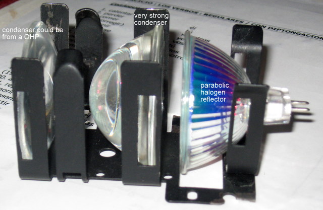

first of all, this is the setup(found on this forum, invented by "Matthias" (?))
with the parabolic halogen reflector the condensor with the short focal distance (from the slide projector) and the other condenser to widen or to narrow the light beam. I tried taking some pictures of the light spot, but it's allmost impossible to take a picture of it with my camera..
But it works! You obtain a very even light spot. Unfortunately, my MH lamp is too big for the 50mm diameter reflector.
I don't know the effect with an elliptical reflector, as you used, giorgos.

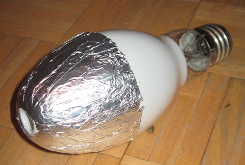

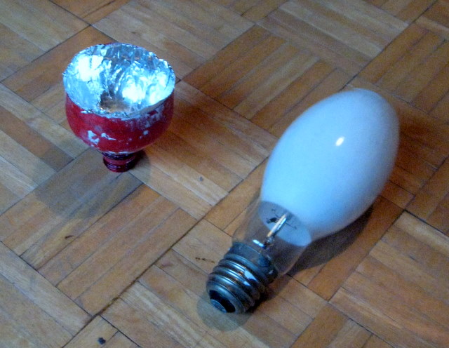

ellipsoidal TEST reflector. I don't know if it will work, have to wait untill the cement is dry. The Mercure lamp has an elliptical form (but I don't know if it will work, it's just a 'trial'!), the alluminium foil should do the job as reflecting coating.. We'll see!
Yes! exactly what DIY is all about! I'm sure that will produce an interesting result

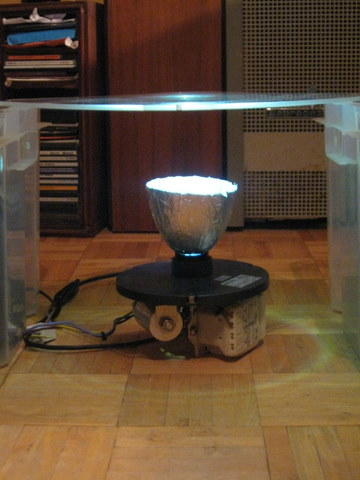

I couldn't wait with the cement reflector untill it was dry, so I made a very crappy test reflector just in alluminium foil, and omg the light is used very efficient! Adjusting the position of the "reflector" made a wide beam, so I could place a +/- 15" fresnel [with a rather short focal length] about 15mm (!!) from the reflector. And here it comes: the COMPLETE surface of the fresnel was 'filled' with light. "Wow!" I thought, now let's try a triplet behind this setup, and yeah, a very bright and sharp image on my wall of the complete fresnel!
If I find my cam, I'll post a picture!
ps, @giorgos: if you get a slideprojector, there is a good IR filter in it, (to protect your dias), so this could solve your heat issue too!

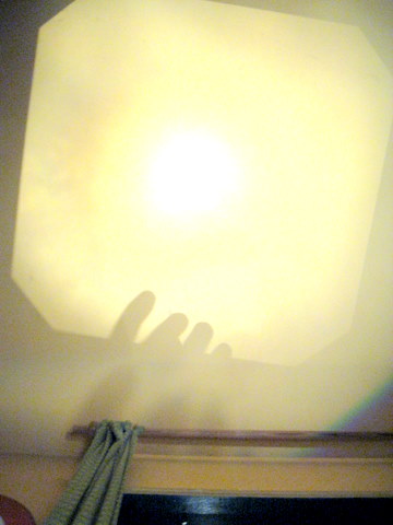

strange, there seems to be a hotspot on the picture, didn't see it with the 'naked eye', in fact it looks different in my room, but it gives an impression of what it is. I didn't cover the top of the light bulb, maybe this should 'remove' the hotspot.
Almost all the light, coming from the bulb/reflector, goes through the fresnel, the rest of the room is quite dark.
btw, this is just a 35W hqi-t... That's why the fresnel can handle the 'heat'. With a 250W, there would be a heat problem, but there has to be a solution
