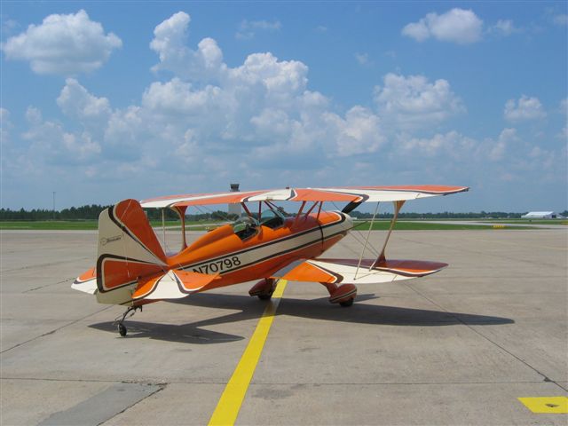

I would in no way undermind your warnings but the lethal degree of Dupont Imron may be a bit overstated. I painted my homebuilt airplane, a Starduster II pictured below, in 1979 with Imron and I am still here. The current owner brought it to Mobile in 2006 and have included pictures of it from that visit. It has been owned by several people including some in England (thus the different N number) and the paint still looks slick and new. Obviously a very durable and long lasting finish. No, it has not been re-painted...
Ray
I don't want to start an argument, just making a point. Of course we know a LOT more today than we did in 1979.
Well, I can't seem to post more than one picture at a time. Please forgive if this is boring.

Ray,
You did a very nice job on the plane, that really looks good.
As far as the paint goes, I was just going by what a friend told me that's a painter at Boeings and a co-worker that does custom paint jobs on cars and motorcycles. When I stopped painting, that stuff was just coming on to the market, so I've never used it.
Since my knowledge of the SOTA paint is somewhat dated, it seems best that I refrain from speaking out of turn and giving information that is dubious or "overstated."
Adios Amigos,
TerryO
