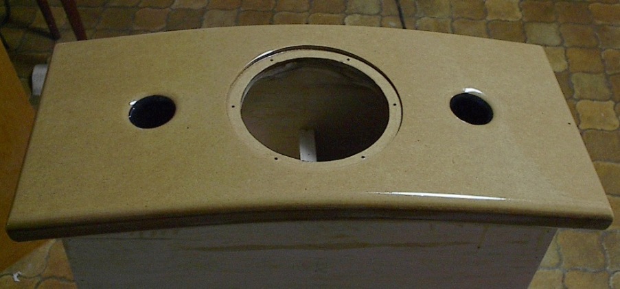

Hi again sploo,
The solvent based clear urethane (doesn't matter what gloss) is what I've found to be the most effective way to prime the raw MDF. This is 1k, just ordinary clear urethane. Thoroughly sand the MDF with 400 grit paper first, to make it as smooth as possible, then spray on 2 or 3 thin coats.
Let this dry 24 hours or more then lightly sand it smooth (by hand) with fine sandpaper. No more priming is needed - edges are sealed, ready for paint.
I did this on my centre speaker baffle and it worked out perfectly. Here's how it looked after the urethane was sprayed on.

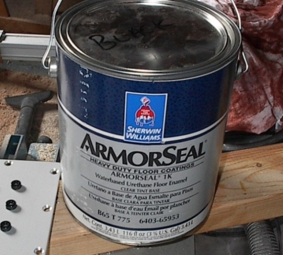

Hi Terry,
I first tried high gloss with alkyd (Tremclad rust paint) several years back on some furniture I did. This I rolled on and sanded smooth and polished. It looked ok after tons of effort.
I then started to spray this, with better results. This paint cures fine, and sands easily after a few days.
I then switched to solvent based urethane paint and sprayed that. This gave great results, but once again the drying time was lengthy. I would need to let it cure for nearly a month for best results.
The obvious other problems with solvent based paint: toxic fumes and highly flammable. Cleanup with dangerous solvents.
I have now been using a waterbased urethane 1k paint from Sherwin Williams, the paint I linked to on the previous page. To say this paint is not on the same level as the 1K oil-based urethane is NOT accurate. It exceeds the oil based on every level of performance. It dries ULTRA fast, low odor, not flammable, extremely tough and durable. One look at the quality of the finish will show that it is not inferior at all.
Invest in a can of this and see the difference for yourself. Once you have used it, it's doubtful you will go back to anything with solvent in it.

John, im sold.
so your using a generic clear urethane as a primer/sealer, then the armorseal. Did you use several thin coats or was it done with heavier passes?
If you have anymore pics of your work I would love to see them!

MJL21193 said:
Hi Terry,

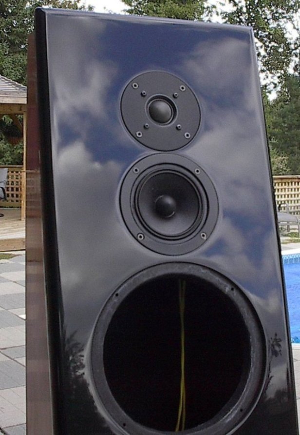

MJL21193 said:
The amp case in post #86 and my curved three-way baffles were just the waterbased urethane paint, smoothed and polished. No clear coat.

Sherwin Williams has several very interesting looking waterbased coatings. I took the chance on the armorseal last year, not knowing for certain how well it would work. I'm glad I did.
They have introduced a new line of automotive waterborne paint: AWX waterborne basecoat/clearcoat.
This looks like the way of the future.
