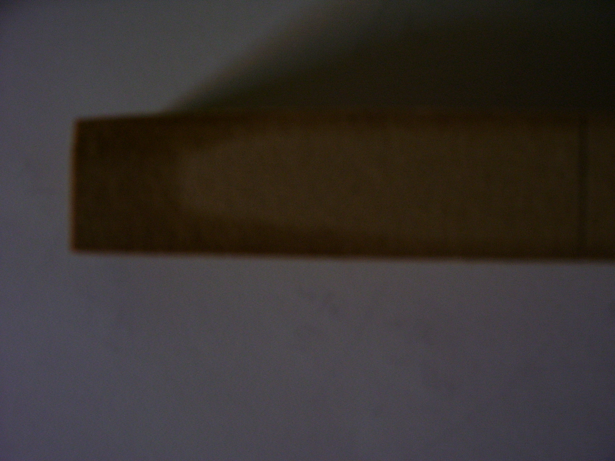

Here is a picture showing the level of penetration of the 50/50 varnish and thinner into 3/4 inch mdf. How much of this was carrying solids I can't say.
The seam is super glue. Looking closely I see voids. When glued up, it had squeeze-out. One point against superglue.

After baking the sanding sealer set at 170 for an hour, I was able to sand them with 220 by hand. Really strange, the seam was far more pronounced as if the tempered edge of the MDF expanded lengthwise. This did not happen on any of the varnish sealed ones. I sanded them smooth again which exposed raw fiber again.
After 4 coats of varnish, it is not building on the surface so it can start to fill and smooth. I went to varnish over top of the sanding sealer. Some soaked in still.

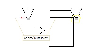

So far for simple rectangular enclosure you might have to go miter edge.
What I did to my speaker baffle is use a 15deg chamfer.
One I glued the baffle I took the 15def chamfer and set it so that it would exactly chamfer away the butt edge. No seams are visible. I wish I though it out better and chambered the other visible butt to butt joint located on top of the speaker.
I'll sketch a diagram.
Here is how I avoided the visible seams on my baffle with a 15deg ( ithink it is 15 but I am sure it is not a 45deg).
It is possble to do this on all the important/visible butt joints, you just have to think it trough and take it into consideration for your design.
My speakers sound quite lovely with this chamfer btw.
I have not tested bevels against round-overs. With flat bevels you could do wood veneer. My working premise based on listening tests is at least a 3/4 roundover is necessary for high end smoothness. A lot of OEM speakers have larger flat facets but I have not tested them.
With 3/4 MDF and a 3/4 roundover, the seam is about where the roundover finishes. Under a mm or so of poly resin, you can't find it. The hope is a year later, you stil can't.
