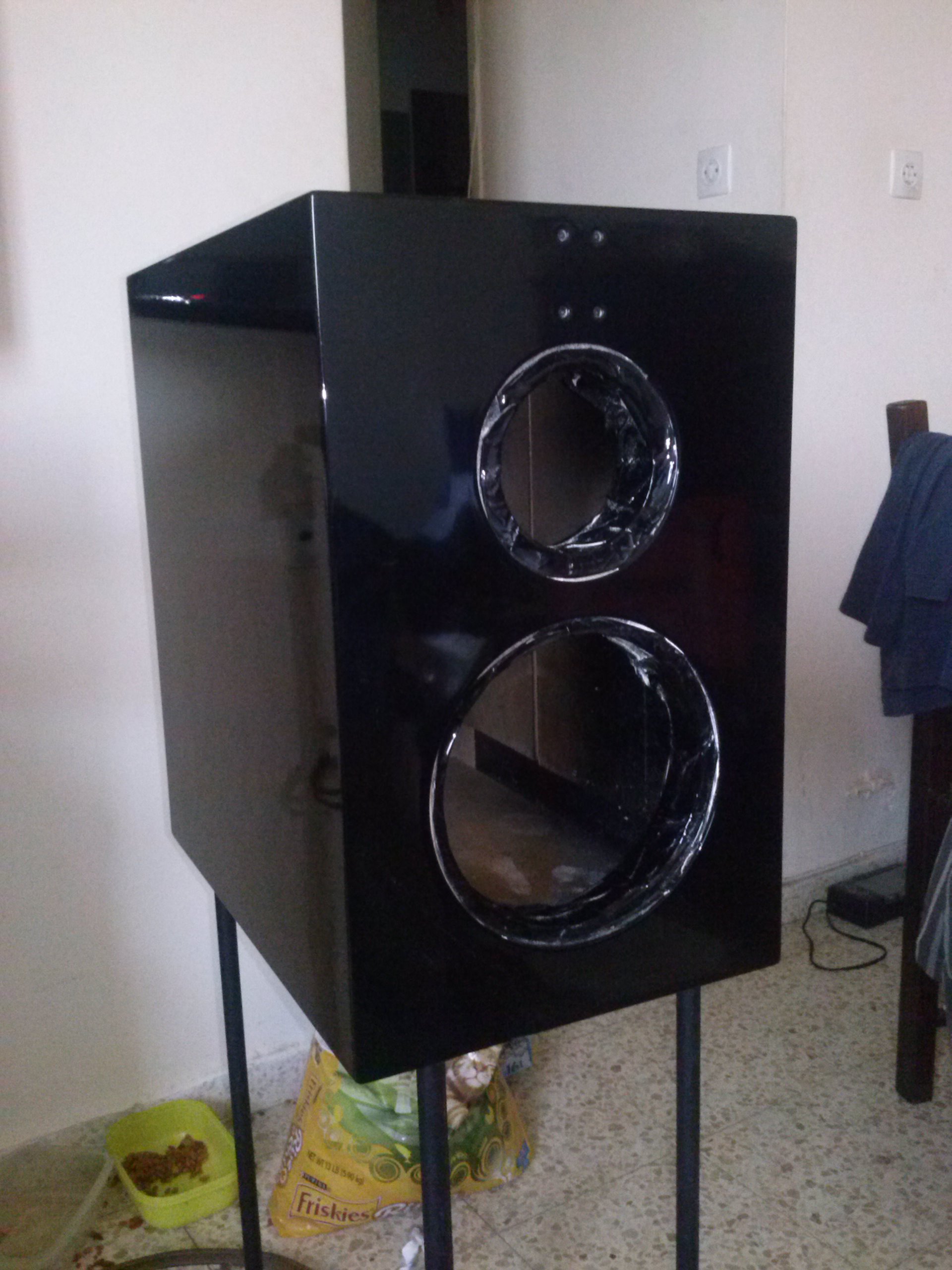

I've just joined the forum, this thread is really fantastic, its a shame the original pictures are not available for reference.
I've tried to follow the process as best as I could being an amateur diyer. I've build a sub box, sealed, primed, wet sanded with 1000, colour coated, wet sanded with 1500. The next stage is to clear coat, I will be using lacquer but I really wanted to validate that what I have so far is kind of expected. I used black gloss spray paint for the colour coat. So after wet sanding it feels very smooth, I've attached some pictures, I'd just like to know if they kind of look as expected, I know its very hard to tell on a computer screen. I just wasn't expecting it to looks so rough 🙂

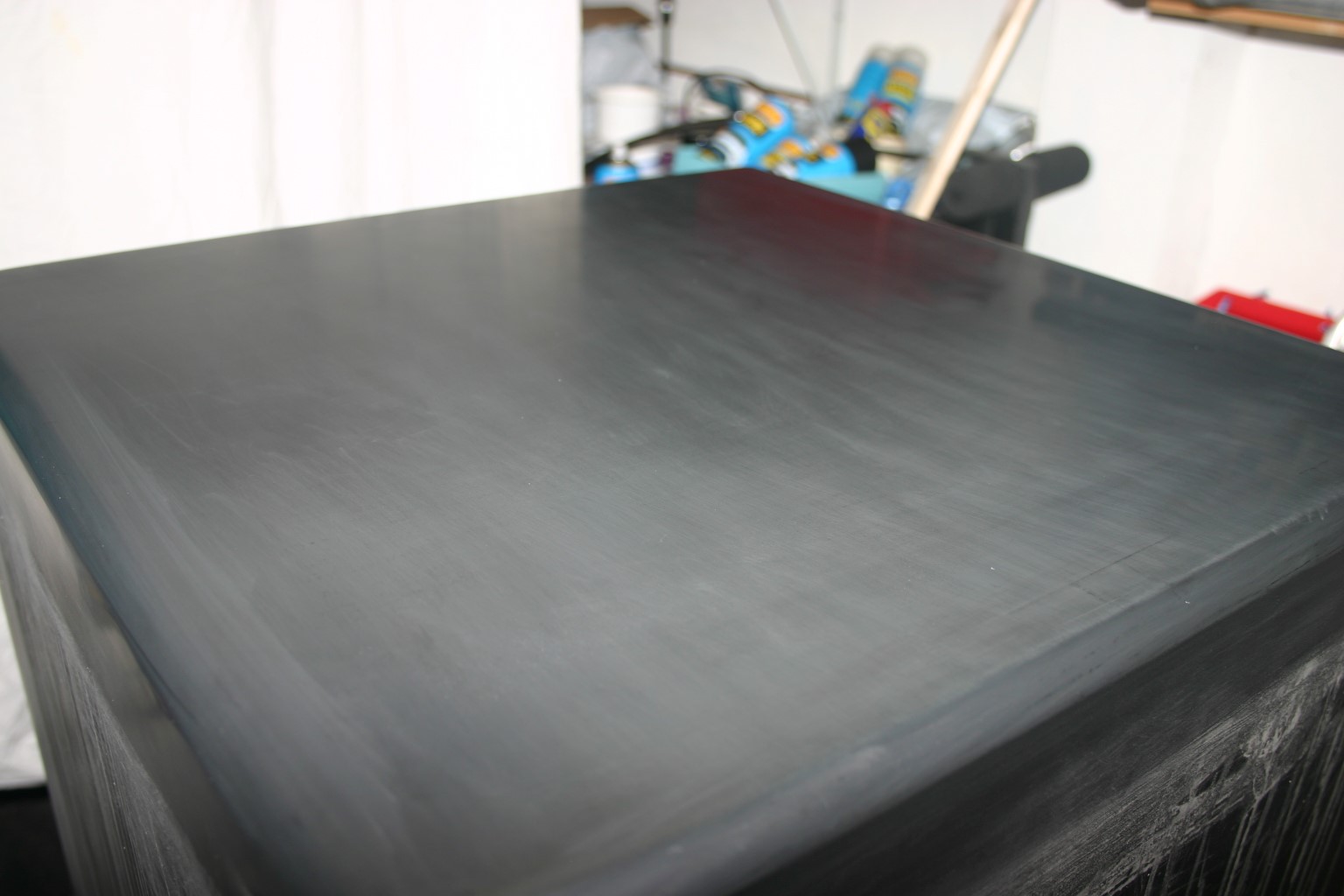

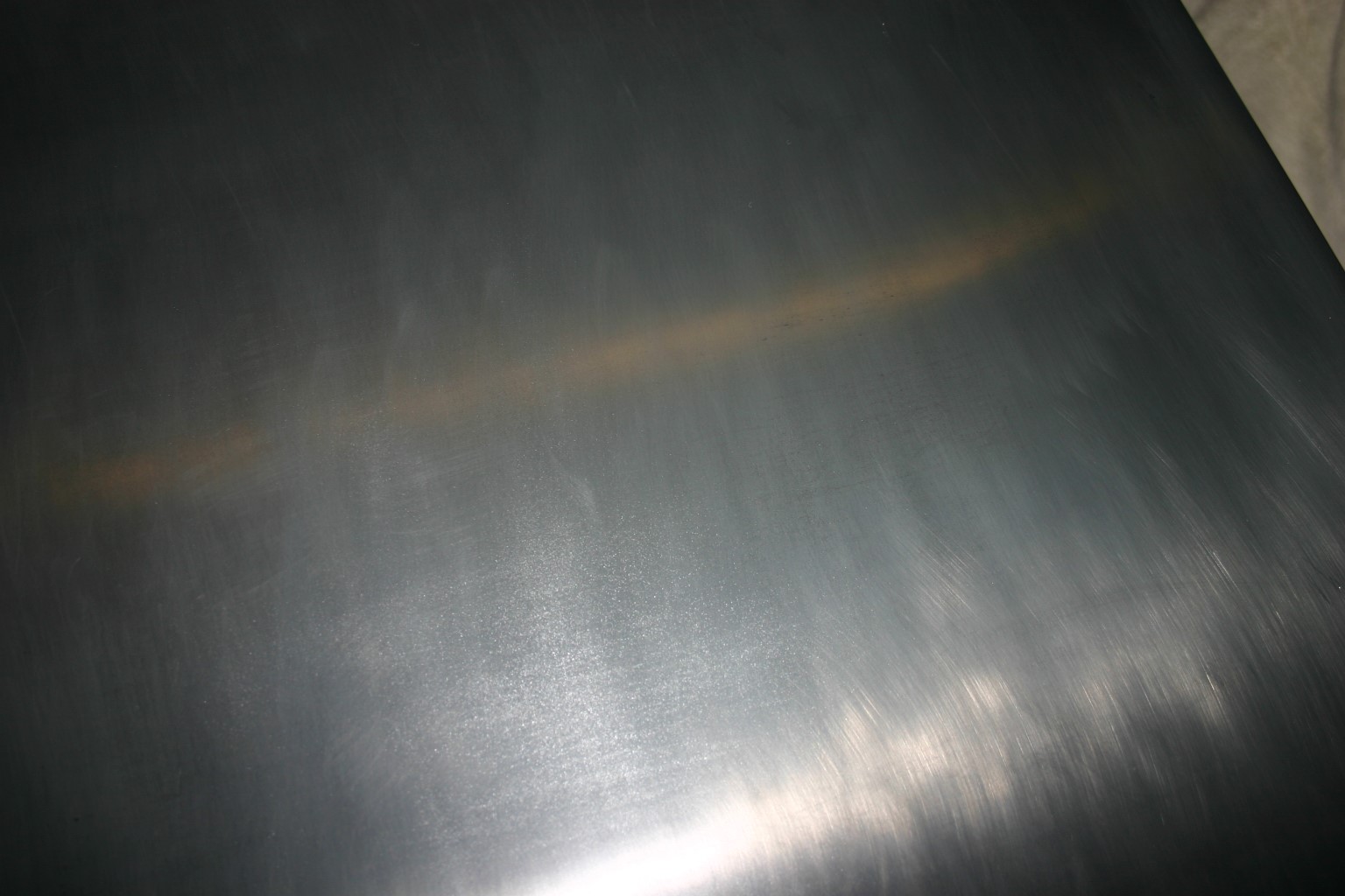

Marvin, it looks about as I'd expect for just sanded...
On the other hand, "lacquer" over "spray paint"? If you're actually talking about lacquer and not just clear spray, you may have a problem. Lacquer thinner will attack most other types of paint destructively....
As jplesset said you have to be sure your base coat and clear coat are compatible. You are ready to polish when your sanded finish is totally even. It looks to me like your base still shows seams and some orange peel. If your clear builds up thick enough this might not matter but if the clear is thin you will sand through when you try to flatten the clear before polishing it. Don't be discouraged, getting a perfectly flat and glossy black finish is very difficult and time consuming but can be done.

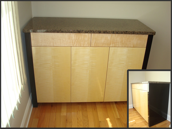

Evan
Evan
and the number of coats and accrued time on those end gables Evan is how many?
Nice grain work on the doors and drawer fronts, even if the colors aren't a dead match.
Doors veneer, and drawers solid?
10 or more coats total. catalyzed. 2 weeks drying before polishing. I use primer tinted to the finish color to get everything flat. Yes, veneered doors and solid drawer fronts.
I made that piece about 7 years ago. I got to see it recently when installing a new bit of cabinets for the customer. Black is still perfect and the door/drawer color came together over time.
Evan
Evan
