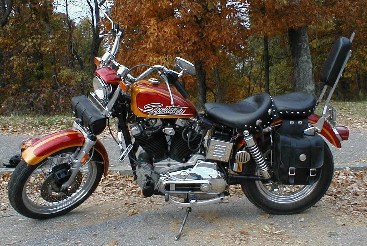

Be sure to use a minimum of a canister mask with appropriate canisters if you are shooting anything but water based. I did the paint job on my bike and a car with the gun and used House of Color Urethane Enamel paint. The catalizer is supposed to be really nasty. I shot it outside and used a partial face mask with activated filters double stacked for safety.
A pressurized mask with isolated intake is even better. You don't want the air intake any where the fumes.
If you paint outside, mornings are the best time, and you have to watch for bugs.

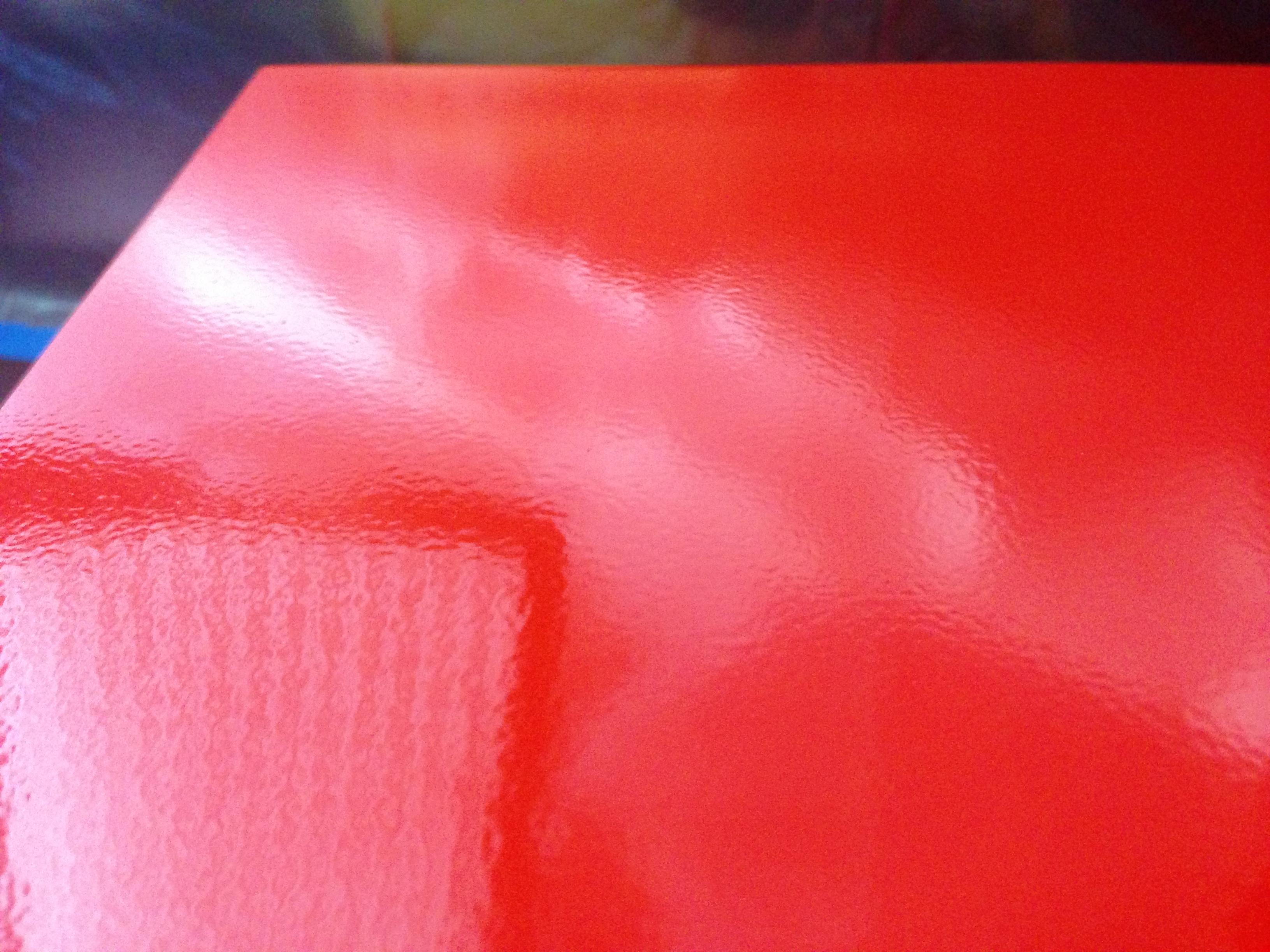

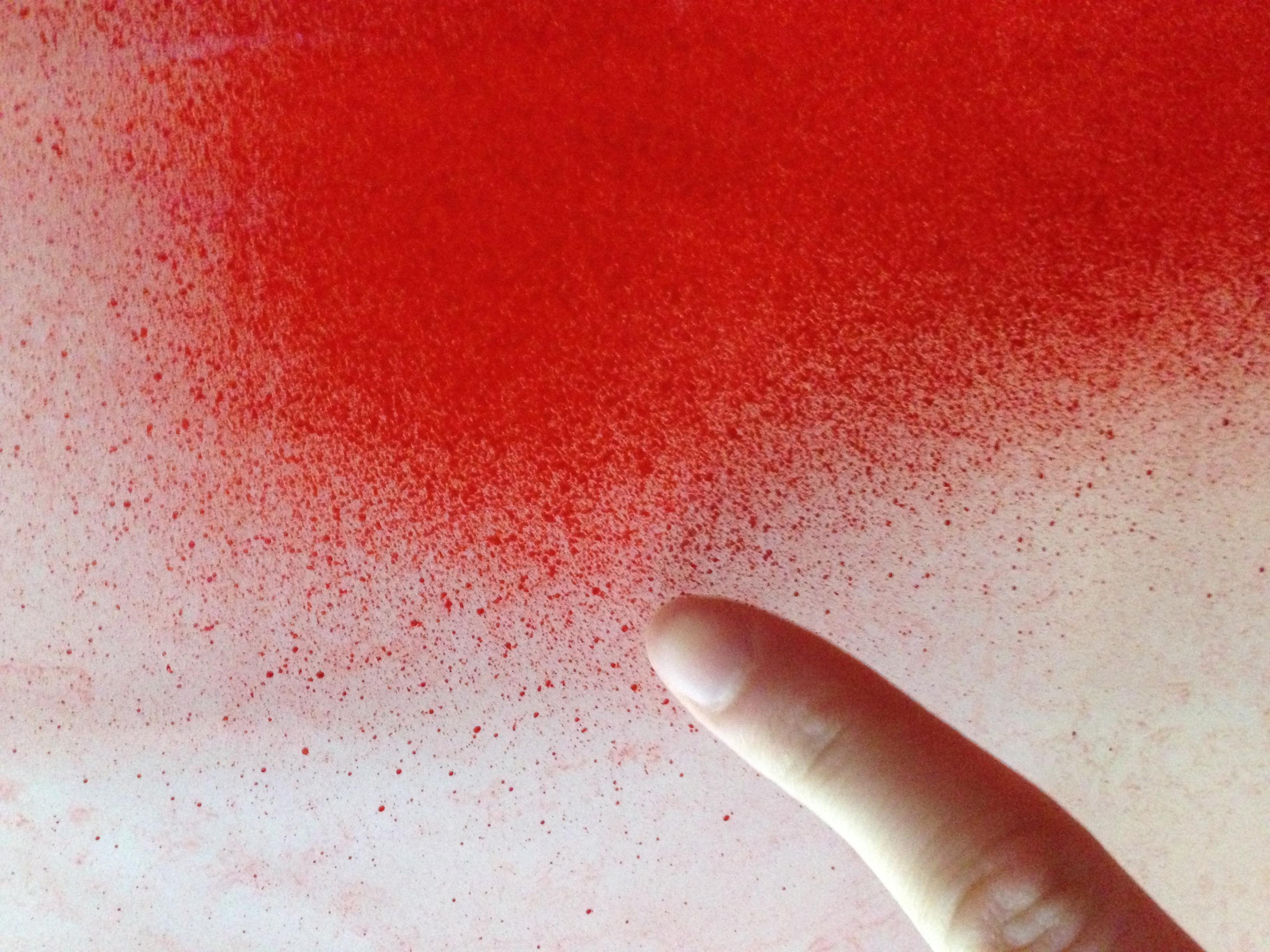

Hi guys,
Me... again :/ lol

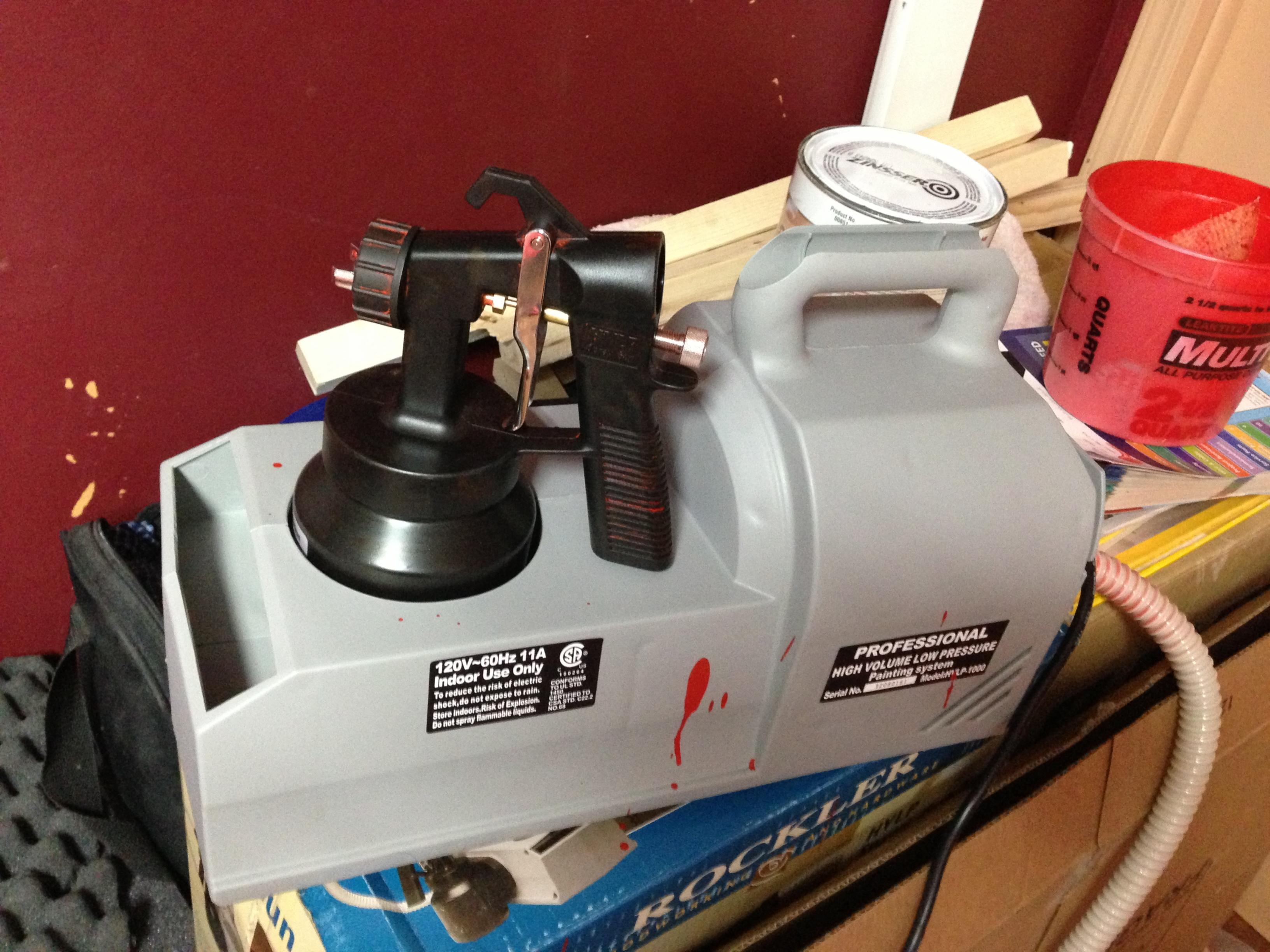

I finally got myself an el-cehapo HLVP gun from Rockler (pic#1). It has gotten a surprisingly good amount of decent reviews for the price it is selling.
Some of the reviews are saying that they are getting amazing results with little to no over-spray or orange peel!

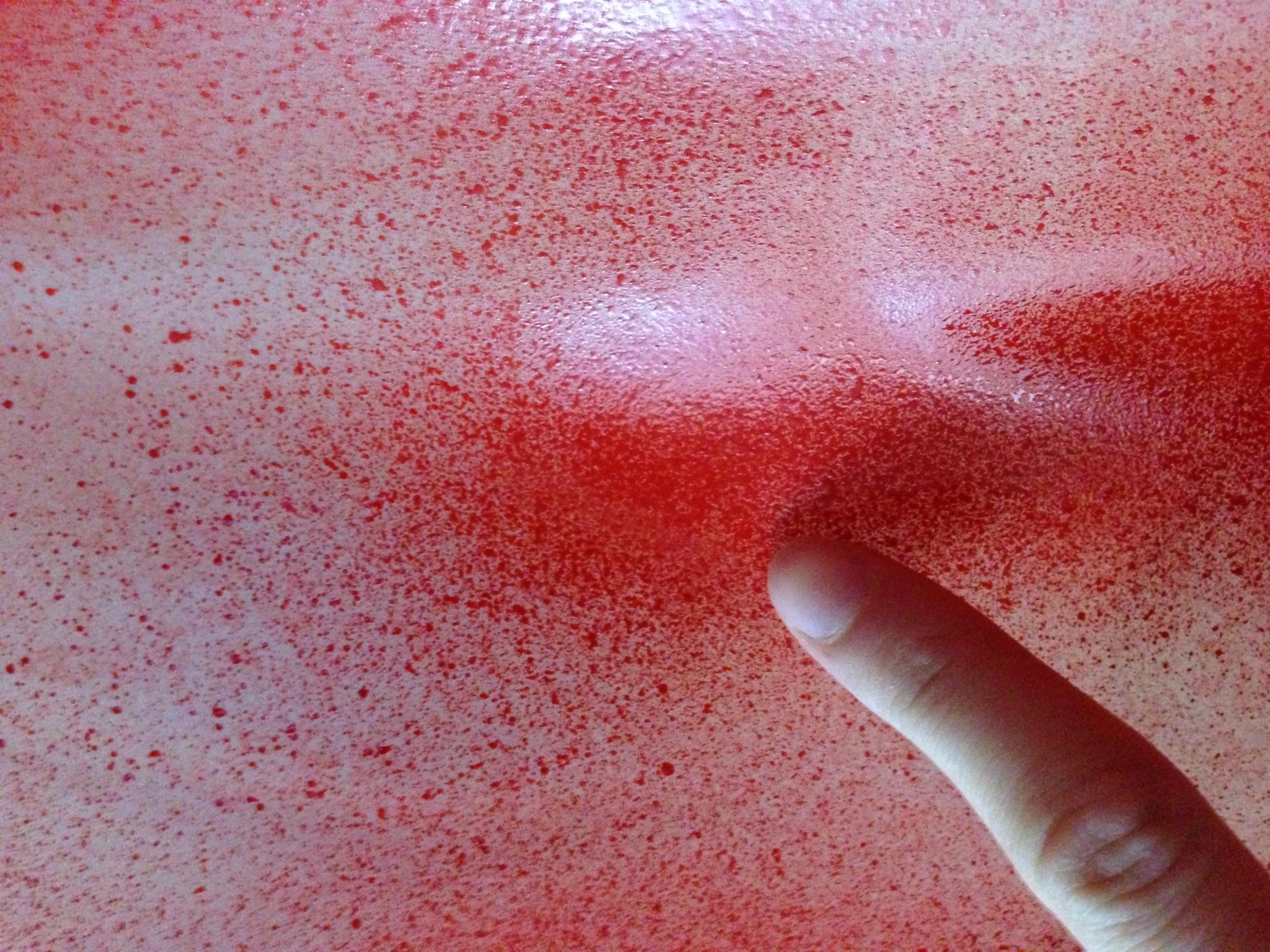

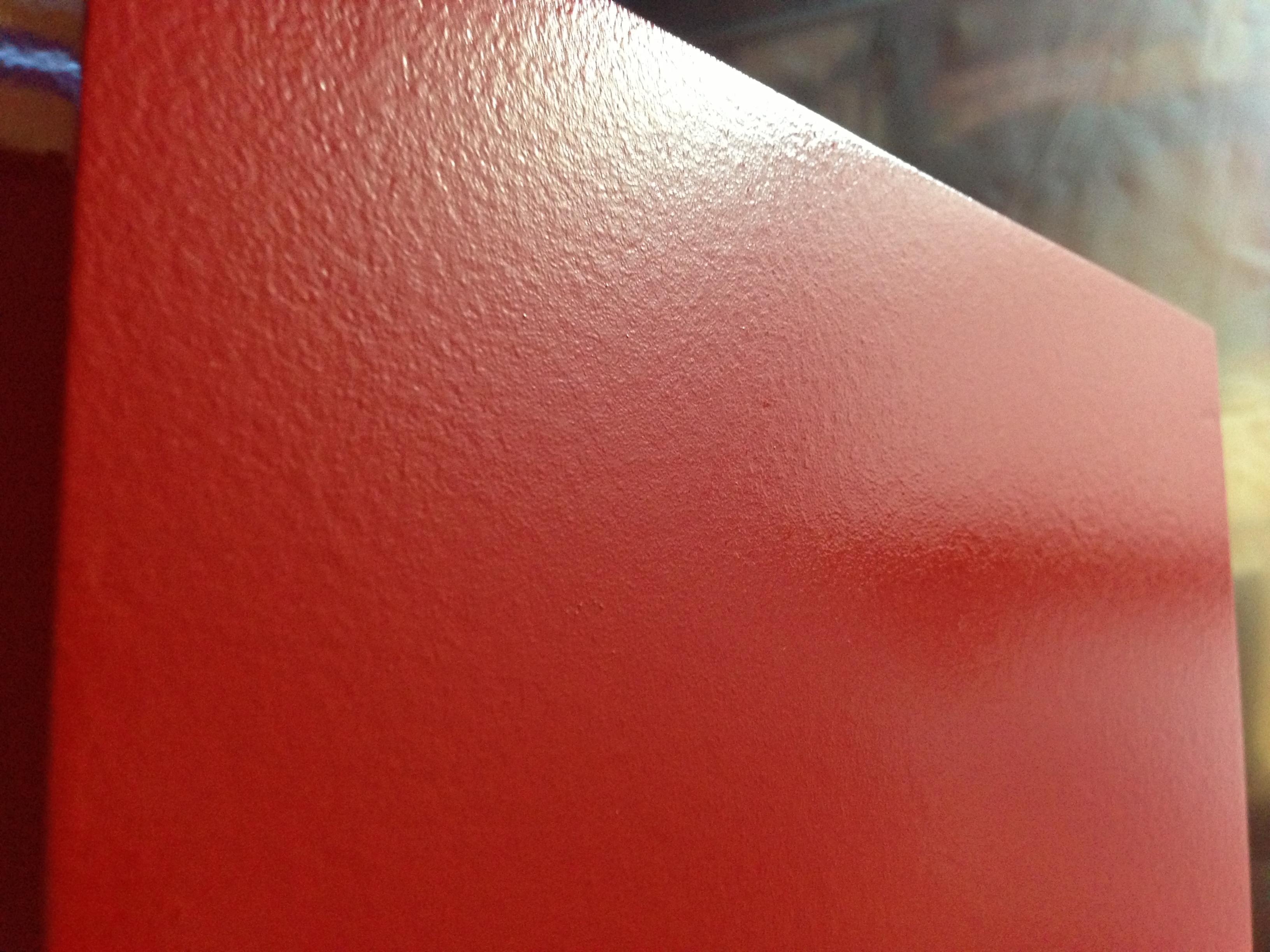

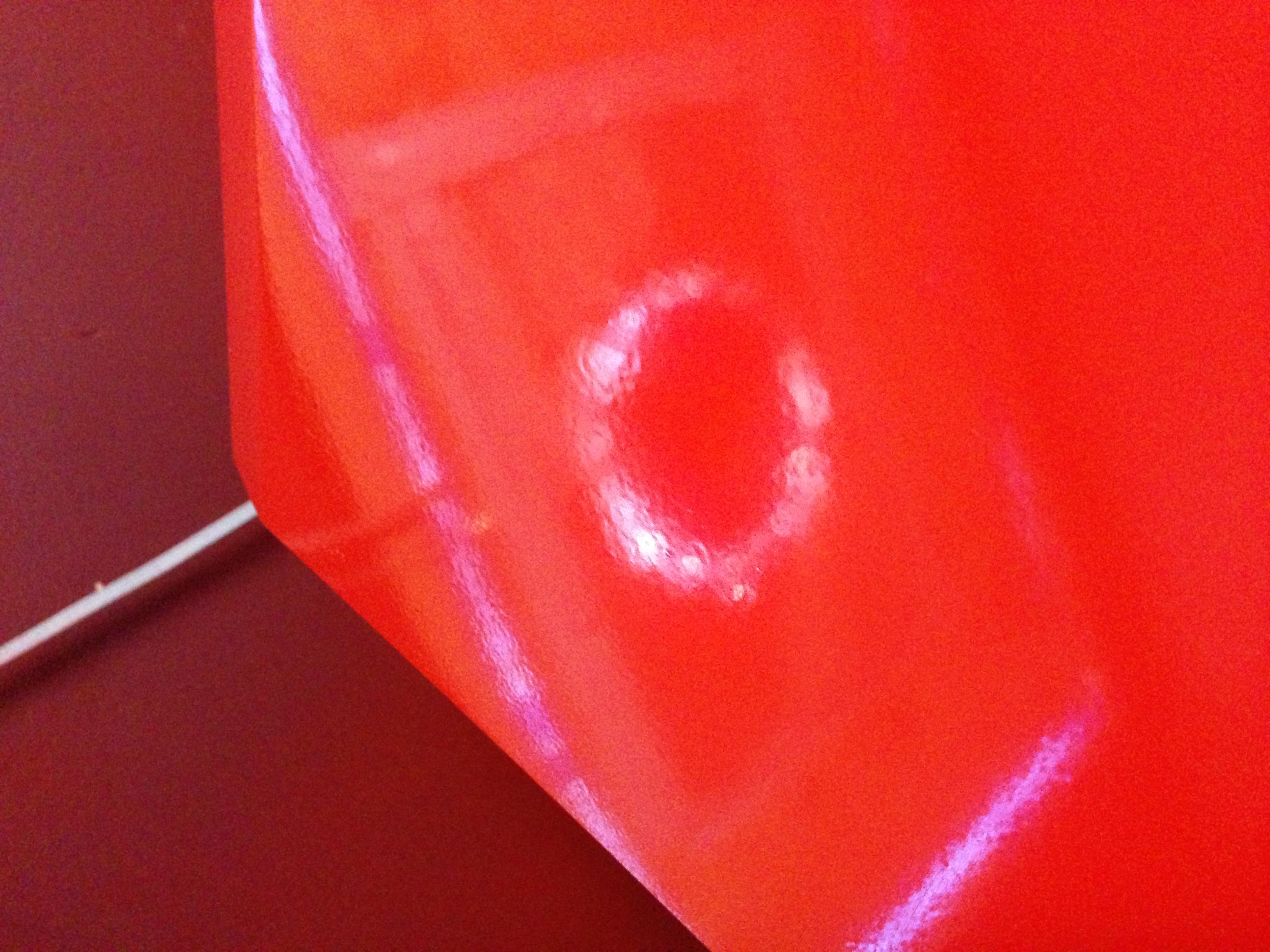

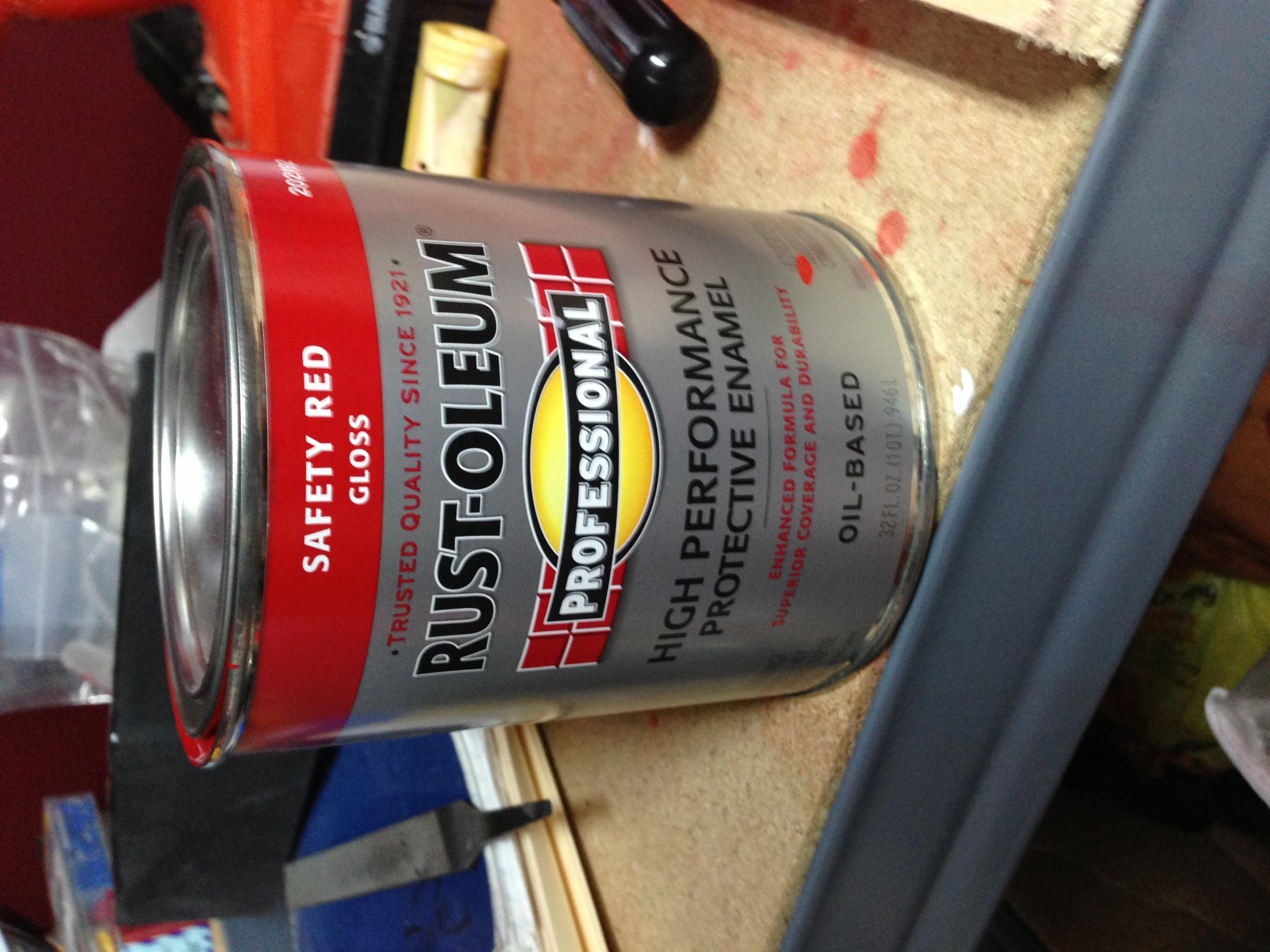

Now I got myself a can of Rust-Oleum professonal oil based paint (pic #2) and at first I mixed it at about 30% (30% diluted with acetone) but I did not get satisfactory results. I even measured with the viscosity cup to get between the commander drain time. I adjusted the material volume/trigger throughout all the ranges and every time I got pretty big droplets (pic #3), so ended up setting the material spray to as low as I can to get some coverage. I sprayed the back of the speaker at that setting and needless to say there was orange peel, a lot of it (pic #4).
Than I cleaned the gun (which was a mess!!!!) and did a 2:1 mix ratio and got slightly better results. I still had to set the materiel spray at pretty low. I got a bit smaller spray droplets (pic#5), but still not that much greater. I decided to spray the whole speaker with that and it was a bit better over all (pics #6 'top of speaker and #7'side of speaker')
I am about to do some sanding with a #400 or #600 and try to get rid of most of the orange peel and crap that got stuck to it :/ (yes i have a DIYpaint booth but apparently nothing i do work properly)
Oh yeah I sanded the primer coat with a #320 flat!
What do I do guys? I am about to mix at 1:1 ratio next time.
Is it the shitty paint or the shitty gun?!? Frankly I can get better result with a spray can.... so I must be doing something wrong at setting this gun and my mixture or the paint is crap. I wish I could do lacquer but there is no red lacquer anywhere and my base coat is shellac already :/

I spent about 1-2 hours wet sanding by hand. I got lets say 80% of the orange peel out and I think I will keep it that way. Next one I will take the random orbital sander and do it that way.... I hope it is easier :/
My intuition looking at your pics is thin it more. I don't know about the rustolium product. There are certainly differences in how different paints spray and flow. have you thought about auto finish?
Yeah I will thin it at about 75% next time (in a day or two). I wish did do an auto finish, I went to PepBoys today and they have Quart cans of Duplicolor lacquer (ready to spray) for abhout $24 each.... kind of pricey. But they have primer, base coat (color choises) and a clear coat. I should have known better and spend the money. I think next time I would go with that combo. Do you have any recommended brand or retailer I can get some good stuff for a decent price?
Acetone evaporates too fast, try 5-10% Naptha or paint thinner
Hmmm.... you think it evaporates that fast that it is giving those results? I am using acetone because that is what is recommended on the directions. I am thinking more acetone and mix at about 75% or 1:1
Do you guys think that Lacquer clear coat will stick to the oil base?
Orange peel means you're either spraying from too far away and/or at too high a pressure, which is another way of saying that it's congealing from evaporation during its flight through air.
FWIW, historically, mineral spirits or Xylene was the thinner of choice to allow the sufficient 'flow' time required for enamel, so I'm guessing that Acetone is required these days to meet EPA emission standards.
Lacquer is a 'hot' thinner, so not only will it stick to enamel, it will melt it, so a sealer is required; though in cold weather I would add a little to thinned enamel to get some initial 'bite'.
Regardless, with enamel it's best to shoot a thin 'tack' coat, then the color coat once it becomes tacky.
