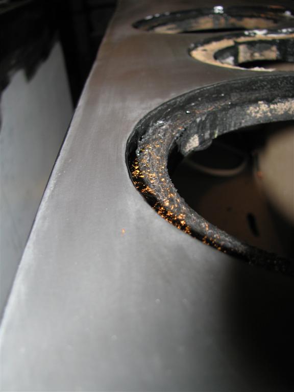

I'm just wondering If after I applied a 2 part primer and 3 coats of black paint And flattened the surface, Can I use a paint roller to apply the top clear coat? , Then flatten and polish ? HAs anyone tried this?
Roller?
I would only do this if I LOVED sanding. even the best rollers don't come close to as smooth as spraying.
once you get it flat, if you spray evenly it should stay fairly flat and be easier to rub out.
Who doesn't!I would only do this if I LOVED sanding.
I agree, even with an HVLP you need a reasonable amount of sanding. With a roller you'd be shooting yourself in the foot to get out of walking a mile.
I guess my question is along the same lines: I've been brushing on the black glossy and have wet-sanded down with 400 and 600, so that it's smooth and swirly, with no glossy marks showing through any more (man, that sucked!)I'm just wondering If after I applied a 2 part primer and 3 coats of black paint And flattened the surface, Can I use a paint roller to apply the top clear coat? , Then flatten and polish ? HAs anyone tried this?
I had bought brush-on lacquer and was now considering returning that for canned stuff...
Taking that as a given now, are the next steps simply to spray on a few-four coats of the clear stuff, and then sand with the 1000-2000, cutting compound, etc.?
Or, do I just go straight to the 2000-grit sanding and then the cutting compounds?

First off, you have to wait a month for the paint to cure before you consider sanding the final coat or applying any type of polish.I guess my question is along the same lines: I've been brushing on the black glossy and have wet-sanded down with 400 and 600, so that it's smooth and swirly, with no glossy marks showing through any more (man, that sucked!)
You appear to be using MDF, did you apply a primer? It's important that you seal all the little pores in the MDF. If you did use a primer, how many layers have you applied? It's really easy to sand or polish through the finish if you don't have a few layers to work with. If it looks like you've sanded through any points on the primer, keep applying layers and sanding until there isn't any bare spots after the sanding is finished. I prefer to apply 2 layers between standing. Once you have the primer down you'll want to apply a couple layers of lacquer, sand down with a higher grit paper (1600 will work) then apply 2 more and sand once again. Once you've applied the lacquer and it's clear you aren't sanding through the paint you should apply as many clear coats as you can. If you are doing this with cans I would suggest at least 4, if not more. Once again standing every 2 coats and you can sand with 2000p if you have it at this point. Don't sand the final coat, you have to wait for the paint to cure first.
Once you've got the final coat finished, wait a month before sanding the final coat, be very careful not to sand through the finish. It's important that you get the surface as smooth as possible, any little bumps will create noticeable defects in the reflection. After you're done sanding, apply the cutting compound. Don't use too much, you just need a little bit. If it looks like it's taking forever to polish away the fluid you're likely using too much. I did 4-6 applications and sanded by hand, but it'll very depending on the quality of the sanding job and the paint. Once you have a fairly reflective finish, apply the car polish to remove the swirls from the cutting fluid.
Very good eyes. I might do something a long those lines for the next speakers I plan to build (much nicer design) but I was more than satisfied with the results as they stand.Kareface, awesome job on the speakers! If you try it next time though, for the front baffle you might want to look into a pore filler/grain filler, especially for those woods like oak, which if my eyes aren't deceiving me is what you used for the front baffle? That will make it so that you can get that glass like finish on wood as well if that's what you're after. Looks awesome as is! just thought i'd mention how to get the similiar finish on a real wood instead of painted in keeping with the thread😉 Lots of other steps of course, but it's not overly dissimiliar to finishing a painted surface.
Yeah, that I'd seen a number of times, but it's good to drive home again. I keep fighting myself against trying to do it all now and be done with it. Luckily, since I wasn't sure of the next steps, I didn't have that option!First off, you have to wait a month for the paint to cure before you consider sanding the final coat or applying any type of polish.
I am using MDF, so I had used two coats of primer, sanded smooth, before brushing on any paint. I did sand through to wood on some of my earliest efforts, and definitely saw the result the next coat I put on, so I went back and hit those with primer before the following coat of paint. I actually took it all the way back down to wood after a particularly bad sanding job, when I figured it would be best to get everything back to one layer and build up uniformly. I was originally doing a coat of paint or primer, then sanding, but I have gone to two coats between sands.You appear to be using MDF, did you apply a primer? It's important that you seal all the little pores in the MDF. If you did use a primer, how many layers have you applied? It's really easy to sand or polish through the finish if you don't have a few layers to work with. If it looks like you've sanded through any points on the primer, keep applying layers and sanding until there isn't any bare spots after the sanding is finished.
THIS is exactly what I needed to hear/see. For some reason, I was thinking that I had to wait a month between the paint and putting any clear coat on.Once you've applied the lacquer and it's clear you aren't sanding through the paint you should apply as many clear coats as you can. If you are doing this with cans I would suggest at least 4, if not more.
The rest of the advice is greatly appreciated, too. For some reason, no matter how many times I read through the write-ups (yours or ShinOBIWAN’s), I couldn’t quite get the timing of the 1-month pause. Thank you again.
