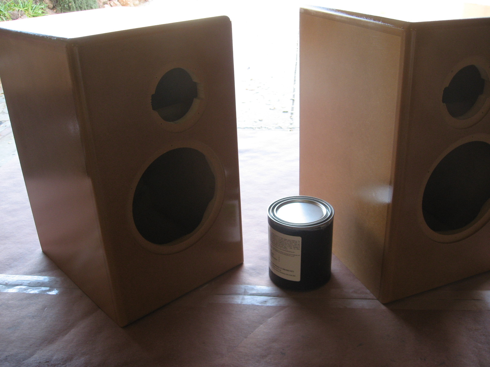

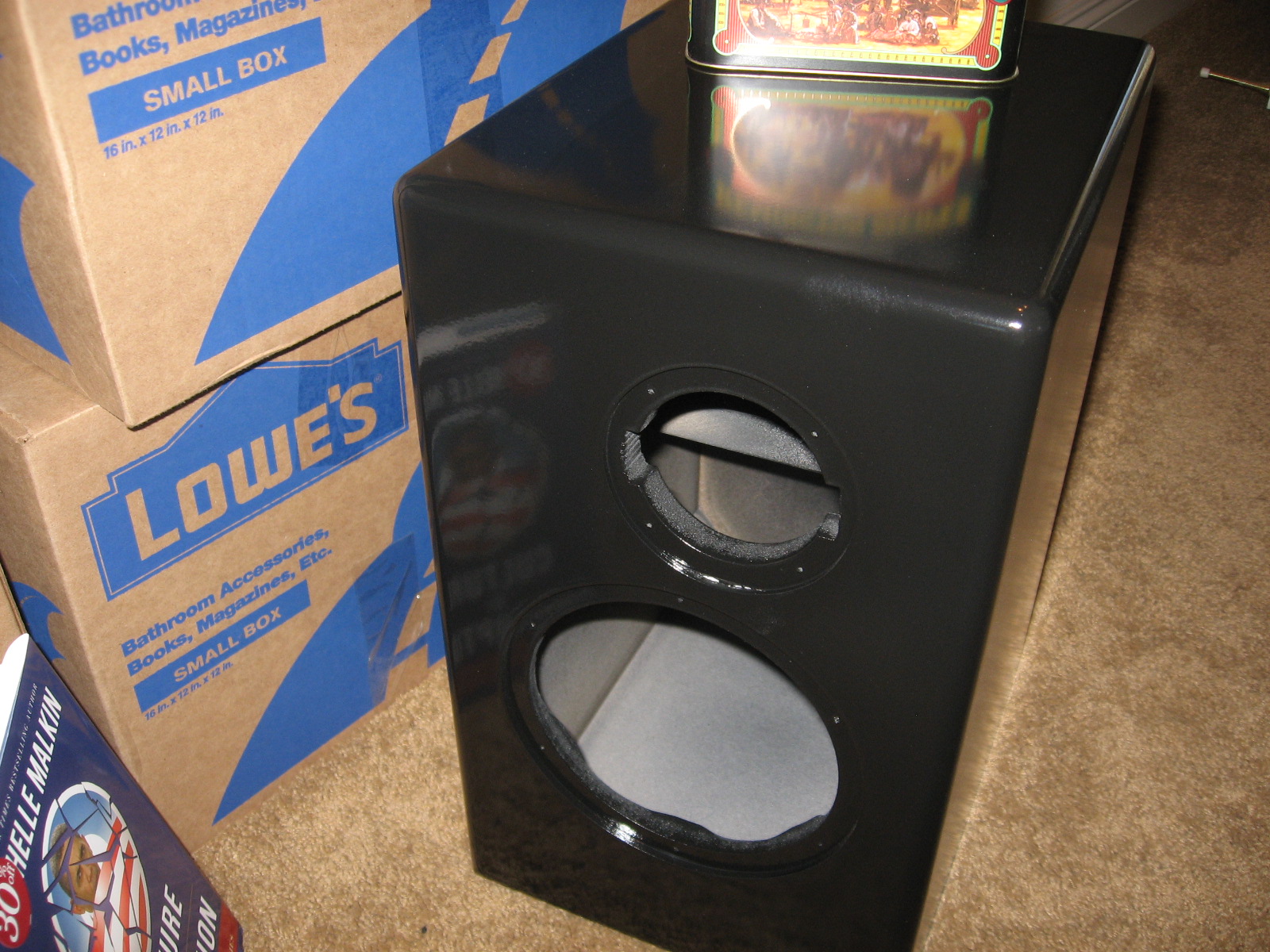

I've recently finished spraying some questionably old Target USL clear over a base coat of USL black on a pair of small speakers, nice finish without buffing out yet. They are a Christmas present and won't be fully cured in time to polish and buff........I was looking forward to trying my hand at the "Piano" finish. As Global Warming has overcome us here in sunny Northern California it snowed 6" last week and lasted on the ground for 4 days. 🙄 This played havoc with my finishing schedule and caused a few problems as you can imagine. Unheated garage, rental house, can't find any tools.... excuses, excuses. Still and all they came out pretty good for the adverse conditions.

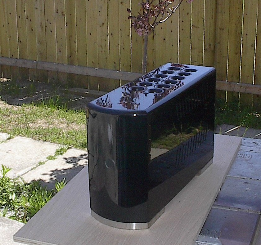

I've used Sherwin William's Armorseal waterborne urethane paint on a few projects with excellent results. It is actually an industrial floor paint, it's 1K but cures very hard - harder than solvent based urethane. I used it here:
And here:
without a clearcoat - just sprayed the colour, wet sand with 2000 grit and buff. They look the same today, the paint is very durable and has excellent gloss retention. I've also used it as the basecoat for a clear solvent based finish with great results.

I finished the polishing process on one of the speakers last night. Took about 12hrs to completely sand and polish that single speaker. The tools I will be using is, 2000p sand paper, a rubber sanding block, Farecla G3, some terry cloths and 3M's car polish for dark finishes.
I'm going to be wet sanding so I want to make sure I don't get any water near the drivers. I also don't want to ruin the finish on the front of the speakers.
I decided to test the process on the back of the speaker first just in case. I'm going to sand it down a little and then try polishing it to see how the results come out.
Left 1/2 sanded, right 1/2 sanded and semi-polished. Just to give you and idea of the pre and post results. This isn't fully polished, just a couple layers of the cutting fluid.
All of the sanding and polishing I'm doing by hand.
Almost done, just need the final layer of car polish.
You can tell from the side of the speakers that the image is really blurry, I don't have a tripod and I suck at taking pictures. However I can tell you that the speakers are actually more reflective and clearer then what the picture denotes. The shaking blurs the reflection but it'll have to do till I can borrow a tripod from a friend.
Here is a side by side with my unpolished left speaker. Just to give you an idea of the before and after. I really couldn't be happier with the results. It took about 12hrs to do one speaker, but it was worth the effort.
