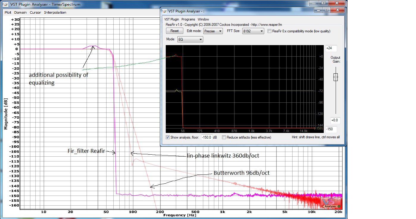

ReaFir filter

try Reafir standalone Filter.
this makes a very steep filter, its phase linear and you can adjust the frequency response, doing some equalizing.
