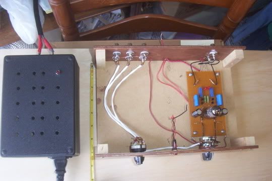

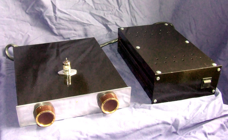

well i hope you people don't mind "slumming"a bit, i'd like to share my "dumbed down" version of the unity gain linestage inspired by sys excellent project. i like it alot. i also plan on trying some of the regulation features in the future. preamp is set up to ultimatley accommodate 2 more of the little 2 channel modules for 6 channels total, for possible home theater use.

it's a very basic version without all the regulation or the input tranny, but i do believe it accomplished many of the goals of low(very! just about dead silent with high sensitivity amps and 100db horns)) noise, and excellent sound with no gain. this thing will drive very long cables with little or no sonic compromise.
i constructed the ps(outboard) and preamp using odds and ends around my work space. ps tranny is a old allied 125-0-125 job wired full wave netting about 105 b+ after 3 stages of rc filtering. the box is a rs 5$ job drilled for cooling it doesn't need and sprayed black "wrinkle"
i mounted a tube socket(modified standard tab to a pc mount!) to a perfboard and both channels and ccs(thanks for help sy!) are point to point wired completley on it, making a neat little module.
one note-after some back and forth comparison, i think that it sounds a little better with ac filaments-of course AFTER i had laid out and built the ps with a dc filament module! even after this change it was quiet so i left it ac.
sorry for the thread crash, i like the project and felt inspired to post! even "dumbed down" it's a great sounding little pre.
