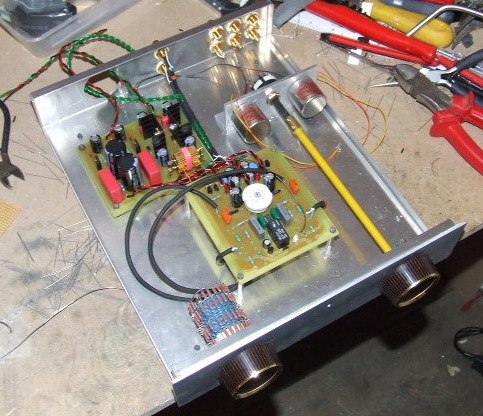

Getting closer...

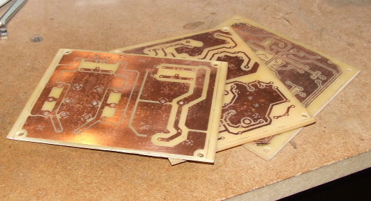

Pinkmouse,
Excellent! How about a bit more detail? Got any layout files you might be willing to share? I'd also love to hear whether the Jensen transformers are worth every penny, or I could safely go with one of the alternatives?

There are a few odd layouts dotted around the forum,(here's one for instance), but the current ones are really down to SY to check first, and then give permission to publish. However, if he is making up a batch of boards he might well have spare proper ones to sell on.

Re: the grounding issue, that's why pinkmouse is designing a board. Point to point ought to be left to us veterans.
