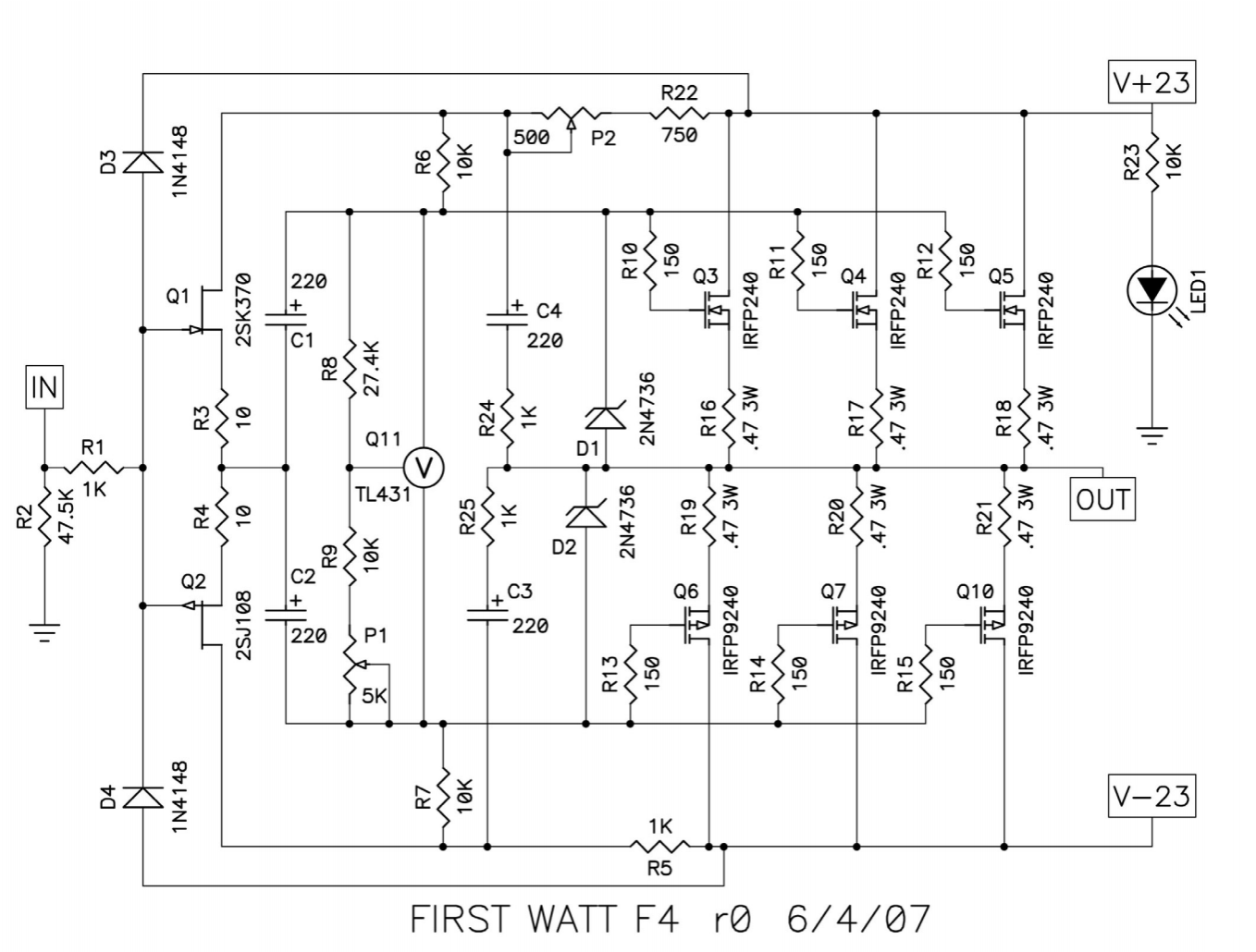

If we are talking resistors can some one help me and point out which are the more important resistors IE that are part of the direct signal pass. I guess R1 is very important since it is in direct path and in the low line end. R2 might be very important as well or?
Others that are key? R16 to R21 or?

I want to do it well and build it as good as I possible can. But put money where in counts. That is why I am looking for your expert advice. Give it a shot Mr Zen and lets see if we can align our audiophoolery moons.
use MP (metal plate, those white flat ones) series for source resistors
or to go wild, use Isabellenhütte ones
trimpots strictly multiturn Bourns, most expensive you can find in adequate form factor
R1,2,3,4 - use Dale non magnetic ones, or go wild and think Shinkoh and .....ah, wtf! just look at this page and use most expensive ones: Resistors | Hifi Collective
for mosfet gate resistors only 1/4W Allen Bradley Carbon Composite ones are Kosher enough to be even put in the mouth of proper Audiophi/oo/l/e
and yes - elcos - industrail quality is either Pana or Elna or Rubycon; but Kosher is nothing else than Black Gate

Mr Zen the man. I guess I got what I asked for. Fantastic🙂. Ok i will reveal now how little I know
Which R numbers are are the source resistors?
Which R numbers are are the mosfet gate resistors?

Gate resistors. No sound signal go through these resistors or?
Resistors on source or drain side have sound signal or?

I have tried my best to rank the resistors regarding which ones are important to the sound.
Please add your opinion or tell me where I go wrong below. Ranking 1-5 where 5 is important:
• R1+R2.........5
• R3+R4.........4
• R5-R9......... 1
• R10-R15......2
• R16-R21......3
• R22-R25......1
The gate resistors pass the sound signal to the FETs' gates, but only very little current passes (practically only charging and discharging the gate capacity, that's what makes mosfets so special as compared to bipolar transistors). In my opinion, RN60 resistors are already overkill here, so just about right.
The source resistors each pass a share of the current that is going through the speaker voice coil. Bulk foil resistors like the Fukushima MPC are probably as far as you want to go. I wouldn't use Mills MRA in that position, not much to gain really.
Concerning trimpots, Vishay has these bulk foil potentiometers:
Y40535K00000K0L Vishay Precision Group Foil Resistors | Mouser Osterreich
They would no doubt be a complete waste in that position, just use Bourns 3269 and be done with it.

Can you comment on my ranking of importance ?

They are all important.
Also, in my experience and opinion, there is no better resistor for our purposes than the Vishay/Dale RN series.

Spending more money on resistors will absolutely cost more money. I don't think it will do much else. 🙂
Joined 2009
just use good quality resistors, means good engineering grade (not audiophool) which in my book means a reputable brand sourced not from ebay-china, film type (thin metal film is a good place to start) and plenty of derating (e.g. use 1/2W for small signal rather than 1/8W). Source resistors can be non-inductive wire wound.
Noise will be dominated by Mr. Johnson so long as you avoid known krap techology like old bulk carbon-comp and possibly other thick film types
