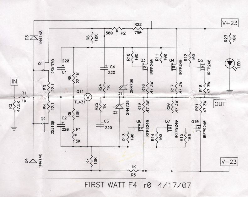

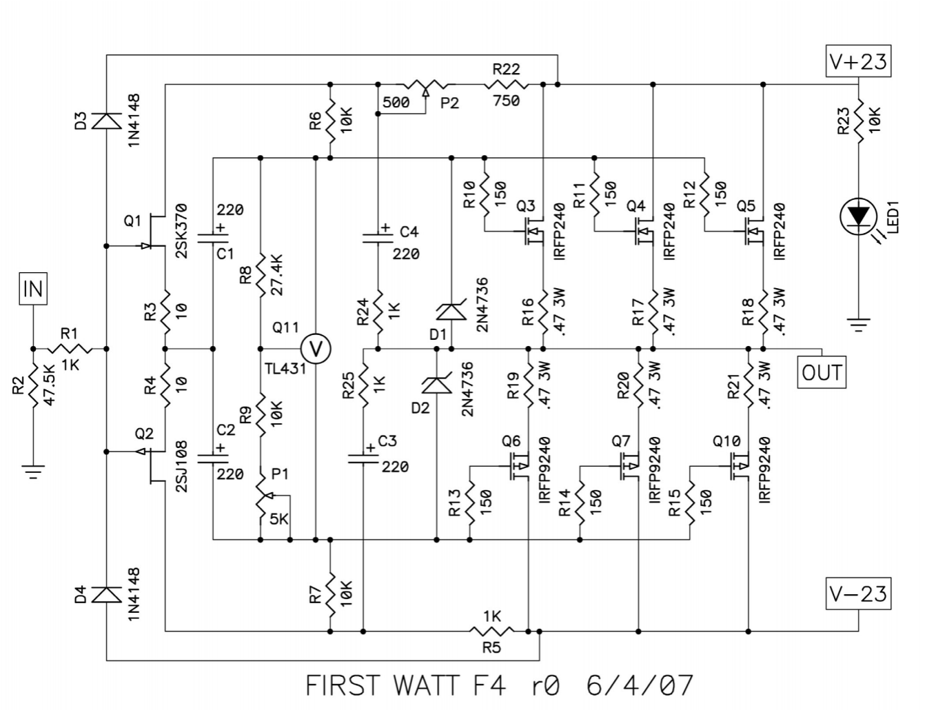

Hi DIY team.
I hope all well and safe. I am a new member building a F4 amp. I am looking at ordering the parts. F4 boards are sold out so I hope they come in soon.
When I buy the parts shall I follow the BOM in the Nelson Pass F4 manual dated 2007 OR shall I follow the diyaudio store BOM dated 2011?
R3-4 and R8 and R10-15 are different Nelson vs store.
I have not ordered any parts yet so I just like to make sure I do it right.
Some help is appreciated.
Hi DIY team.
..................NELSON PASS MANUAL....VS..... DIY STORE
R3+R4 ...................10R..............................22.1R.......................??
R8..........................27.4K ...........................22.1K......................??
R10-15....................150R.............................100R.......................??
It looks like the store was referencing a slightly older schematics. I suggest
using the values in the current manual.
Thanks a lot Dennis!
The DIY Store schematics is dated 2011 and the store BOM by JojoD818 is dated 2013.
The NP Manual schematics is dated 2007.
So I shall follow the NP 2007 schematics as attached. Correct?

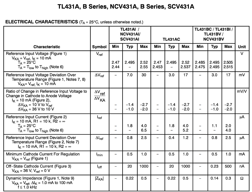

The cheapest one with big stock is TL431CZT. 2% tolerance and 100 ppm. EUR 0,315.
The TL431BVLPRAG is EUR 0,405 and 0,4% and 50 ppm.
If I can find the EUR 0,1 extra in my pocket is it a good idea and will it work to buy TL431BVLPRAG??
TL431BVLPRAG ON Semiconductor | Mouser Sverige
Thanks for your support.
Get the part that will make you sleep better at night.
The only suggestion I have is to buy at least 10 to get quantity discount,
since you can use them in other designs.... 🙂
I find that it is invariably the best quality part not the cheapest that ‘sits well with me’ long term. Even if it’s under the hood, I know it’s there!
