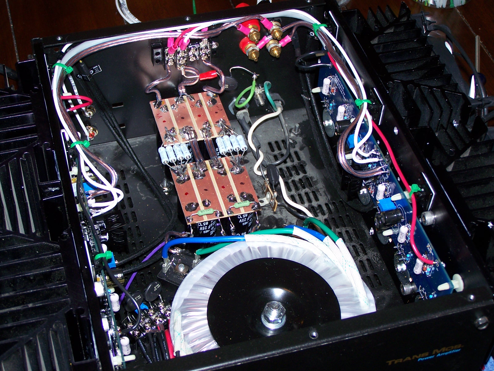

I used the AS4218 from antek.
There are other options from Hammond and Triad but nowhere near the price.
I was originally going to use the AS3218 from Antek, if you aren't planning on cranking the bias like I did then it will be more than enough.
You could probably use the AS4220 and burn a volt or 2 in the CRC.

No, I would notice the fans failing.
They are open frame so you see them spinning right in front of you.
Usually when PC Fans fail they won't initially spin up.
With modern Fluid Dynamic bearings they will run for many years without issue.

I used the AS-5218 in my build as the 400va was out of stock. Only issue i ran into was lack of physical space for the toroid and psu board with rectifiers inside the 4U case, hence i had to stack them.
