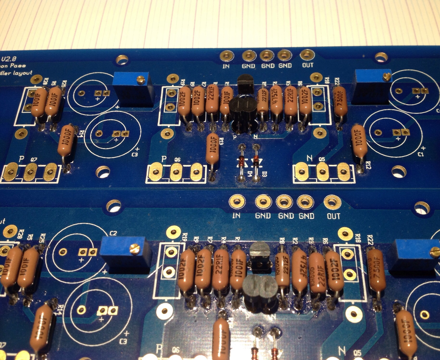

Looking at the P / W choice for the Bourns trimmer resistor:
Assuming one was to put it on the board as shown at the beginning of this thread...
From the picture, it appears it would adjust towards the capacitors, not upward, which would be convenient.

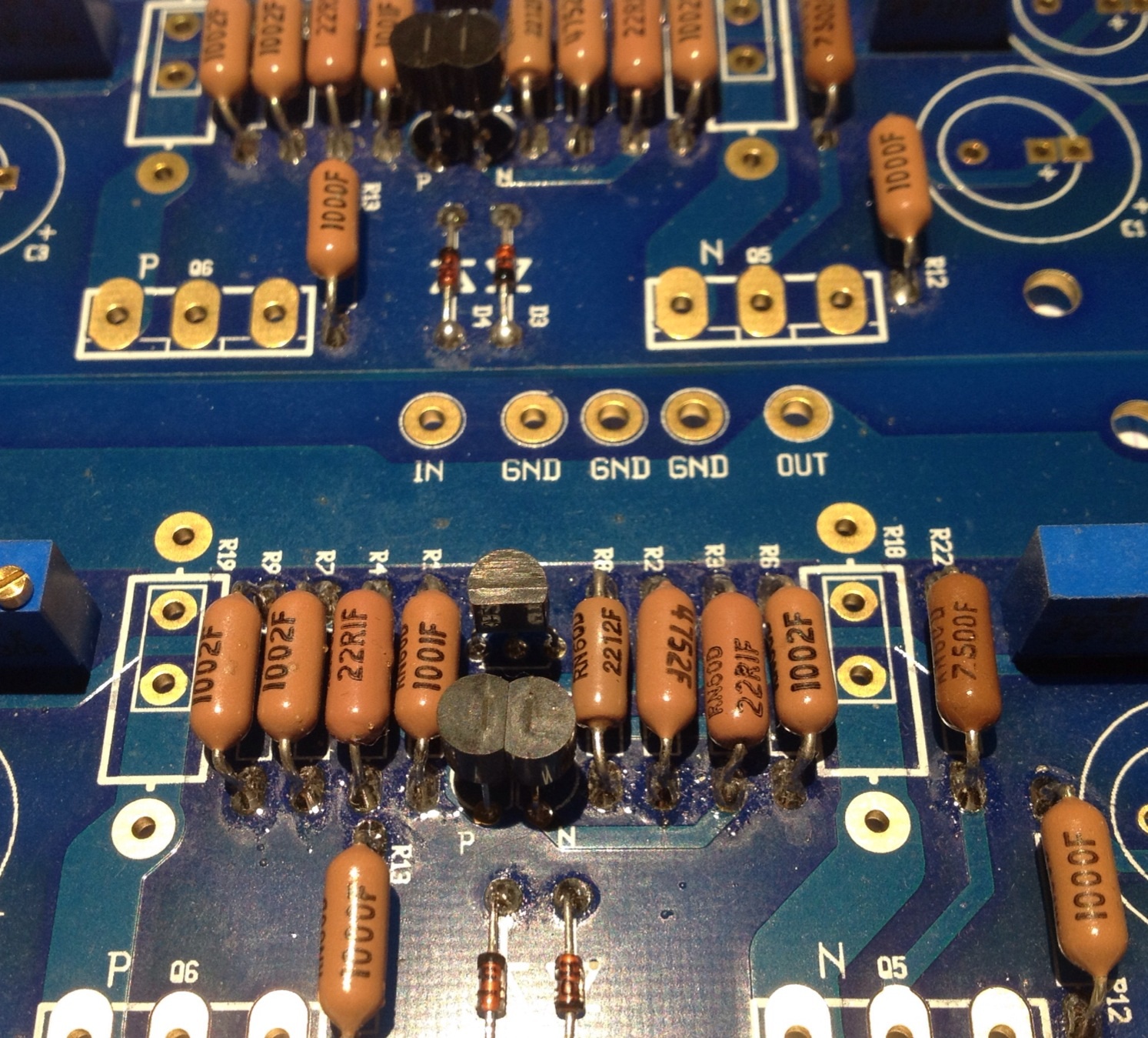

6L6 did mention the RN60 wouldn't fit (in some places, such as near center of board), but I think I understand what he meant by mounting them "Soldier" style. I see Apex Jr has some 18g teflon tubing which would help prevent shorts if I am understanding what he is saying.
Either of the Bourns trimmer pots will work. The only difference is location of the knob.
RN60 get tight, but you can make it work.
RN55 will work perfectly in this circuit -- the RN series is 50% thermally derated, so if they are calling an RN55 a 1/8W resistor, it's actually a 1/4W. They are mil-spec and are built in the next size body.
A CMF55 and RN55 are essentially the same thing, the only real difference being that the RN will always have copper leads, the CMF may have copper or steel.

I used the p version pointing up where w pointed points at the caps.

RN60 will fit but they are right next to each other.
Yes it look like on my "work in progress " pcb with all RN60
Not yet cleaned but it be made at finish. Have a nice day 🙂
