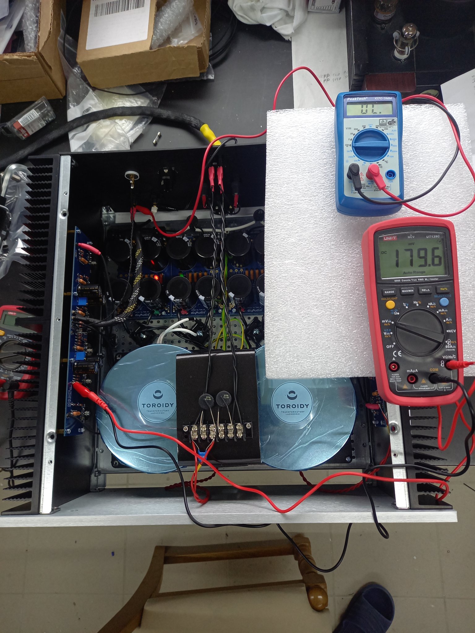

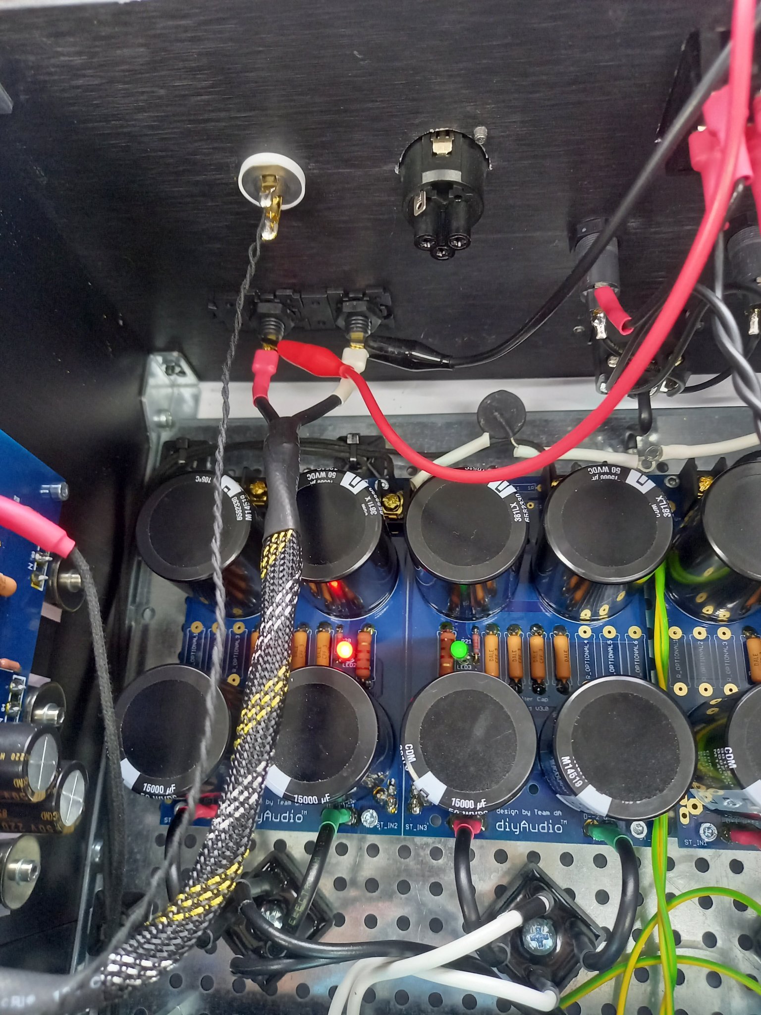

How are you hooking up the DMM?
You mentioned replacing the pot. Does the old one measure fine?
Problem solved, it was my fault. 🤢🤣
After much inspection I realized that I had swapped the minus rail and GND wires on one channel. Lucky I didn't fry anything. I just started both channels and adjusted the bias and offset. Thanks to everyone who helped make this a success and happy new year!!!🙂🥂

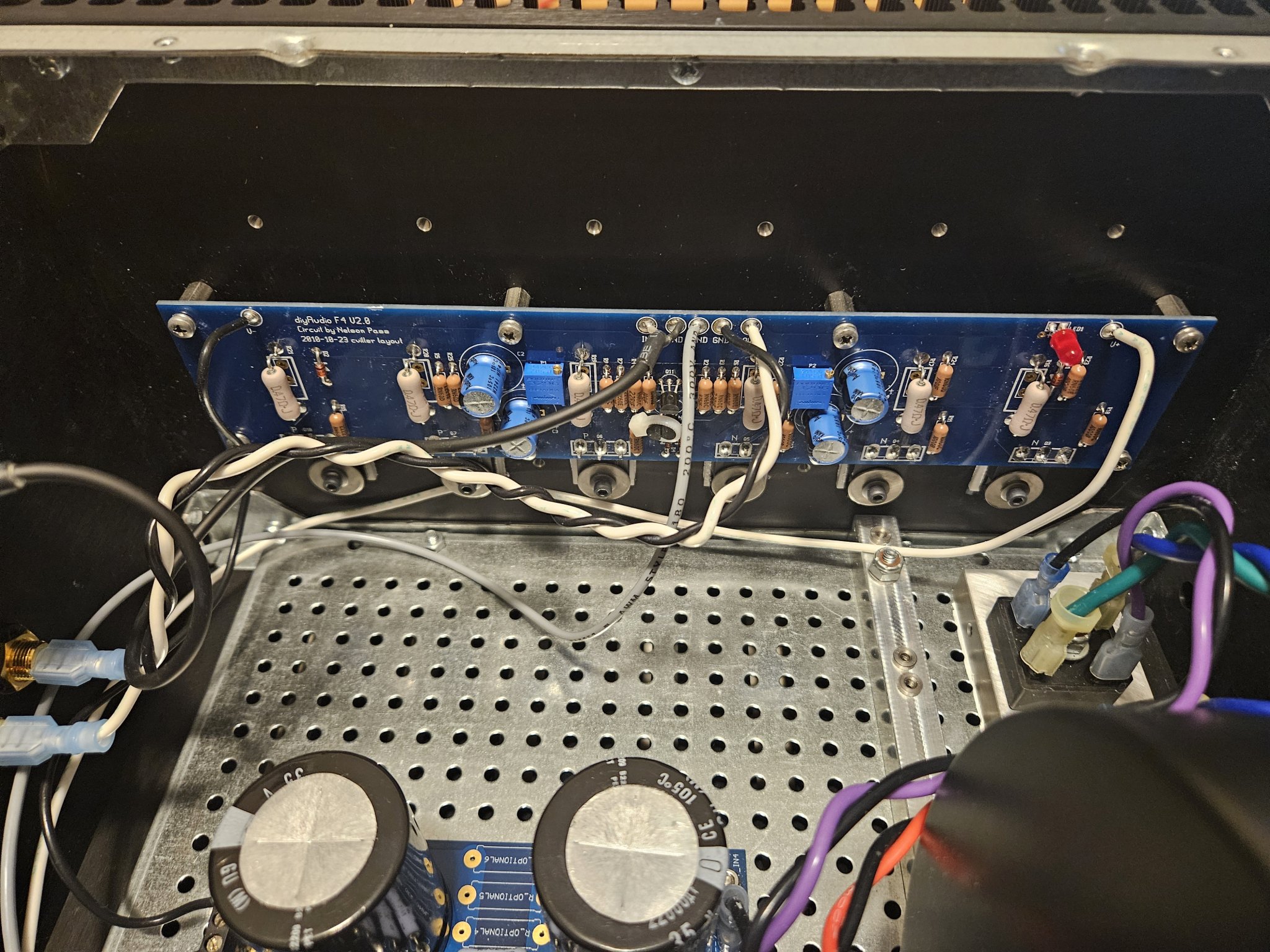

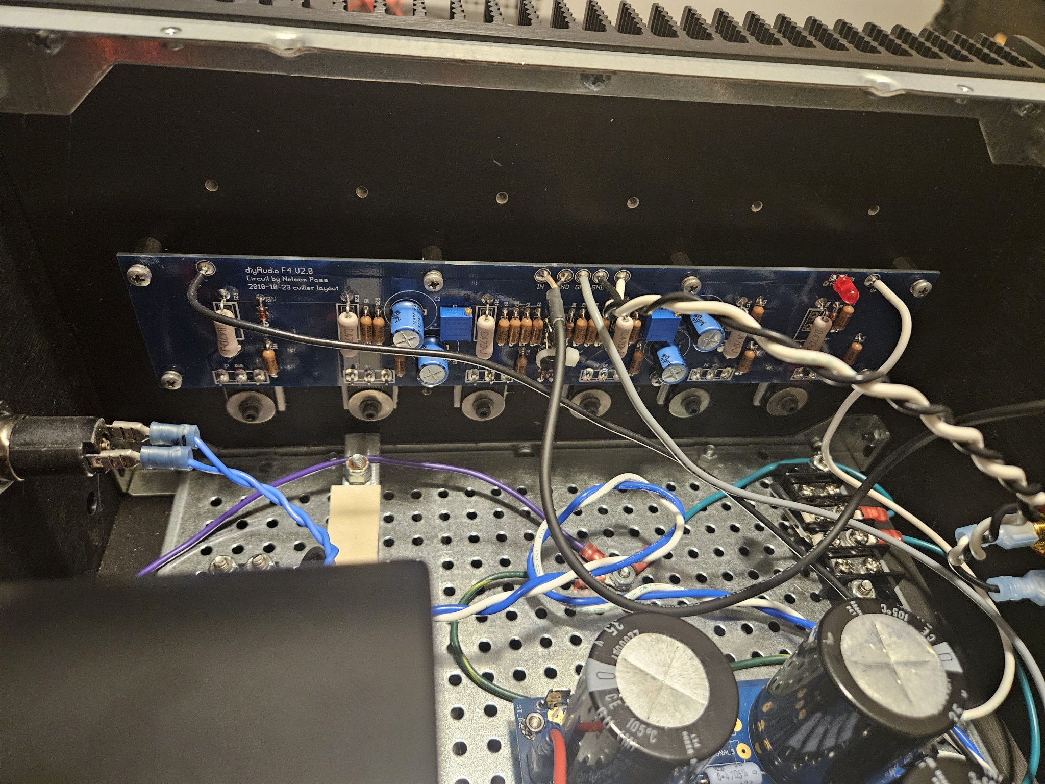

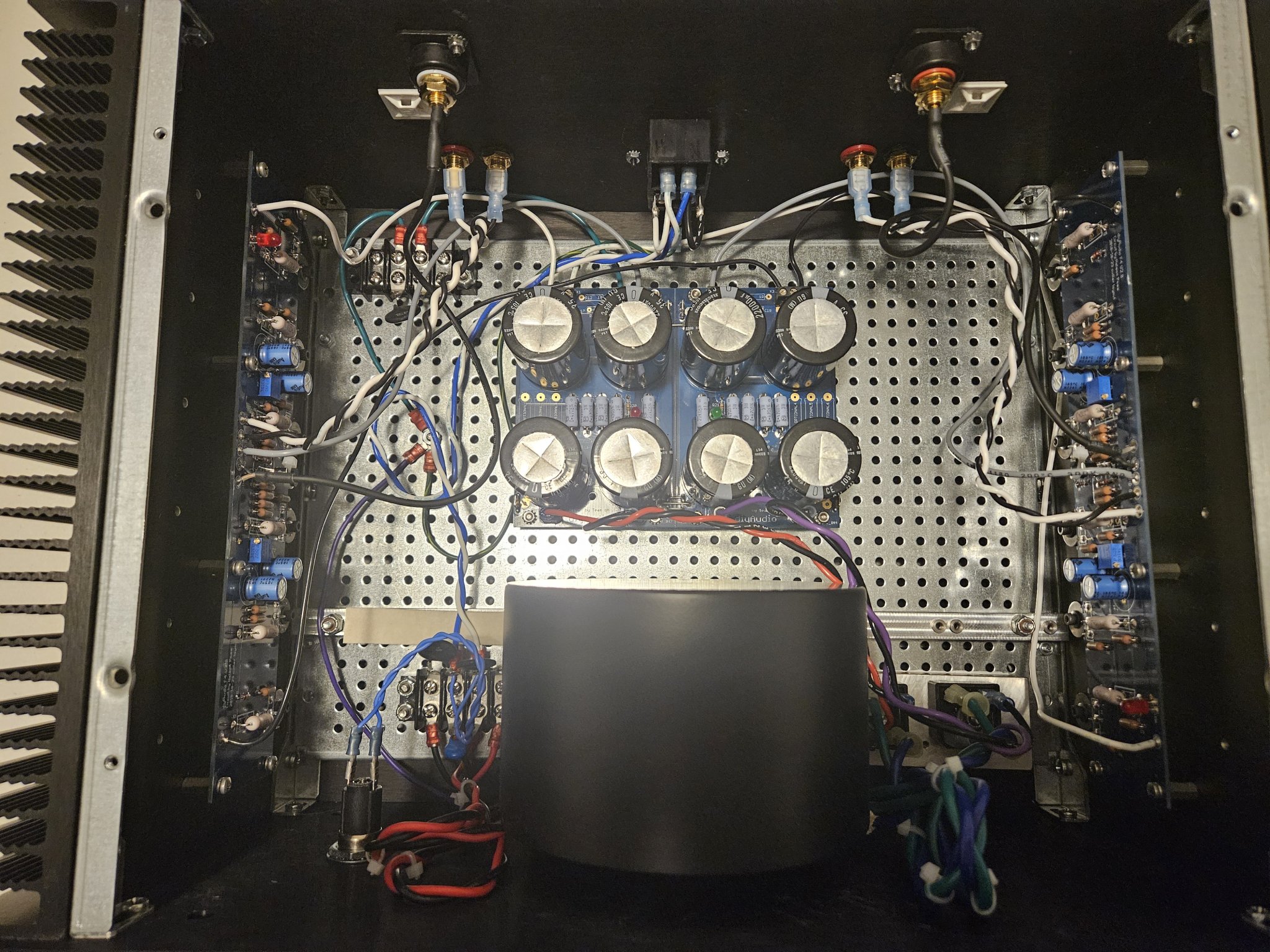

Finished my third FirstWatt diy build today. My first build was an M2X, and the second was an Aleph J. I’ll call this one my ThirdWatt.
It’s a standard build using the diyAudio Store F-4/BA-3 Transistor Kit, which are said to be matched, however I received mine without any values marked on the mosfets. But I decided to charge ahead and installed them anyway.

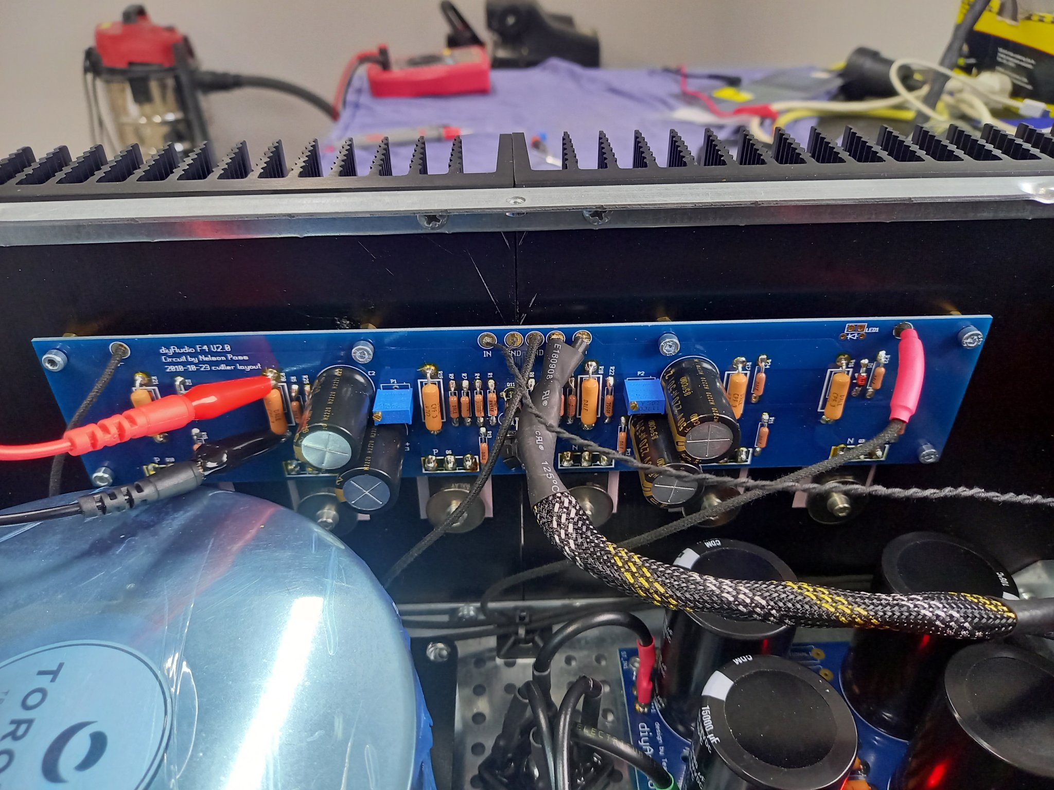

Shorted the inputs and adjusted voltage across R16 to 0.13v and let it cook for an hour. Readjusted to 0.2v, and offset to zero (+/- about 1.5mV), and let it cook for another hour with the cover on. Here’s the measurements across all of the source resistors after the last hour:
Left Right
R16 .206v .205v
R17 .215v .196v
R18 .221v .194v
R19 .201v .213v
R20 .235v .201v
R21 .205v .183v
Are these values acceptable? Would there be any benefit to making any changes?

count in triplets;
one N triplet, one P triplet per channel
if you're in 5% in triplet, perfect
if you're in 10% in triplet, still good
if you're in 15% in triplet, acceptable
more than 15%, think about tighter matching of mosfets

Thanks ZM. Unfortunately, it looks like the P triplet on the left channel is just outside of acceptable range.
(.235 + .201) / 2 = .218
.235 - .201 = .034
(.034 / .218) * 100 = 15.59%
Looks like I'll have to make some changes.

Triplet is 0.201, 0.205, 0.235. Average is 0.214.
0.235/0.214=1.10, or 10% high.
0.201/0.214=0.94, or 6% low.
So just within 10%.
At least that is my interpretation.
