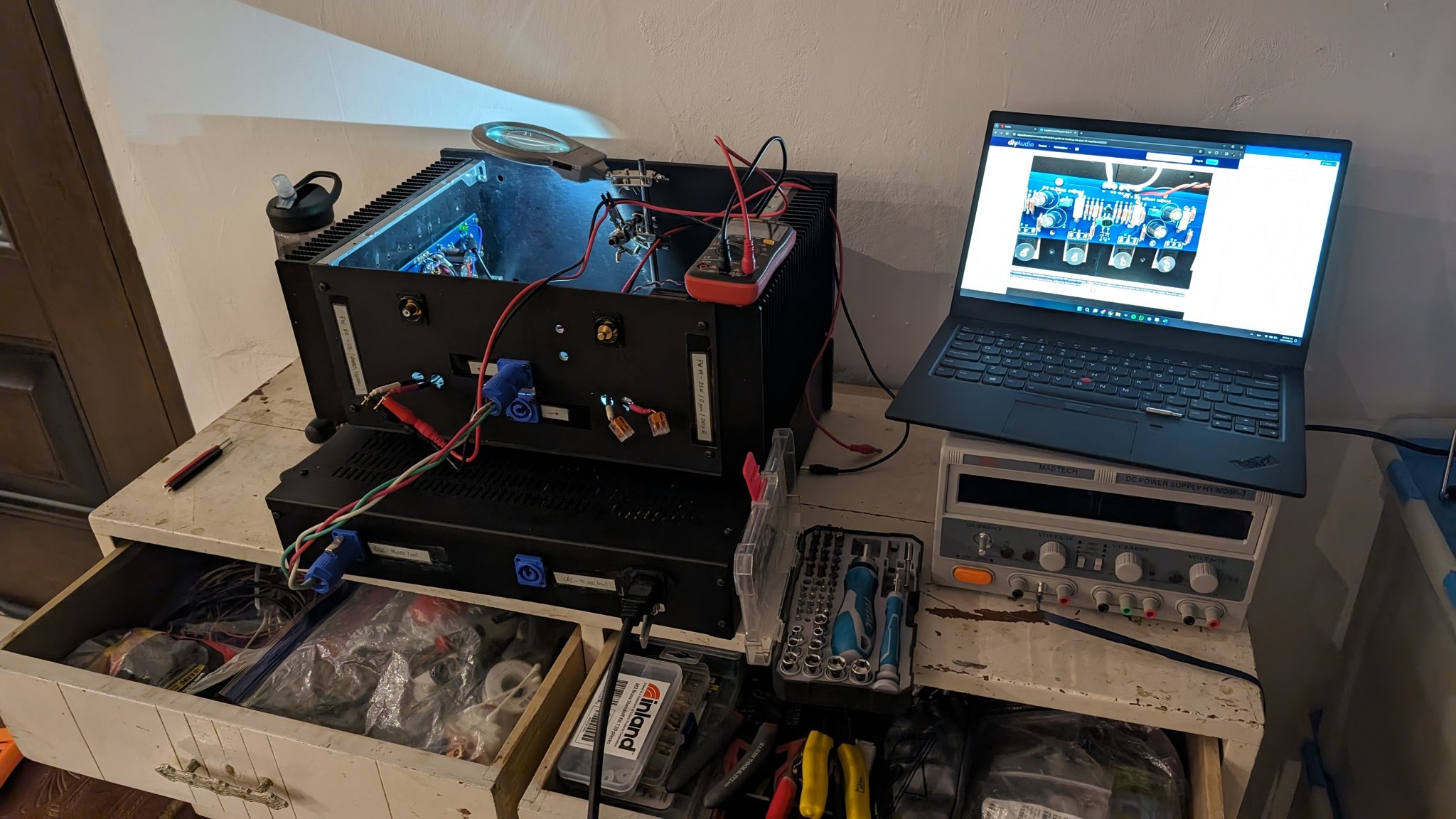

After three years in storage and a too-many-steps international moving process I finally have my stereo again and just started reviewing my F4 monoblocks to press them back into service.
Unfortunately one of the amps won't bias up correctly. I was following the procedure and had the bias sitting at .13v for an hour, didn't touch the offset because it was at .06v. I then moved the bias up to .300v and switched over to check the bias, only to find that turning P2 had no effect. After many turns (in both directions), I switched back to look at the offset and saw it reading .750v. I immediately killed the power and started cranking down P1. Now I'm gonna have to find the problem, but unfortunately lack any knowledge of where to start as I'm still at the legos stage.
Some further details...
1. I haven't had the fortitude to turn it back on, but I did notice when I killed the power that the heat sinks were not warm very warm... I thought they were warming up during the initial hour, but I'm running on fumes after trying to put an entire house together for 3 days straight and might have been mistaken. Maybe the mosfets never powered up.
2. I have monoblocks with external power supplies (there's only one channel in each box) and just attached the second amp to the power supply that was already in place from biasing up the first amp. Unfortunately there was still some charge in the capacitors. So it's possible that I fried something right then and there, although I was able to power it up and adjust the bias.
3. I did not smoke anything. No fumes at all throughout the process.
Any thoughts on where to start for troubleshooting would be greatly appreciated. Unfortunately I'm three years out of practice... and like I said, never really made it out of the lego stage back when I was in the thick of it.

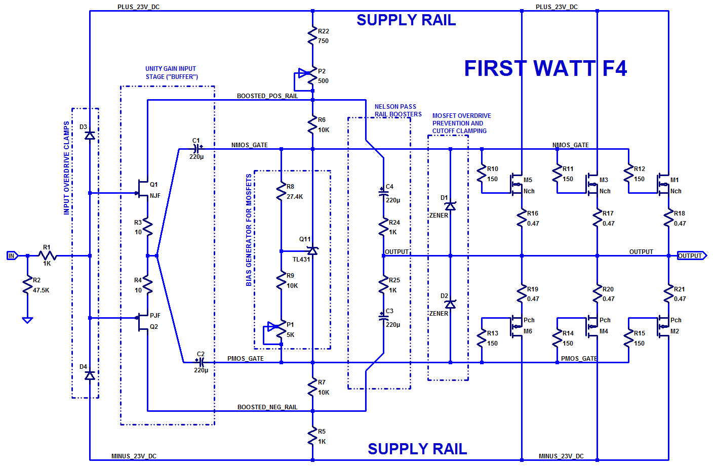

first confirm having both rails present at channel pcbs
then find your reference schematic, give us voltages across at least one source resistor, DC offset, voltage between upper and lower gates
+ rail = 24.5vfirst confirm having both rails present at channel pcbs
- rail = -25.1v
SR bias (adjusted via R1) = .15v
PMOS_gate (top of R15) - NMOS_gate (top of R11) = 8.5v
schm please
there are few variants and I don't like broken phones routine
also, Iq designation - either written as A, or "V across R" - that's proper
"bias" is governing voltage
And now it is warming up... and I was able to adjust the offset, although it was off by over 1v at the start (probably from all of my turning last night when it wouldn't move). Weird.
I'm going to let it cook for an hour and see what the status is.

Thanks, I meant, measured between the two gates accessing at the gate side resistor legs of R15 and R11. Using standard store boards.

now, simple logic sez this - if that same amp was proper operative prior to getting it to storage, it would be best to dismantle pcb and inspect all soldering points, redo what is suspicious and even more than just suspicious
taking same care as during initial assembly, put everything back, renewing thermal goo if there is
repeat setting procedure
if problem is solved, that was it
if not, we're going to troubleshoot ......... though - in most cases it's simple as replacing TL431 or just increasing R8 to first standard value or decreasing R9 to first standard value
reason - some TL431 are all equal ........ while some TL431 are even more equal
if your trimpots are common 270deg rotation type - be a Chicken as ZM, replace them with multiturns - much easier life for us not initiated in ABFAB Club

Agreed. It's heating up normally now. I think I'll repeat what I did yesterday just to see if I get the same result when trying to bias up to .350v, Then dismantle, and follow your advice. I don't want to just be waiting for it to blow one day, it's not so easy (or at least cheap) to get stuff shipped to Panamá. Hopefully all my screws hold up to the torsion.

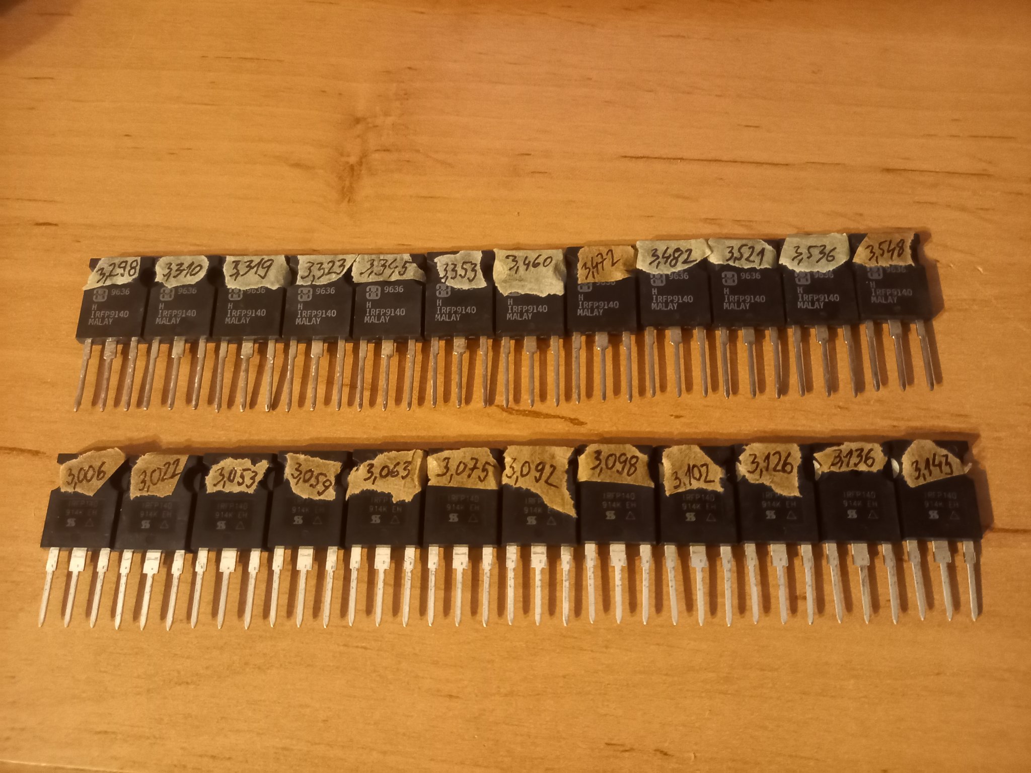

Using a method found on the internet
http://www.diamondstar.de/transistor_matching_mosfet.html
I tested my diyaudio store bought mosfets and got the following results.
How would you best distribute these p and n channels on four f4 boards (two monoblocs)?
just group them in triplets, per polarity
so, starting from left, count them by 3 and put aside
good thing is to remember - no need to pair them inter-polarity , meaning N to P
nor is important to choose them specially for channels in one amp
