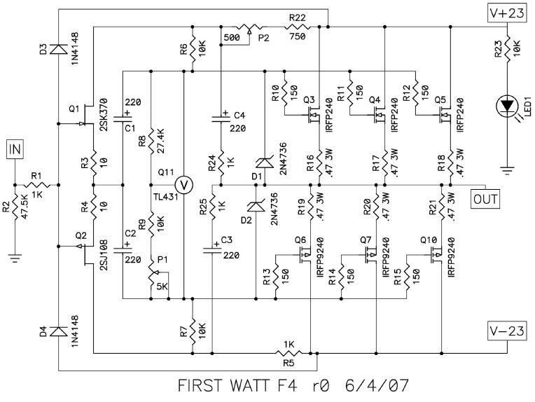

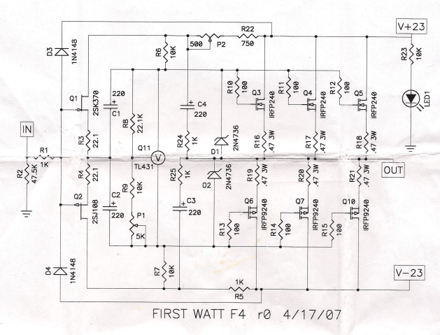

Peter's boards came with the attached schematics which came in an earlier version of the F4 document. The only typo I noticed was the part number for D1 and D2.
I didn't see any real difference between this and the schematics in post #1. (I only looked dquickly though.)
The current F4 manual has a slightly different schematics (source resistor value for the jfets and gate resistors for the mosfets), but nothing dramatic.
(https://www.firstwatt.com/pdf/prod_f4_man.pdf page 13)

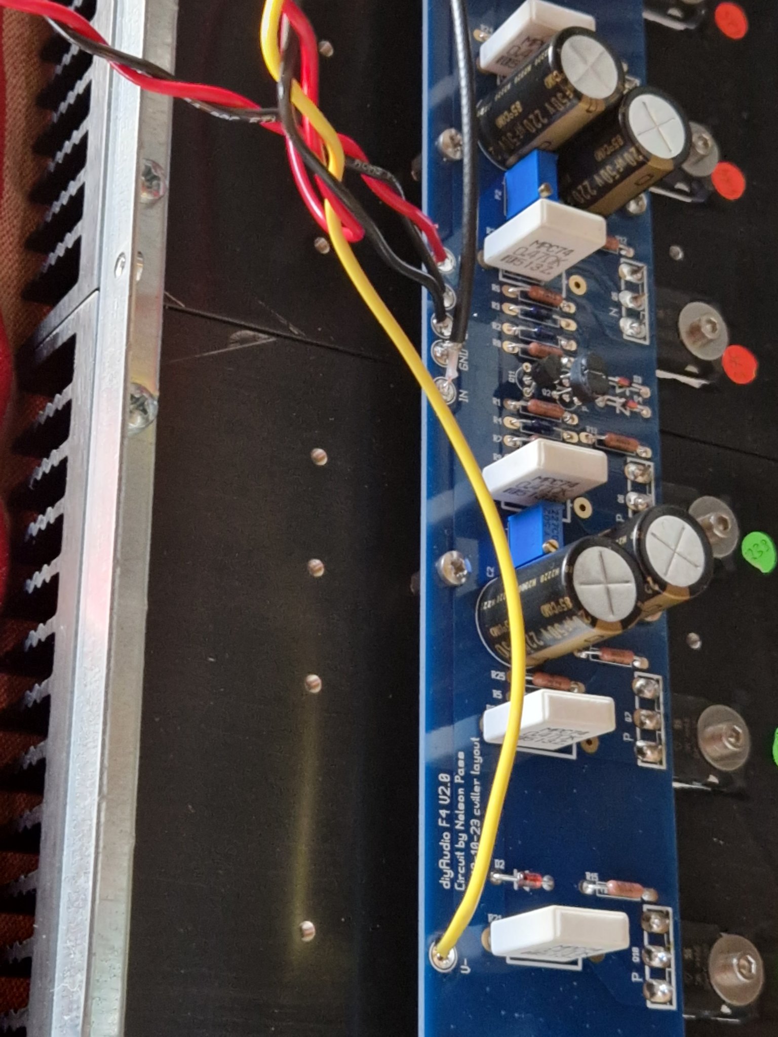

I got my F4 up and running today, temporarily lashed up. With 20V rails, 200mV across the source resistors and a 4U 400mm modushop case, I seem to have a fair bit of thermal headroom. Are there any downsides to cranking up the bias a bit more? I have 4ohm LS50 speakers.

F4, just like BA3, is 24vdc to 32vdc. @Extreme_Boky will be pushing thermal limits.

In addition to the thermal, one should consider the Vds of the jfets as well. With +/-32V rails and, say 7mA current through the jfets, even without an input signal, the jfets are at near 25V, which is what the 2sj74 is rated at. This will modulate with an input and can swing well into the 30s with a large-ish signal.
