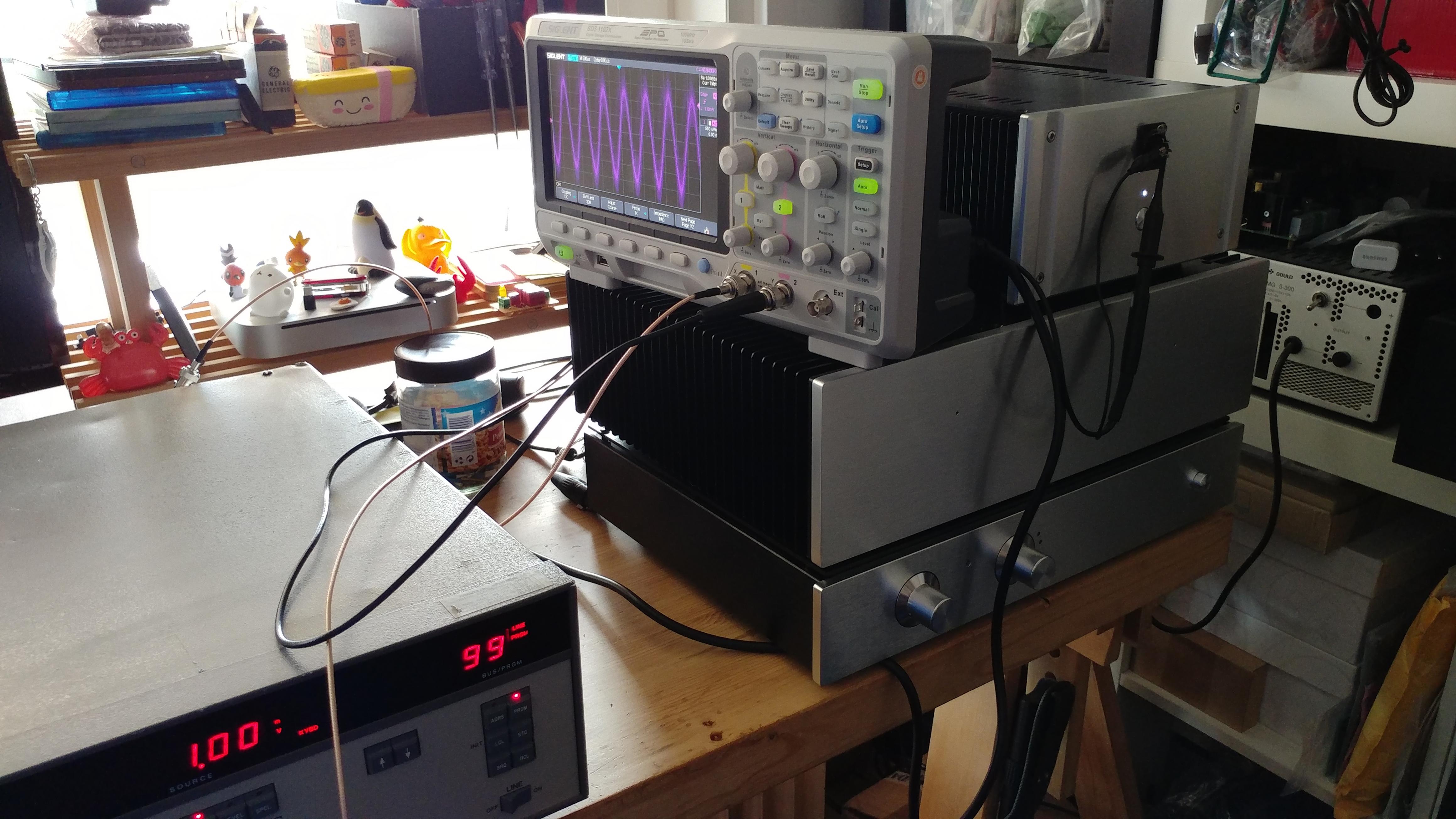

This past weekend I finally got around to finishing the F4 headamp build that I’ve had on my bench for several weeks now.
The PSU consists of a 150VA 2x15VAC toroidy transformer with a CCRC filter. There are 3x33000uF filter caps per polarity, R being a 1R wire wound bolted to the bottom plate. Supply voltage at the last C is a symmetrical +/-18V.
The amp is using a single pair of FQA12P20 and FQA19N20C output FETs with Vishay CPF3 0R22 source resistors. The output FETs’ bias is set at 0.5A (110mV over the source resistors). The input JFETS have an Idss of about 8.5mA, with the p-channel having a 5R degeneration resistor to match the j74’s transconductance to that of the k170’s (see 5th image). I had to use 7k5 for R9 to get the bias up to 0.5A. Output offset is around 1mV when warmed up. I have 15mV of cold output offset in my notes, but I have to check that again, it just seems too low.
The numbers:
(THD measured with Boonton 1121 analyzer with 0.0009% THD baseline, F4 unloaded output)
Vsupply=+/-18.01V
Ibias=0.5A (110mV over R22)
gain -0.46dB (1V in, 0.948V out)
noise about 50uV unloaded (purple trace 6th image)
1V input (0.948V out) @ 1kHz:
95.46dB S/N
94.92dB SINAD
-94.9dB THD, 0.0019%
3V input (2.847V out) @ 1kHz:
105.56dB S/N
93.97dB SINAD
-93.98dB THD, 0.002%
THD spectrum 2nd>3rd>4th, with 2nd around 10dB over 3rd
visible clipping at 14V input (1.213% THD), above 7V input 3rd order dominant
output impedance: 0.33 Ohm
unloaded V1=521.2mVrms @50Hz
8R2 loaded V2=500.5mV
Z=R*(V1/V2-1)=0.33R
There are countless reviews on the F4, so I’ll keep it short. Source is a soekris 1021 R2R DAC with a DCB1 output buffer. Surprisingly, there’s enough voltage swing for the HD800, with a few dB to spare.

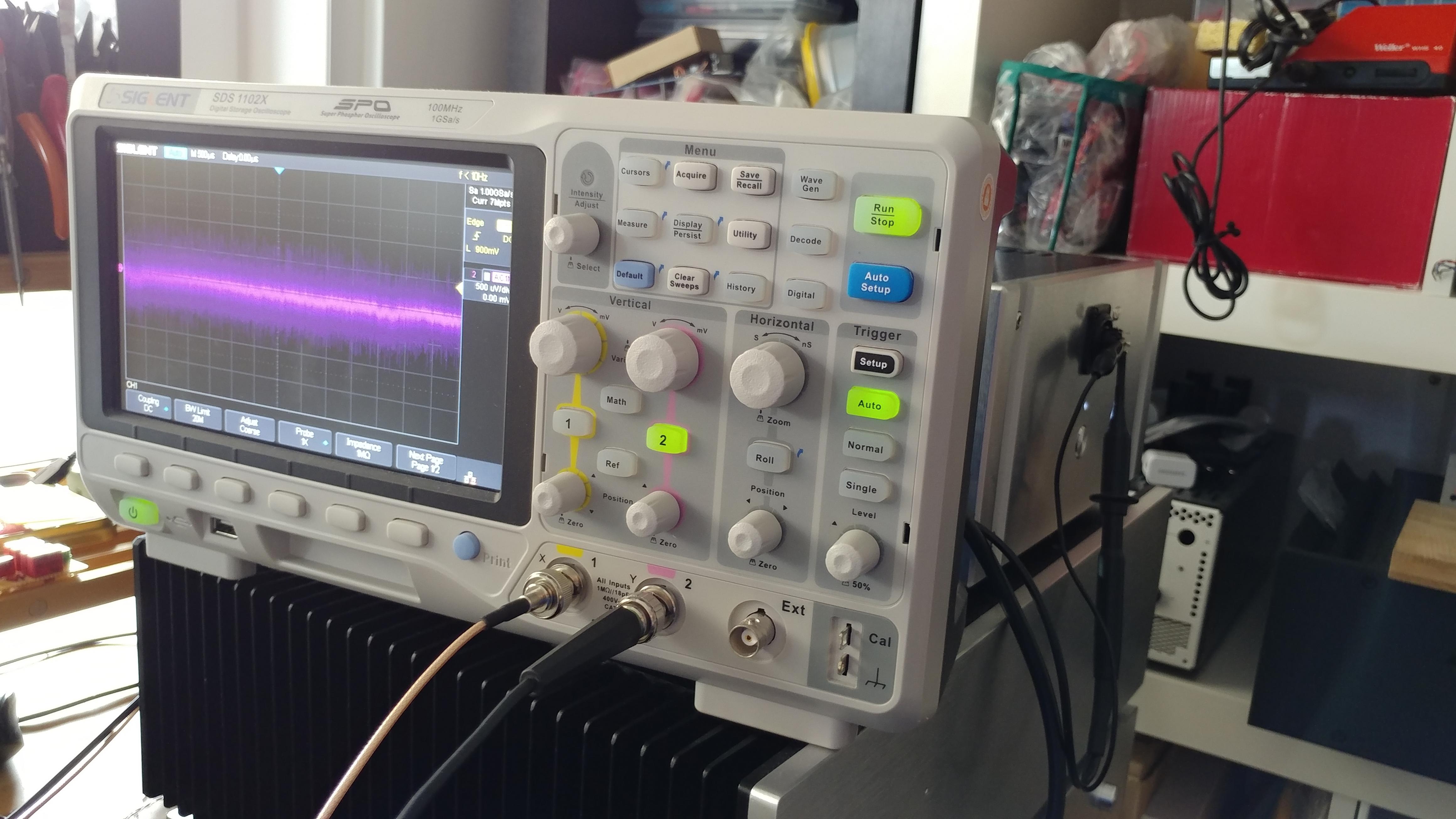

High noise?? This amp has one of the lowest noise floor out there, something like 50uV.
The first image attached shows the noise floor of the amp with unloaded output and the input floating. The vertical scale on the scope is 500uV (that's 0.5mV per division). The hash around the bright purple trace is scope amplifier noise. It's hardly measurable.
The second image attached is the unloaded output with a 1mV (rms, so like 1.4mV peak) signal at the input. Same 500uV scale.
With the HD800 the amp is dead quiet. It's impossible to tell whether it's on or not, of if the headphones are plugged in or not. What you can tell though is when the track that's being played is starting, because as soon as they turn up the controls on the mixing console in the studio, you will hear any faint amount of noise or creaking of chairs or ambient in the recording.
