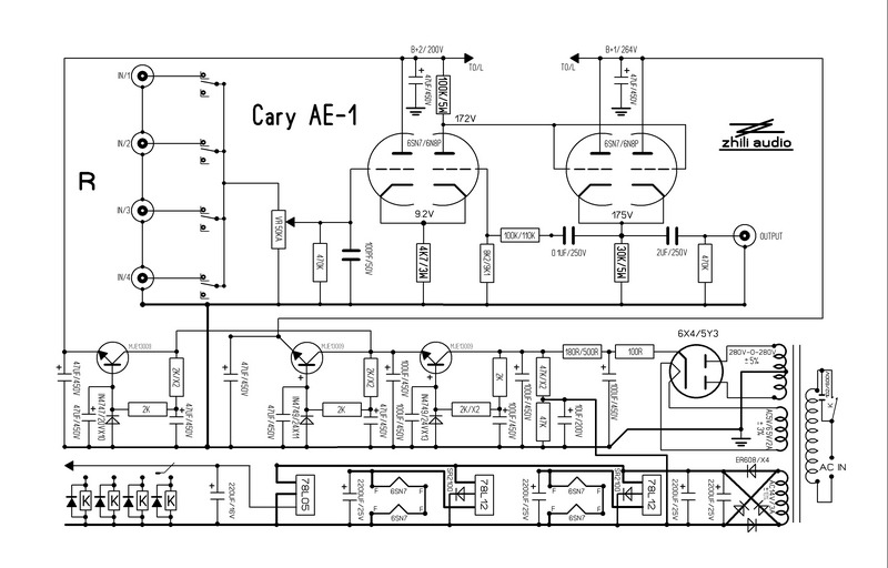

Has any of you coparisons with the CARY-AE1 circuit, using 6SN7? Is transposable to ECC82 . . .
I took a look at the CARY-AE1, in practice if I am not mistaken it matches in DC a common cathode amplifier with a cathode follower (via double triode), with the help of an amount of feedback to stabilize. It's correct? I didn't quite understand the role of C = 0.1uF, perhaps compensatory...

The C-0,1uF is the feedback cap to block residual DC coming from the kathode to G2.
The first tube is just a phase trick so the tube U2 is driven by the cathode. And seen from the input then the preamp does not do any phase reversal . . .

Let me see if I understand that correctly...
The first stage is a compound grounded grid amplifier with the first 6SN7 (V1) being a cathode follower driving the cathode as the input of the second 6SN7 (V2, grounded grid amplifier).
The third (V3) and fourth (V4) 6SN7 sections are paralleled and configured as a plain old cathode follower, operating at a fairly low plate current.
NFB is taken from the cathode of V3||V4 to the grid of V2.
Since V1/V2 doesn't have much gain, and V3||V4 is a cathode follower, there's probably not a whole lot of gain available for NFB from the cathodes of V3||V4 back to the grid of V2.
It looks like the PSU uses separate capacitor multipliers for V1/V2 and V3/V4.
I suppose this circuit could be implemented using 12AU7s, with the same parts values.

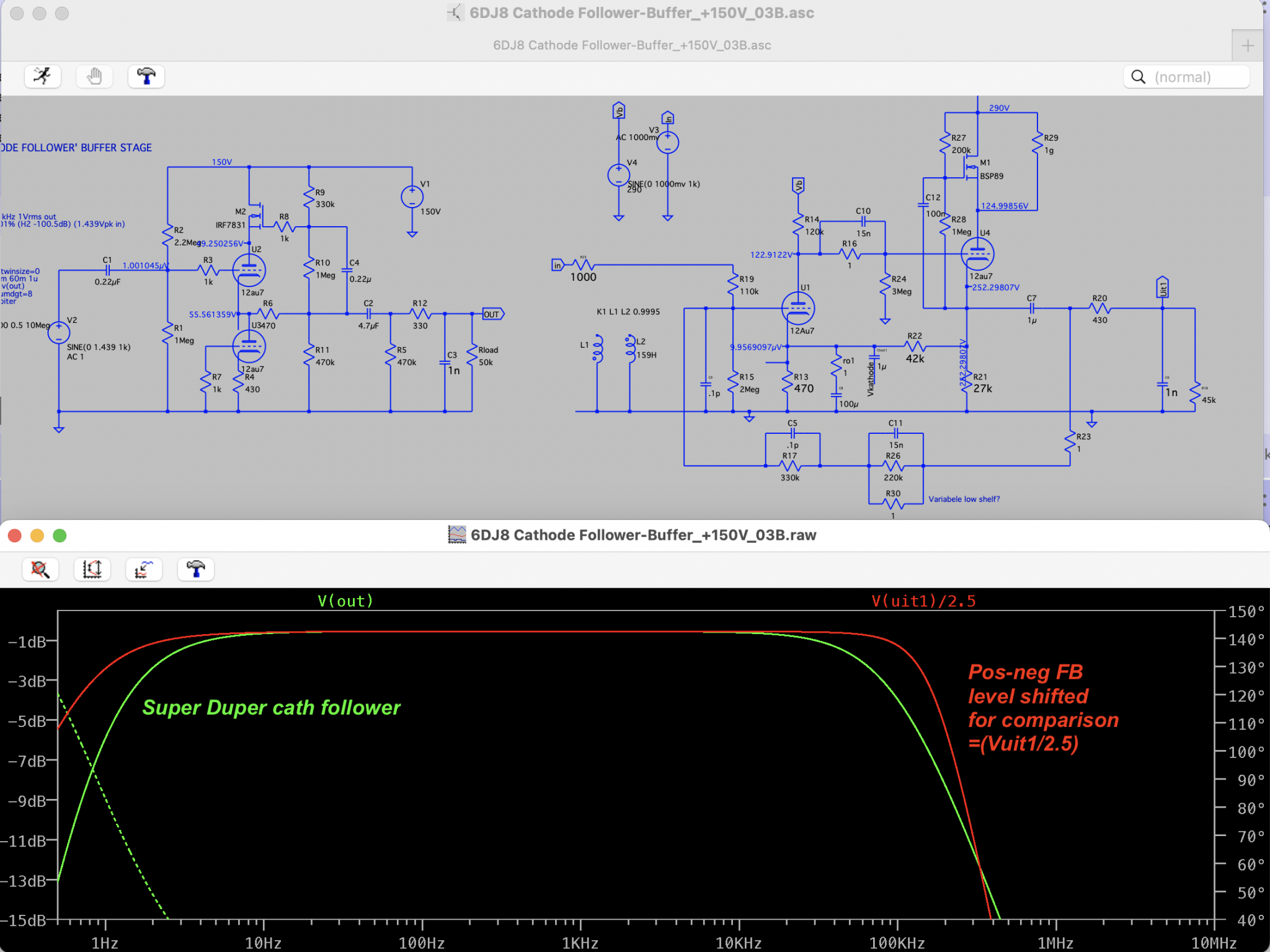

Thanks for that. Playing around with the fourth simulation, the CCS is a big improvement over resistor loaded source follower, but the upper mosfet (SLSF) actually makes it slightly worse compared to CCS loaded (similar results to those in post #195). All of them good compared to tubes though 😉
I compared the previous #67 (which I have running now) with the 6DJ8 Cathode Follower-Buffer_+150V_03B - the Super Linear Cathode Follower. For comparison, I shifted the output line by dividing it in LTSpice. Both loaded with 1 nF. [I shorted the constant voltage source with R=1 ohm, so what is in the picture is not in the sim, for your comprehension]
