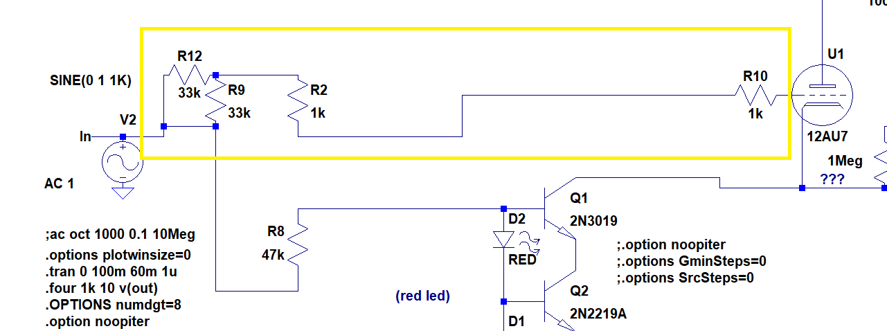

Hey indaco,
I re-drew your schematic into my LTspice installation, using the models I have installed on my system.
After some problems with the way my standard.bjt file was formatted, I got the simulation to run.
First, can you tell me what the purpose is of the resistor network composed of R12, R9, R2, and R10?
It looks to me like R8 (47k) comes right off the signal source, feeding straight into the base of Q1.
Then R12 and R9 are two 33k resistors in parallel, making 16.5k ohms.
From there, R2 is a 1k resistor in series with R12||R9, and then R10 is in series with all of that, connecting to the grid of U1 (the 12AU7).
That basically makes an 18.5k resistors in series between the signal source and the grid of U1.
Why?
I simplified all that into a single 18k grid stopper for U1. The end result looks like this:
Does that look right to you?

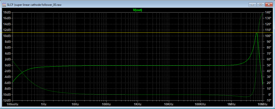

I simulated that circuit, and I get a huge oscillation at well over 5MHz. (Notice that I ran the .ac AC analysis with a 10MHz bandwidth so I could see the oscillation.)
The FFT simulation is taking a really really long time to finish. Something's not right.

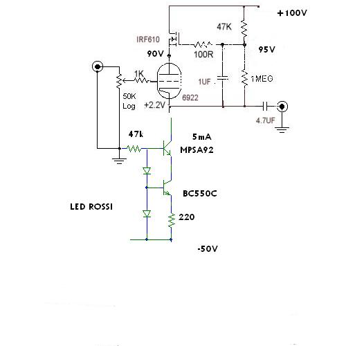

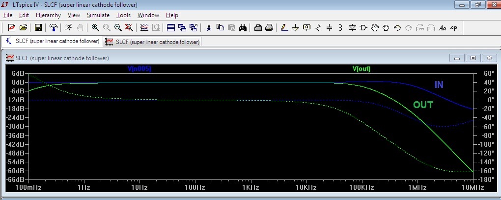

Hello Rongon,
in reality I copied the diagram from a forum ... there was a potentiometer (50k) at the input for which I inserted a resistive divider at 50% (even if I don't see its usefulness, being a buffer). Instead the other value I inserted it was by mistake.
My simulation hadn't problems of long-time run...have you set all parameters in proper way?
Anyway basically you obtained about my same results, with the pitch in the HF range (3.3MHz). I noticed this may be tamed through a small bypass capacitor (1-10nF) on R6 (above the mosfet on the bootstrapped triode). E.g. with 3.3nF, THD improved further a little bit.
Here's the plot after this modification.

When you tried to mimic the volume control, you didn't do it correctly. The volume control should be a voltage divider, with one series resistor (R1 in the circuit below) and one shunt resistor (R2).
The reason my simulation wouldn't render was because I was running the .trans directive to measure THD. LTspice dutifully rendered the oscillation on the waveform, which takes a lot of processing time.

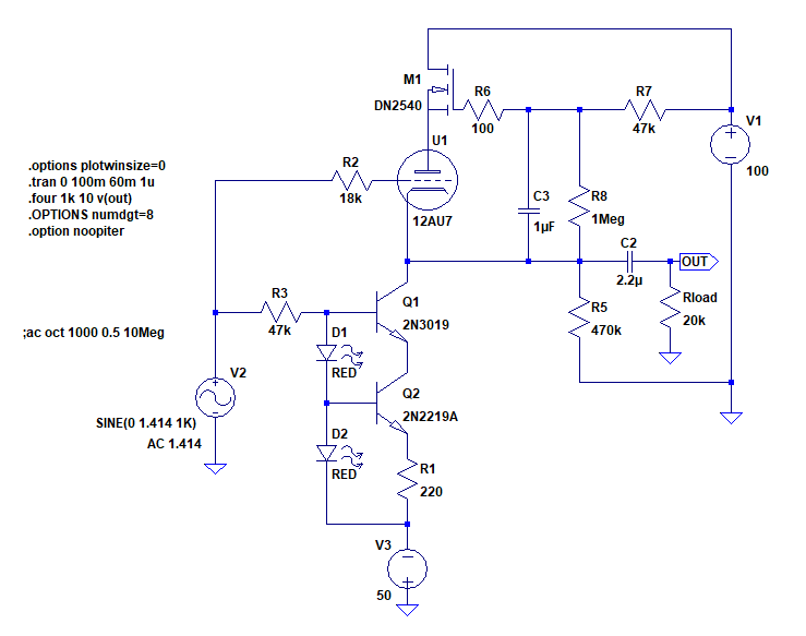

The FET is there to ensure that the voltage across the triode is constant. Since the triode has a constant voltage across it and a constant current through it - it operates in its most linear way. The SLCF was developed by one of the big tech companies to present a stable load to the front end of an oscilloscope and a very linear drive to the screen tube.
R3 must go to ground, not to the input 😳Oscillate at around 5MHz, apparently.
Mona
Indeed, if that is a sink circuit it's as you say...I realized that I have incorrectly copied the schematic regardless (then the simulation fooled me).
I think there must be more wrong than just that. I ran an AC analysis and it still has a +13dB spike at ca. 6.5MHz.R3 must go to ground, not to the input 😳
Mona
I found that if I raise the value of the gate stopper on the DN2540 to 22k ohms or more, that kills the oscillation.
Perhaps the DN2540 is not the best part to use as the plate constant voltage source. Maybe DN2540 has too high gate capacitance or Crss?
Maybe. I substituted an STN3N45 MOSFET in the plate of the 12AU7 and the oscillation went away.
I think the problem with the DN2540 was that the B+ of 100V was too low for it. It was only dropping 10V drain to source. I find that device wants 50Vds, at least.
I raised the B+ to 150V and now the DN2540 works.
I ran a transient response on this and it shows THD with 1V rms out at 0.0155%. It's all H2. That's half the THD of a plain old 12AU7 cathode follower with a resistor cathode load. Still, the 12AU7 Bootstrapped Pair with shunt NFB shows lower THD and gives you adjustable gain, and uses no transistors.

I think I found another mistake in the schematic for the SLCF...
MPSA92 is a PNP transistor, but is shown as an NPN.
I put an MPSA92 in as the top transistor in the 12AU7 cathode (on top of the BC550) and the circuit's not working.
I think MPSA92 is the wrong part there. That has to be a mistake.
A 2N3019 works as the top transistor.
Now that I have this SLCF simulation working, I tried it with a 6DJ8. It works far better with that tube (higher gm, higher mu than 12AU7).
With a 6DJ8 the THD is below 0.005%.
With a 12AU7 THD is 3x higher (0.015%).
I would expect THD to be somewhat higher in real life, in both cases.
