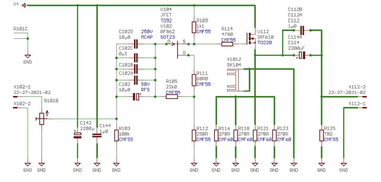

If you don’t have genuine IRF610’s it is possible that they can fry out and die shorted out, which is why the voltage went up. 3-4v drop is normal for a mosfet cap Mx.
Another trick is use a 19v laptop supply and skip the cap Mx. Just use a CLC filter. 470uF and 1mH 470uF with 50ohm in parallel with the 1mH.
If you got them from Mouser they are real. Sometimes you can fry them with static discharge. Discharge your hands or wear anti static wrist straps before touching them. It is winter and dry air and wool or fleece sweaters make lots of static.
An ohm meter between any two pins of a MOSFET should measure more than 10kohms. Single digit ohms means it is fried and short circuited.

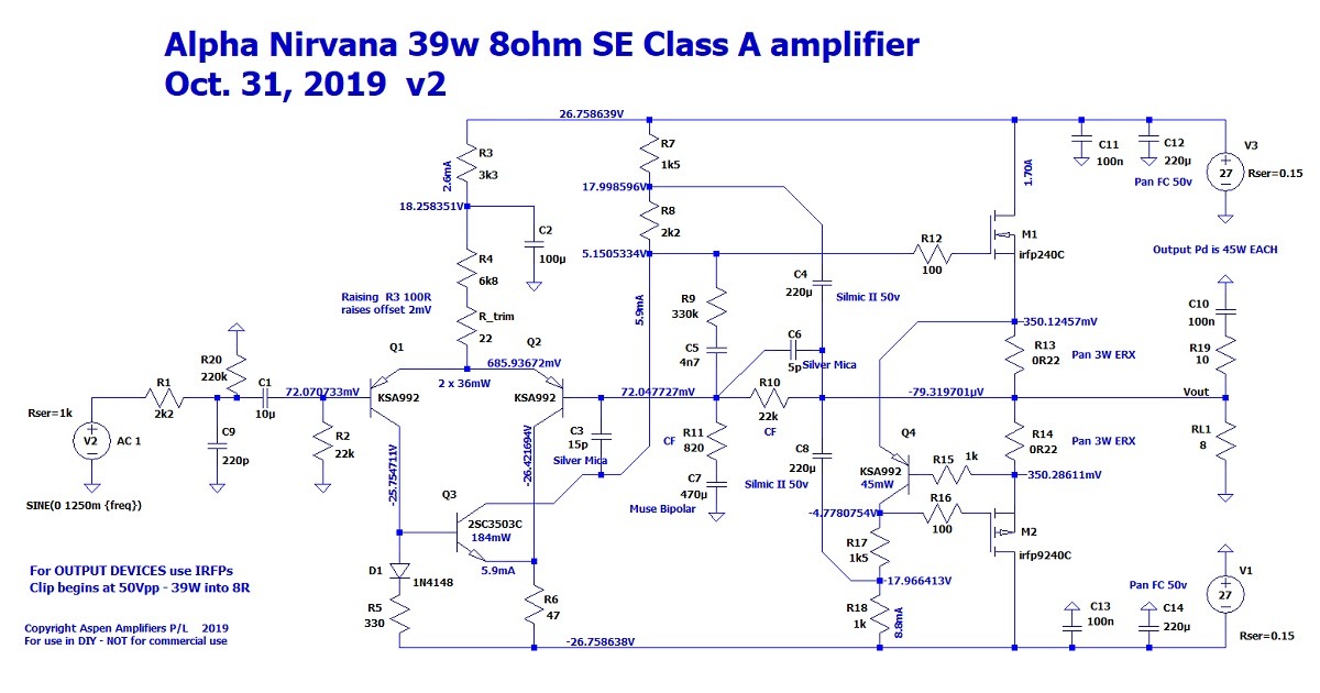

4W SE Class-A by Lineup

Lineups circuit can be lower in gain with really good THD values but well, it already has 7 transistors.

Thanks xrk971. I tried lineups amp which rellay is a beautiful thing that measures well. The Pass follower is built on perfboard and will be tried soon.

Thanks, X. Yeah, I wear a grounded wrist strap and I placed the gate resistor first on my pcb before the mosfet. I'll check for a short but my best guess is that I had a brain fart and forgot my wrist strap at some point. Also, I had the brick plugged in first, then plugged it into the DC jack while it was hot, so not sure if the 'instant on' killed the mosfet. I should probably plug in the DC side first, then the AC side. 🤷‍♂️
The BF862/IRF610 is simple, but proving a little tricky to get working. The cap multiplier did have a fried IRF610. A replacement got that working just fine and I had one channel that is working to spec. The voltages measured are really close to the sim with the cap multiplier providing 19.8V.
However, I've built 2 additional channels that are proving to be a puzzle. On both, the voltage measured at the IRF610 source pin is around 9.8 volts. The voltage at the drain pin of the BF862 is 14V, and around 1.2 V at the gate of the jfet. I'm thinking the jfets aren't working to spec on these 2 boards like it is on the first board. I should take a closer look at these jfets to make sure they are within spec. X, does that sound like a reasonable approach? This is my first trip in working with discretes. I'm used to plugging in opamps most of the time.

  3. Resistor values: 1k1 (tied to positive rail) and 47 ohms (to IRF610 gate) connected to the drain of the BF862. Source has a 68 ohm in series with a 250 ohm resistor that is then tied to ground. There is a 22k resistor connected to the gate and which is then connected at the 68 ohm/250 ohm node junction.

Please take a few closeup photos from different angles so that I can see what the PCB looks like or is this a P2P board? It’s a very simple circuit and if you are getting strange results it’s usually a cold solder joint or a part is way off. It might help if you posted questions in the actual thread. We can look at the schematics.
Just to confirm, this is the amp we are talking about right?
Check for a cold solder joint at R111 and R112 above. If no current flows, you won’t get the correct gate bias voltage at the MOSFET. The gate should be about 5v below drain. So for 20v drain, around 15v.

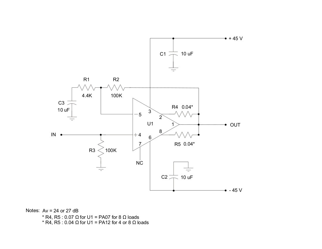

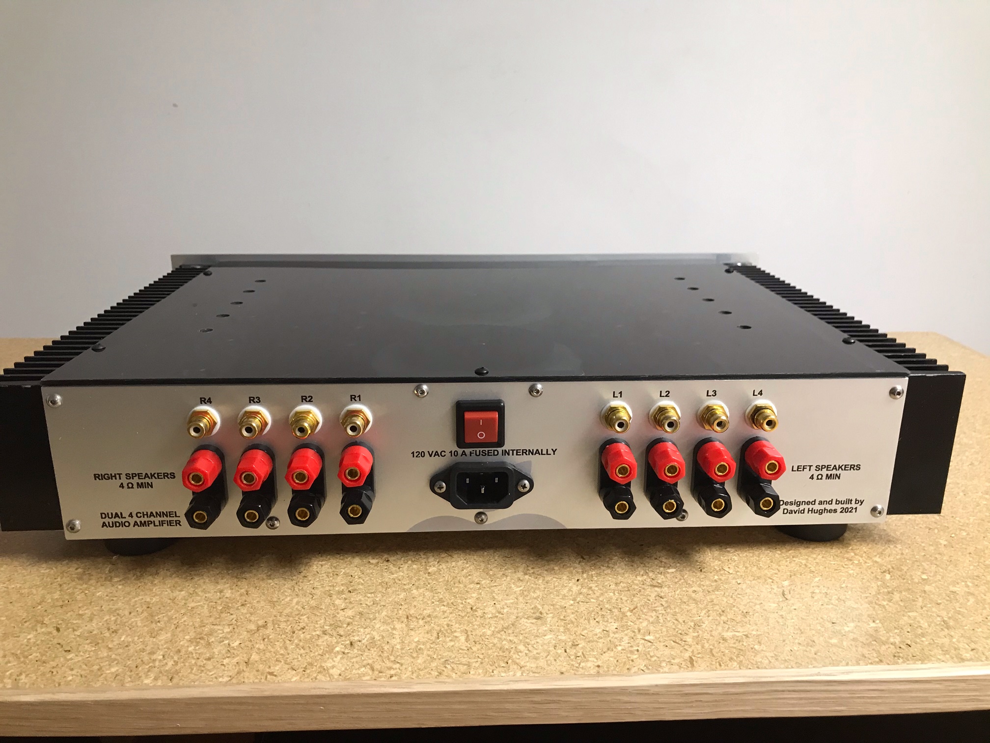

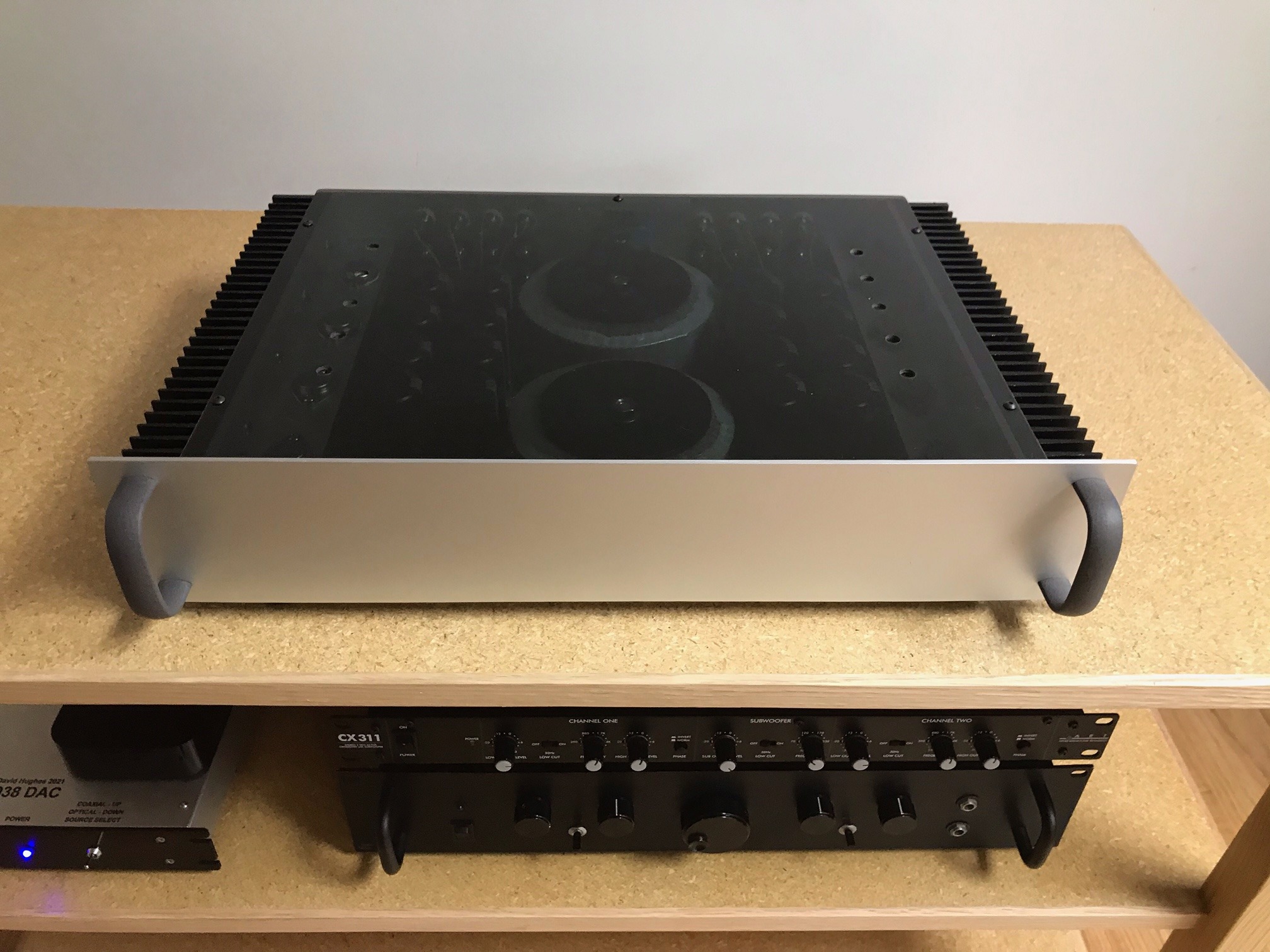

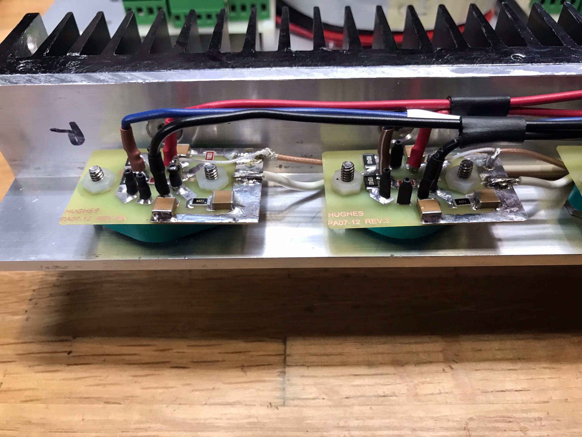

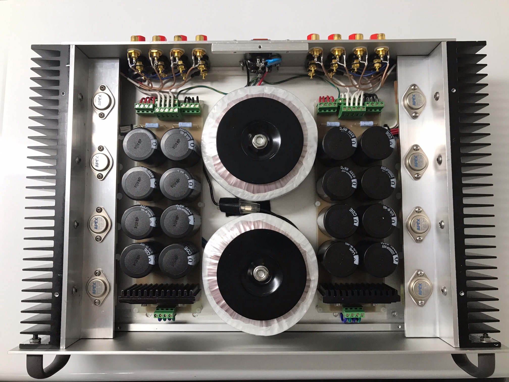

OK, here's one based on the Apex Microtechnology PA12 power op-amp. Nine components including the PA12 chip, eleven if you count the socket and pcb. Nothing special in the design, just a basic op-amp circuit, pure and simple. The board measures 30 mm x 50 mm. This puts out 75 wrms into 8 ohms and 125 wrms into 4 ohms, per channel. I put 8 together in one 2 RU chassis with 2 power supplies for a dual 4 channel amp to run an active x-over system. Sounds good.
