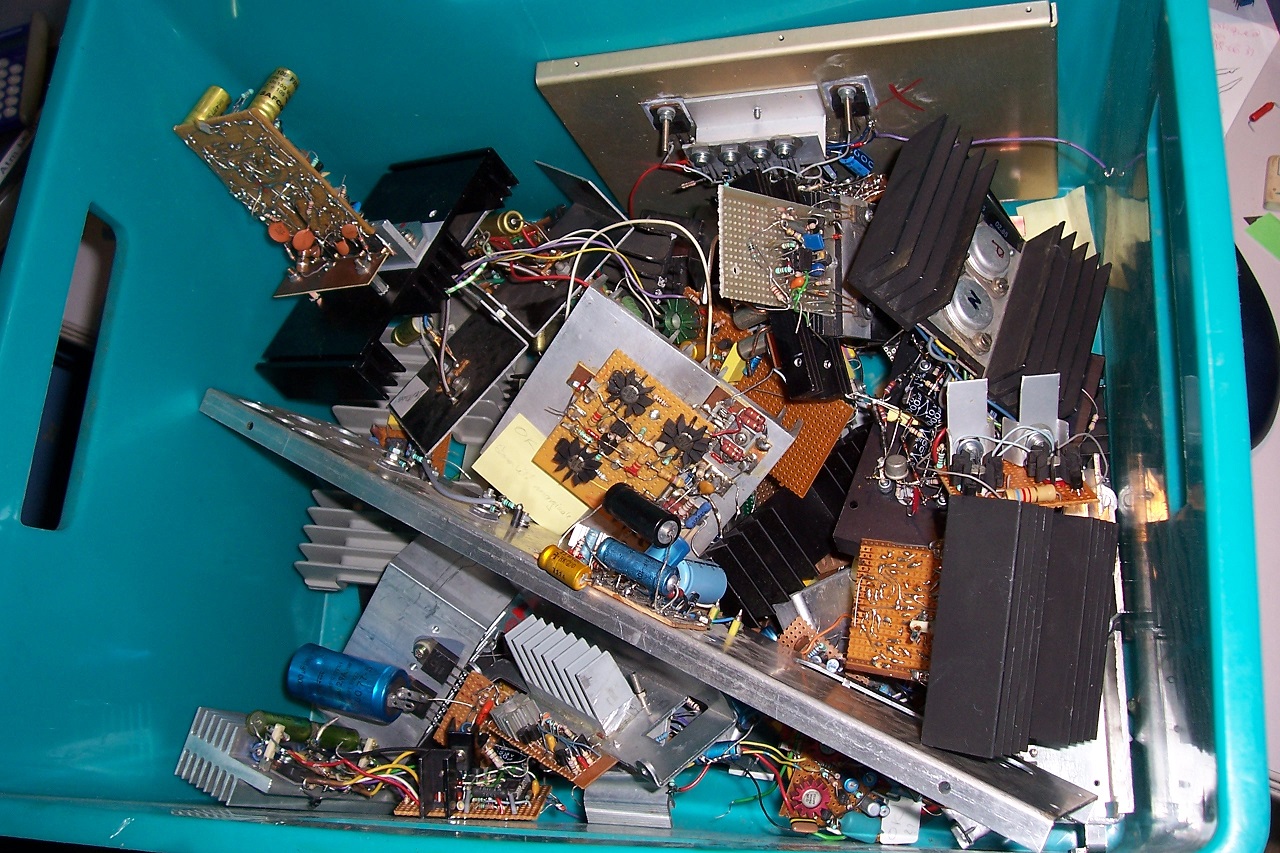

A dive into the past

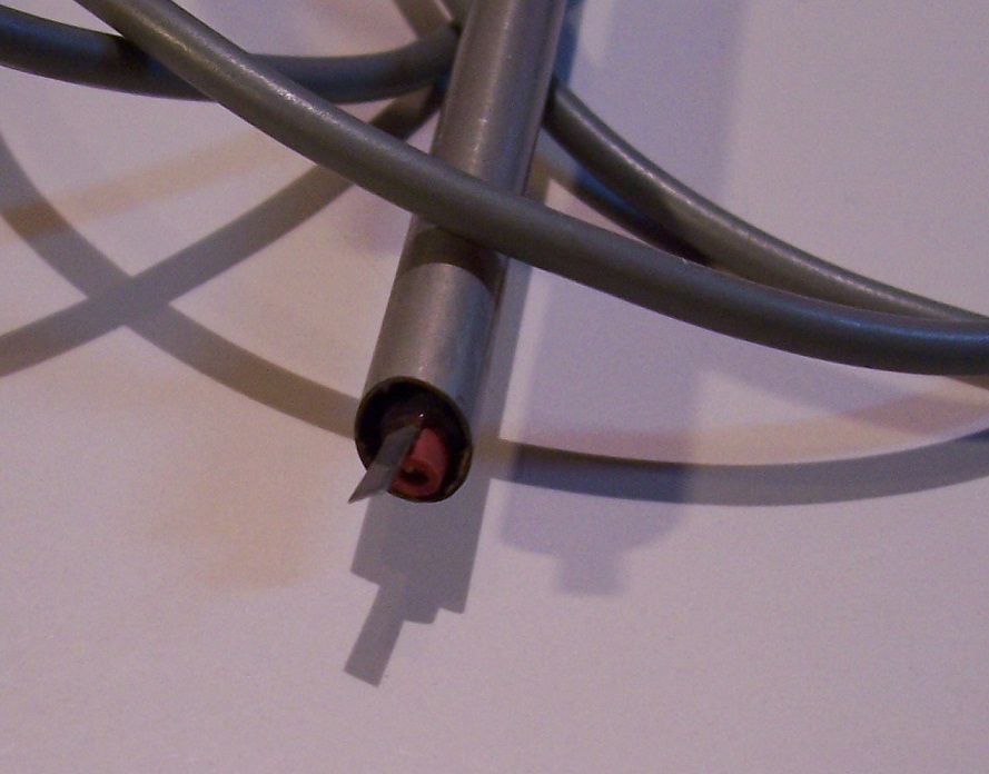

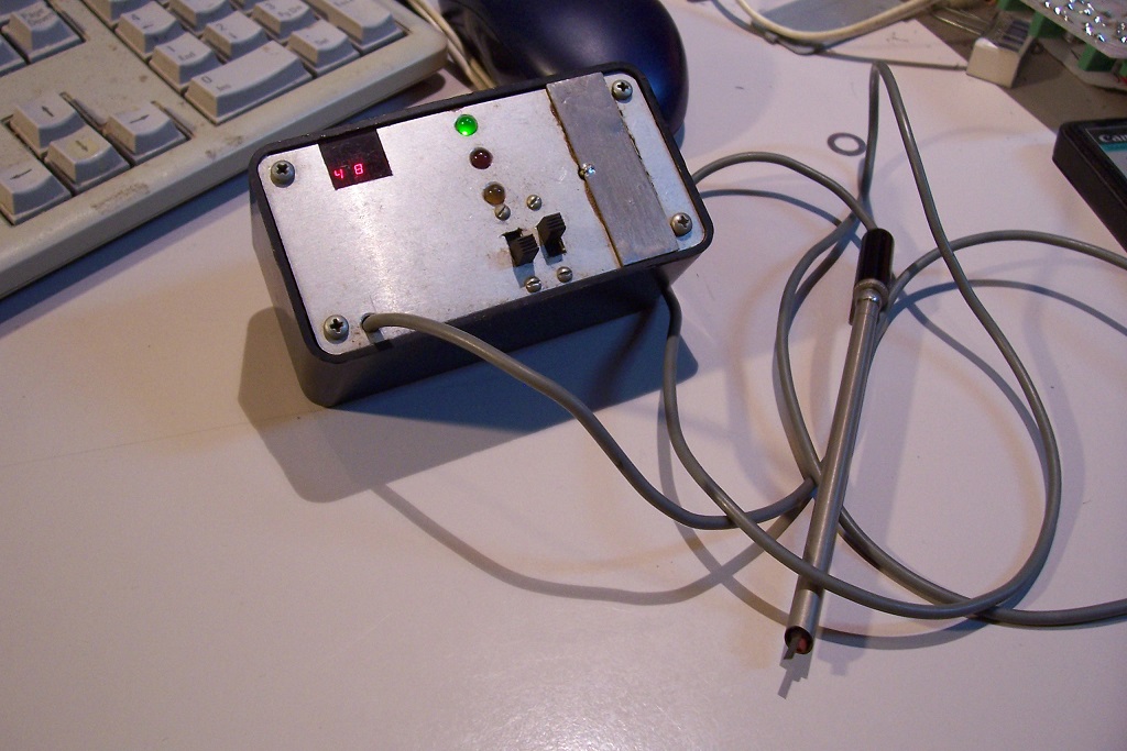

Mystery device:
With battery power and a touch pad, it probably compares a human, assumed as 0v to *something else* and discovers the differential (and also the location)?
It is mains-powered in fact, mainly because of the power-hungry MAN's-display, but it could as well be battery operated without changing the function
A tracer? A bug sweeper?
No, and no

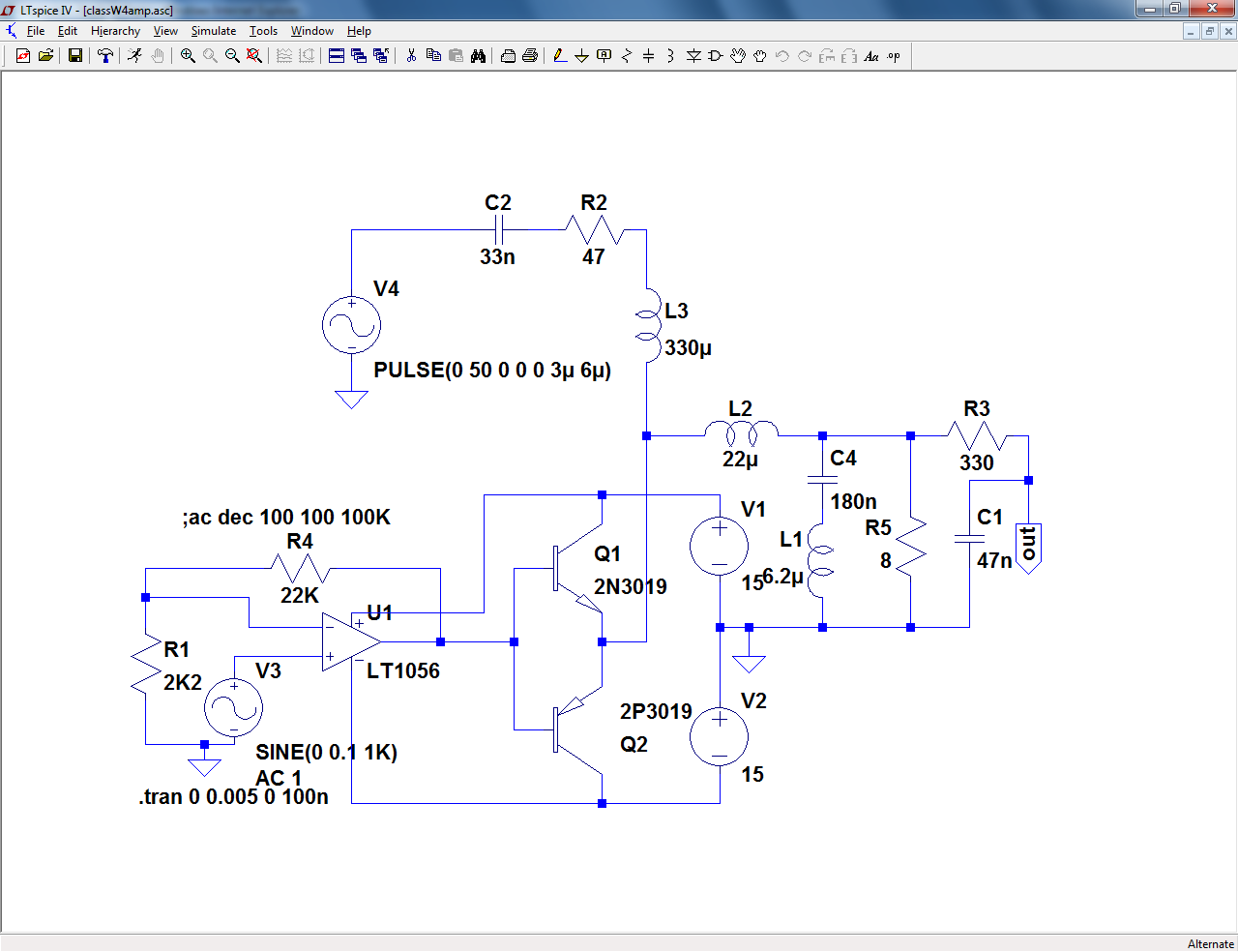

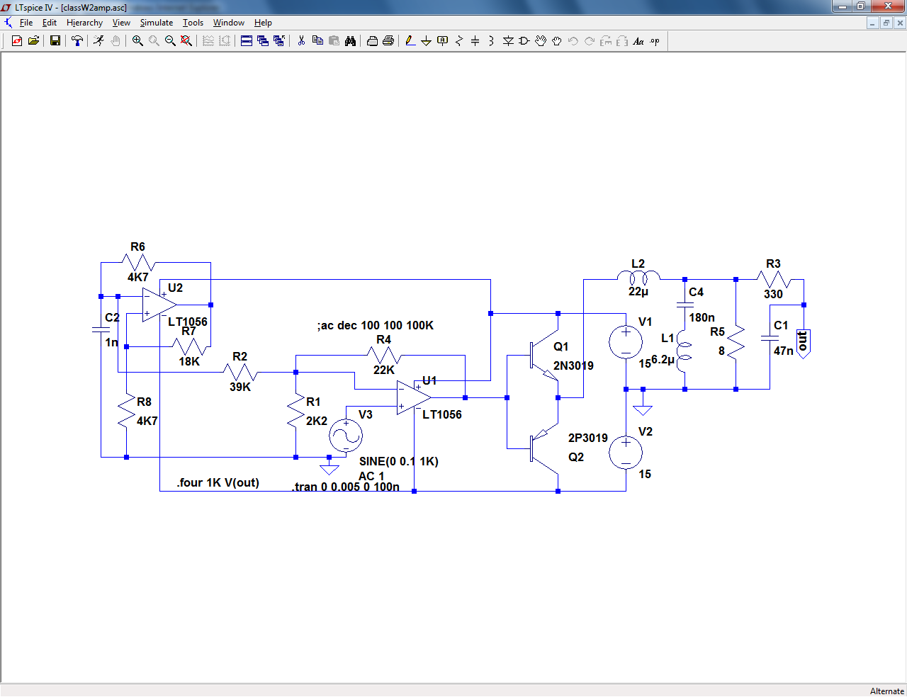

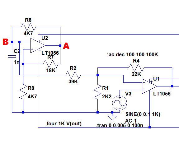

Instable device:
Flip the op amp to inverting? That's my only guess. Starting with an op-amp and then following it with a complexity doesn't make sense visually. Generally speaking, op-amps are for shortcuts and that one sure didn't. Is it a nesting arrangement or howland?
Apparently, the opamps are not in the signal path, they control bias voltages, and flipping them would result in latchup.
The amp itself seems to be only inverting

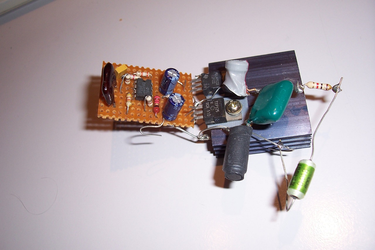

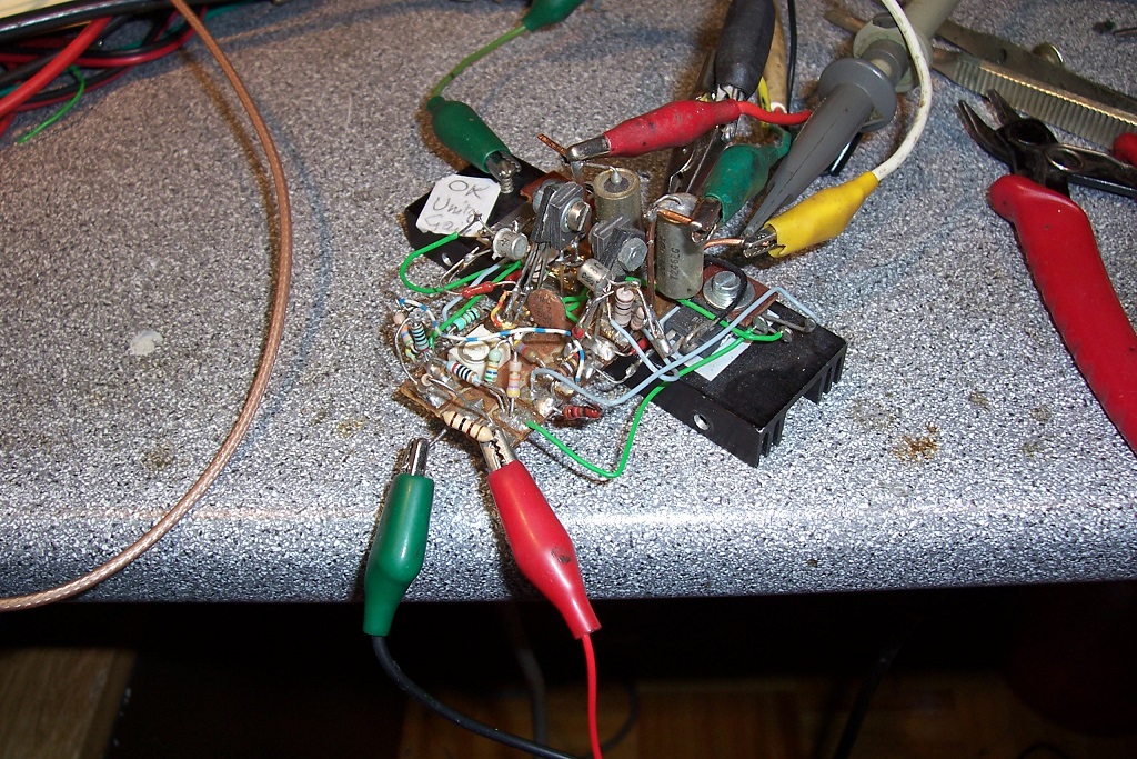

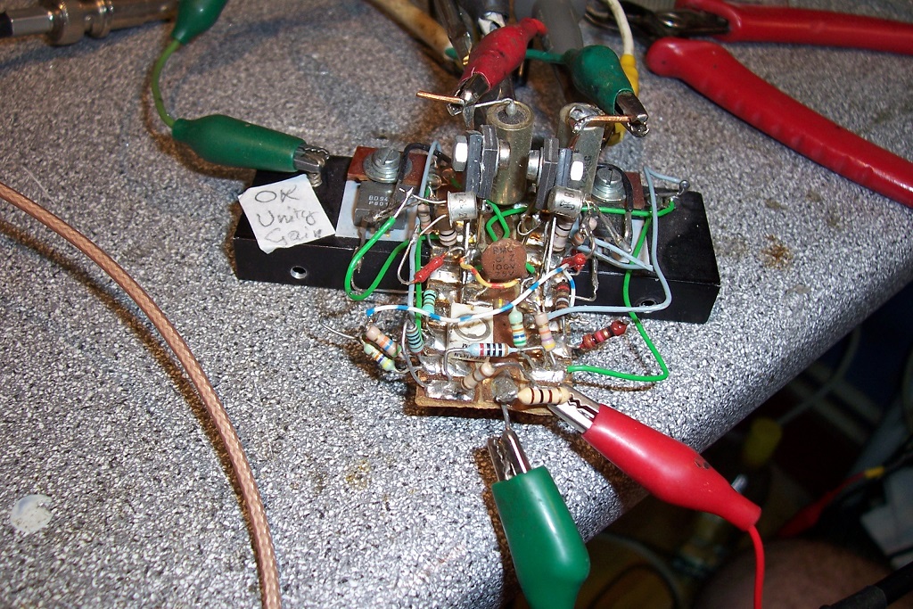

Yet another "fossil": this one is labelled "stabilité marginale", and that is indeed the case: when loaded with 3 ohm, part of the lower half-wave is festooned with VHF oscillation.
Easy to fix apparently: I probably didn't try hard enough the last time, an additional comp cap does the trick.

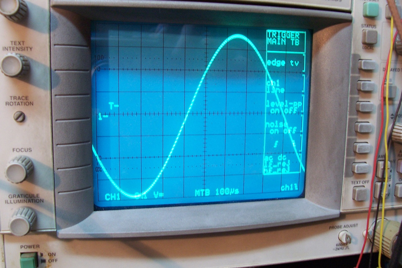

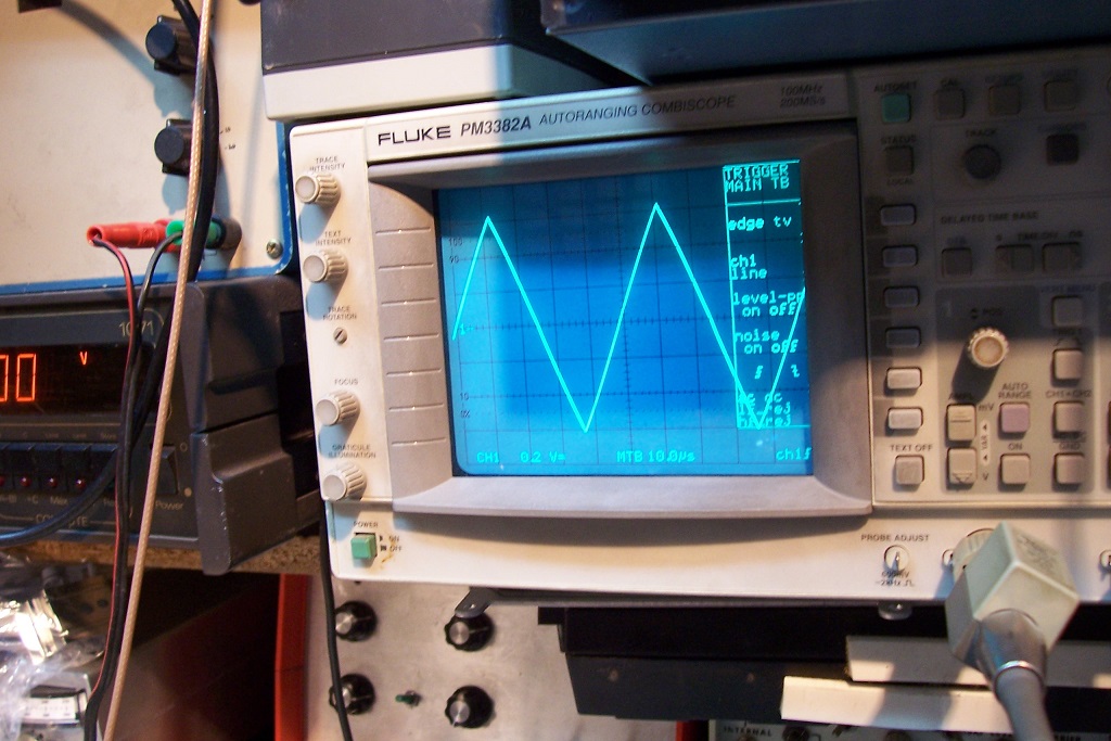

This one is really wideband: it uses paralleled BDX37's as OP, and it does give results: see the oscillogram (it is a 200KHz triangle, and the apparent defects near the top are not caused by the amp), measured on a 3 ohm load

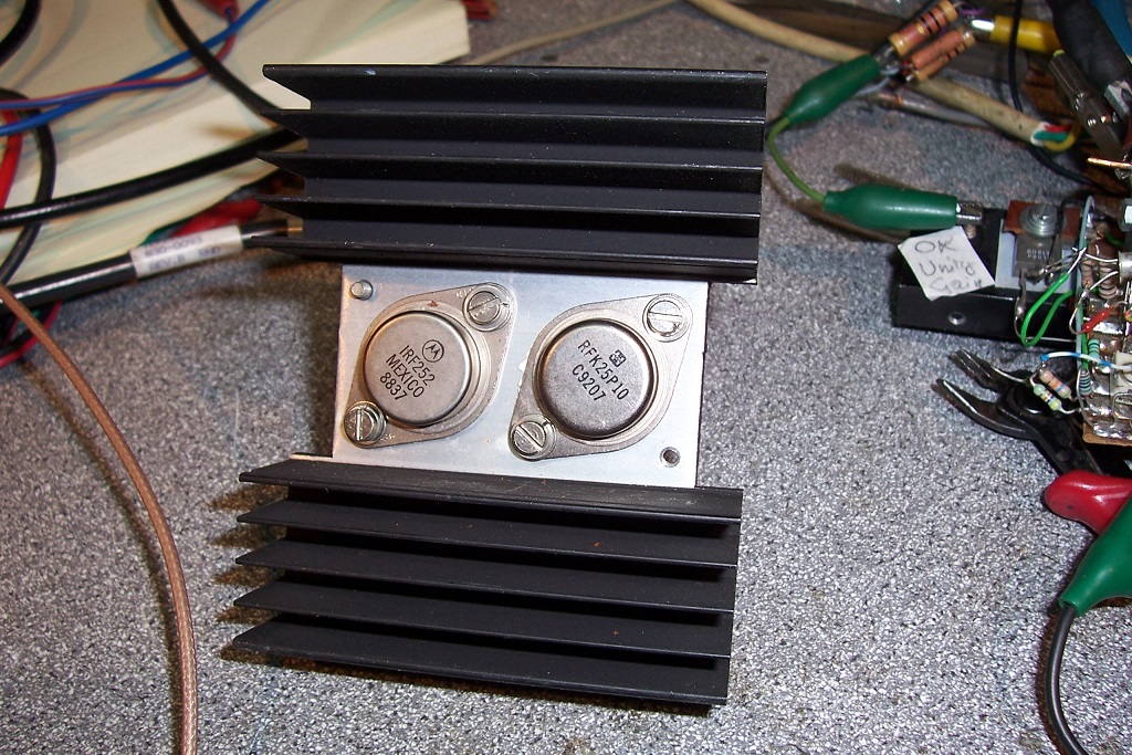

I just use this thang. I added a 4.7uF little green Nichicon ES bypass cap over that thing to pass the hf around it. Anyway, that outfit goes series to the speaker (series to groundside, speaker return, if a split rail amp). Its really good for a test speaker. Can put it at the speaker cabinet so that the amp is driving first the cable.
