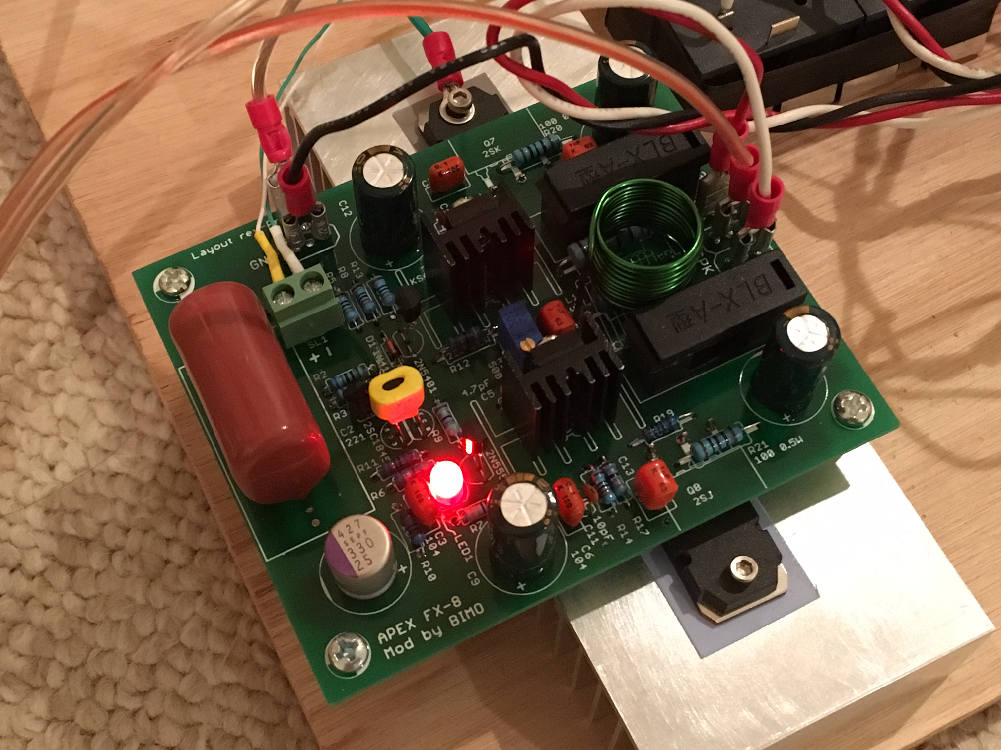

Just an update on the FX8 Bimo mod layout by Prasi. I finished the second board and now listening in stereo. Sounds great with a transient perfect FAST speaker. Very low distortion and snappy right sound.
http://www.diyaudio.com/forums/soli...imate-fidelity-amplifier-775.html#post4755887
First sound test - fired right up without a hitch. The default pot setting gave a 1.75amp quiescent current (talk about class A 🙂) and I quickly adjusted down to 175mA. Sounds great and this layout is a pleasure to build. You do need some non E6 values of resistors though: 820R and 33R had to be specially ordered for this project.

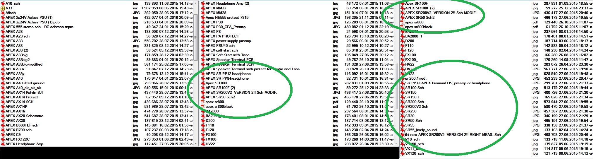

SR thread starts here:
http://www.diyaudio.com/forums/solid-state/173462-studio-reference-amplifier.html
Some of them have been listed some posts above, as marked in the attached picture.
