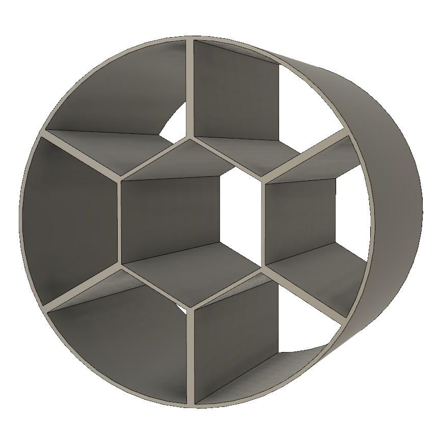

Some years back I was at a friends shop and listening room and we were working with some Altec 15" coaxes that were missing their horns. Someone there said he could 3D print news horns. I said "Great, can we do a soccer ball pattern?" He said to send him the drawing, which I did, but never heard back. I don't know if they got printed or or even modeled.
Fast forward about 12 years and I now have a 3D printer and can bash and thrash my way thru drawing in Fusion 360. So I jumped in. What would they look like? I have some renderings to show, and am printing some tests at the moment. The geometry was much more complex to draw than I anticipated, and my limited skills didn't help. But here they are.
The reason for the truncated icosahedron (football) shape is that the pentagon and hexagon fit together so well on the surface of a sphere, no gaps. This shape also makes it easy to do a "sort of" round multi-cell horn. I have drawn some other shapes - all hexagons, circle in the middle with arcs around the edge and some others, but the soccer ball shape looks the coolest. 🙂

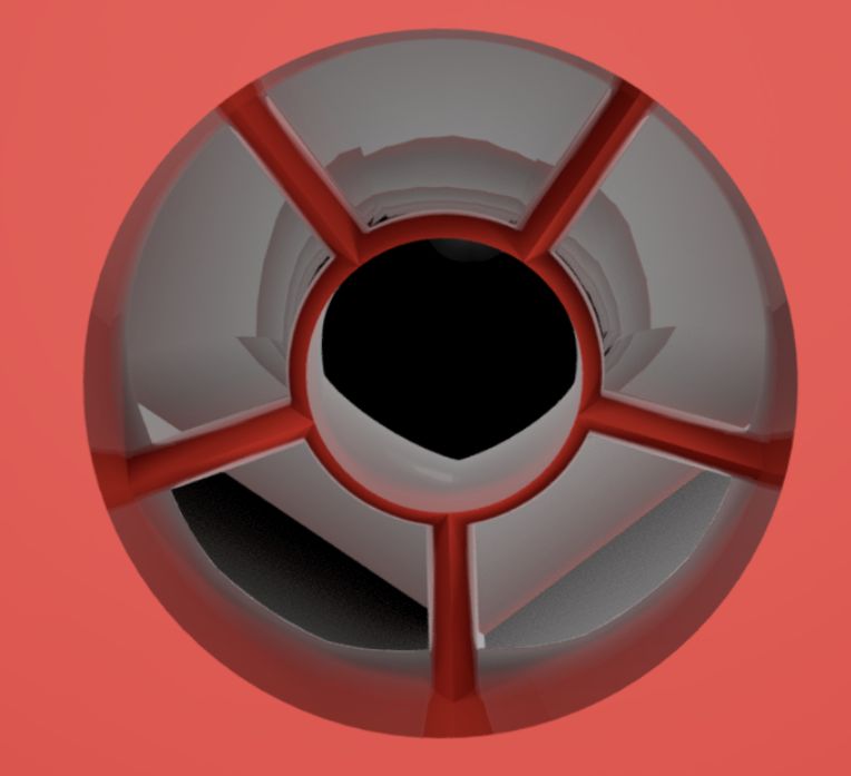

Below you can see what the throat looks like. This is for a 1" driver and you can see how the pentagon and hexagons have been brought into rounded shapes to fit the round opening of the driver exit. No wasted space. You can also see that the fins are brought to a point where they face the driver exit. Finders crossed that works. :xfingers:

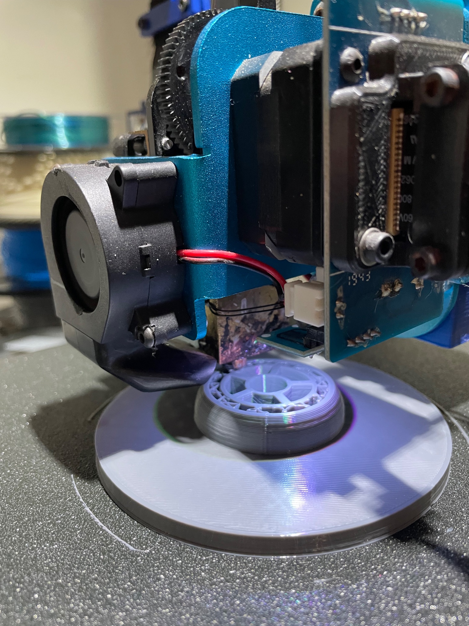

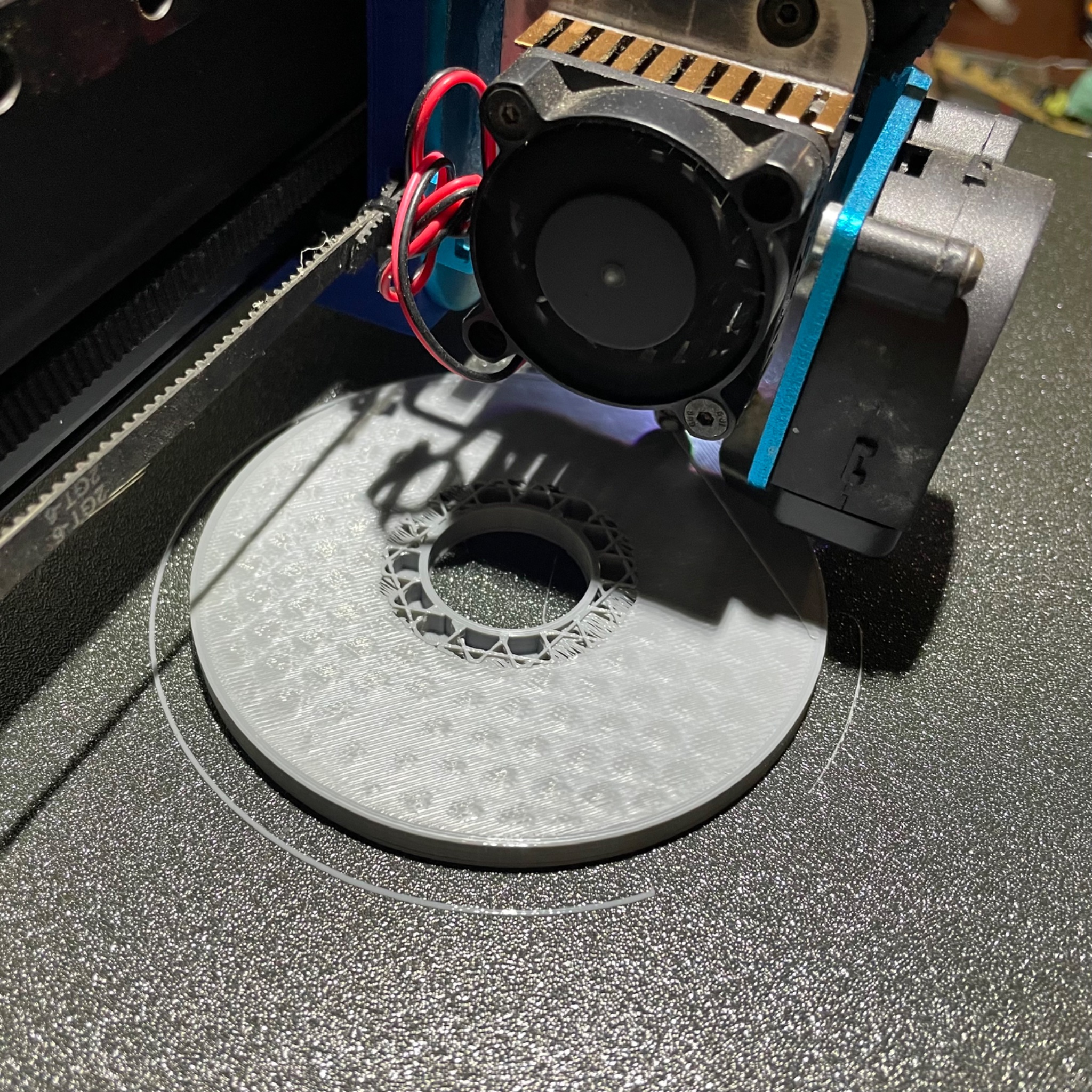

Tomorrow I should have some photos of the test prints. Right now the flange and the start of the throat are test printing.

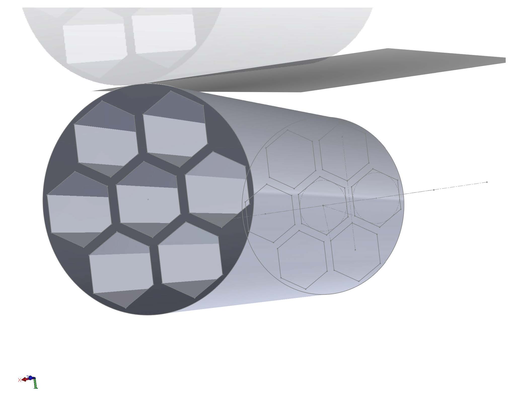

Hi @Pano.,
about two years ago I made a similar pattern as an insert for Altec 288 throat, reasoning that breaking the throat into a plurality of "channels" a perimeter of each being sized to be smaller than the wavelength at 20,000 Hz, would extend the high frequency by avoiding cancellation, but I could not measure any improvement.
Now I wonder if I should continue with the idea mating it into a horn similar to yours.

Pano, your horn idea looks very interesting and beautiful.
The insert from mefistofeliz - I am surprised there was no difference , even if the walls were paper thin, with the triangles invading the throat; that would change the compression ratio - maybe the reflections from this are advantageous? Could the smaller throat area work better? I would not know.
Went against all the little I know.
A simple annular ring arrangement is said to improve the Celestion Axi-Periodic.
Reactions: Pano
Hi @Pano, @Fuling, @rickmcinnis,
This is a very interesting project. Too bad it made no difference, that is surprising. Tell me more, was insert contained entirely inside the 288, or did it extend into the horn?
Perhaps the measurement that I did was not appropriate for evaluating the effect. I first measured the driver by itself, i.e., without any horn, then I inserted the insert (clumsy English - sorry), into the throat and measured again. I have a vague recollection that there was less "hash" at the higher frequencies, but since my goal was to extend the high frequencies, I did not peruse this any further.
Furthermore, the measurements made no sense to me as in my understanding, the "hash" at the higher frequencies is caused by the diaphragm breakup, so the insert should have no effect.
I was trying to find the measurement data, but at about that time my laptop died, and I could not find a backup. But now, with @Pano attempt, I am interested to revisit the issue, perhaps by remeasuring the insert itself and mated to a horn, or even integrate the insert with a multi-cell horn as per @Pano's brilliant idea, as I like multi-cell horns despite them appearing to be currently out of vogue.

Hi @Pano,
Perhaps your idea could be combined with mine, extending the multi cells right down into the driver. That might be difficult with 1" exit drivers, but not too bad with 2" exits.
Perhaps I did not explain myself correctly, the quoted portion of your reply is exactly the idea.
Essentially, my problem is how to expand the outer cells/channels without impinging on the middle one - without any gaps - which you seem to have solved.

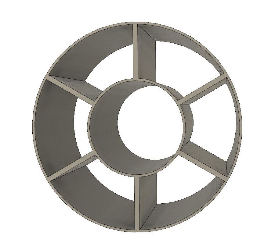

I'm no expert in phase plugs, but I've made quite a few: https://www.diyaudio.com/community/threads/diy-compression-drivers.317125/
As I understand it:
When the diameter of the wavefront is smaller than the duct in which it's traveling through, a wave can't form because there simply isn't enough room for it to form.
For instance, 16khz is 0.844 inches long (21.4mm). If you subdivide a 25.4mm throat, like you did, there might be a small improvement in the overall smoothness at VERY high frequencies (13.5khz and higher.)
If you had a peak or a notch, doing something like what you did, I would expect that it would (possibly) smooth things out. If the high frequency response is already smooth, I wouldn't expect this phase plug to INCREASE the output at high frequency, because the output at high frequency is determined by mass and force. IE, you could increase high frequency output by lowering the mass of the diaphragm, increasing the force of the motor, or both. Again, all of this assumes that there are no peaks or cancellations caused by pathlength differences. If there ARE, then an improved phase plug is exactly what you need.
Hi @Patrick Bateman,
Just like you, I do not pretend to be any expert on this. However, from reading some smart people, it is my understanding that when the wavelength exceeds the dimension of the duct, a path difference and, therefore cancellation occurs. So, the "hash", i.e., the peaks and valleys.at higher frequencies are due to both the cancellation, and reinforcement, as well as the result of the diaphragm breakup..
So do I understand your quote as arguing that my perceived smoothing of the peaks an valleys were due to curing the path difference?
