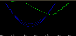

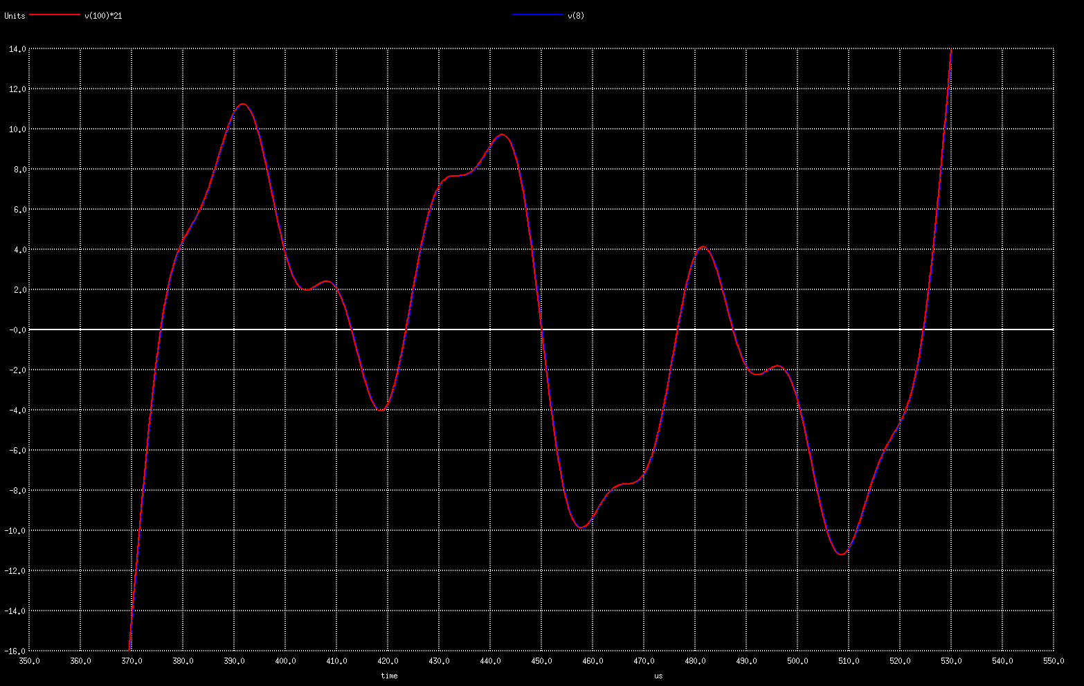

The red trace is the input signal multiplied by the amp gain a 'control reference', and the blue trace is the output signal, at 20KHZ, 100KHZ, 500KHZ
Cheers
Arturo

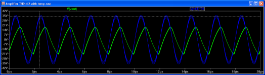

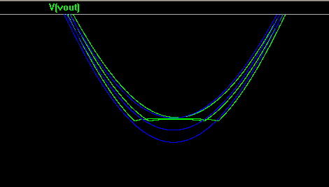

Arturo,
same set up as yours, though it won't go to 500kHz. images: 20k clip, 100k clip, 500k overview, 500k zoom
regards,
Ken
Ahh.. your simulation is not going right. 2n3906 as input can not do that good, it only fast.
Here my simulation with original model. Results only 0.004% THD at 1kHz, while my VAS has 0.0002% THD at 10kHz.
How could you get such linearity with bad VAS linearity huh?.
Do not trust your sim results, they are not going right.😕
Get models from Bob Cordell's web site their hFE curves match and other features match the data sheets much more closely. Most manufacturers models a nasty bad...
Ken

But what is the purpose to measure the VAS alone?. When loaded with the rest of the power stage(s) it will change (for worst), but it is irrelevant, what matters is the linearity at the output, or I am missing something?
Cheers
Arturo

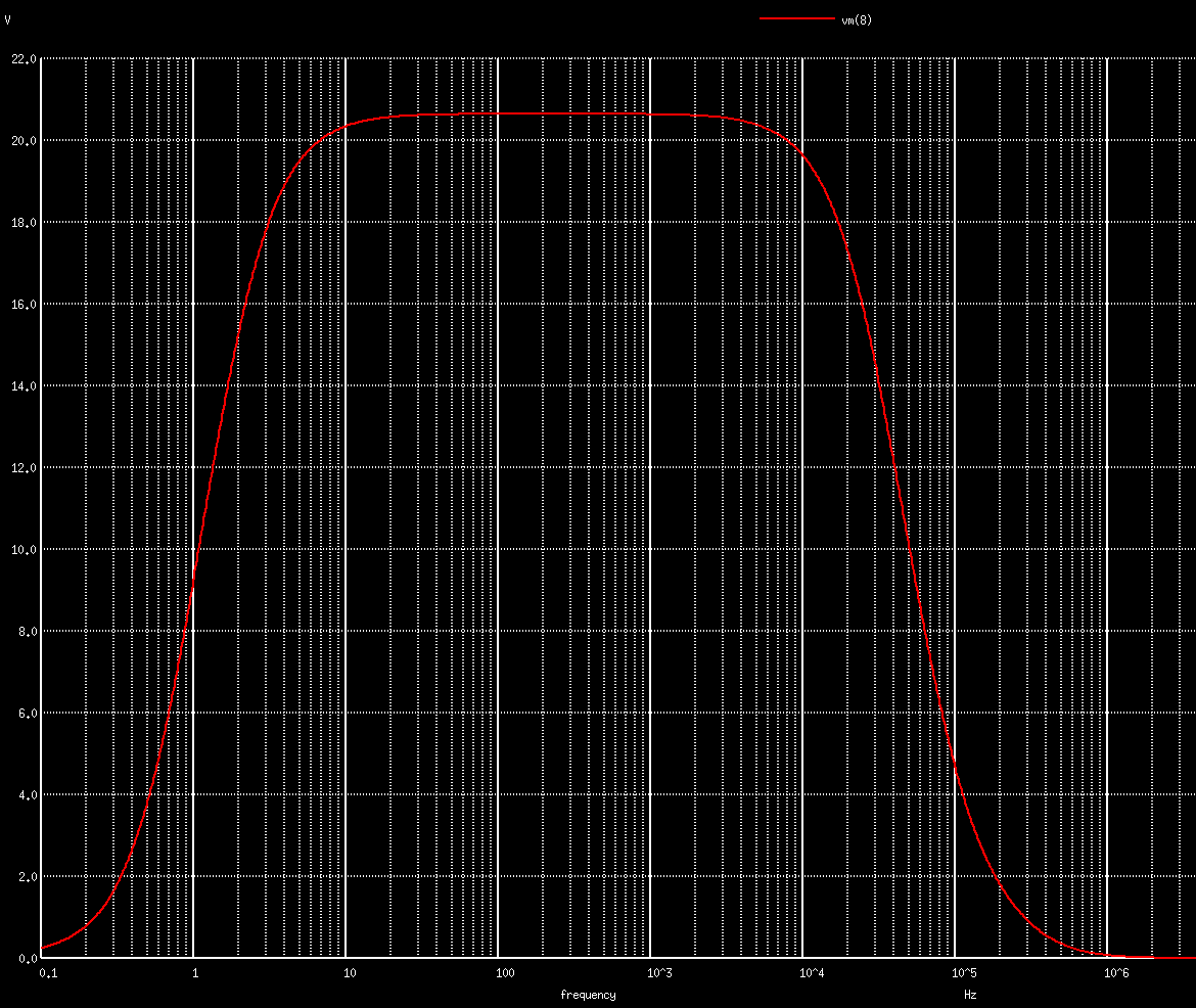

BAD and GOOD
I agree most of your opinions. Now you will understand the 'HI FI Bandwidth' with the following example. Here I show 2 sets of pix's to show the behaviour of 2 amps a BAD and a GOOD. This example isn't far from reality, found in some low end amps, both amps are feed with some 'music material', the red trace represents the shape that the amp should reproduce accurately and the red trace is the reproduced shape of actual output.
pix 1 is the BW of the BAD amp
pix2 is the reproduction of the BAD amp at 1KHZ fundamental, seems to be fairly accurate. It is capable to reproduce 10+ harmonics of the input shape.

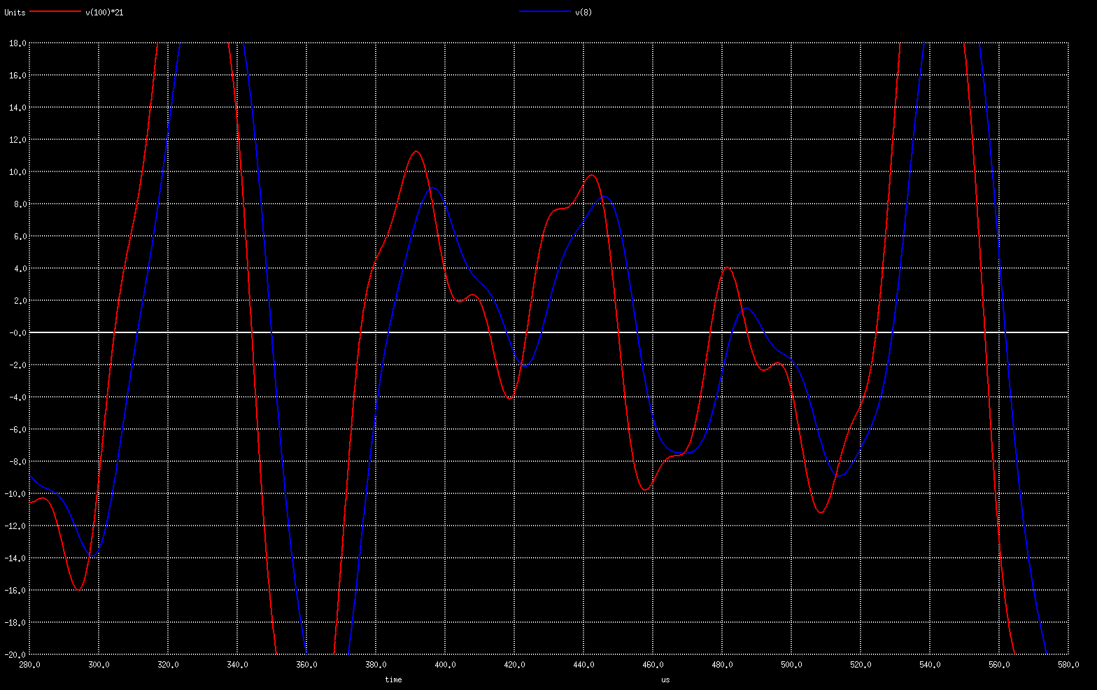

pix3 is the BAD amp at 10KHZ fundamental (still at hearing range). The amp is not capable to reproduce accurately. Indeed will have a big impact on trebles, it will reproduce a pasted sound (without air) without resolution.

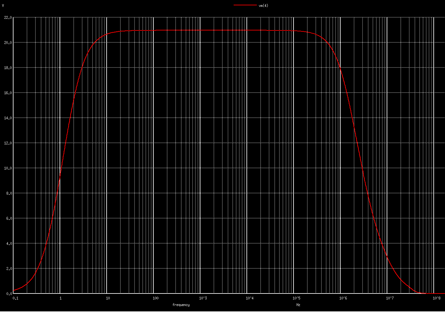

pix 4. is the BW of the GOOD amp.

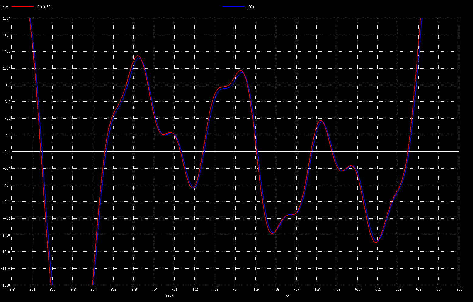

pix 5. Shows a very accurate shape at output. It can reproduce a flat band of 100KHZ+ with low distortion all over the BW. Therefore most of the harmonic content (=shape) of the music will be reproduced accurately. That makes the trebles ie: horns, reeds, cymbals, piano, percussion all with rich harmonic content to sound with very high definition, it should have a good sound. Moreover many people 'tune' Cdom to get the final amp sound, what they are doing is changing the BW and the slew.

post86.
500kHz output looks like it is slew limiting.
If you reduce input/output voltages you should get a much better sinewave at the output.
