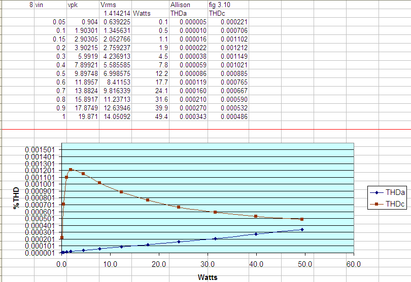

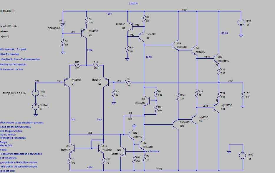

To test the amp in simulation; I've compared it to Bob Cordell's Triple emitter follower Figure 3.10 on page 65 of his book. Using Bob's model files and Thd setup, I've put together the Figure 3.10 as a baseline and used the front end of this amp to graft the modified Allison on as the CAS.
I then ran each in simulation at various input voltages to get a picture of THD.
A note on the modified Allison, it runs in class A up to about 16watts into 8 ohms in this configuration, but, it can be easily adjusted by changing out one resistor.

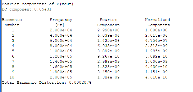

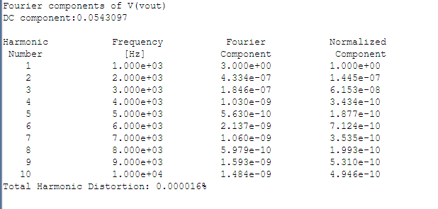

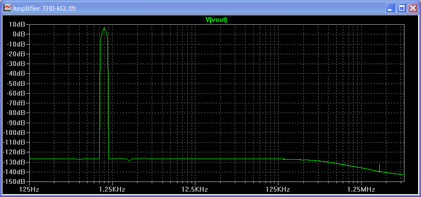

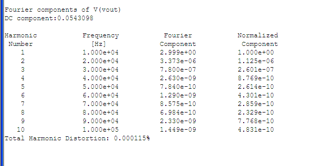

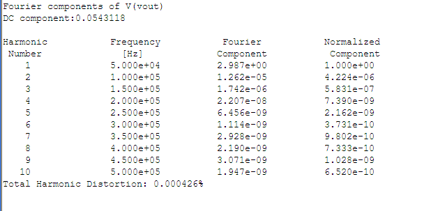

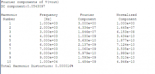

The following are the HD2-10 results at 1k, 10k, 20k and 50k respectively and the FFT at 1k. All at approx. 1 watt output.

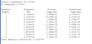

Klewis,
Referring to the second schematic in post #1 (ie the Allison circuit), if you add a resistor (of about 100 ohms) between the emitters of Q11 and Q18, then these output transistors will never turn off and the only switching in the circuit will be the two Schottky diodes. I doubt that you'll be able to measure any difference though.

Hi Paul,
Nice to hear from you again. Your help in the past has been great! I think you meant Q17 & Q18, I'll give this a try. The resistors that feed the emitters of these transistor are different values. I found that if you tune these so that the collector currents are equal, it drives the distortion down further. My implementation plan includes a pot at one of these resistors to balance the current, ultimately replaced by a fixed resistor.
I've actually been using mje15034/35's for the drivers, they are much more stable than the 2sc4793/a1837 used in the simulation. They also have a close match pnp to npn (keantoken's suggestion). What do you see as the are the benefits of the mosfets for drivers and outputs?

Ken,
re Post #11, I meant the output transistors Q11 and Q16 (the values are hard to read off the image in post #1). A resistor between their emitters will force them to stay on, irrespective of what the Schottky diodes are doing.
The small drivers could be replaced by small Mosfet drivers (I'm using irf610 & irf9610), which can supply large amounts of base current to the output stage without loading the VAS stage.
You should also have a look at Nelson Pass's patent 4752745 of June 1988, which uses an OptoCoupler to control the bias. Similar to Allison's scheme, but simpler.
TYVM
This explain why it sounds better (assumuing 10times worse real world results) :)
Lower distortion NOT accompanied by more high order artifacts make the sound cleaner. There is of course a limit, under which pursuing for PPM thd is pointless, but I dont really know where that limit lies.
Hi Ken,
How a temperature compensation is working, what transistors are fixed together on a heatsink?
dado
Hi dado,
I've posted an enlarged schematic of the output section so that it is easier to see componet numbers and values. (I use a small table pc, so the screen captures aren't so great) Bias is set by R14, I basically try different size resistors at this location until the temperature of the heat sink gets hot, but, not too hot :hot: The higher the value of R14 the higher the bias. I typically start at 90 ohms and step up in 10 ohm increments. In this way you can tune the amp to the size heat sink available.
Only the output transistors are mounted on the heatsinks. Diode D2 is thermally bonded to Q17 and kept away from the heatsink, the same for D3 and Q18.

I've spotted an error in the bias settings that don't affect the values at 1 watt, but, will most likely affect the values above 15 or 16 watts. I had forgotten to adjust the current that feeds the output down to 6.8ma (what the LME49811 makes) and therefore had it running class A all the way up to 50 watts. I'll re-run and repost later today.
