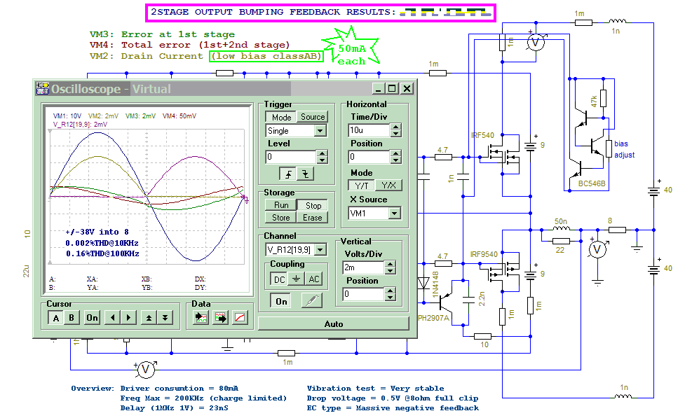

Hi Artu,
Topologies. That's true dominating, but classA always best and easier to be linearized than cassAB or B. It is impossible to use huge NFB with long chain stages from input to output stages. The NFB could be used in output stage only to get lowest error from the output comparing with VAS output.
This one for example: Using two negative feedback. Fist feedback working in high speed and the second help it. ClassAB and HEXFET, still very stable with very good error correction from output and supply.

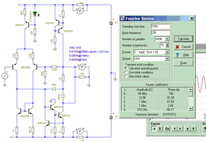

Hi, Klewis, I post my VAS here may be you need different VAS.
http://www.diyaudio.com/forums/soli...erformance-never-let-me-down.html#post2488064

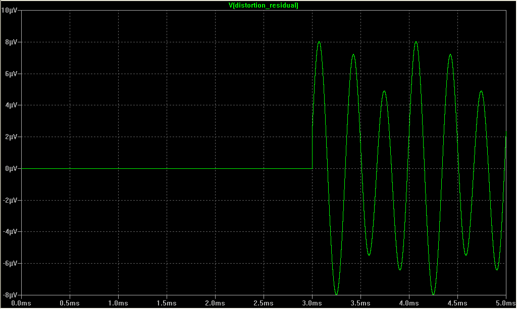

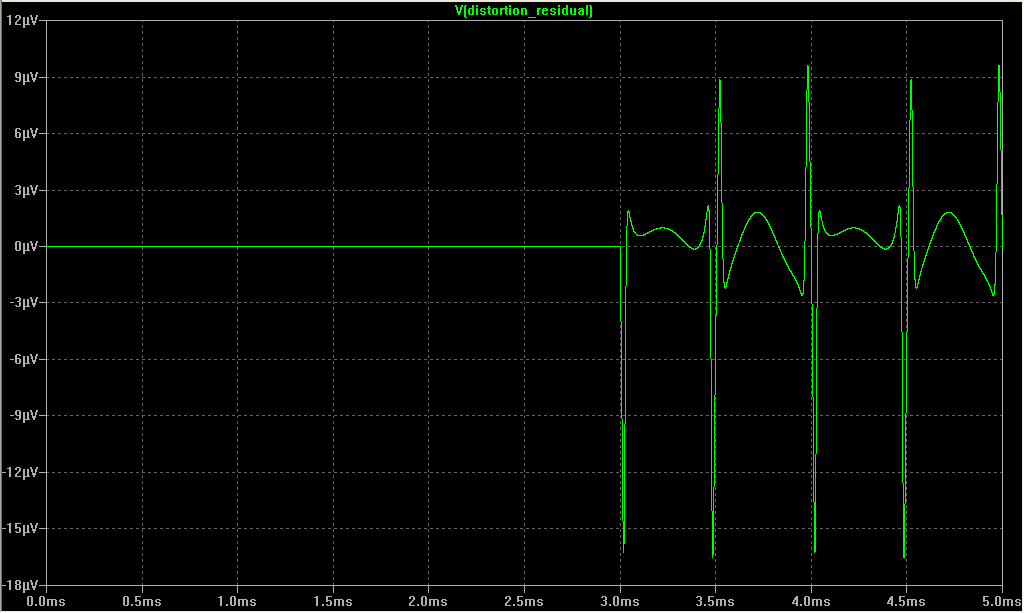

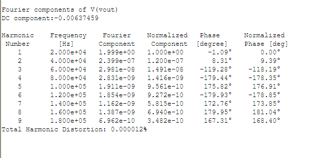

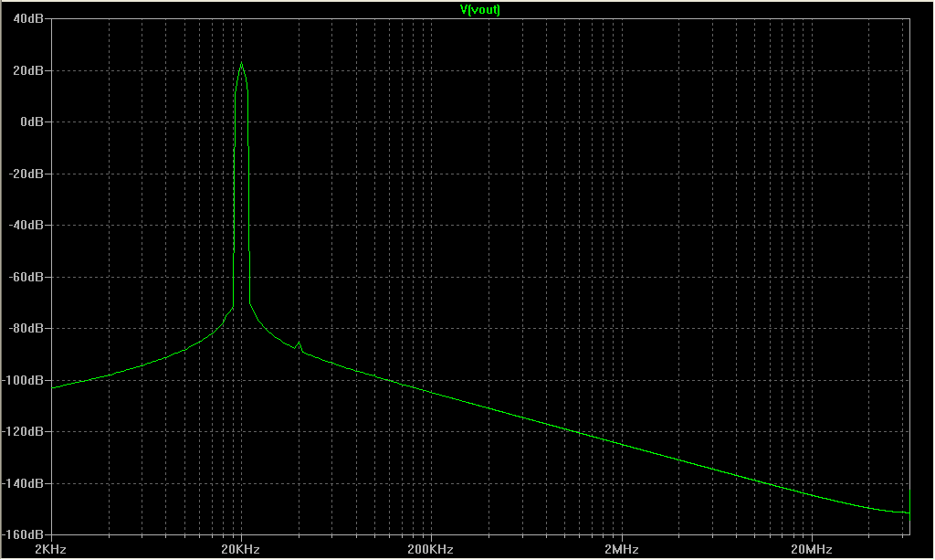

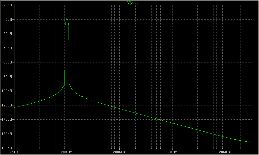

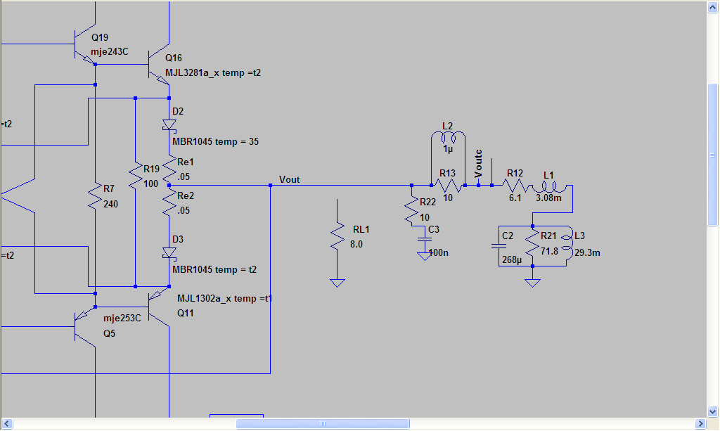

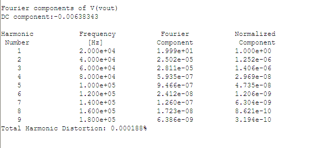

Here is performance into a complex load - Sigfrid Linkwitz (spelling?) values for an 8ohm speaker. First, 1watt 1kHz, 1watt 20kHz FFT, 1watt 20kHz THD and 50watt 20kHz THD and FFT.
KenL
But my simulation results only 0.02%THD, may be caused by the output transistor or something. I don't have those output BJT here, and entering model to the table will need much time.

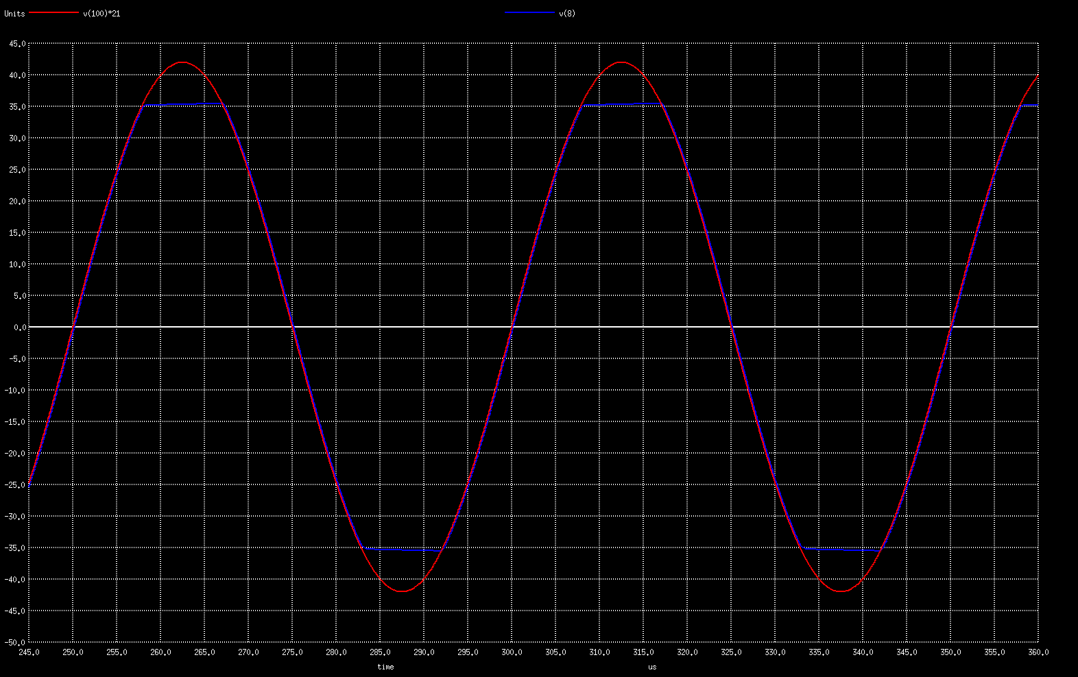

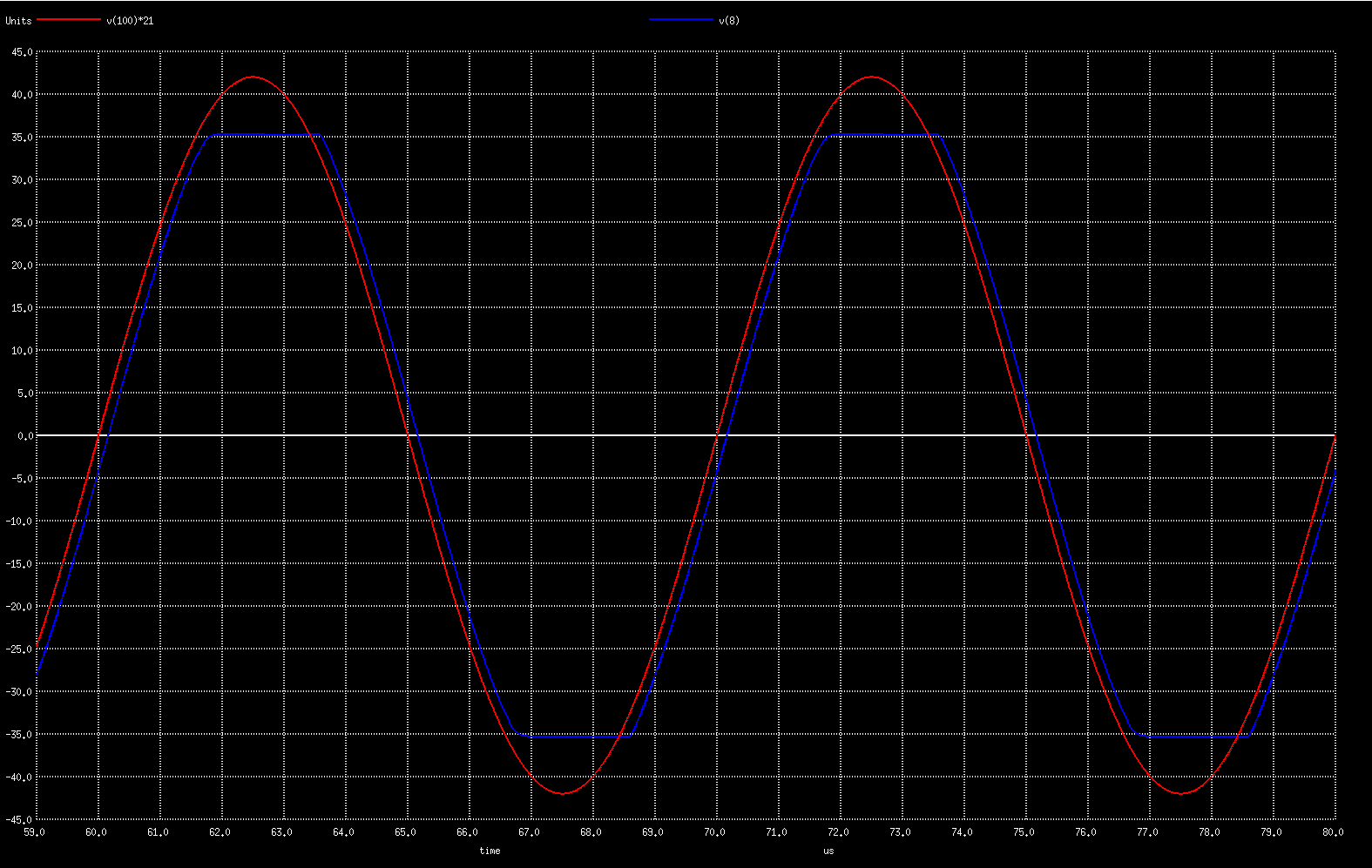

clipping issue
Hi Ken,
I use a similar 'complex load' more or less a speaker model, that's fine, I usually put a pure 100 nf and 2uF capacitive loads (both seems to be nasty) and test the amp just before clipping and clipping at very high freq. >= 100KHZ (much as slew allows, but bellow) and look at the falling edge when the amp re enters the linear region to verify if there is a sign of ringing. Also it is important that the DC offset do not deviate to much from 0 (symmetric clipping), that can be verified doing a fourier analysis (DC component). Other test is the square wave with very high dv/dt I use:

Clipping examples
The red trace is the input signal multiplied by the amp gain a 'control reference', and the blue trace is the output signal, at 20KHZ, 100KHZ, 500KHZ

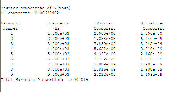

Ahh.. your simulation is not going right. 2n3906 as input can not do that good, it only fast.
Here my simulation with original model. Results only 0.004% THD at 1kHz, while my VAS has 0.0002% THD at 10kHz.
How could you get such linearity with bad VAS linearity huh?.
Do not trust your sim results, they are not going right.😕
