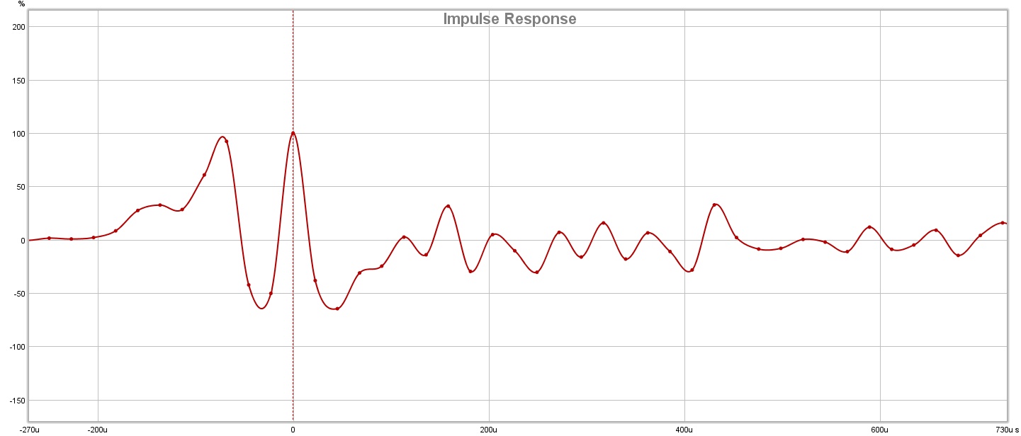

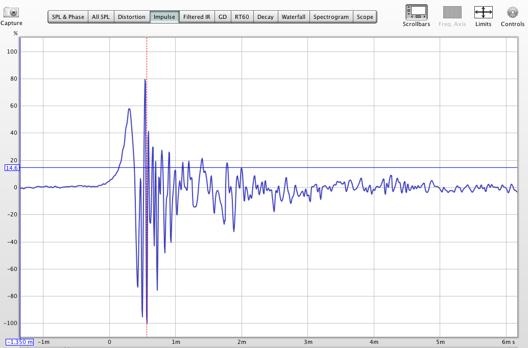

I didn't remember reading this in the guide... I should have a re-read.
But, how do you count samples to arrive at 3 from my impulse test?
We'll use REW for this example (in the guide I use Audacity). Zoom in to T=0 (impulse center) and make sure that the sample points are visible (Controls - Show points when zoomed in). REW assumes that the loudest point is the impulse center and aligns it to T=0 which will be at the 1 second mark (sample number 44100 in this case). Notice now that the initial spike is 3 samples earlier (44097). An audio editing program like Audacity will actually tell you the sample numbers.
Oops, will need to redo the sweep, the AutoEQ was ON on my preamp, so it was added to the 4cycle filter. Might have been responsible for the late impulse

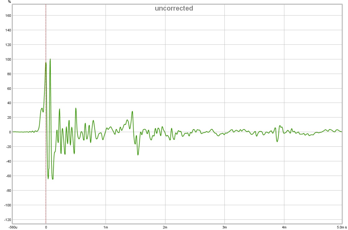

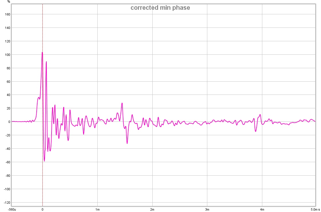

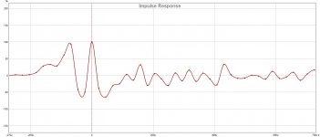

While I'm at it...here are 3 pics showing:
1. uncorrected impulse response
2. corrected with min phase filter
3. corrected with mixed phase filter
Perceval, here's the mixed phase filter to compare to the min phase one i already gave you. Make sure that eq is off 😉.

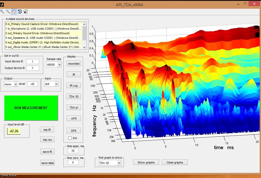

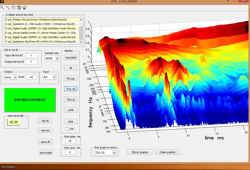

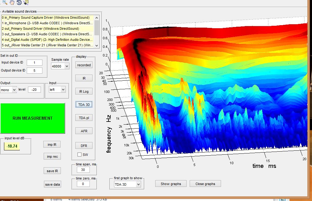

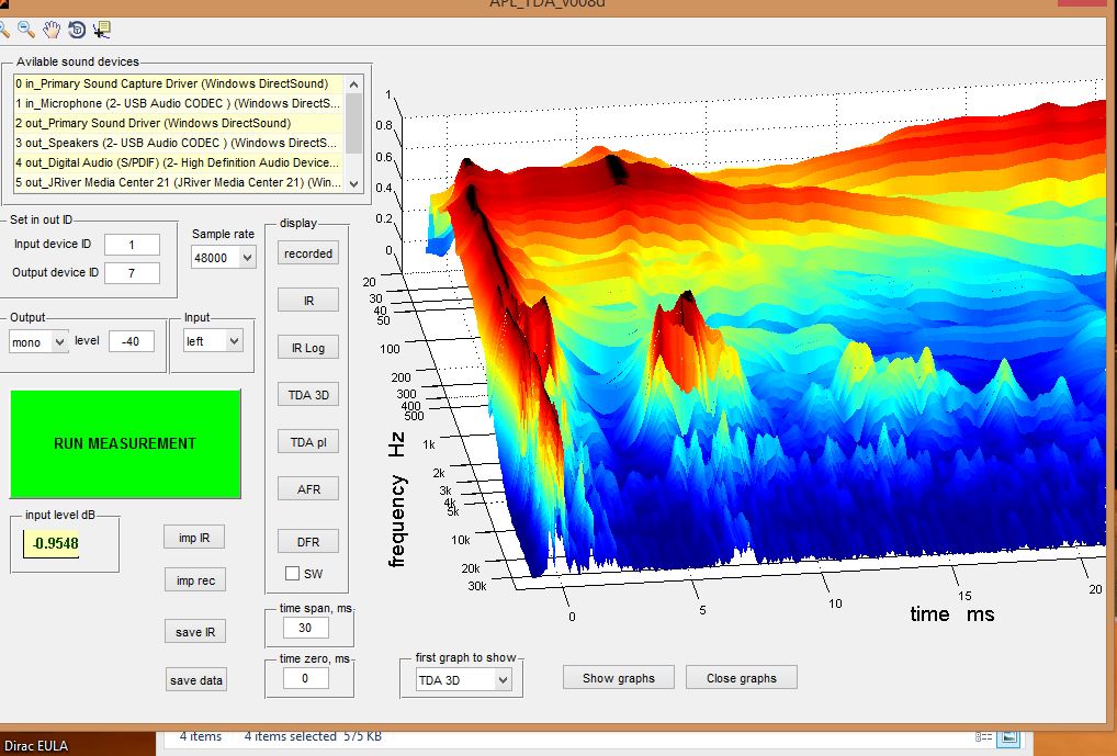

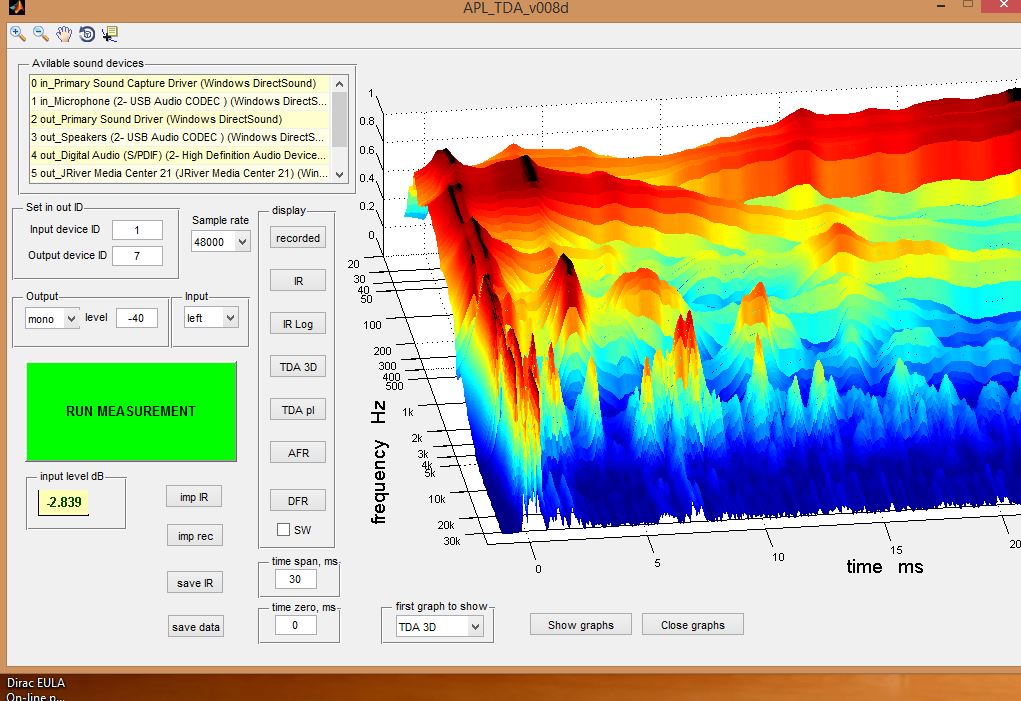

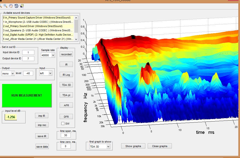

Since I was cluttering the Two Towers thread, I decided to continue here.
Showing the power of APL TDA and it's visualisation of a room. And showing the power of DRC.
So, here we have a pair of W8-1772 in a ported enclosure, driver placed 60cm (2 feet) off the back cement wall. Mic is at the listening position at ear level on the couch, 130cm (4'3") off the cement back wall. Strong reflection from that back wall and a coffee table in front between 5ms and 15ms.
This one is with another W8-1772 placed on top of the ported box, dubbed the Mega Nola Brio Trio! 😉 We see the multiple new reflection sent by the extra drivers mounted on open backs.

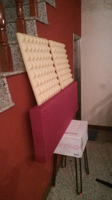

Now, I've added pillows on the coffee table, and a rockwool panel with some acoustic foam on top of the panel, trying to tame the back wall reflections.
Now, I will move all the drivers from the front wall, drivers now sitting 105cm (3'5") off the back wall. Now that cleans up a lot of stuff, but that new strong peak at about 7ms is from the cement front wall, I believe.
Here, I turned on the small 10" Yamaha sub placed in a corner of the room.
Finally, I launched DRCDesigner, and running out of time, I just let it do it's own sweeps, and didn't follow all the steps mentioned by gmad in his description, hoping peaks would be aligned close enough (hint: they weren't) and used the basic minimal setting with a downslope of -5dB from 1kHz to 20kHz.
Still, it did a clean up job, I should say!
Now, I've spared you the other multiple sweeps I took with TDA, REW, etc... This took a little less than 2 hours.
Imagine what would be possible with a whole afternoon and following the instructions closely to make sure DRC performs at its best!
I have a better understanding of my room, and found a problem.
My right speaker's output dies quickly at 200Hz and lower. I have no idea why. The left is fine. I tried to swap amplifier channels to see if something was wrong there, and nope, still dropping on the right channel.
That might explain why the low end has gaping holes between 50Hz and 120Hz. The left channel is working alone at those frequencies.
