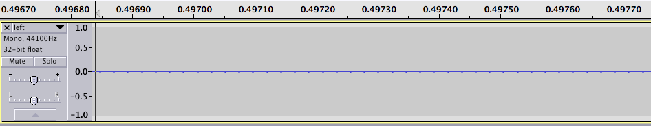

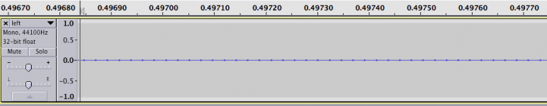

I had no problem getting measurements in and using DRCDesigner in conjonction with REW... but now, it's all gone overboard.
Somehow, I can't get REW to export a wav file from the sweep I did the last few times I tried.
I had just change the wav file into pcm, then put that in DRC, but the filters that came out were loud, bassy, and there was a strange echo.
So, I had a look with Audacity at the wav file REW exported, and this is what I get... I had to zoom in quite a bit to see anything... I don't understand..

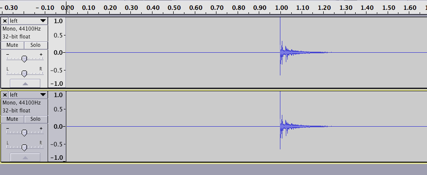

How does the impulse response look in REW prior to export? Also, try normalizing the wav in Audacity to examine it...
The impulse Response was not the prettiest, but I was expecting that, as it was taken in a room with many reflective surfaces.
I never normalize the export from REW... Should I?

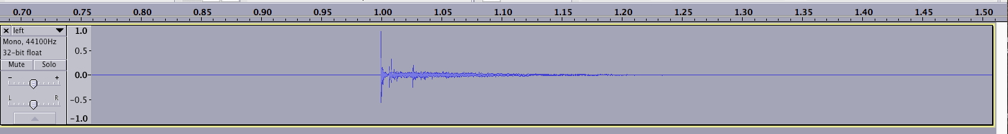

Normalising the wav gives me this... So, I should normalise the wav files before changing to pcm and import into DRC?
I export the IR normalised in REW as 32 bit file, have DRC plot me a prediction as well as the correction file and always measure the result with convolution filters in line to check if it's result is close to the prediction. (it usually is very close)
I don't think gmad normalises his IR's. So I don't think it's required. It just makes it easier to check the separate steps along the way. It gives me a predictable result that I can use with a fixed attenuation within JRiver.
Are you sure DRC picks the right timing for the IR? I remember that being a problem in your earlier case.
Yes, I only suggested normalizing in Audacity for the sake of visual comparison to what is being seen in REW.
So, what's wrong with my normalised file then?
I don't understand why it just stopped working nicely as it did before...

Hi, perceval:
Although the exported wav files are ok, the raw files are not readable; you need to check your export settings for those. Try re-importing the raw files immediately after exporting to verify that they're ok. This would certainly explain why DRC didn't produce a useable filter.
There is a strong secondary spike immediately following the first spike in the IR. Both REW and DRC assume this to be the impulse center. It's verry narrow which means it contains high frequencies so I assume it's the whizzer cone. I set DRC to make the first spike the impulse center. It's only a difference of 3 samples so it may not even make much of a difference in the end; I guess you'd have to try it both ways to see.
Because of the strong room influence, I suggest trying a minimum phase filter. The room response can have a big effect on excess phase response, and excess phase correction can lead to artifacts more easily than minimum phase correction.
