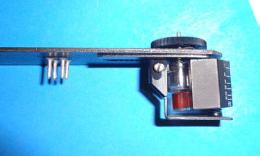

Dear Ralf, I also believed that it was the fulcrum of a simple gimbal tonearm with a flat shaft, but then, looking at some photos and infos (see attachment) I saw that is instead a DIN plug, and then the "fulcrum" is not an articulation but a fixing point.
Just like in my H arm, but 30 years earlier.
A counterweight in the rear is useful to balance the arm (I've also used, not to stress the bearing), but the damping is needed only in the resonant front section of the shaft.
ciao carlo

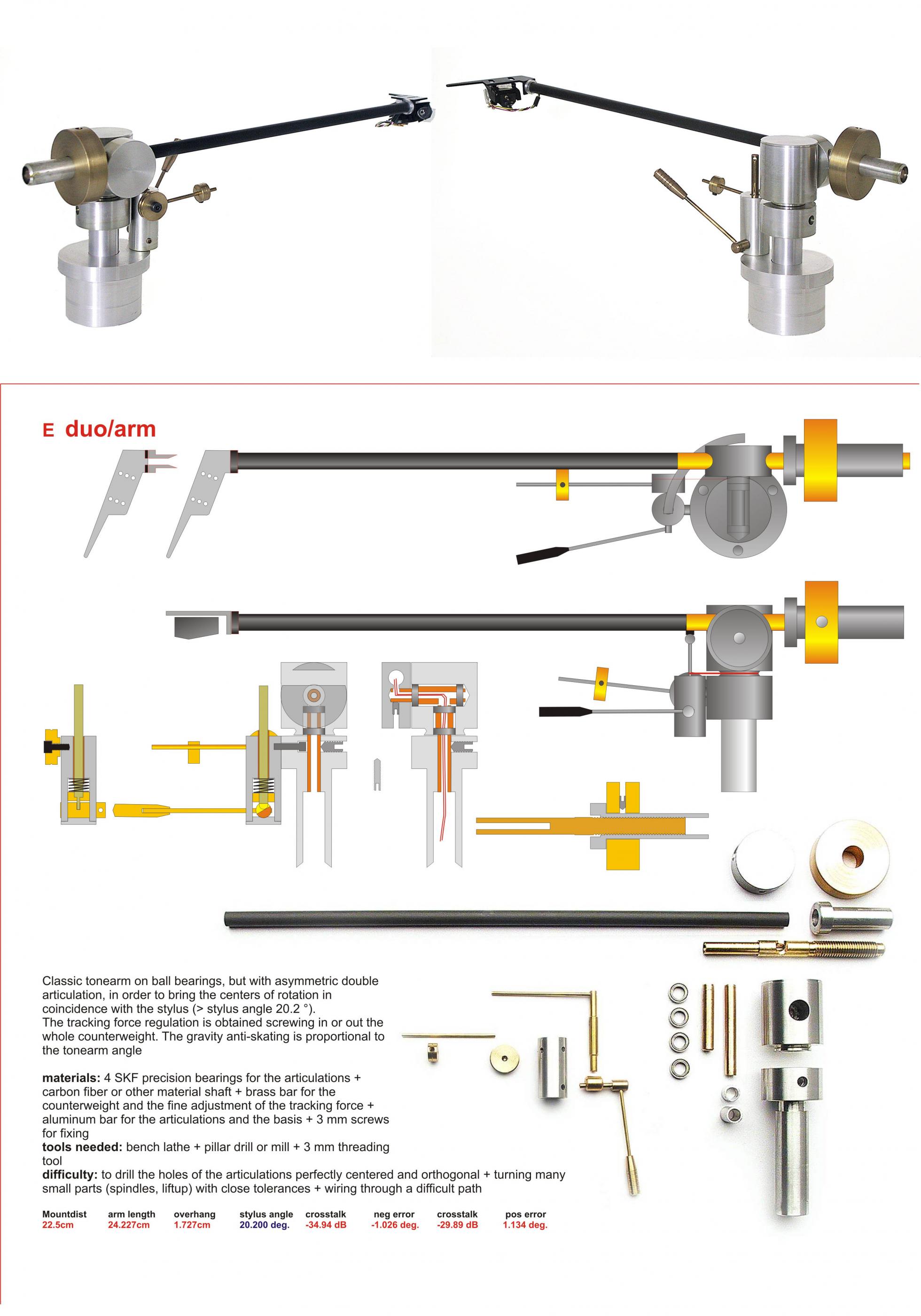

not a bad idea at all: several years ago i made this arm with two asymmetrical axes aligned with the stylus. It allows also to have a constant overhang. However, when properly set, imho the j-arm with the piano wire plays sharper. Sharper not always mean better. There are lots of problems involved with elastic vertical movements (help wanted, forumers). The advantage is that is possible to face one by one, which is difficult with sofisticated solutions.
Carlo

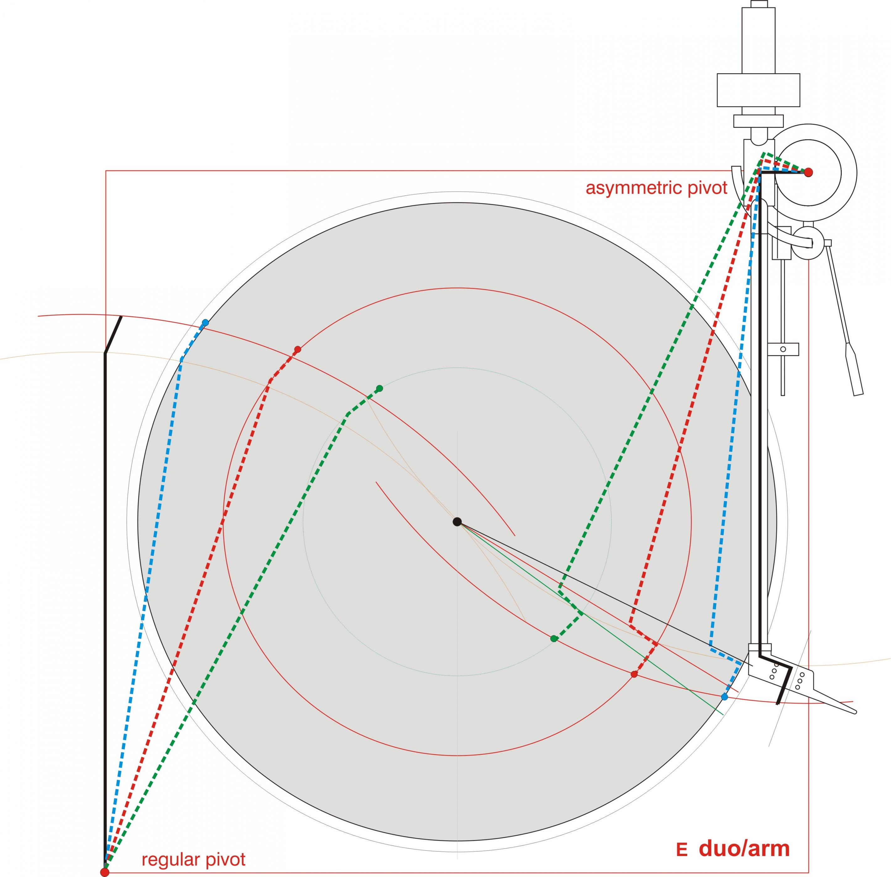

My old DUO arm instead is only a standard gimbal arm, but with the two axes decentralized to align to the stylus, for the well known balancing issues.
Idea almost as old as the tonearms. In my little drawing here is the simple geometry of my arm: the offset error is the usual, the bonus is that the overhang remains constant or nearly so.
The sound is almost identical to that of any arm on bearings, strengths and weaknesses included
ciao Carlo

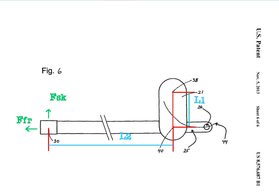

You are confusing the ALTO arm with the Schroeder LT arm. ALTO is geometrically conventional and does NOT have an extra pivot! ALTO arm has nothing to do with parallel tracking. None. All you have to do is look at the LT arm's headshell as it has NO offset angle. The ALTO has an offset angle at the headshell.
My old DUO arm instead is only a standard gimbal arm, but with the two axes decentralized to align to the stylus, for the well known balancing issues. Idea almost as old as the tonearms. In my little drawing here is the simple geometry of my arm: the offset error is the usual, the bonus is that the overhang remains constant or nearly so.
I failed to see the difference geometrically between your DUO arm and conventional pivot arm. Since your arm has only ONE pivot, the effective length is still measured with a straight line from the pivot point to the stylus tip. Regardless of how you try to angle, curve, change shape, or have different joint, the geometry is still a straight line from pivot point to the stylus. That's why straight, J-shaped, and S-shaped arms are the same thing geometrically; even "split-plane" arm like Dynavector is still the same. Unless you added an extra pivot somewhere in between that straight line then all the conventional geometry is out the window. Care to elaborate on that? Thanks.
The ALTO arm is not about geometry. Based on its name it is about the loading on the bearings asymmetrically as it leans on one side of the horizontal bearing that might lessen chatter. It's analogous to turntable debate that much has been argued about the advantage of belt drive turntable bearing being pulled to one side that effectively preloading the bearing towards one side to create consistency. So far it's all based on observation. Perhaps Frank can chime on on this when he's not busy.

Directdriver is correct. The ALTOs bearing layout primarily pre-loads both bearing sets, lateral and vertical. There are no ball bearings(differing from the drawing nocdplz posted) used for the vertical movement. Even if one chooses such an arrangement, the minute slack of the balls vs their races would allow for relative movement when under a dynamic load(tracing a modulated groove). Not good...
The other advantage of this topology is the utterly simple way to generate a skating compensation force(decreasing towards the center). Move the shaft out of a perpendicular position and the offset mass will tend to find the lowest point. That's why the Alto's base can be"tilted".
And no matter where you put the armwand/bearing point relative to the vertical axis, it can be reduced to a straight line with a headshell featuring an offset angle(as directdriver pointed out above).

The geometry, imho, is a little different from the classical one since the fulcrum of the vertical movement moves back and forth: the sound, however, does not improve so it is useless, if not dangerous. I posted that old arm just because you talked about the axis alignement in the Vertere, but this quickly led off the subject.

Forgive me. I add some word for DD and Frank, to be clearer (my bad english does not help me).
Of course the shape of the shaft is irrelevant, if the two axis meet in one point.
But if the horizontal axis is shifted laterally from the vertical one ,the thing changes: not for the offset error, but for the hoverhang.
Am i wrong? carlo
carlo
may be wrong - carlo
Sorry again - too many years from that project.

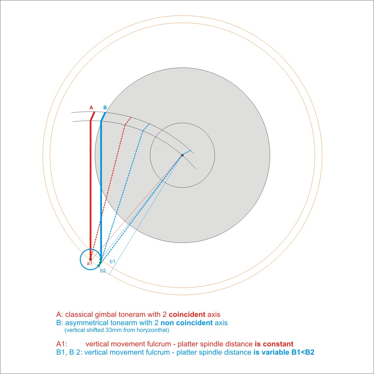

I was tryng to explain this (see attachment): It was an experiment to test the influence of a variable position of the vertical movement fulcrum and the 2 axis in line with the stylus. Of results was just talked enough
carlo
