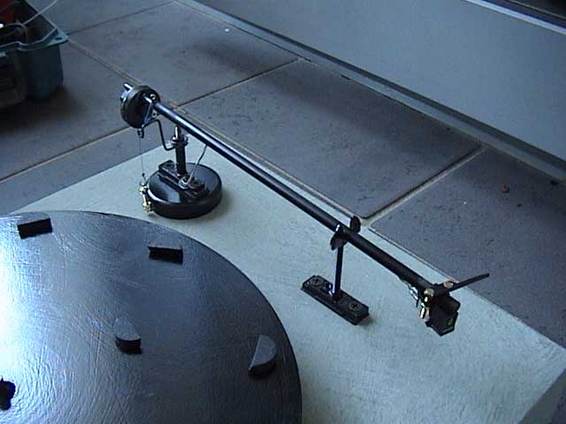

Here's a unipivot made from old scrap.
Kitchen cabinet hinge clips for stands.
screws for arm rest and pivot (sharpened).
7mm carbon tent pole for arm. (pivot drilled through to top wall).
Grado cartridge clamped to arm.
Washers for counterweight.
2mm wire, thread and screw for anti skate.
Works nicely, but on very warped records, could do with more damping as it rocks a little (azimuth)
Next project using nanooks 'magnetic' azimuth stabiliser.

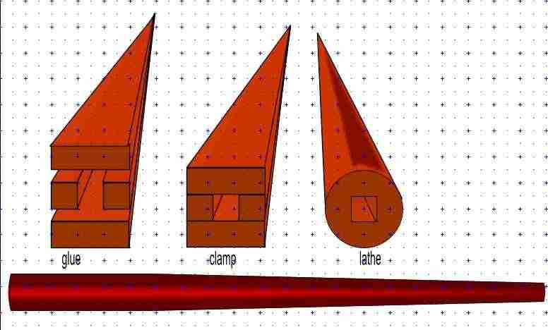

GREAT THREAD!...my thoughts
I'm about to embark on my own tonearm & have some ideas i'd like to share.
ARM TUBE MATERIALS
Bamboo; natures own very strong tube, I seem to recall a bamboo tonearm from many years ago yet a GOOGLE search returns practically nothing! Buy a pack from your gardening centre then look at x-sections of the pieces ‘til you find the right one!
HARDWOOD ARM [ MY NEXT TASK]
Drilling a long centre hole could be difficult so why not prefabricate in strips, When they are glued you will have a square, accurate central ‘tunnel’, which will also serve as centralising hole if you want to lathe it to a round section!
If the middle sections were of contrasting wood [colour] they would also serve as a visual middle location for marking, drilling etc.
See pics.
ALUMINIUM; [ALUMINUM]
If you use aluminium parts you can get cheap polishing kits on ebay & polish the metal to a beautiful mirror finish which will not tarnish.
TONEARM CABLE;
Cheap £2 earphones provide great fine lacquered wire for your arm, I still haven’t mastered ‘tinning’ it very well though. Any tips on this enigma would be greatly appreciated!

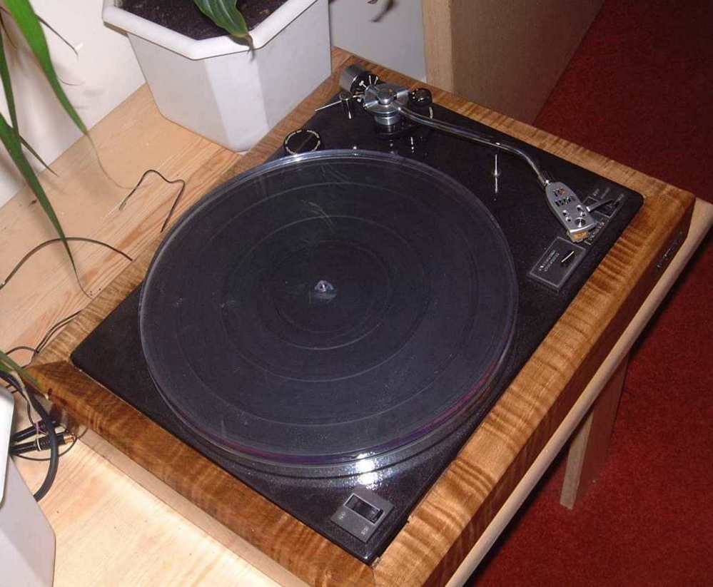

pioneer pl for a tonearm
This was an ugly seventies PIONEER PL 12D turntable ‘til I got my hands on it! I basically made a new body out of solid maple and did some other tweaks, the spindle bearing seems excellent, and I’ve also made a polycarbonate platter.
The stock tonearm is frankly not very good. I took it apart and fiddled and polished the parts but there’s too much free play in the arm bearings, if I tighten them up then the arm movement gets sticky & heavy, too loose and we have the rattles! so this is the candidate for my new arm project.
