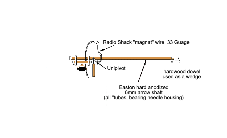

ssmith said:
1.The Altmann DIY Unipivot seems to be the one that started it all -- it's cheap'n'ugly, and allegedly sounds damn good. So anyone who's tried it and compared it with a mass market one (something like a Rega RB250?) please report here!
This is a better looking version.

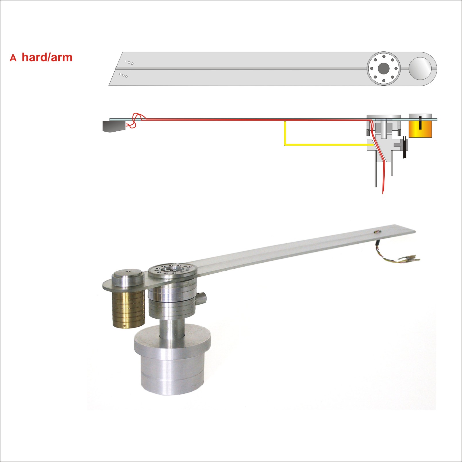

Hello everyone, I am not new in Diyaudio, but this is my first post, so forgive me, and my bad english (maybe you'll prefer to my good italian)
my nickname will tell you that I am an analogue addict, and the work of Altmann for me was a real revelation, at least like to discover that a set tube amp with ten components sounded better than my ipod.
I tried to make tonearms in many different ways, unipivot included, then I asked myself: one pivot alone? maybe too much.
here is the result, and it plays.
ciao - Carlo

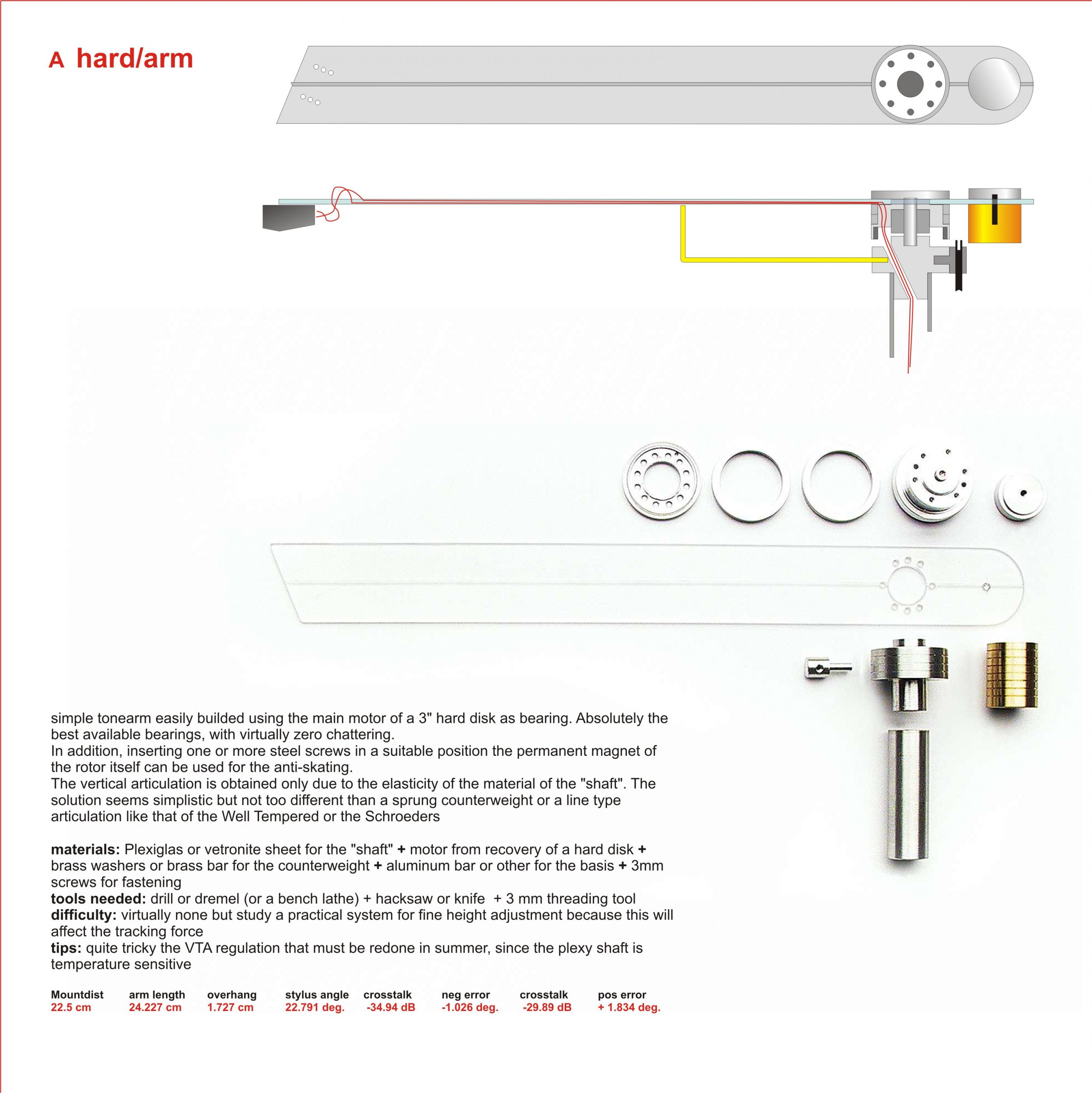

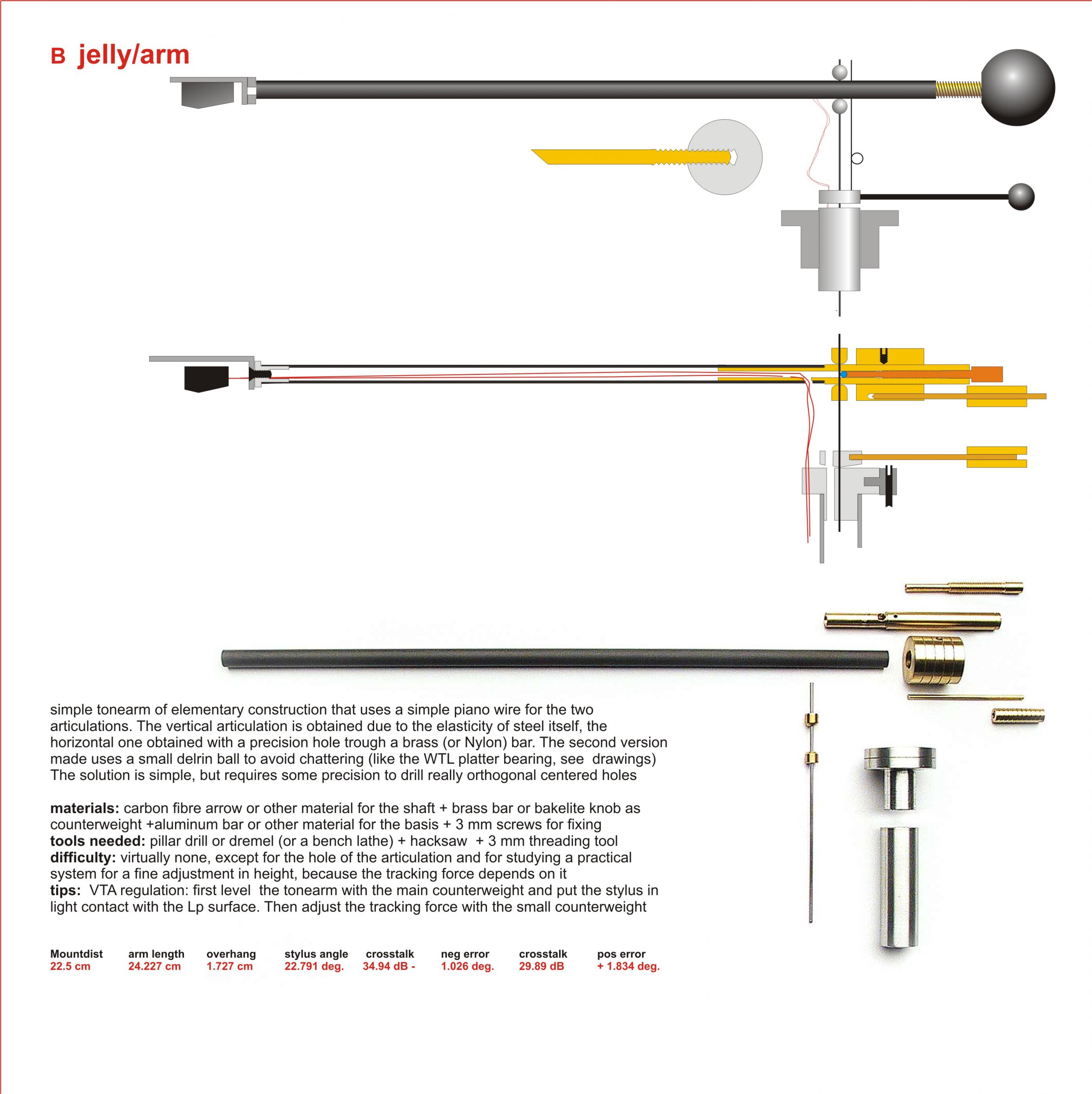

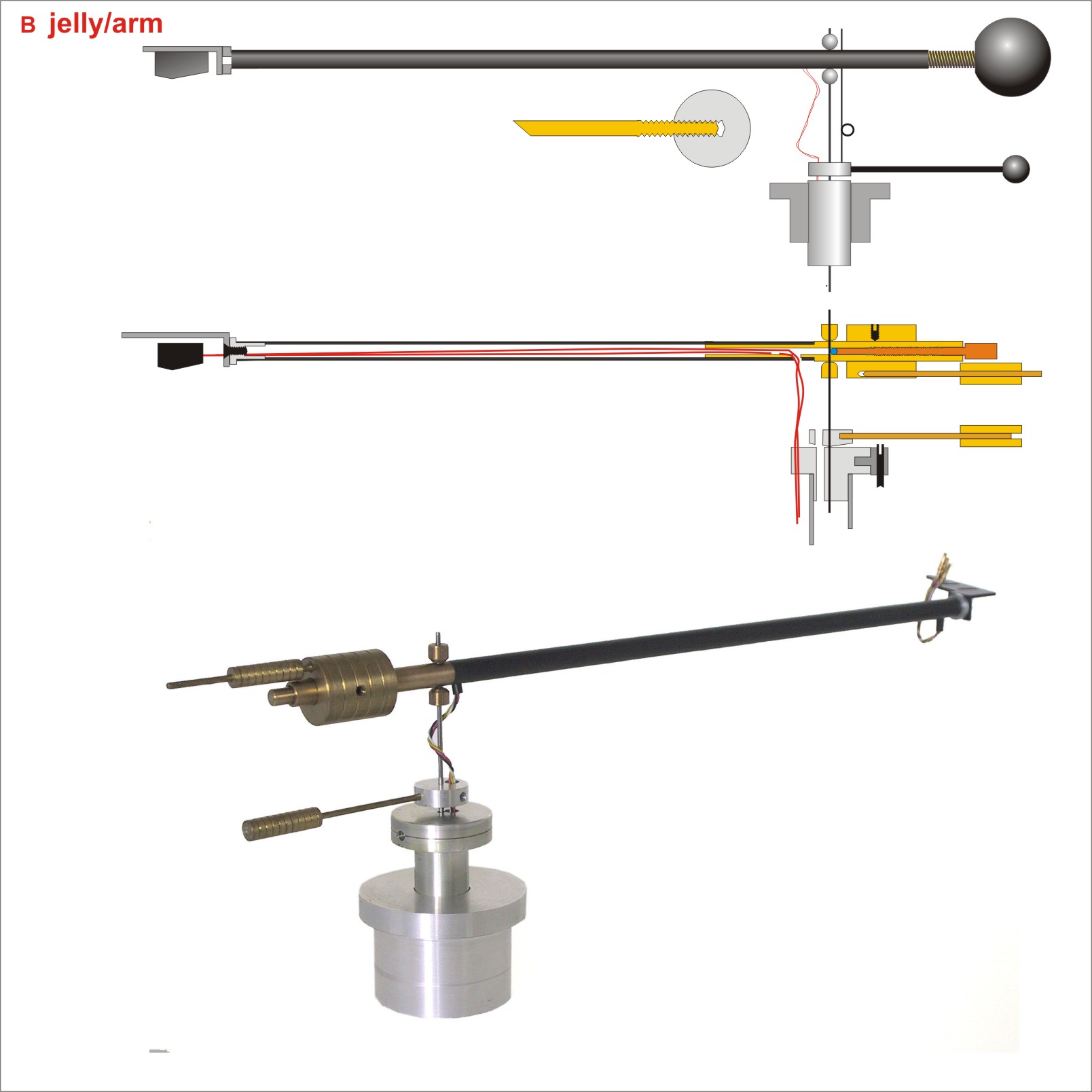

I sent two "silly" realizations that seem to lack of articulation for vertical movements (like the cutting lathe..). Maybe so silly that someone can't understand my drawings, or has mercy on me.
So i've added a few words
(see attachments).

Very interesting concept, nocdplz. (Great username!) It seems in both arms the vertical movement is based on compliance, the flexing of material in the Plexiglas and piano wire. My question is that do you encounter changing tracking force when altering VTA?
And in the Plexiglas arm, during needle drop do you have to hold the armlift until you get to the playing area? How does it handle warped records, does the arm have enough flex to accommodate it without damaging the cartridge?

thanks Directdriver: it' an experiment more than a concept.
I made some arms from different schools trying to understand what is important and what is not (or very little, at least to my ears) and trying to reduce the variables. Lesson learned is that tonearm's (and TT) role is only to leave the cartridge in peace to do his dirty work. I also believe that, about the geometry and physics of the tonearms everything was just said in the thirties, and there's no need to lose time any more.
I try to answer to your questions: these arms are certainly not-so comfortable to use (like our tube amps), and of course the VTA is vital to set the tracking force (totally for the H arm, partially for the J). In the drawings you see an height adjustment screw, and a sort of armlift, but they are not essential. The essential point instead is the flexing material: I used 0.8 - 1 mm for steel wire, and 1- 1.2mm sheet of plexiglas or lexan, but it depends on the total weight, the height etc. The lexan is not the best because is influenced by temperature, maybe better the carbon fiber or the plywood used for model aircrafts. But i have still to find and try.
Of course at the headshell level you must get more flexing than the stylus, but risks with warped records maybe are less than that from the inertia of a heavy headshell / counterweight (not to talk of the stop&go motion of a linear tracking).
Anyway, to put together a rough version of these arms is quick and easy, and the funny thing is that they play like many others, and not the worst: which (like the Altmann Joke) gives a lot to think about the value of what someone claims and sells around

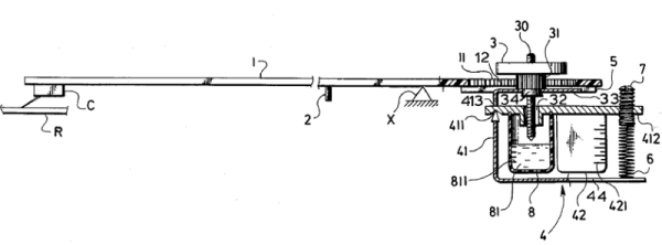

Alighiszem: thanks for the link. are there some drawinngs of that arm? i can't understand how it works
