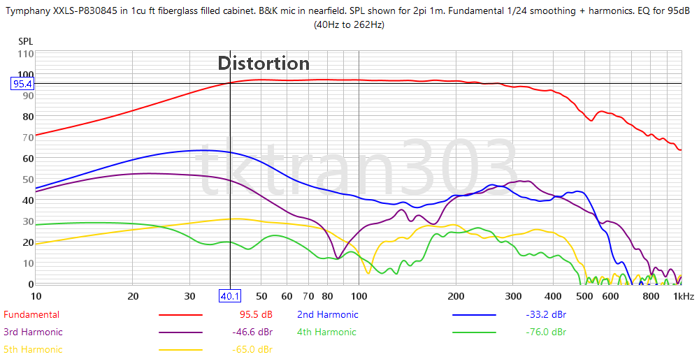

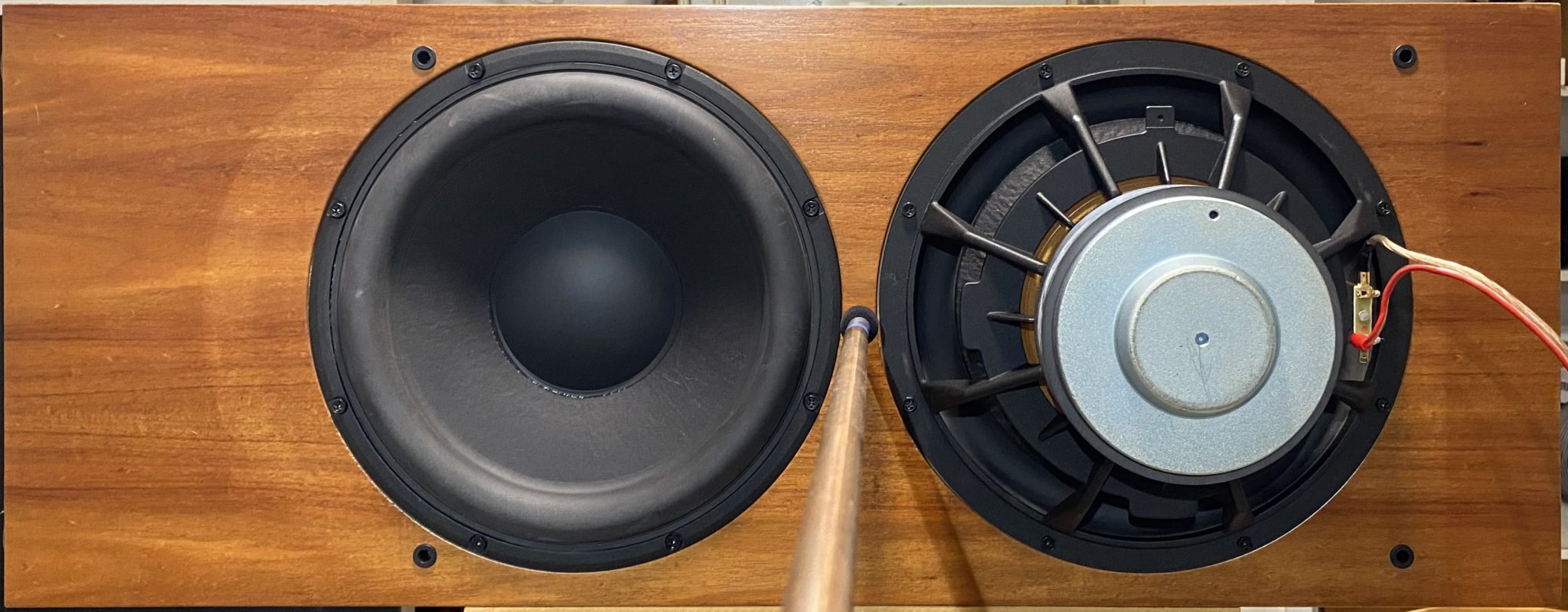

At 80Hz the cone excursion is just 1mm for the 12TXB100
At 80Hz, the cone excursion is 3mm for the 830845

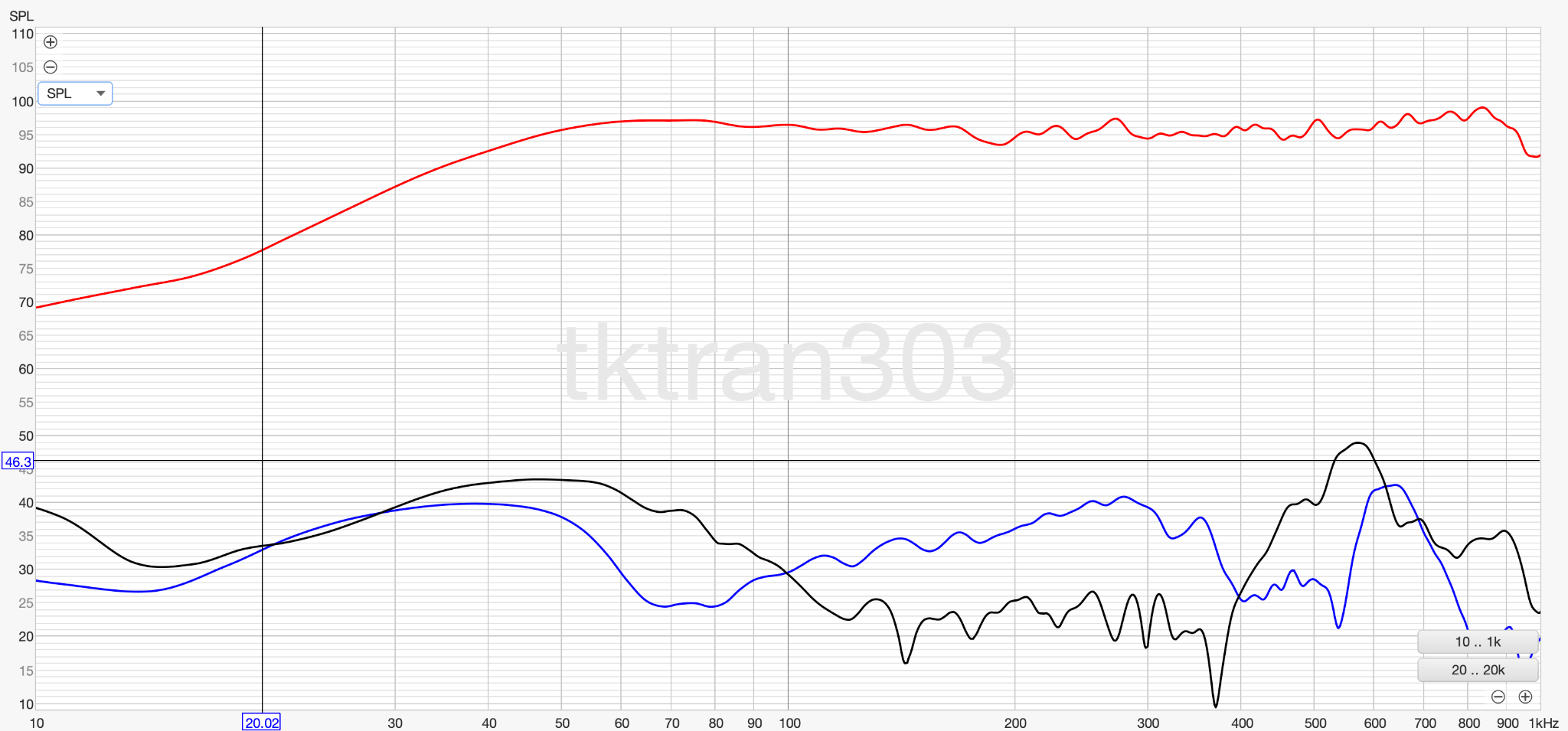

Exhibit A:

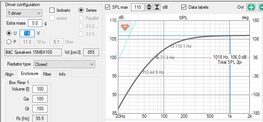

B&C 15NBX100, in closed box of ~100L... similar to what our own @gedlee used in the NS15 (New Summa 15) a decade ago-
Please note the cursor positions.
1) 106dB sounds like a lot, but I'm talking about dynamic range of
85dB @ main listening position with a 20 dB dynamic range, typical of THX, Dolby Atmos standard for theatres.

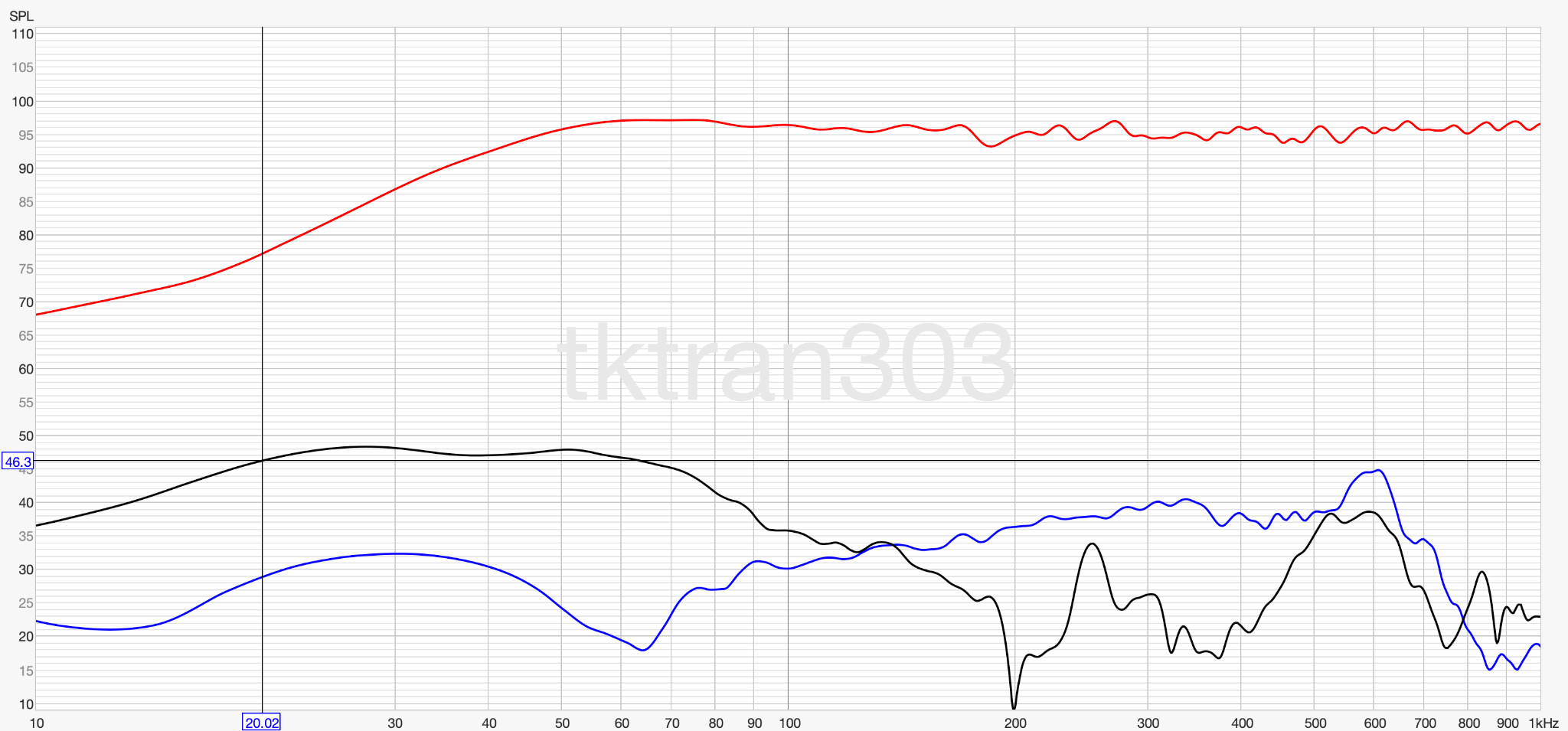

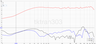

Exhibit B:

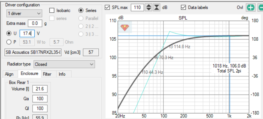

The brand new SB Acoustics SB17NRX2L35-8 in a ~22L closed box. Now this is much bigger than it practically needs to be... however, I wanted to match the low end (20Hz - 100Hz ) as closely as possible without the use of EQ.
Some of us a little shy or reluctant to use EQ or DSP. That's slowly changing, but I didn't want to be accused ofcheating bending the rules.
Here's the response:
The driver is close to excursion limits (acqua line) and power limit (albeit "IEC continuous power", a rigorous 24 hour testing standard)

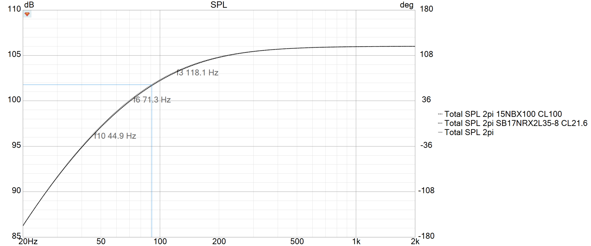

Here they are overlaid:
The responses of a 6" midwoofer are perfectly matched to a 15" midwoofer between 20Hz and 2KHz.
Note the cursor position around 90Hz. You'll need that later.

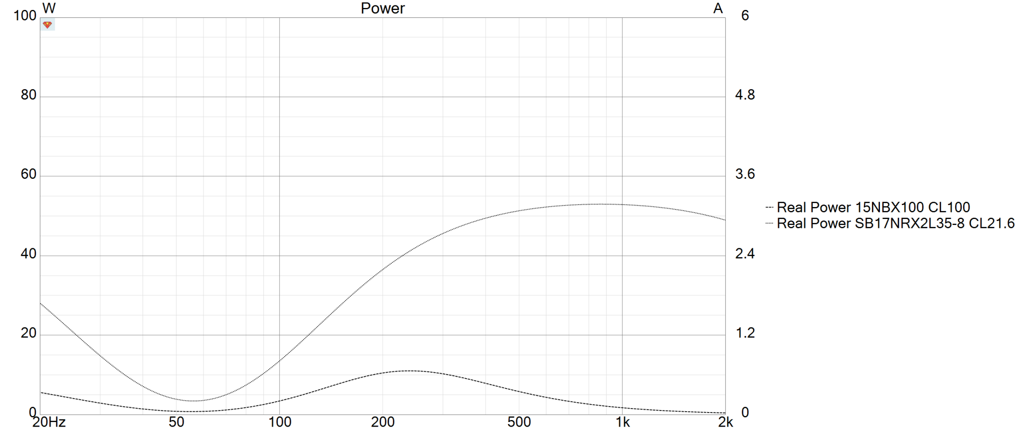

What about Power vs. frequency?

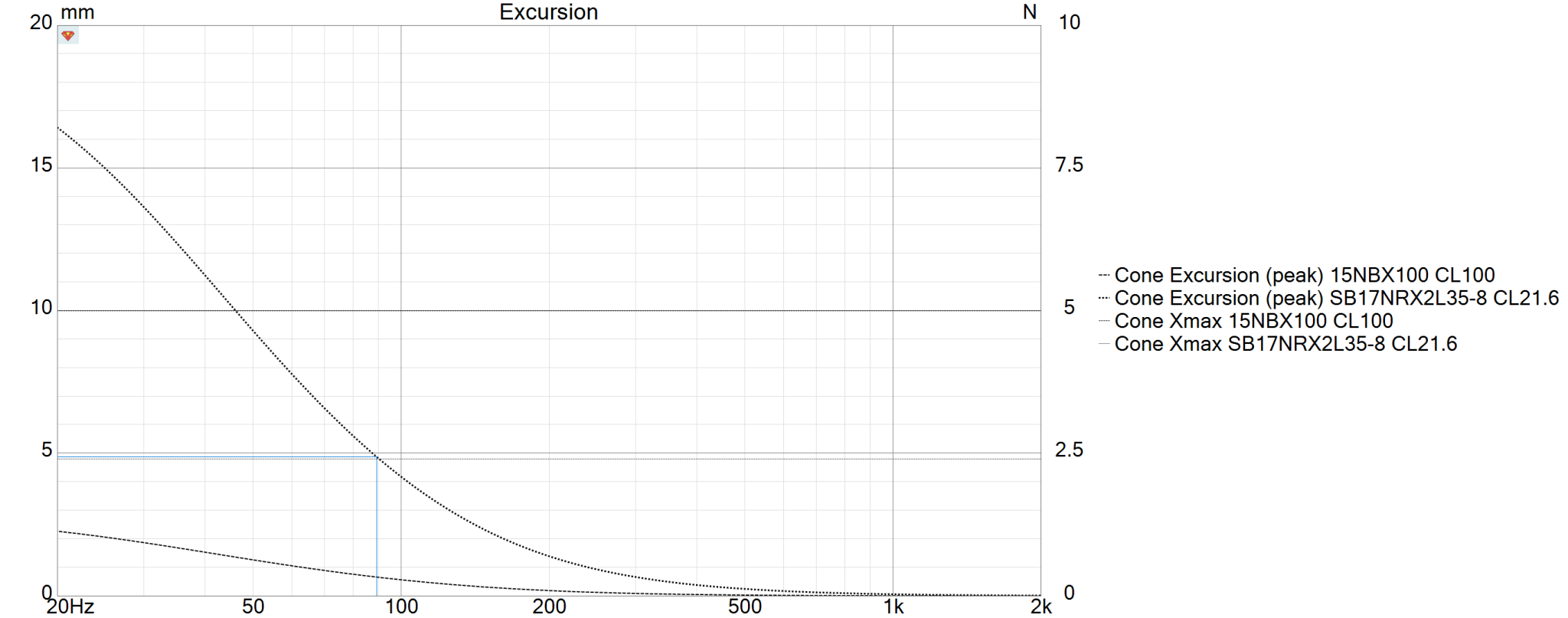

Or Excursion vs frequency?
The 6" is works hard at almost 5mm one-way excursion whenever at musical signal at 90Hz comes along.
The 15" is not even breaking a sweat, at under 1mm, and also fraction of the power.
This is what I would consider a worse case scenario type simulation!
So regardless of whether the smaller speaker has a fancy magnet/motor/cone/frame/spider/surround...
It still has to work much harder than the bigger driver.

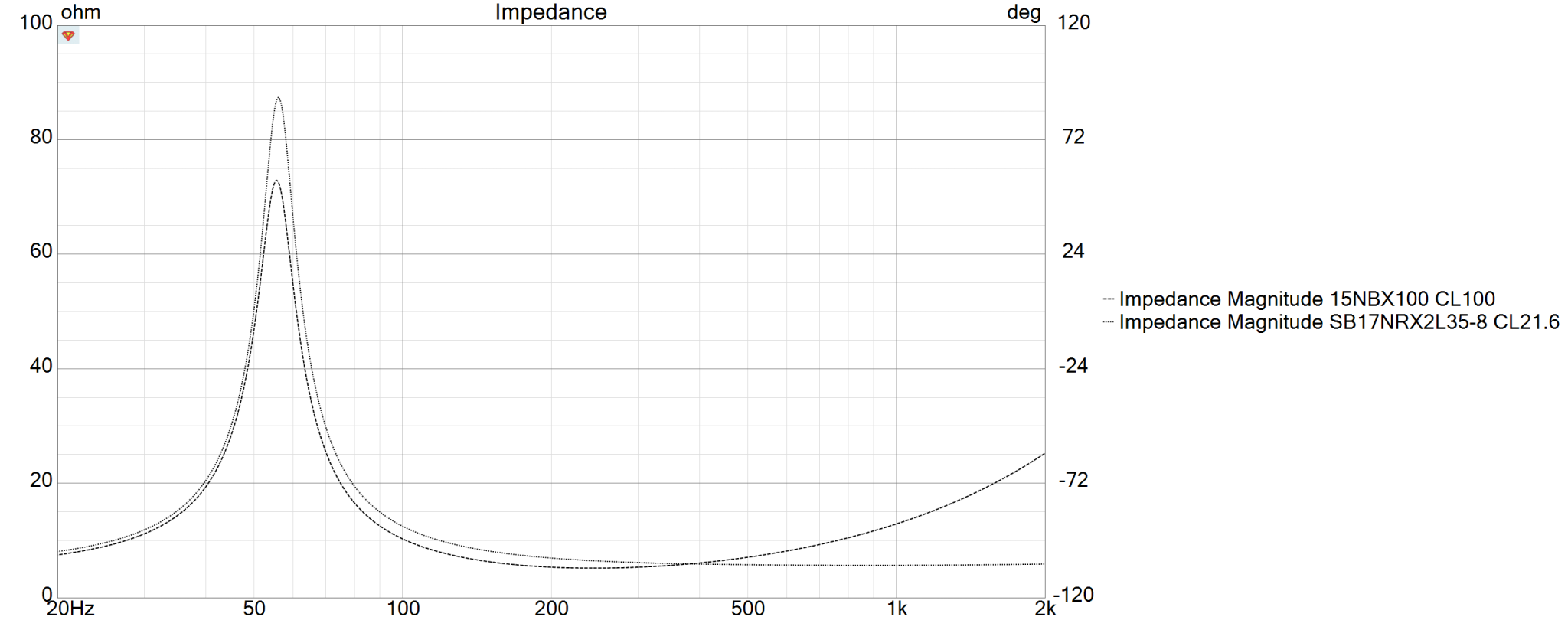

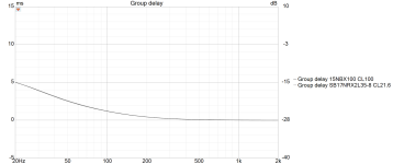

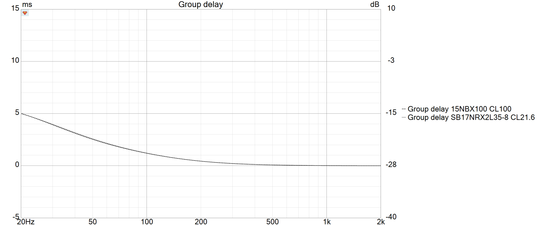

Impedance and group delay plots are attached for review ... but they are the same or very similar.
Of course for home use, depending on where you're sitting, you may not need "reference levels" for SPL.
2) 7.6 volts. That's like 11W into a speaker that's rated at 1000W(!) (AES 2 hour test)

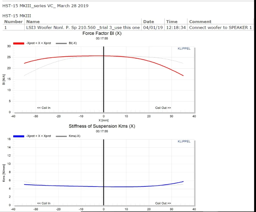

IF you think of it in a single form of increasing the field strength in the gap sure.Cone, more magnet won't do a significant amount.
Adding more magnet as in a Ferrite woofer, using double,triple,quad stack magnets for a higher constant BL(x)/ xmax is likely what he was getting at with the question. As it makes no logical sense to compare increase in cone area to motor strength, instead of 'linear' displacement.
Like the Se HST 15MK3 i added below using stacked Fe Magnets, multiple demodulation rings, a long linear suspension etc. which has 'impressive' BL(x) and Kms(x) even at 20mm excursion.
The directivity issue is moot, and you save physical space in driver size and enclosure sizes etc.
There are some obvious taradeoff that is the requirement of the longer voicecoil assemblies etc ofc.

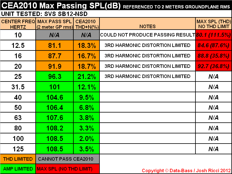

I think those distortion levels are too high for most people on this forum to be acceptable. At 100 dB, I get around 0.5% THD from 15-250 Hz at the listening spot. The double reverse inverted configuration has cleaner sound at the levels I listen at.
To get 96,3db at 25hz (not counting room gain/uncertain), the poor 12" is moving +/- 8mm already.I think those distortion levels are too high for most people on this forum to be acceptable.
Remember stated xmax is usually just a calculated factor depending on % of BL loss.
Suspension nonlinearities kms(x), Le (x) nonlinearities etc. are not standard parameters to find for most drivers.
But you do not use a single, sealed 12" ( that also costs 150-200$ nib).I get around 0.5% THD from 15-250 Hz at the listening spot
A ported encl. will reduce distortion a lot depending on the drivers (x) linearity.
So what kind of comparison is that?
Because it reduces suspension/excursion nonlinearity you will have a reduction of H2, not H3. ?The double reverse inverted configuration has cleaner sound at the levels I listen at.

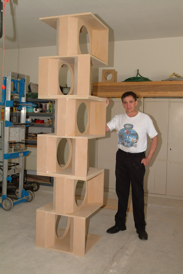

I recall you have four 12” XXLS woofers (835017)?
I also have four 12” XXLS (830845) woofers:
OTOH, Monte Kay has four of these:
Each loaded with six 15” woofers (RSS390HF) So that is twenty four 15” in total.
Meanwhile @Josh Ricci has a 1000L subwoofer. That makes my woofer bin, at 35cm wide and 100L seem tiny. Ok so he has tapped horn, Monte is open baffle, yours are dual opposed and Mine are no opposed. (Just sealed)

With 20Hz at 90dB, my sample of the 835017, in my 1 cu ft sealed box did not exceed 20% H3.
This is similar to data-bass.com measurement of SVS SB12-NSD subwoofer (NLA) that uses a 12” XXLS variant- Max SPL @ 20Hz SPL 91.8dB, THD 18.7% (H3 limited)
Reference:
https://data-bass.com/systems/5b11db42a201f10004e39d7a
Here are 13 speakers measured by Sean Olive:
How did the measurement even record a range of ~50 to ~500 % of “maximum percent of third harmonic” for the 13 speakers?
This is just at 90dB.
What happened?
(See post about this study )
Reference:
What happened?
My point is that distortion is something I would like to keep low. 99% of the time I play music at low levels, probably around 70-75 dB. The double reverse inverted configuration is noticeably a better choice even at those levels. When I play loud, I probably max out at 105 dB. I live in an apartment and have to think about my neighbors. For most people, two 12" subwoofers sound twice as good as one, and four keeps the distortion sufficiently low at high levels. If you're going to buy one driver and cross it at 80 Hz buy an 18". I don't think a single 12" bass reflex configuration is enough for low distortion at higher levels, but I may be wrong.Because it reduces suspension/excursion nonlinearity you will have a reduction of H2, not H3. ?
Low enough distortion is what I'm after. The IMD is of course much higher than THD, but I don't know how to interpret or how to do those measurements. How low is low enough, I don't know, but what I heard from guys with more drivers is that it sounds better.asshatter,
