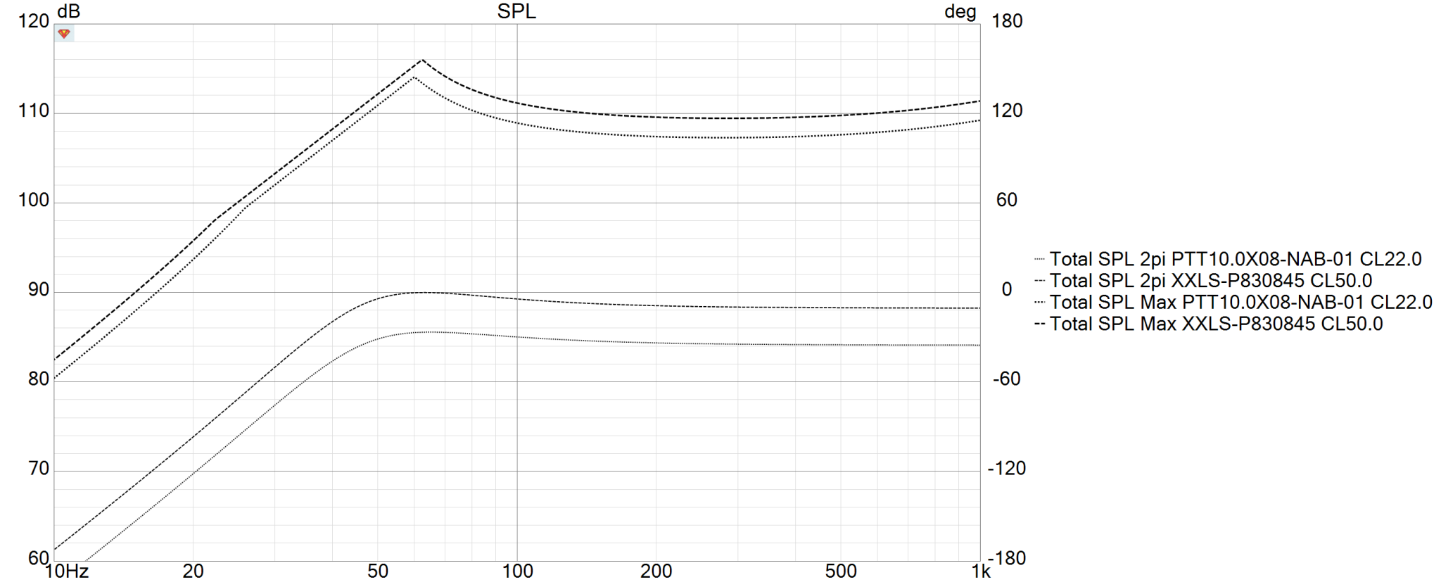

I'm thinking of a 4 pcs 10-12" driver array into relatively small sealed cabinets that I could stack on top each other. The idea is to compensate small cabinets with simply more drivers. The target SPL is 100 dB at 20 Hz without breaking a sweat (small excursion). If 4 isn't enough, 8.

Simulation of four 12" drivers wired in series or 2||2 in 80 liter sealed cabinet shows that one can get ~105 dB at 20 Hz from most high xmax PA subwoofer drivers with 200-400 Watts with DSP (like FaitalPro 12RS430 or BMS 12S305). These parameters are acceptable because it scales up and down by increments of 2 drivers and allows nice headroom (allows lower xmax if using more drivers). I will need to try this with 15" and 18" and see how cabinet sizes change for similar performance. Ported cabs would require way to large volume for a low tuning point.

How about loud and cheap for an array...They don't seem to me to be the typical subwoofer drivers with their - conservatively calculated - 5.65 mm Xmax. Both look more like bass-midrange speakers.
The BMS12S05 appears to be a good woofer with 3 demodulation rings in the ferrite motor, healthy 11mm excursion and big enough spider and surround to support it.
Here's 4x BMS12S05 in series parallel in 80L sealed
... vs 1x SAN18.403 in 80L
You have a 3dB advantage at 20Hz with 4 twelves.
The SAN18.403 has a neo motor with a single alu demodulation ring.
But a €600 advantage and weight advantage of of 15kg (1x11kg vs 4x7kg)
Do you have ability to EQ?
If so, consider starting off the the lighter cheaper variant and see if it's enough for you...
