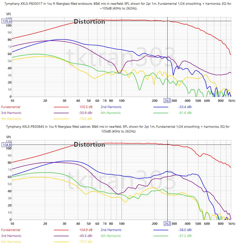

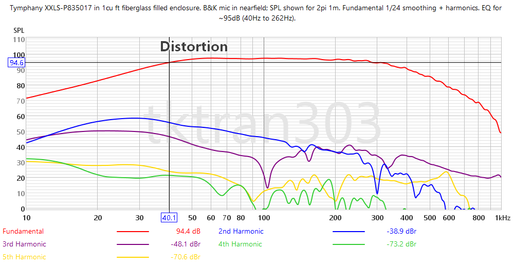

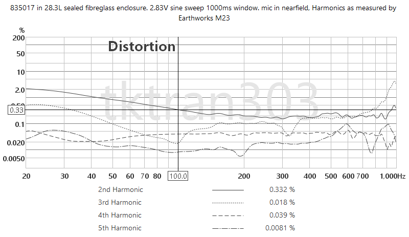

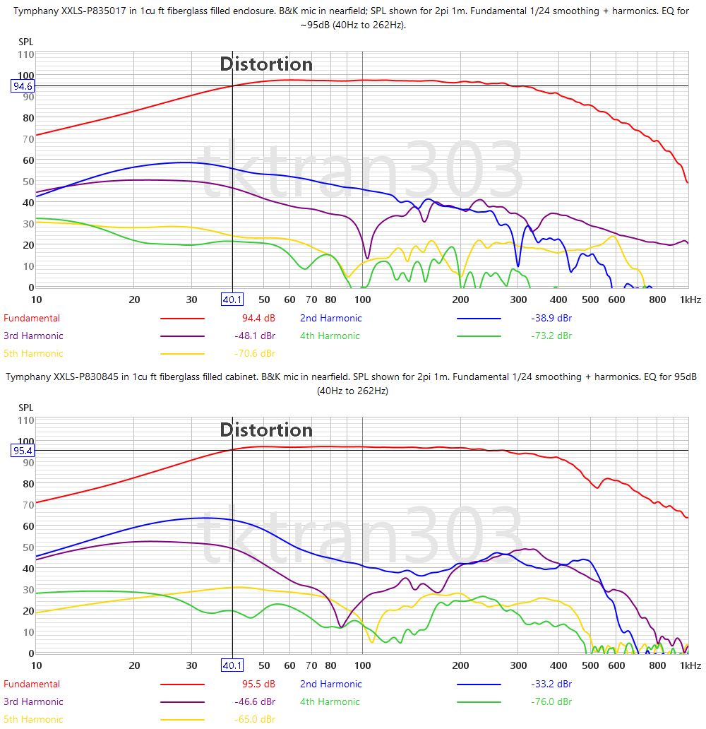

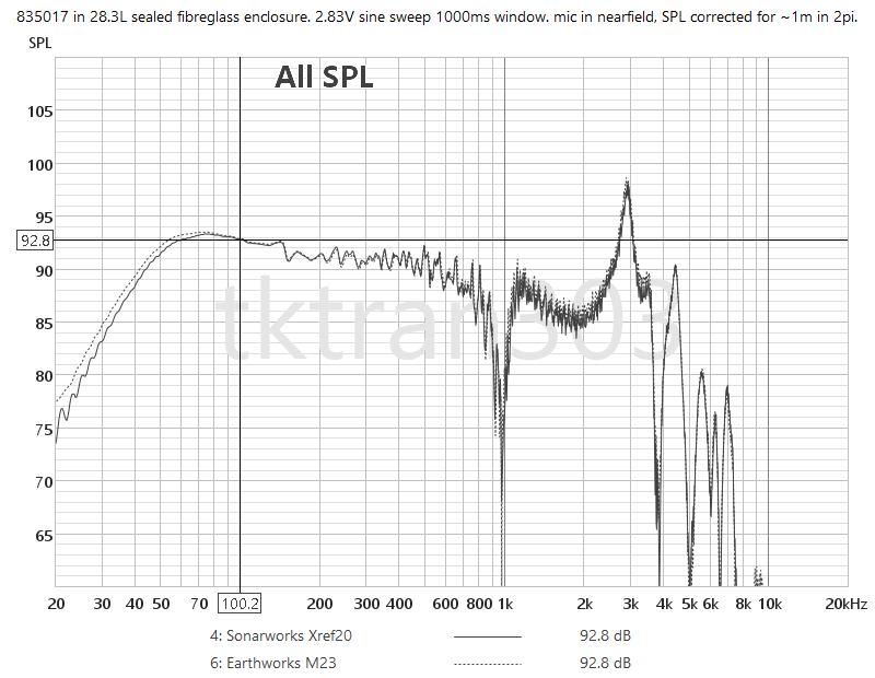

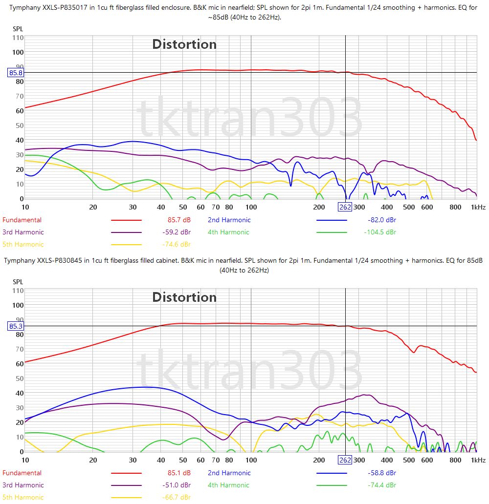

Here's my measurement taken some time ago, in the nearfield, with 2 different microphones.
The level of imprecision starts to increase somewhere between 100-200Hz and fluctuates even more as the frequency gets higher. The usual rule of thumb of 4311/diameter of cone" = 4311 / 10" = 431Hz is a kind of soft boundary.

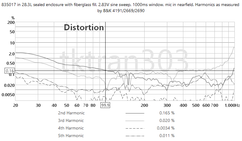

The upside of taking a nearfield measurement is that the signal to noise ratio is higher, so one can actually peek into the harmonic distortion more clearly. The downside is that the microphone is exposed to some 110dB... which may be result in microphone self distortion.

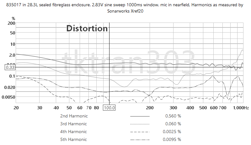

Here's the harmonics as measured by the Sonarworks Xref20 and Earthworks M23:
It unclear how important these measurement of harmonics is.
But for a start, we need to measure them properly if we are going to make meaningful correlations.

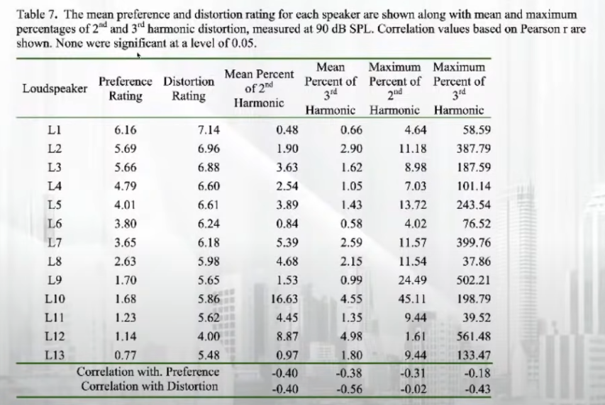

Here are 13 speakers measured by Sean Olive:
Unfortunately haven't found the original study. If anyone can point me to it, I would be most appreciative.
I'd like to know the measurement conditions. Were there limitations to the microphone, amplifier or measurement method? By method I mean- was this the Maximum Length Sequence (MSL- pre-1999) method, or log chirp (aka Sine Sweep- post 2000, after Alberto Farina presented his paper at AES)
Did anyone apart from @5th element notice that the speaker with highest preference rating also had the highest distortion rating (lowest distortion overall). 🥷
And for speaker L12, it's maximum 2nd order is lower than it's mean.
"I'm no maths major, but but how can the peak be less than the average?"
From my point of view, how did the measurement even manage to register a maximum H3 of 50 to 500 % for the 12 speakers?
Suppose it not due microphone or method, and this distortion is of the bass region, where distortion is typically the highest.
Measuring bass distortion is no trivial task.. and is reason why there are different proposals ow how to do it more accurately eg. CEA2010, CEA2010B, CTA2024-A.
Can you please name 2-3 of them, because it would be very good to know?

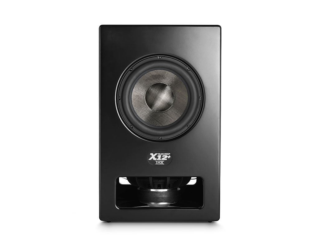

From what I understand, it's been done since 1989, by Ken Kriesel in his push-pull subwoofers:
Designed by Kreisel, a new innovation in subwoofer technology: Push-Pull drivers, used in M&K’s new MX Series. Push-Pull is achieved by mounting one driver physically backwards in the cabinet and wiring it backwards as well, causing both driver cones to move mechanically in the same direction. The result is acoustic cancellation of even order harmonic distortion, cleaner, tighter and more accurate musical bass reproduction, and significantly improved high-output linearity
Reference: Miller and Kreisel timeline
Here's a modern incarnation-
You can do it in dipoles too:

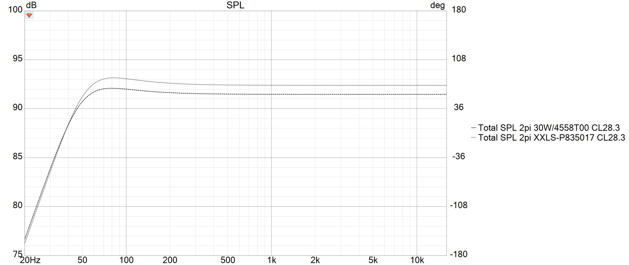

That's would be the one. Same 4 ohm, alu cone.
Models the same, apart from minor sensitivity difference (-1dB). Though this could certainly be within margin of error that would be inconsequential in typical use as a 4 ohm subwoofer.

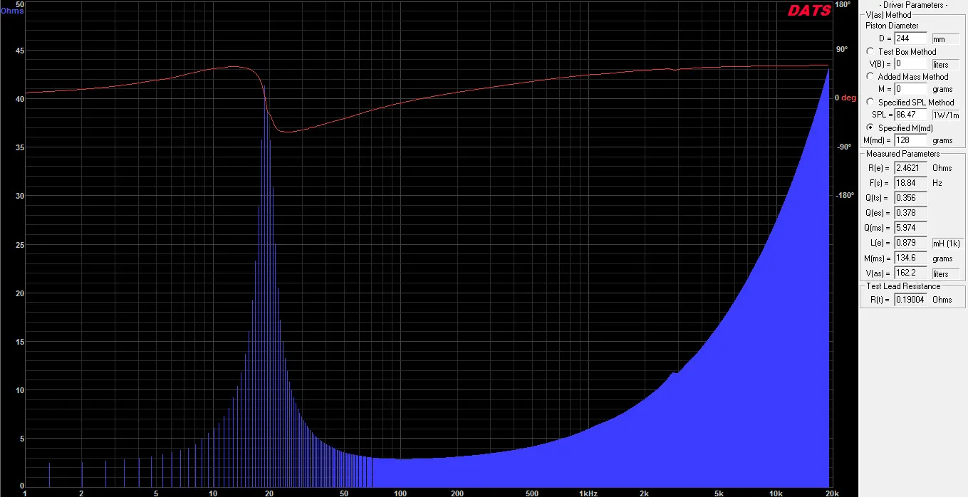

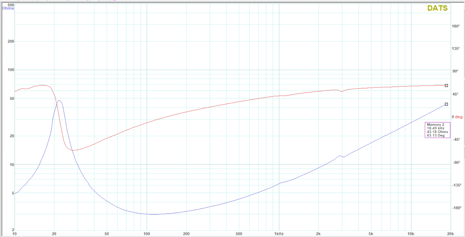

My 835017 free air impedance sweep:

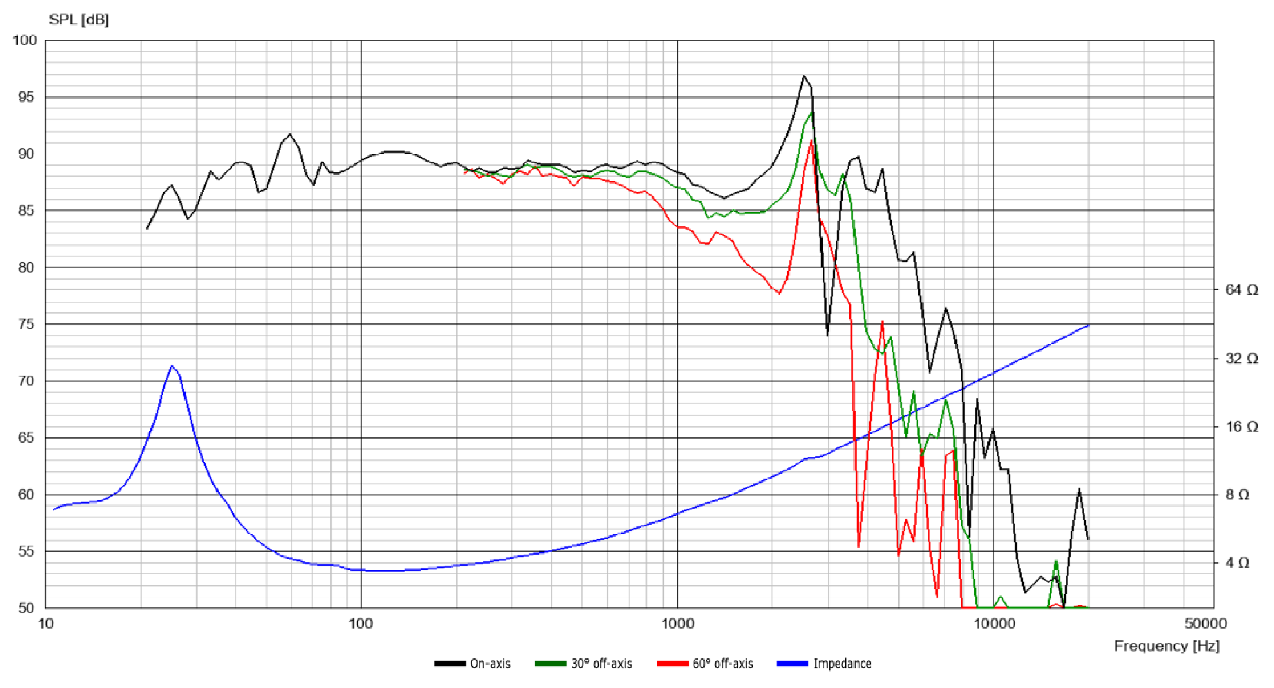

Here's the Scan-
from Scan-Speak datasheet:
https://www.scan-speak.dk/datasheet/pdf/30w-4558t00.pdf
Indeed a close match to Tymphany datasheet eg.
The Scan has different basket and dust-cap (fibreglass). It may be a better performer in the midrange.
Unfortunately I do not have any samples to nitpick it's comparative performance, so I will refrain from further speculations.
Besides, if you are using below 150 Hz only (subwoofer applications) practical considerations may be more important eg. 4 ohms vs 8 ohms, availability etc.
Lessons:
1) SPL must be specified (apples to apples to comparison)
2) Microphone must be specified (different mics distort at different SPLs)
2) Process must be specified
ie. different results from calculations eg. Maximum Length Sequence eg. JustMLS, MLSSA, Clio,
Or sine sweep (Clio, ARTA, REW) or stepped sine (STEPS) or FSAF (REW 5.40b40)
3) if higher order harmonics are bunched up- suspect that the Noise floor is limiting ability to measure at.
Without this- beware of distortion measurements. Actual driver distortion is probably a lot lowerthan what's shown.

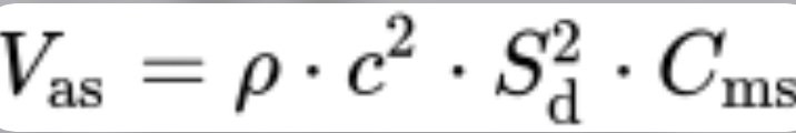

Let’s go back to the original definition of Vas. It was defined publicly for the first time in 1961 by Neville Thiele of the Australian Broadcasting Corporation.
P being density of air
C being speed of sound
Sd- Equivalent piston area of the driver diaphragm
Cms- Compliance of the driver's suspension, in metres per newton
At first glance, it might appear that these are fixed quantities. However, we now know that in cone movement-
Cms is variable (Klippel et. Al)
Sd is variable (Steve Mowry)
So Vas is in fact variable with cone movement.

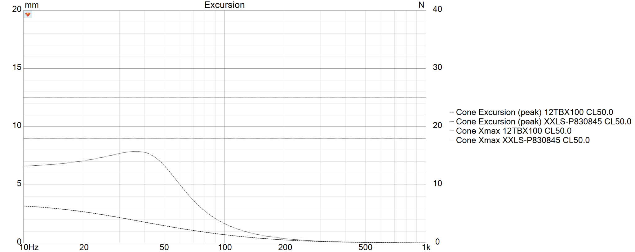

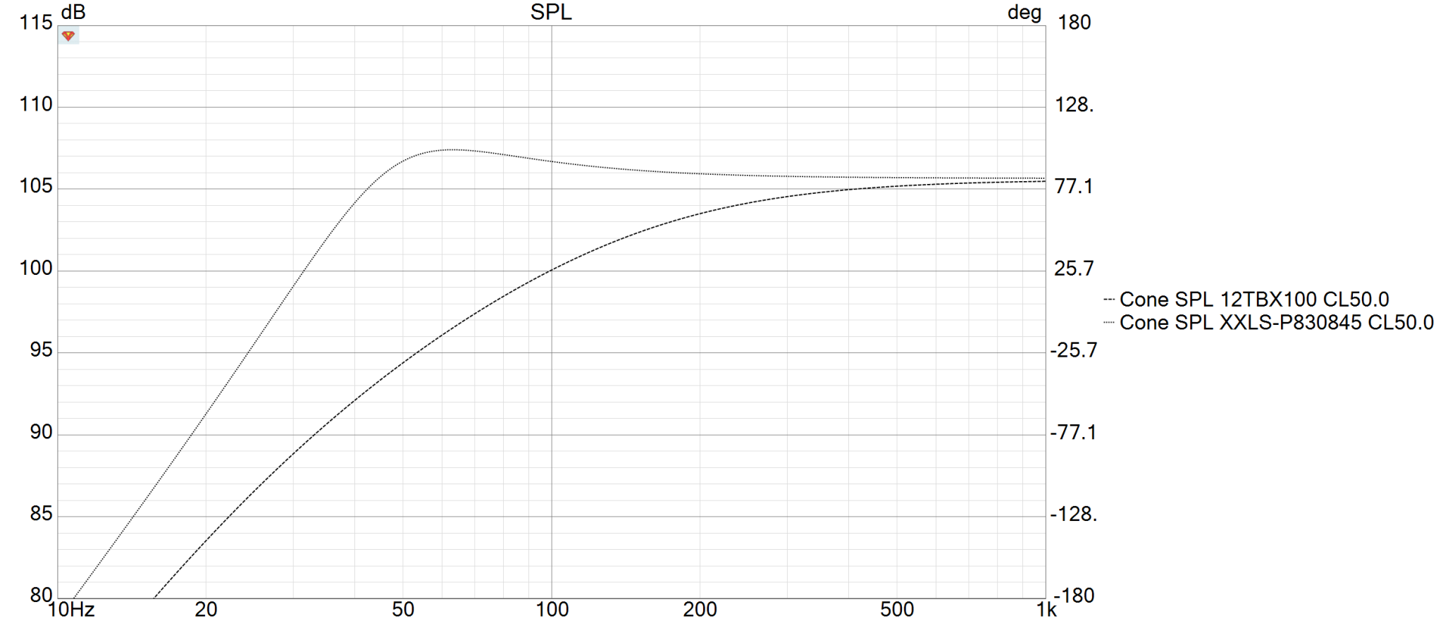

I recently simulated a 12" B&C midwoofer in a 50L cabinet, similar to what I used the 830845 in (50L)
Note:
At a whopping 105dB@1m ie. lifelike / THX /Atmos "reference" levels,
At 80Hz the cone excursion is just 1mm for the 12TXB100
At 80Hz, the cone excursion is 3mm for the 830845
If you don't want separate subwoofers than the 830845 is a better solution, as it is 9dB higher SPL at 80Hz.
But with the use of separate multiple subwoofers, a 12TBX100 in a 50L closed cabinet is a better solution from 100Hz upwards is better from an purely acoustics point of view. The SPL and dynamic range will be higher, the amplitude modulation distortion will be lower.
