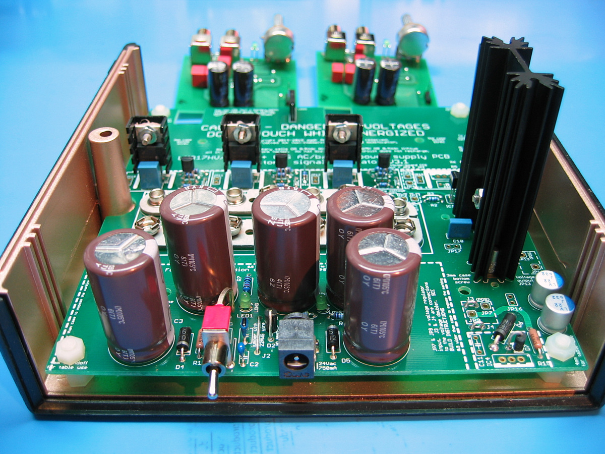

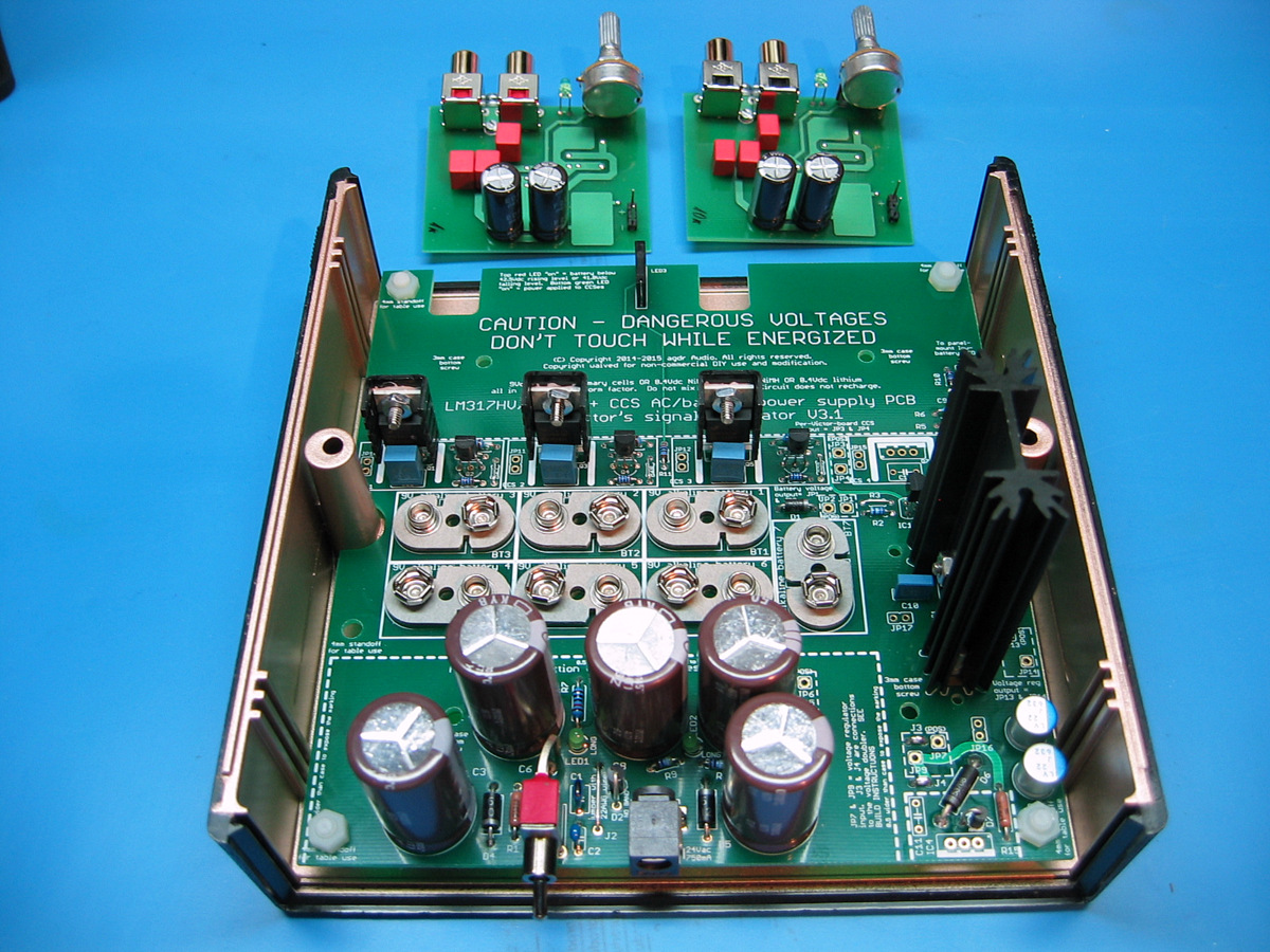

Victor board mounting on the front panel and wiring photos - part 2
More photos...

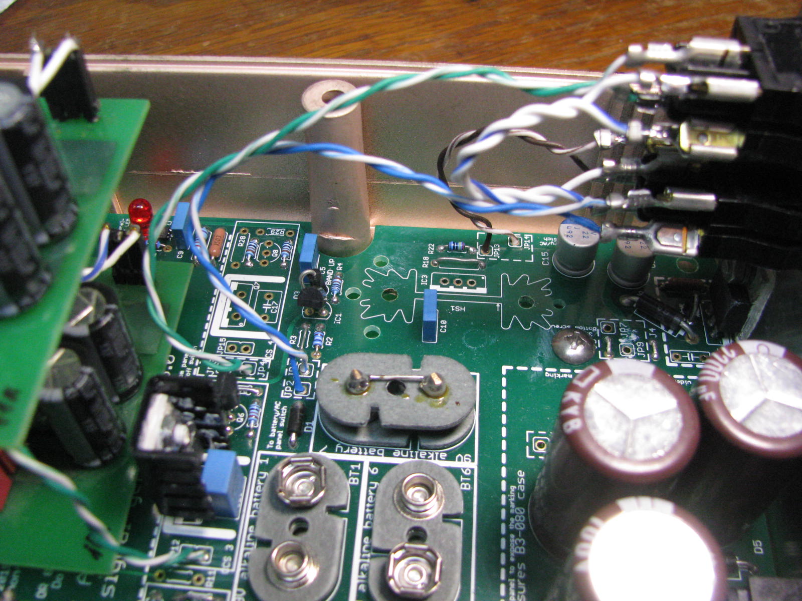

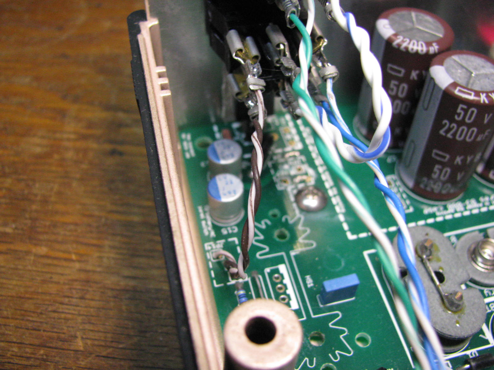

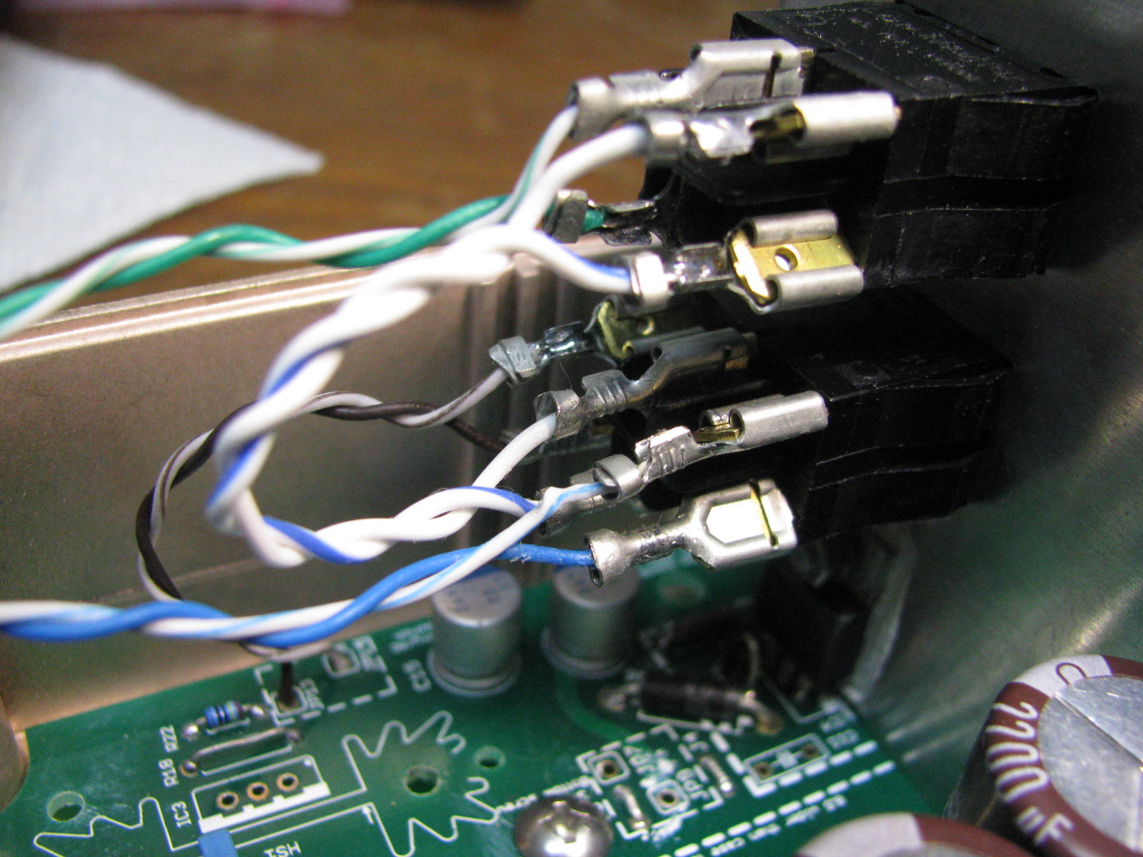

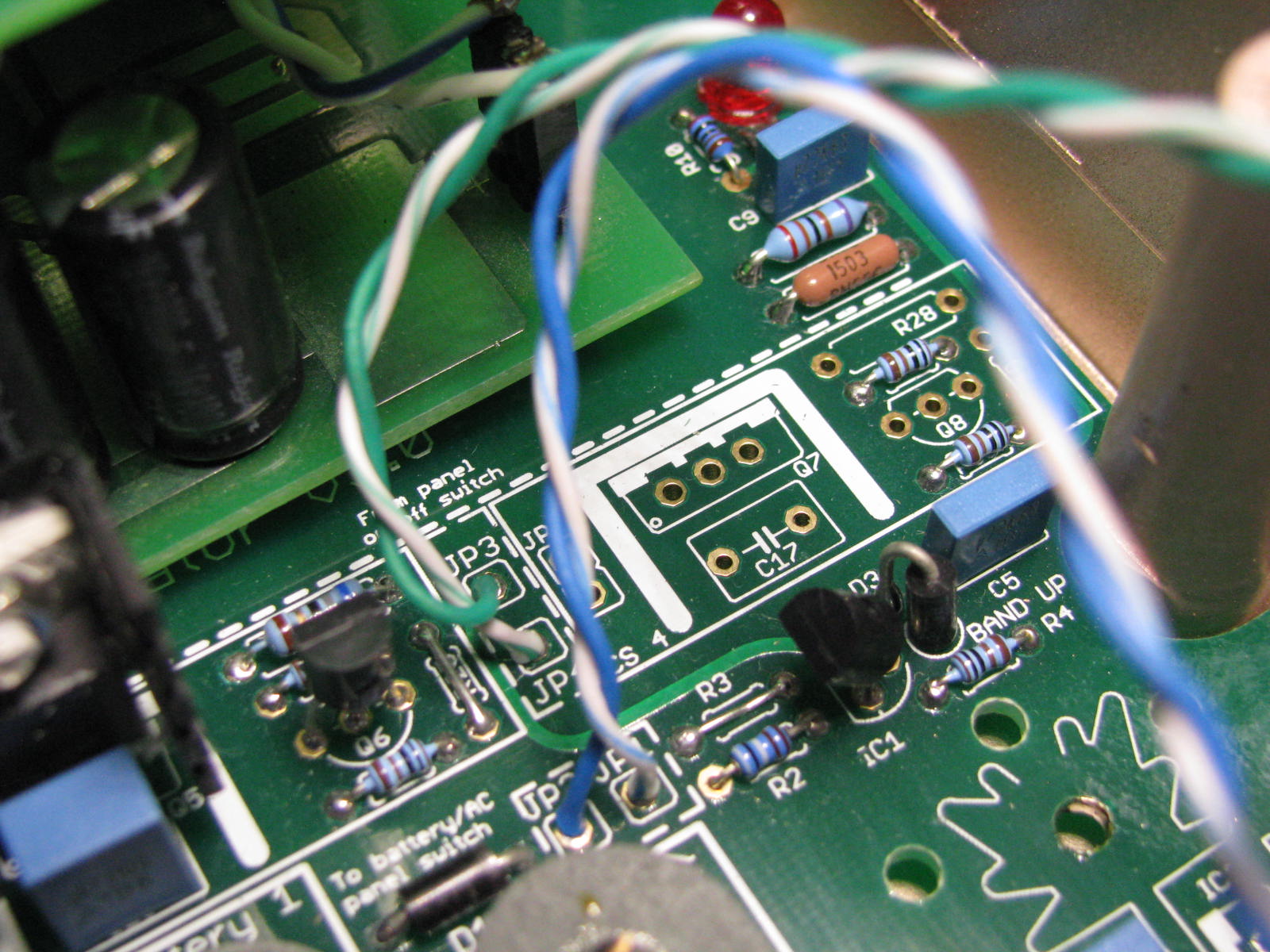

* The next 4 show the wiring to the rear panel switches. Again, the obvious thing, be vary careful to mind polarity in all of this! I believe I have the positive terminal marked on each board section.
So I have a green/white pair going from the CCS row feed to the middle contacts of that top rocker on the rear panel, which is the CCS cut-off switch. Then a short twisted pair jumper goes from the near side of the that switch to the middle contacts of the DPDT below, the AC/Battery select switch. So whichever you select - AC or Battery - gets sent up to that CCS on/off switch and on to the CCS row. I put that top switch there just as a handy way to turn off all 4 CCS (and hence all 4 victor boards) at once, without having to turn off each front panel switch.
Then the blue white pair from the battery section output goes to the near side DPDT contacts, while a brown/white pair comes up from the voltage regulator outputs to the far side DPDT contacts.
I'm just using CAT5 pairs here. But I built up one of these for another forum member last year and I used some since multi-strand silicon covered wire. I love that stuff, it is extremely flexible.

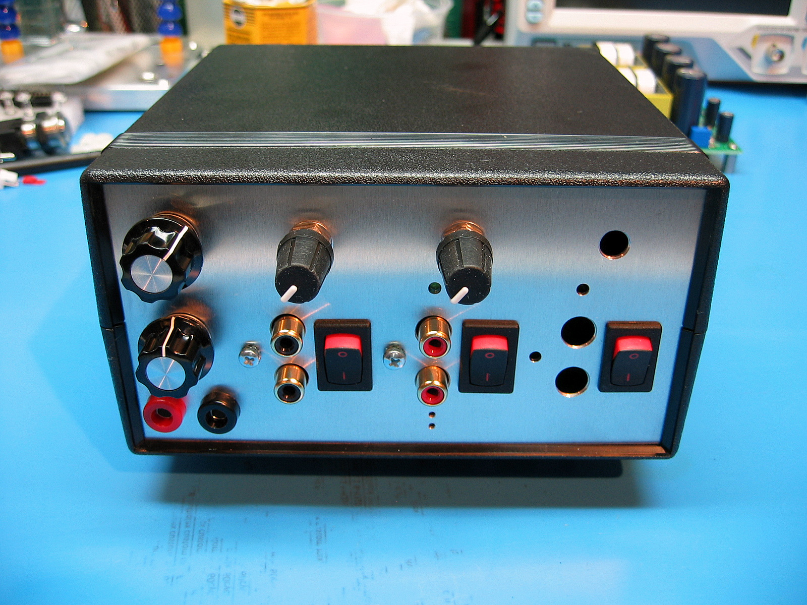

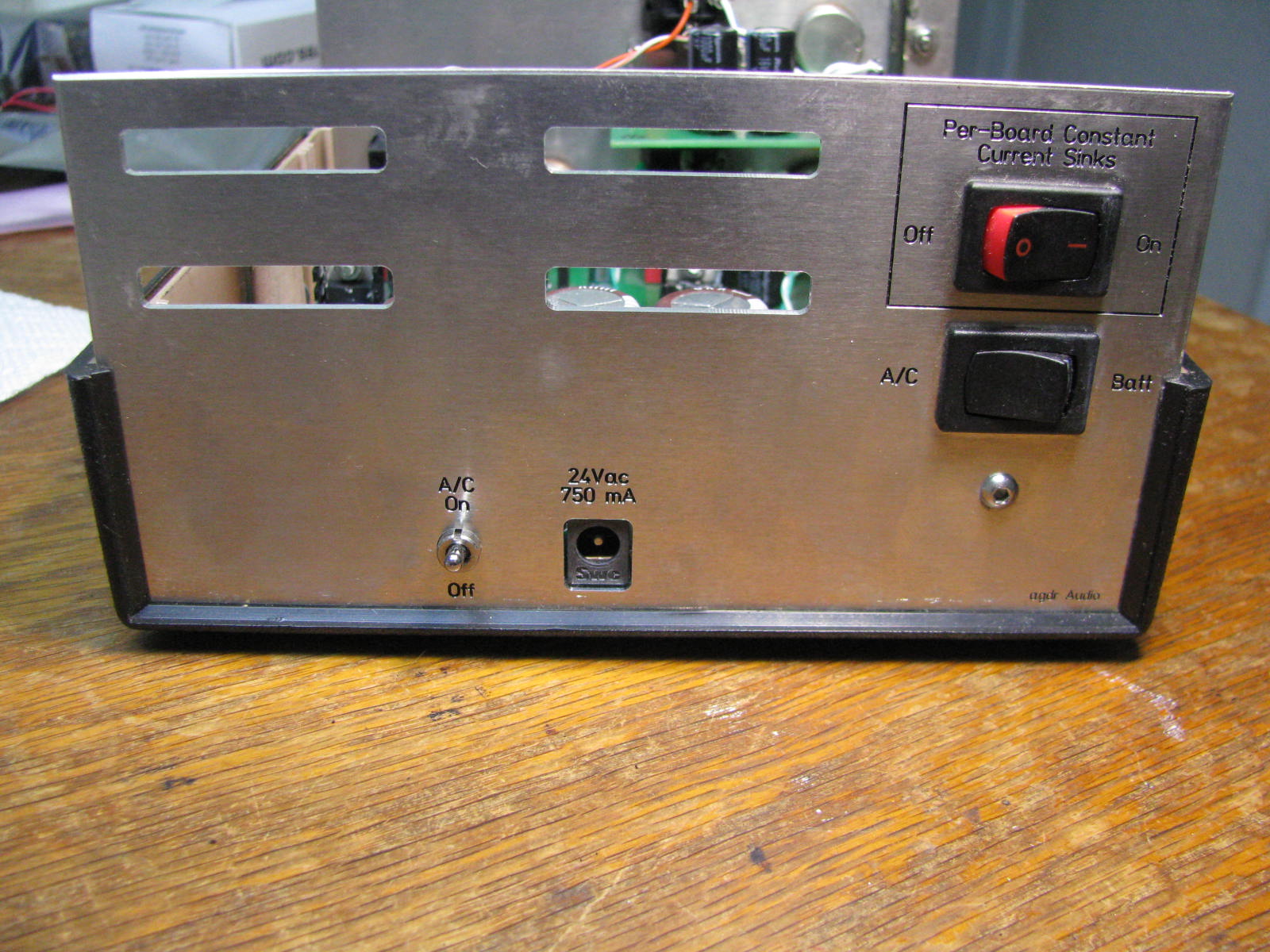

* The next two are just the back panel switches with the labelling, as a reminder of which goes where.

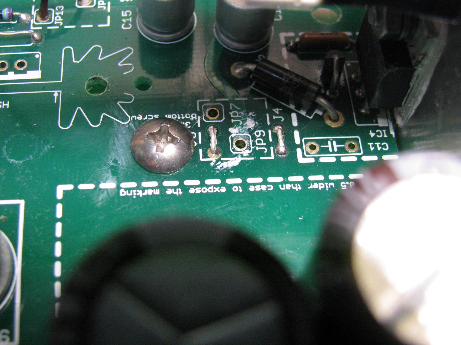

* The next two show one of those truss head screws doing its thing, the voltage regulator mounted on the rear panel with the insulators, and also the two jumpers there near the screw. Don't forget about those two, they pass the power from the votlage doubler on to the voltage regulator section.
Those jumpers are there so the batteries could be fed to the voltage regulator section instead, if someone wanted.
I don't have C11 installed because intially I had the voltage regulator over in the heat sink position, with a heat sink for table top use while
I was waiting for my rear panel to arrive, ao I populated C11 instead. C11 and C10 are in parallel. I just didn't have the motivation to remove C11 and move it to C10 after de-soldering the vreg / heatsink and moving the vreg to the rear panel position. So your board is correct in having C10 populated. That really is where it should go if you are using the rear panel position for the vreg.
* Finally a close up of the battery and CCS power feeds.

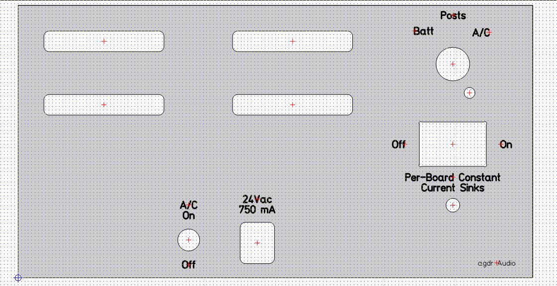

New, optional, rear panel update
Here is an update on the new rear panel design with the DP3T rotary switch, preliminary picture below. So far so good. The lower rocker switch now becomes the master cut-off for the per-board constant current sinks (was the upper switch). The rotary switch for battery-binding posts-AC is now on the top. I did a bunch of calculations today and the body of the rotary switch behind the panel will fit in the space just fine, clearing both the Hammond case lip on the top & right and the rocker switch edge on the bottom by several mm.
But.. there are angles involved, lol. I'm going to have FPE fabricate one of these so I can test it before I post it on out the Google drive link. As luck would have it I don't have a knob here that fits the 0.25" D shaft. I've ordered some in from Digikey. I **think** the keyway on the switch is at 30 degrees from the bottom, where I have it here, best I can figure out from the datasheet mech diagram. But that really needs to be tested, and that is assuming the line on the knob-being-shipped is where I think it is relative to the D shaft flat.
So long story short it will be a few weeks before I have the new rear panel design posted. But in the meantime the existing design using 2 rockers is still there at the project Google Drive link. I posted an update to that today which makes the text and engraving a little bolder, went from a 0.2mm engraving tool to 0.4mm. I have tested that on a past panel, I just hadn't posted it yet.

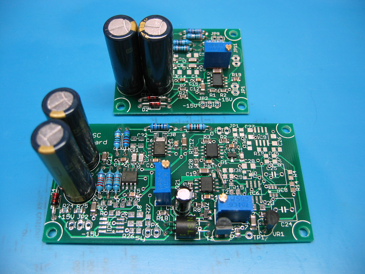

Getting closer. A trio of oscillators coming up!

What 3rd frequency would be the most useful if I already have the 1k and 10k Victor boards? That third spot is starting to look lonely!
BK
Trust me, it will look even lonelier as time goes on! I've regretted not putting a 4th Victor board in my existing case. In the second case I'm building up I'm putting in all 4 boards. Most of the cost with each panel is one time setup for the drilling and engraving, the way Front Panel Express prices things. Adding a few more holes for another Victor board only adds a dollar or two to the cost.
In my existing I have 1KHz, 10KHz, and 11KHz. Those last two are useful for two-tone IMD measurements. As for mixing the two tones, Victor says it is OK to simply connect the two oscillator outputs with an RCA Y cable, since the oscillators have 600 ohm output resistors. An alternate way is to make an op-amp inverting summing circuit:
Summing Amplifier is an Op-amp Voltage Adder
For my second box I'm having Victor build up 260Hz, 7KHz, 19KHz, and 20KHz boards for me. More two-tone IMD stuff, the 260Hz + 7KHz and the 19KHz + 20KHz. The odd-looking 260Hz number was picked just to avoid power line harmonics.
So maybe consider an 11KHz board! If anyone else out there has some thoughts an a 3rd frequency, please do post.

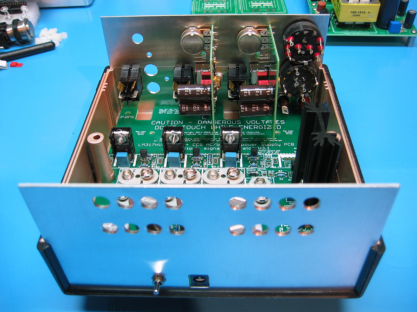

Nearly done. Made some tweaks to agdr's panel layout to move the controls to the front and implement simple banana plug inputs. After a bit of hand drilling and filing and everything fits nicely!
Will probably put some small vent holes above/below the heatsink and see if that works out. If not, I'll move the regulator to the rear panel alternate location.
