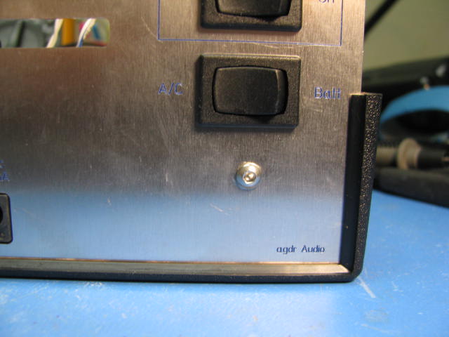

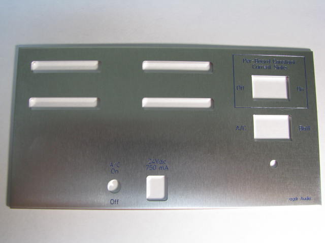

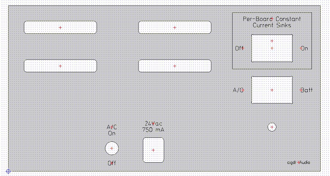

I finallly have the rear panel CAD file for this project done, attached below and also out at the Google Drive link in the first post in this thread.

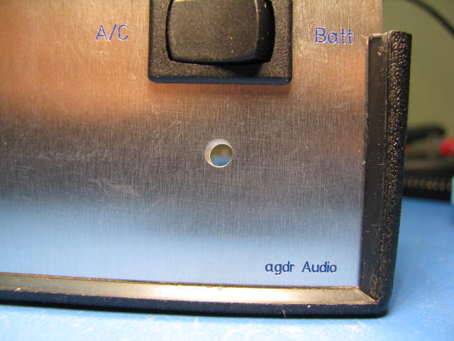

Front Panel Express made a mistake on the first run of the panel (scratches on it), but they have been good enough to re-run it at their expense and allow me to fix a couple of screw-ups I made at the same time.
The power jack hole and the mounting hole for the voltage regulator bolt are just exactly spot-on, as the photos show. 😀 However, here is a build tip for both the power jack and the stacked LED on the front panel. There is a small amout of "wiggle room" in the PCB holes on both, around 0.25mm or so in either direction. I used the datasheet recommended holes sizes, which always tend to run just a hair large.
When soldering those parts please be sure to have them lined up as closely as possible to match the silk screeen part outline. The best way is just solder one lead first, then flip the board over and check positioning. If needed re-heat that one lead as many times as need to get the part placement perfect, then solder the remaining leads.

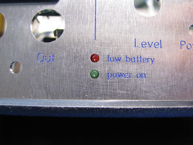

On this one the LED was slightly off to one side, covering up the part silk screen ouline on that side. So I solder-sucked it out and re-did it per the above. Compare the front panel LED photo now to the one I posted weeks ago above. Perfectly centered in the holes now.
* photo 3675 shows the rear panel as shipped from FPE.

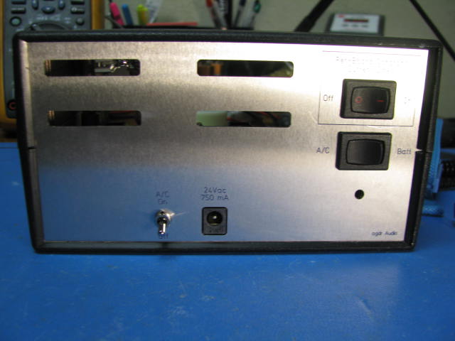

* 3693, 3694, and 3695 show the fit of the rear panel int the Hammond case. in 3695 that is looking through the panel hole and the hole in the tab of the TO-220 LM317HV on the back of the panel! Lol, it doesn't get much more exact than that. Make sure the LM317HV is all the way down on the board as far as the leads allow when soldering it in. Remember that if the rear panel mounting position is used like this the heat sink position on the board doesn't need to be used. They are wired in parallel.
* 3697 is the front panel LEDs now that I solder sucked it and repositioned the part so it fits exactly in the board silk screen outline.

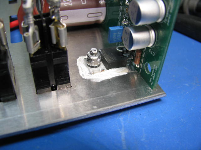

* 3703 and 3704 show the LM317 heat sinked to the rear panel using 3mm stainless steel button-head mounting hardware from Bolt Depot.com. That is a 3mm nylon insert acorn nut on the back. I've gone to those lately in place of a 3mm lockwasher and nut - easier to work with. The standard mica washer, nylong TO-220 hole washer, and heat sink grease are used here to insulate the chip from the rear panel.

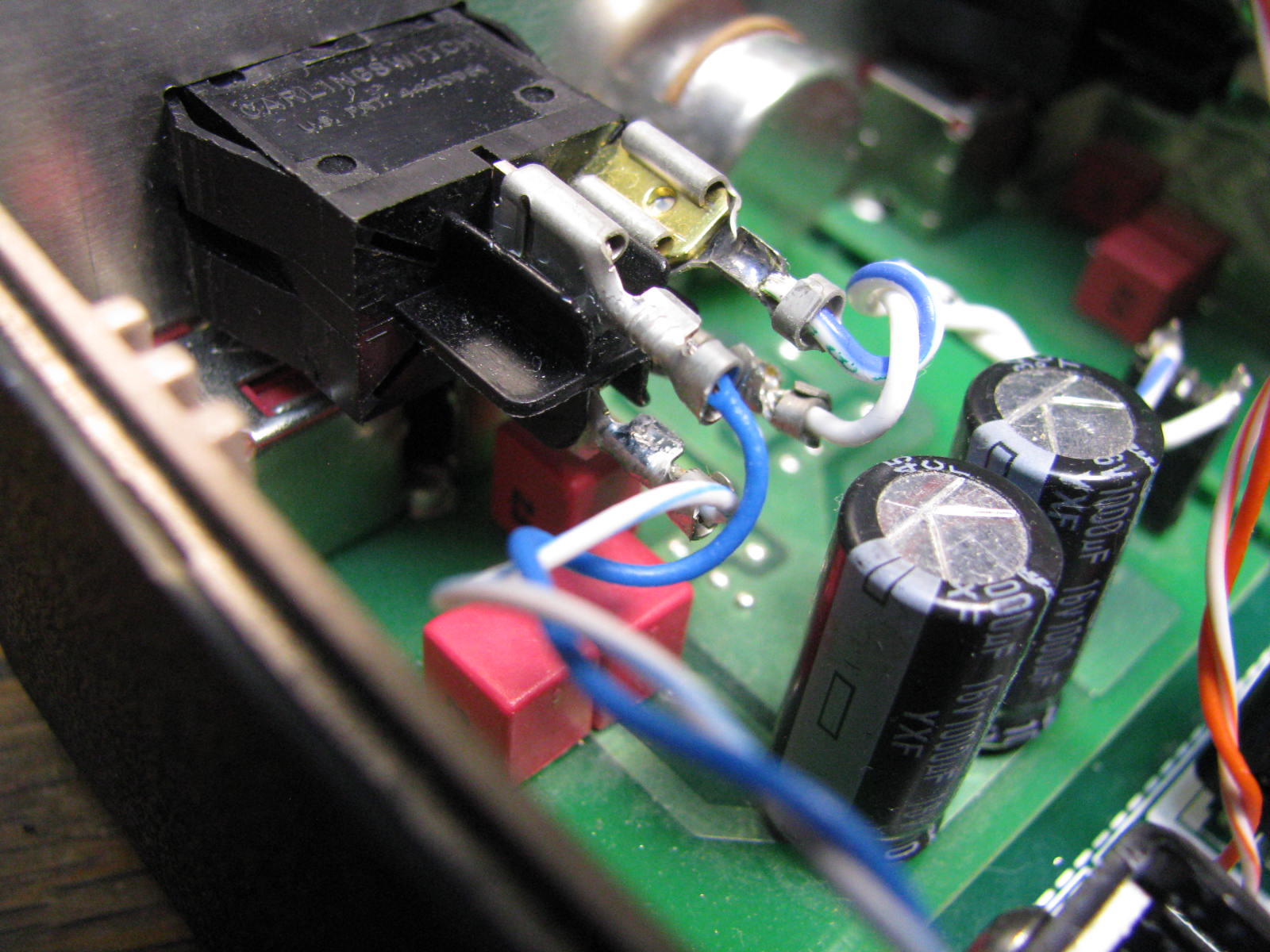

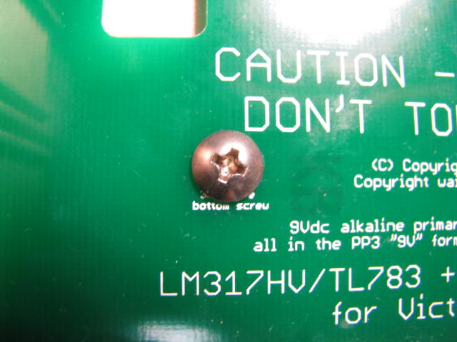

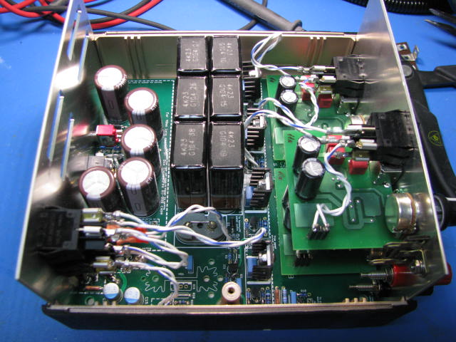

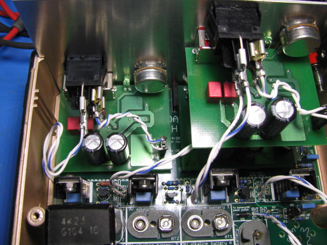

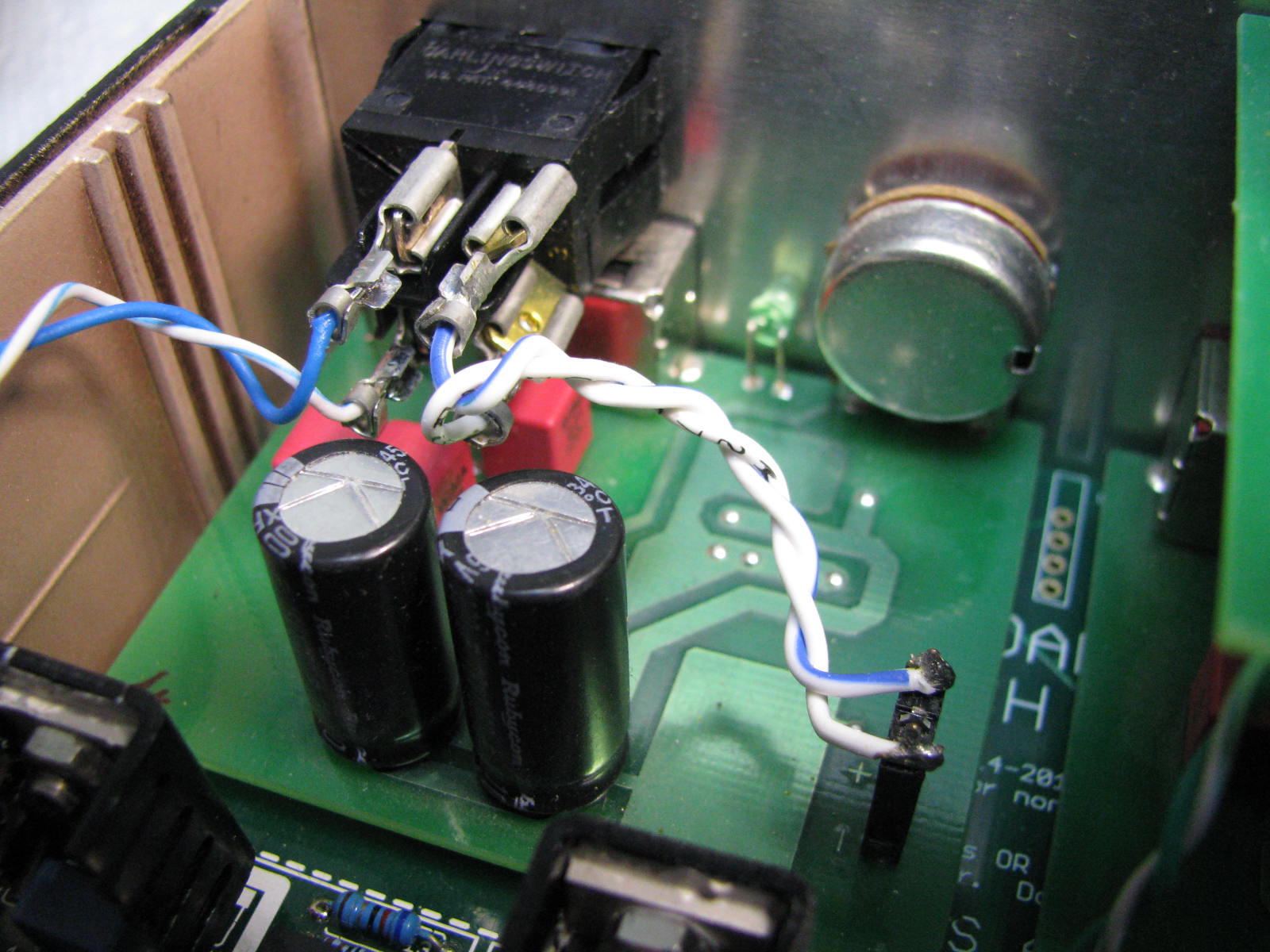

* 3705, 3706 and 3707 show the #6 x 1/4 truss head screws from Bolt Depot for securing the board to the Hammond case. This is the size screw Hammond recommends. The super-flat truss head is just the thing for use under those Victor board (2 of the mounting holes are under the lower oscillator boards). 3707 is a sideway's shot showing the height of the screw head.

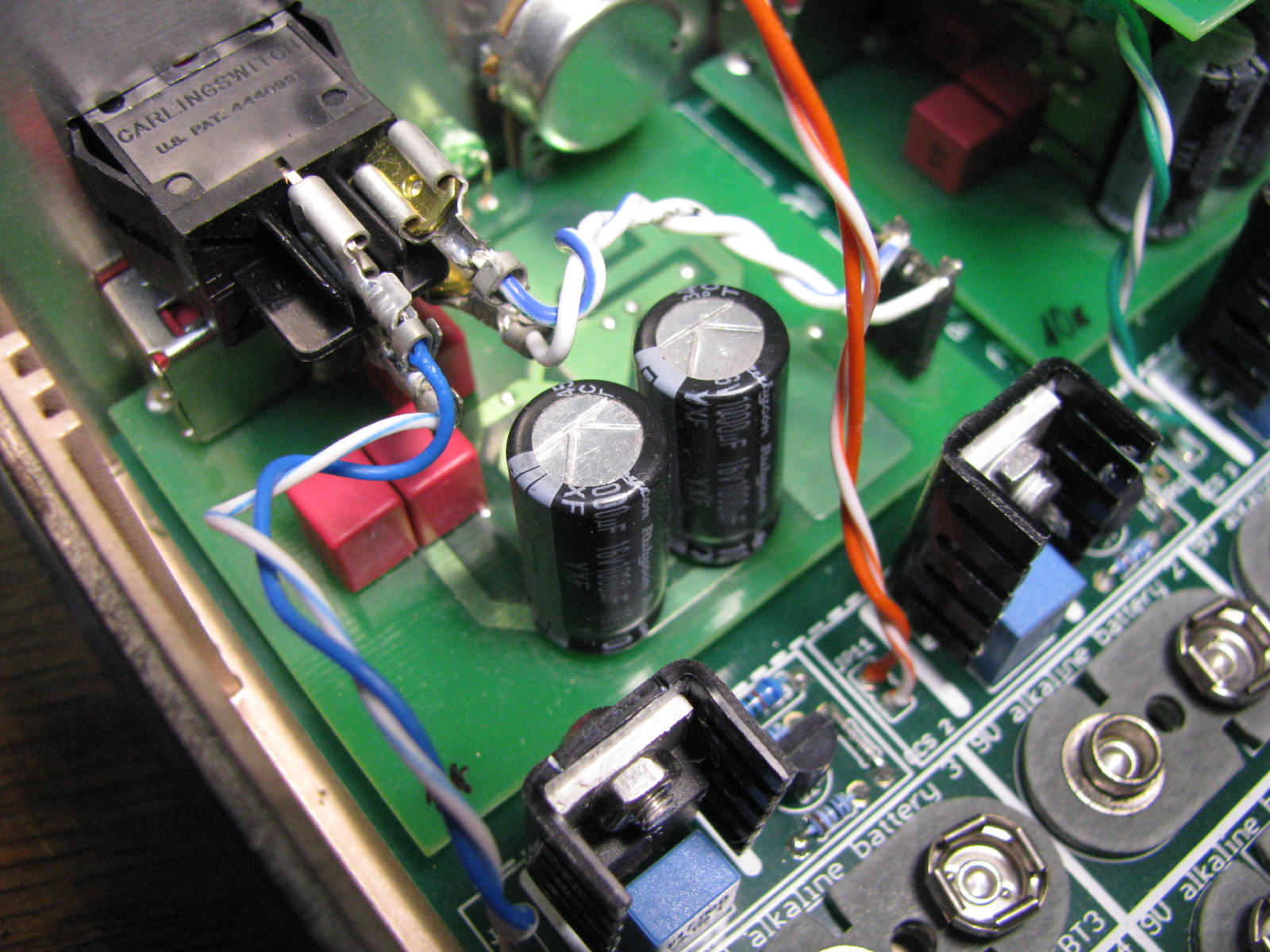

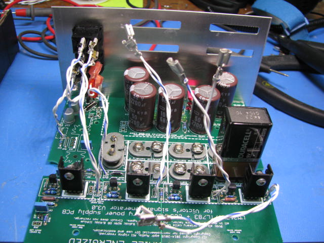

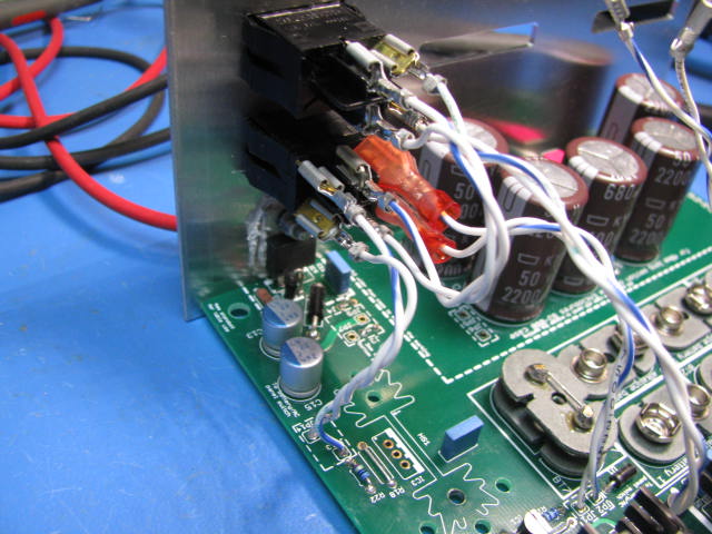

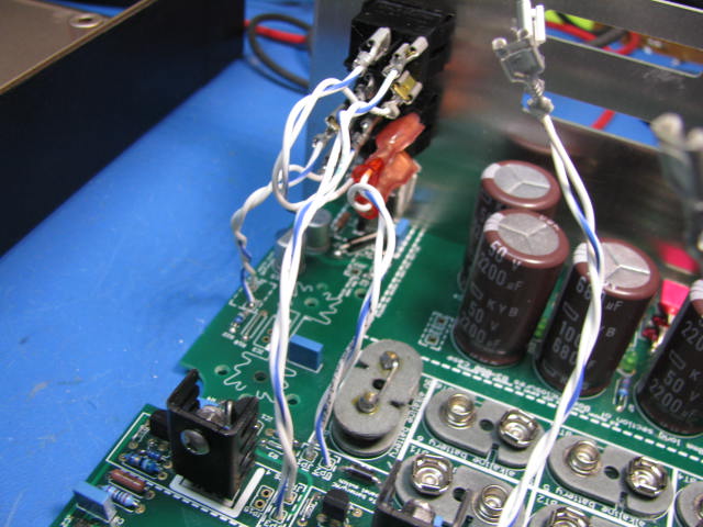

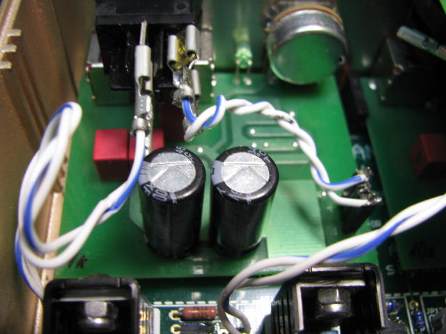

* 3700, 3701 and 3702 show the wiring of the two switches on the rear panel. The bottom switch is a DPDT that selects between the batteries or the output of the LM317HV voltage regulator, fed by the voltage doubler. In this case I've populated 6 of the 9V batteries (around 54Vdc), while the voltage regulator is set for 48Vdc.
The output of the DPDT then feeds to one set of terminals on the top DPST switch, which then goes to feed the row of constant current sinks. This switch is just there to cut off the power to the CCSes entirely to preserve the batteries, if they are being used. There is no particular reason I used insulated fastons for the one wire pair here, I was just trying out the crimper. 🙂 The insulated fastons actually won't fit on the middle contacts of the switches, plus the crimper & dies from Amp/TE were insanely expensive, so the (wire soldered on, not crimped) uninsulated Fastons used here are the best way to go.
The wire I've used here is 22AWG 19-strand twisted-pair silver-coated teflon insulated stuff (from eBay), a notch up from the ethernet cabe strands. I've used the convention throughout to keep the top terminals on all the switches as positive, the wire with the blue stripe.
* The remaining 4 photos show the front panel switch and Victor board wiring with the front panel installed. I've used the same convention here, top switch terminal and blue stripe wire is positive. Each board has a short twisted pair that goes from the Victor board connector to the switch Fastons, then from there to one of the constant current sink sections. I haven't pushed the Fastons coming from the CCS sections fully onto the switches here because I needed to remove the panel after the photo. With the Fastons pushed in all the way they have plenty of clearance to those tall electrolytics on the back of Victor's boards. I've left off the 7th battery at the end of the row (it is jumpered with a shorting connector) simply because no additional voltage is needed here. The front panel binding posts and the 2-lug terminal strip are not used in this build since all the power is internal.
If you place an order to Bolt Depot you also might want to order a spare set of the two case screws, flat head Philips 3mm x 10mm bolts, just in case they get lost at some point. 🙂
Some more helpful build photos...

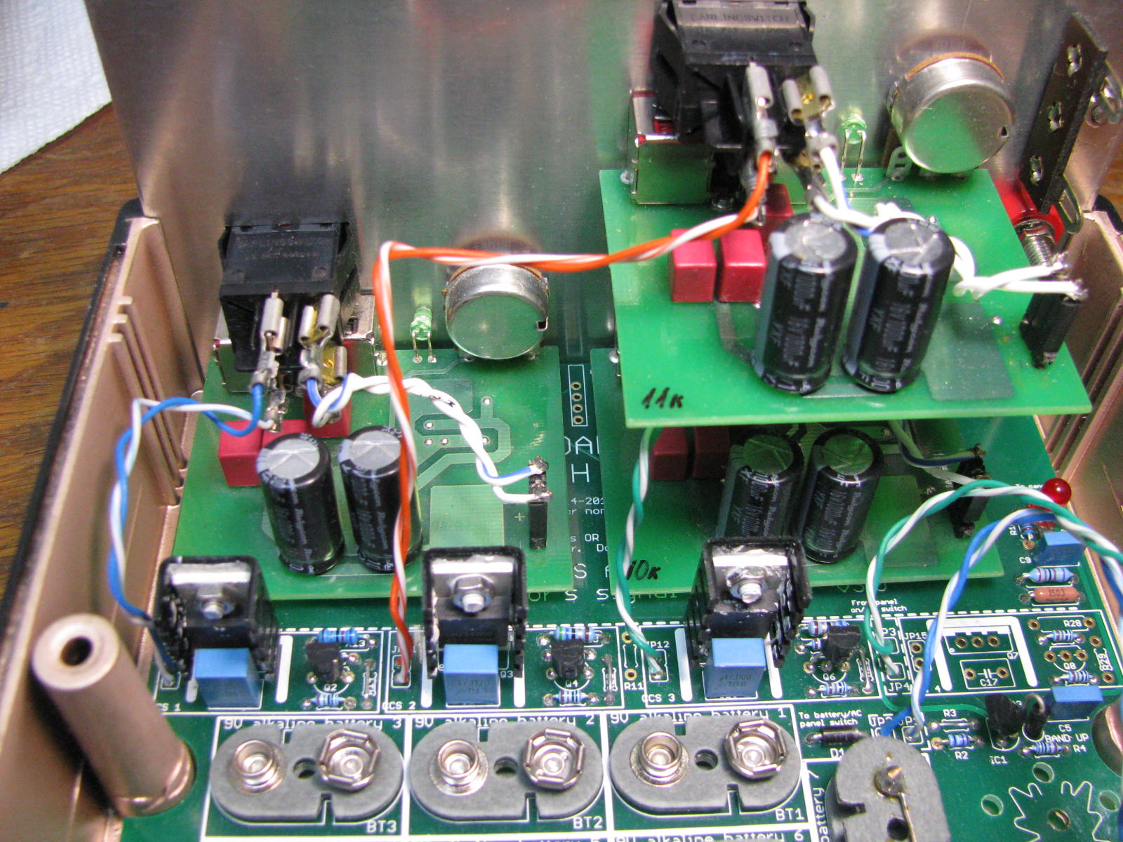

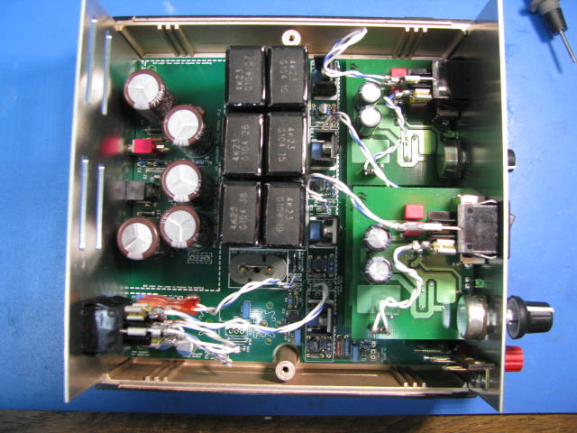

I am going to wait for the panels to wire things up, but here is the progress so far:
My (new) oscillators didn't come with panel nuts, so that might be another part to specify, assuming you used them.
I can find a screw for the regulator and then there is the terminal strip to mount. I guess I will have to order the four M3 screws to affix the board, as a regular machine screw probably won't "cut it"?Does that cover the hardware? Perhaps just add the hardware directly to the BOM as well?

Hey nice build job! I just realized that somehow I didn't have a subscription set up for this thread and missed your post above with the photos.
You even have that tiny IC2 low battery chip soldered in! I would say that one chip is the hardest thing in the entire project due to its size. I have another project going on in the headphone thread, an OPA1688 CMOY, that uses a different newly-released comparator that size, the TPS3701. I gave up an had some small DIP-6 adaptor boards machine assembled for that one. The rest of that project is through-hole, so the one chip would kind of mess up the DIY effort if not DIP. At least this comparator chip is 5 leads instead of 6 (the TPS3701 is 6) which makes that one side a littler harder to solder bridge. 🙂
I see you bought the shielded case too! That is the one I have. $30+ but well worth it.
So right off the bat, when you apply power to the AC voltage doubler section those two LEDs will let you know immediately if all is OK with the doubler. I added those on one of the later board runs. When I switch something on that is running at 68Vdc or so I want to know *immediately* if it is working properly! The energy for those LEDs essentially comes for "free" because that is also the power-off safety bleed resistor circuit on each half of the voltage doubler. Those resistors would have to be there anyway as bleeders.
On the panel nuts, is that the nut for the pot on the Victor board that is missing? I have a boatload of 6mm and 7mm nuts and washers, if that is the size he used. I'm on the road right now but when I get back in tonight I'll check the size vs. the Victor board. If they are are right size I'll just pop a few in an envelope. 🙂 How many do you need?
That is interesting, Victor had nuts and washers on the pots on all 3 boards I bought. He must have stopped including them at some point. I agree, I should put those on the front panel BOM.
On that voltage regulator, you need to use a full TO-220 insulator kit (mica washer w/ heat sink grease and the nylon bolt insulator) for mounting that one on the back panel. I have a bunch of those too, I'll put one of those kits in mail too. It has the bolt and nut.
On the M3 screws that mount the board to the bottom half of the case, those need to be special truss (very flat) head M3 screws that a I *should* have included with the board, but sounds like I forgot. Sorry about that! I have those and I'll include those too. In fact I kind of remember now after mailing the board thinking "Did I include the screws?". 🙂 Be sure to screw the board down before inserting your front panel with the Victor boards mounted on it, since the Victor boards sit right over two of the board mounting screws.

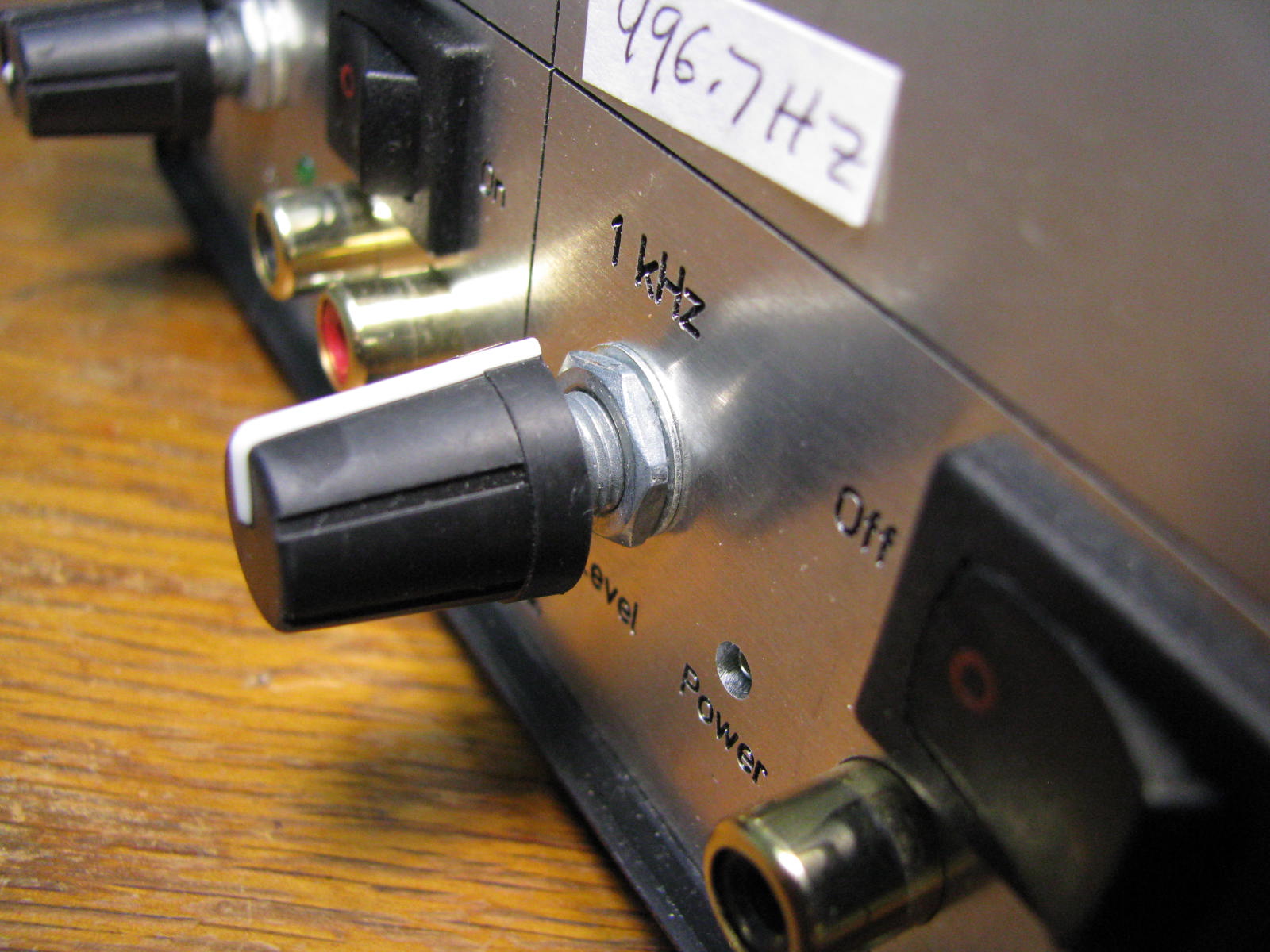

Victor board mounting on the front panel and wiring photos - part 1
Good deal, you have 3 Victor boards, same as mine!

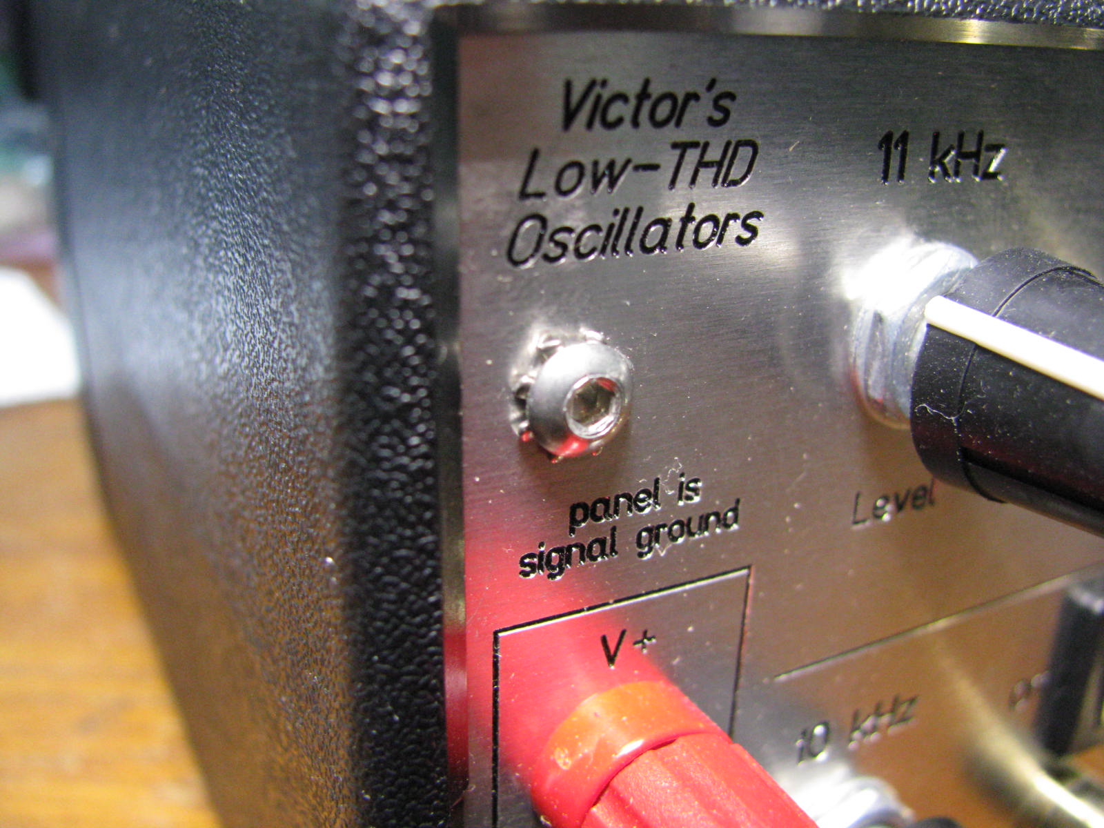

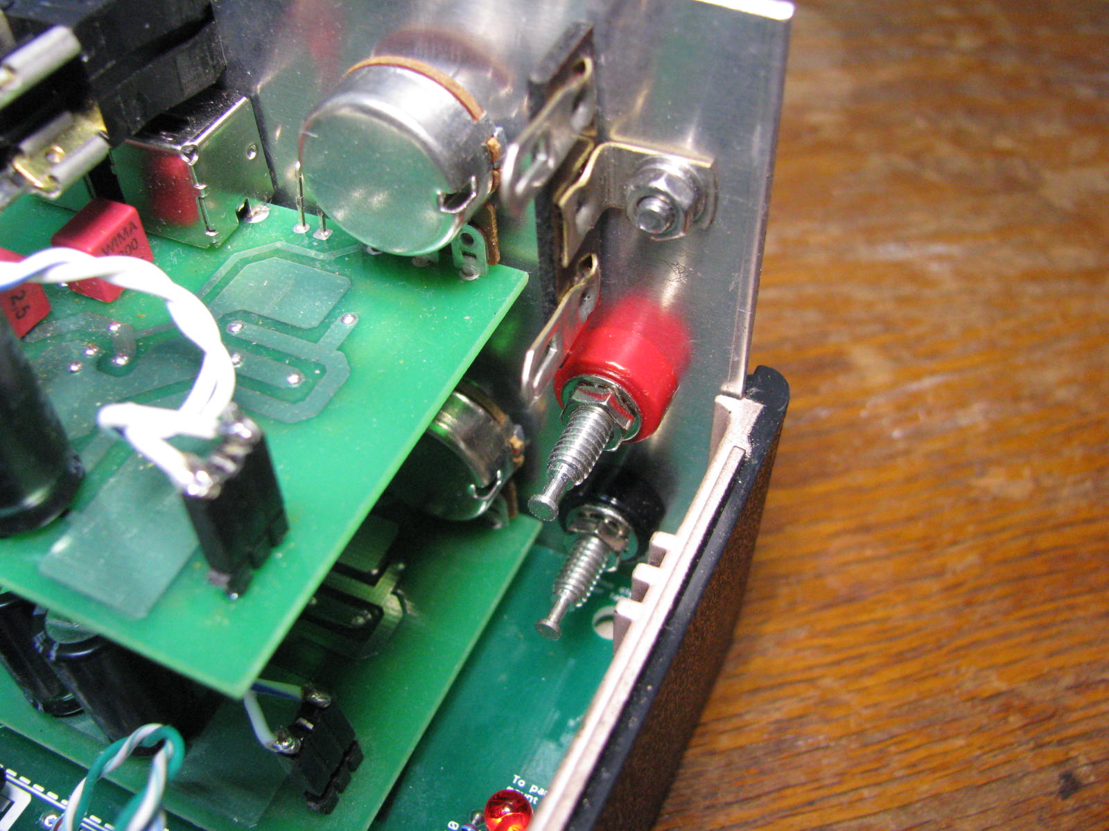

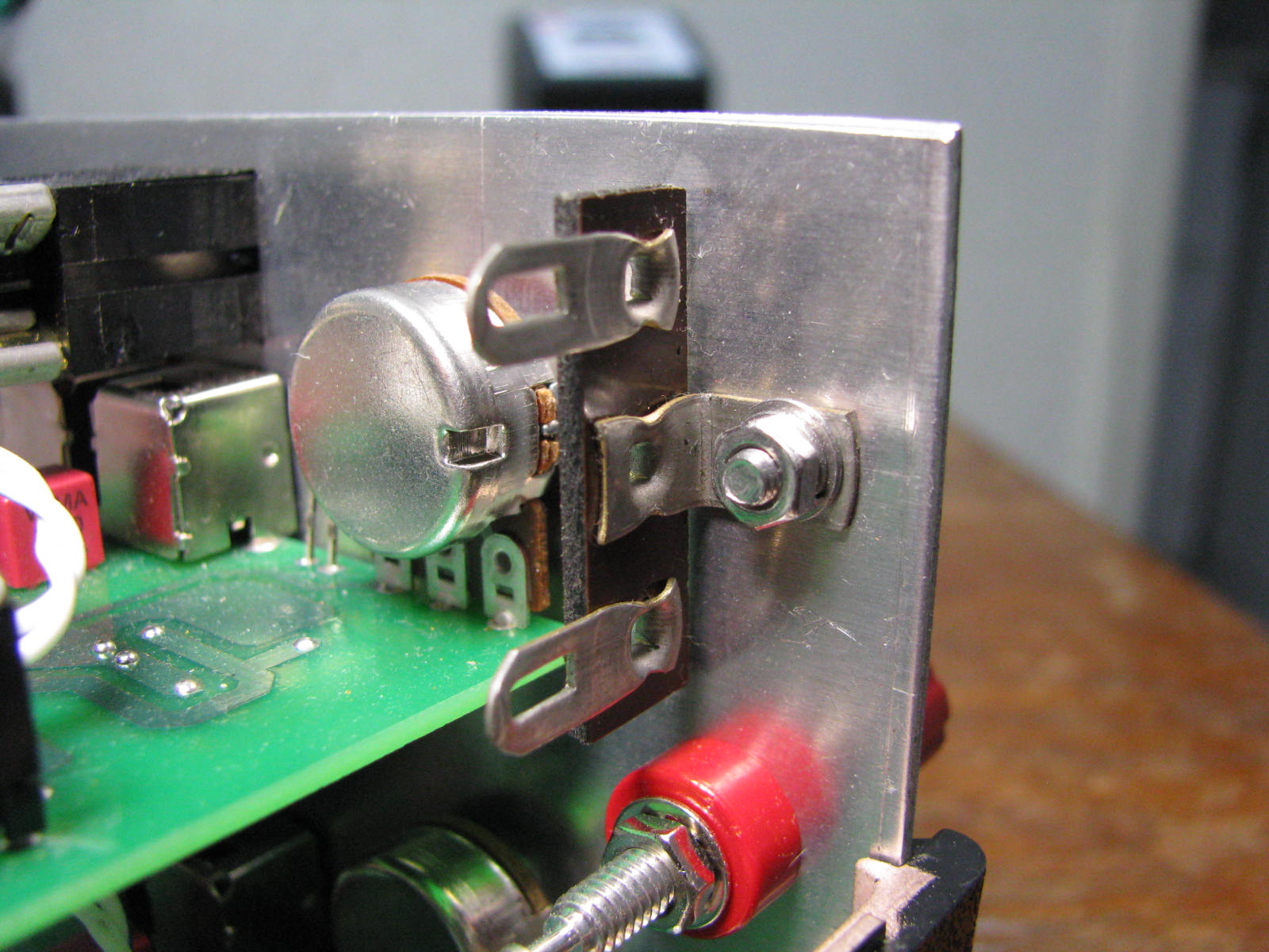

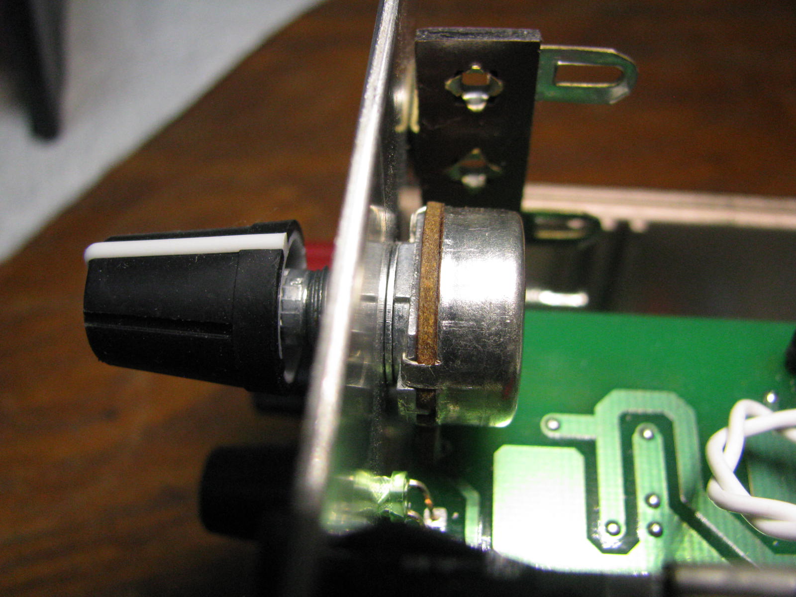

So here are some photos that should help. I checked the nuts and washers on my Victor boards. They are the same size as 9mm dual pots, M7 with a pitch of 0.75mm. I have a bunch of those. Hopefully Victor hasn't changed pots, on his new boards, or if he has hopefully they have the same threads.
For the pots on my Victor board I had to use one washer in-between the pot and panel in the back, then a washer and nut on the front. That washer in the rear was needed to get the pot to line up perfectly mechanically since Victor has it back just a bit from the board edge.
Then on the ground nuts - at least on his older boards here - It took 3 flat washers in back between the ground nut socket and the panel to close the gap, then on the front I used the screw and external tooth lockwasher. My Victor boards actually came with all that - 3 or 4 flat washers, the ground screw, and the external tooth lockwasher. Let me know if yours is short any of that, I probably have it here.
Also, if you have his new boards, the spacing between that ground screw socket and panel may be different. You may have to mess with adding and removing washers a bit to his board to get it perfectly parallel to the mounting panel. Victor's boards were consistent, though. Once I figured out the right number of spacer washers to get them to sit flat it worked on all 3 boards.
Photos:
* The first two show the flat washer and nut in front of the Victor pot and one washer in back between the pot and rear of the panel.
* The next 3 show mounting of that terminal strip. I don't have mine connected - or the binding posts - because all the power is internal, off the power supply board. I have the posts and terminals there so folks could run power in via the front. They could also be used to run the power supply voltage out the front. You could even do something like build up that 4th constant current sink position and feed the output to the binding posts. That would give you a lab current source at any value you set if you happened to need a CCS for something. 🙂
That looks like I used a M3 stainless button head bolt 6mm or 8mm long for the terminal strip. I'll figure out which and send it. 🙂 The socket on those is M2 (2mm metric). They have those at Harbor Freight tools, a set of 3 foldable metric allen wrenches, English allen wrenches, and torx wrenches for $6 or so.
* The next 4 show the wiring going from the constant current sinks to the rocker switches for each Victor board, then from there to the Victor board power pins. The last 3 are close-ups of one Victor board wiring.
So on all 3 boards the CCS twisted pair feeds the center contacts of the rocker, then the right hand contacts have a short twisted pair that goes to the victor board power pins. Be careful about polarity, of course! Notice on those close-ups the blue wire with white stripe is the positive. Teh Victor power terminal closest to the pot he has marked as the +.
* A photo of another Victor board, showing the power wiring, same sort of thing.
Photos:
