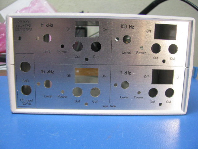

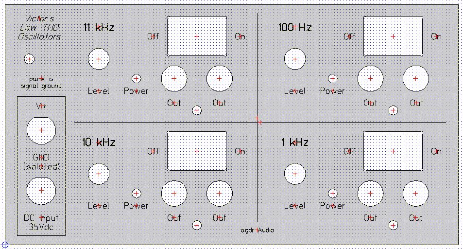

It fits!

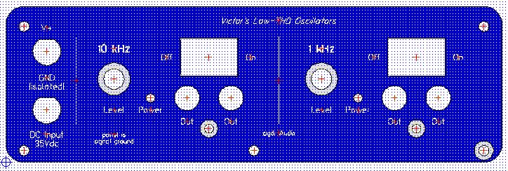

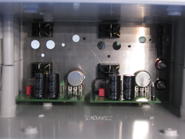

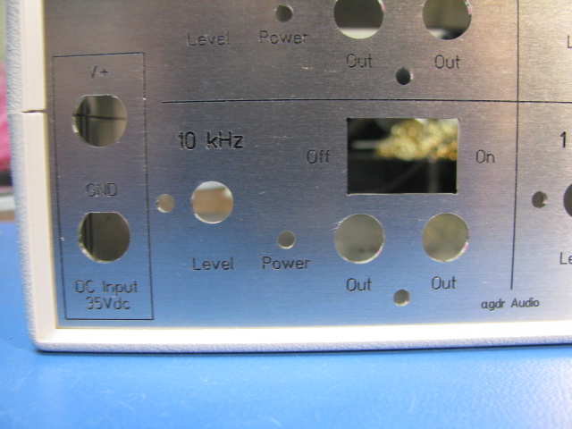

The 4 board front panel arrived from FPE today and it looks like I nailed it. 😀 The whole thing fits perfectly. The one thing I might do is add 1mm to the width of the four switch holes. I used the datasheet recommended width for panels 1.5mm to 2mm (the Hammond is 1.6mm). It does take some significant finger pressure to get them in, but nice and solid once in.
I'll go ahead and zip up a file with the FPE CAD files for the 4 hole and 2 hole and post here in a couple of days. I'm not going to do a test panel on the 2 hole since it is just the 4 hole that I deleted the top parts from the CAD file. Really nothing there that can get screwed up. I'll also post a file with instructions on exactly how to submit the CAD files to Front Panel Express (or Schaeffer in the EU) and instructions for mailing one of the blank panels from the box to them.
I'm not going to do any group buy with these panels since there is very little discount, 10% for 10 boards, which would then get eaten up with their shipping cost to me and the shipping costs to get the blank panels to them. Plus anyone interested in this panel may want to modify the text to their liking, which is easily done in that free Front Panel Designer Program.

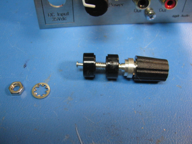

I discovered why Victor includes those four washers on the ground bolt. They are needed to properly space the board to the panel. So the correct sequence is ground bolt - external tooth lockwasher (Victor includes) - the panel - the four washers - and then Victor's board.
Then on the pot where Victor includes a nut and washer I discovered the washer needs to be left off, but the nut should be left on for proper spacing. That means you need to get another nut if you want to secure the panel to pot (recommended to ground the pot shaft and keep hand capacitive coupling from effecting things). Its the same nut as on a 9mm pot, so just buy a Mouser #652-PTD902-2020KA103 pot for $1.81, throw away the pot and keep the nut. 🙂 So the correct sequence here for the pot is: external nut on the panel face - washer that Victor included - the panel - the nut that victor included - the pot.

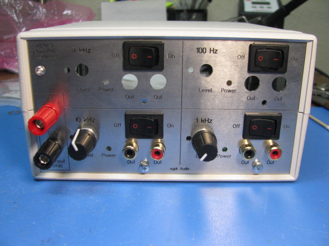

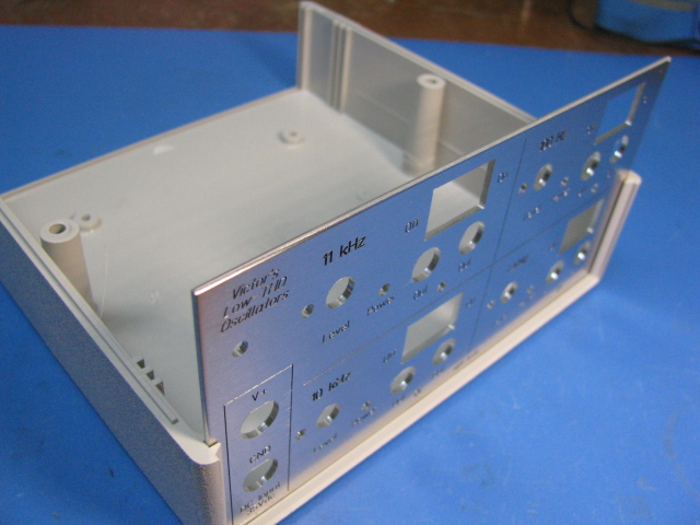

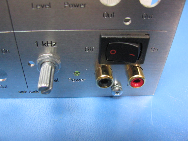

The photos below...
* The blank panel from FPE and parts from Mouser. Those are the DPST versions of the switches now. The Hammond panels have protective film on one side which I left in place when I mailed the panel to FPE, then gave them instructions to use that side. Arrived like this in just perfect condition. No scratches or any other evidence of the milling and engraving process.
* The next three show the panel with the two clam shell halves in place. Looks like I did leave enough room at the edges between the case and the text. In the middle photo it looks like the text engraving is skipping in places and not solid black. That isn't the case at all, just a lighting effect on the photo and due to the engraving having some depth, which also messes with the photo. The text engraving and straight black lines all came out solid black and look just terrific.

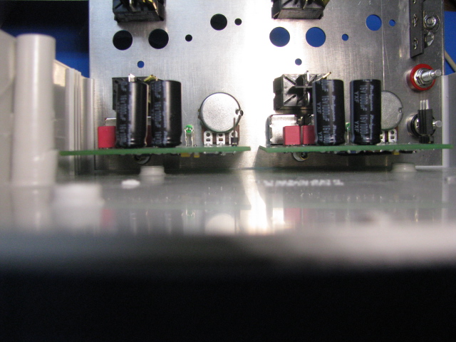

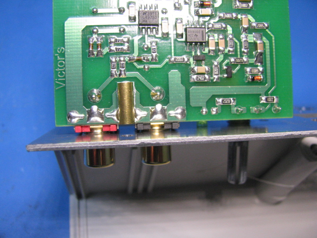

* The next two shows the fitment of Victor's boards on the panel. You can see the gap between the ground nut on Victors board and the case, that requires those four spacing washers that Victor includes. The washer Victor includes with the pot should be left off, but the pot nut should be left on to properly space the pot to the panel.
* The next shows the order the binding posts parts assemble. Note that the binding post itself has a metal D at the base that would fit in the panel D hole. The two insulators for the post have a "socket" for the metal D and reproduce that as a plastic D. You must use the insulators, even on the ground post, since the post ground is not the same as the ground screw ground which is the panel ground, as per postings above.
* The next two show the final product mounted in the case - without the 11kHz and 100Hz of course. On the rear shot you can see the two terminal solder lug strip mounted.
* The final one shows the clearance between the case-bottom screw bosses and the boards. Should be enough room for the power board and the mounting screws.

The photos below...

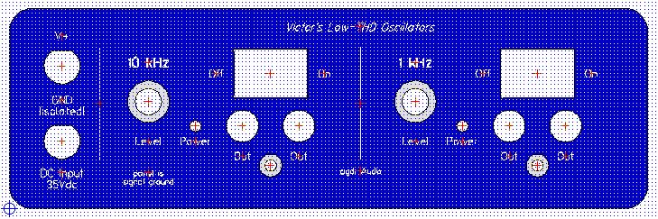

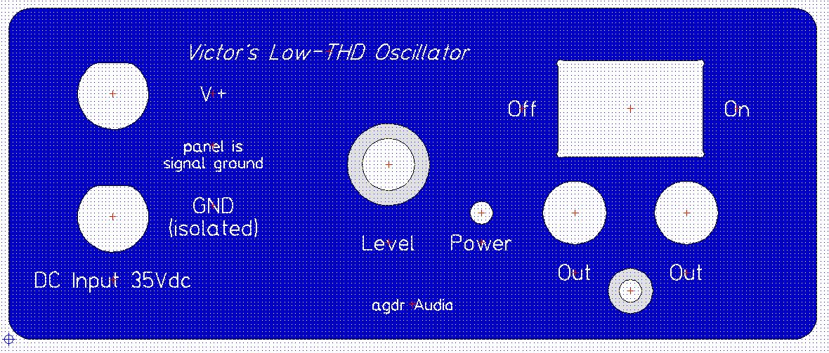

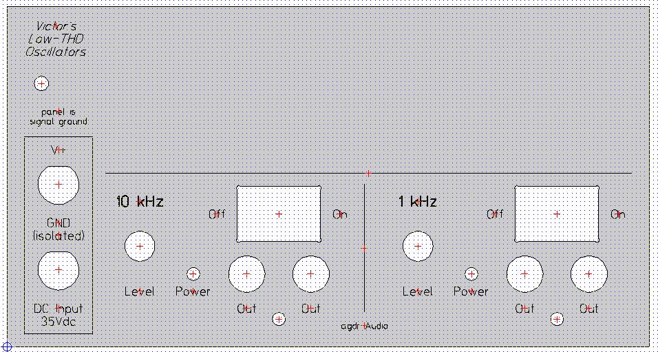

Panel CAD files for 1, 2 or 4 Victor boards and submission instructions
Below in the zip file are the CAD files for the panels and instructions on how to submit them to Front Panel Express here in the US or Schaeffer AG in Germany for drilling and engraving. The zip also includes the JPG screen captures below of the panels.
The zip file contains the CAD files for a 1, 2, or 4 Victor oscillator board panel. The 2 and 4 board panels are for the Hammond 1598 series of cases, as per the posts above, while the single board panel is for a Box Enclosures B3-080 case. The submission instructions in the zip file has all the details. The instructions are assuming that a blank panel from the case will be mailed to FPE or Schaeffer rather than using their own stock. I've done a few of these now for various projects and sending in the blank gives the best result.
I've made a few minor changes from the test panel I had fabricated in the post #45 above:
* Victor has let me know via PM that the hole to the left of the pot for a pot locator tab in his mechanical diagram is no longer needed. He has switched pot manufacturers and says he will revise his mechanical diagram. I was wondering about that since neither one of my boards had that tab on the pot! Those holes have been removed in all these CAD files. So one less hole that needs to be drilled for each one of Victor's boards.
* I have added some words to make it more obvious that the DC power input ground is not connected to the panel, and that the panel is in fact signal ground. I've added "isolated" to the DC input ground text and added text that says "panel is signal ground". I'm just concerned that someone will use a lab supply that is also powering the device under test, or have its ground common with whatever is power the DUT. Whatever supply is used to power the Victor boards must be isolated and dedicated (or use batteries!).
* I noted in post #45 that the four switches take quite a bit of finger pressure to snap in using the datasheet hole dimensions. I've spoken with the manufacturer and that is apparently by design. The resulting clearances between switch body and panel are correct. Regardless I've increased the hole with by 0.1mm to 19.5mm from the previous datahseet 19.4mm number for a 1.6mm thick panel. I've found the best way to snap them in is do one side first, down flush with the panel, which leaves the switch wedged in the hole at a 30 degree or so angle. THEN snap in the other side. Don't try to snap in both sides at once. The plastic "springs" on the ends of the switch are too stiff for that. Be sure to support the panel from behind with a finger to prevent any bending.
If anyone else builds up one of these panels/cases please post photos! 🙂

Here you go - CAD files below. 🙂 I'm glad you brought up the (Box Enclosures) B4-080 case. It really is a good solution for just 2 of Victor's boards.
One CAD file is with the 5 mounting screw holes (from the panel to the case) if a person is having FPE use their own 2mm material. The other is without the mounting holes if you are sending the blank panel from the B4 case into FPE, or drilling it yourself.
You can pull all the hole locations and sizes off these CAD files for home drilling with that free FPD program of theirs, from here:
