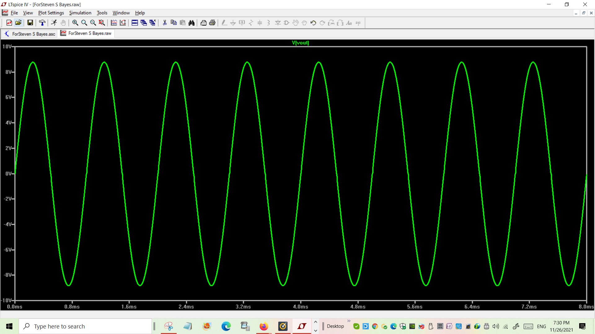

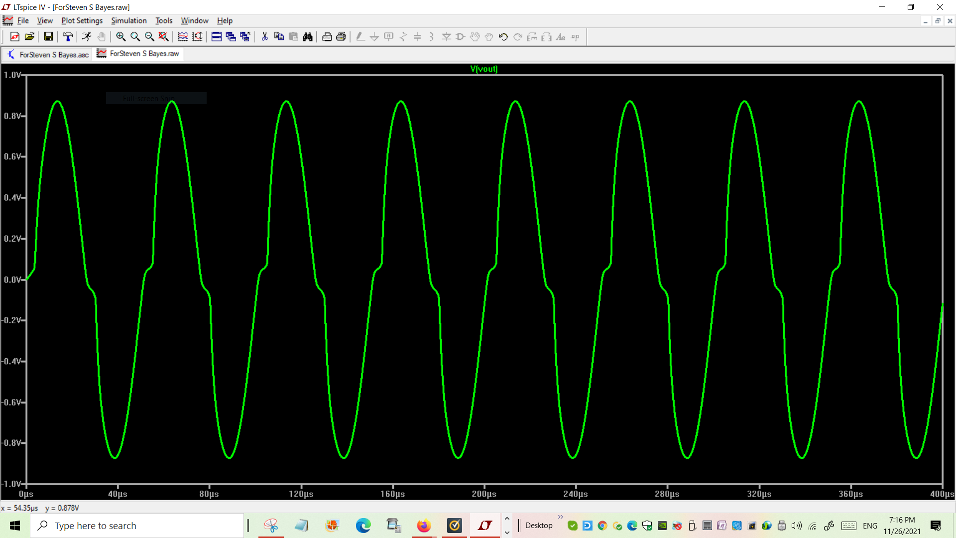

Example of 20kHz crossover distortion.
I do not know. The only thing I know is 20KHz is a very low frequency for almost anything not mechanical. I say this, not because of your post ( as I said : I don't know ), but, because, there are some people in this forum who really think 20KHz is a high frequency. Strange. 20KHz is nothing even for modern tubes.
See attached image.
Yep
That is the only problem, crossover distortion at high frequency.

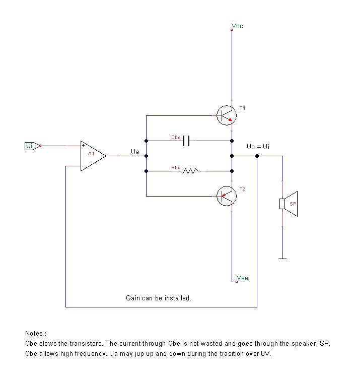

In this sense, a way to slow down the transistors in the direct schematics in order to avoid the machine gun noise ( banging a few bangs a second, the higher the current, the higher the frequency of bangs ) may be to introduce Cbe. Cbe puts high impedance at low frequencies and low impedance at high frequencies. There may be some jumps up and down of Ua, when around 0V, but, the current is not wasted and goes through the load.
Please, see the attached.
Another point is I have not used emitter resistors. Thus, while one of the transistors open and the other one closes, because they are slow, there may be a point where the two transistors are, to an extent, open and, thus, switching current would flow from Vcc to Vee.
Therefore, a good way would be to investigate whether emitter resistors would eliminate the machine gun noise.
Although, I do not have an oscilloscope, I intend to make a test circuit and test the ideas to see what helps and what not.
A good idea may be to install only one of the transistors and see whether I still get the machine gun noise. The other transistor can be replaced with a resistor or not installed at all. Not a good test, but, may reveal something.

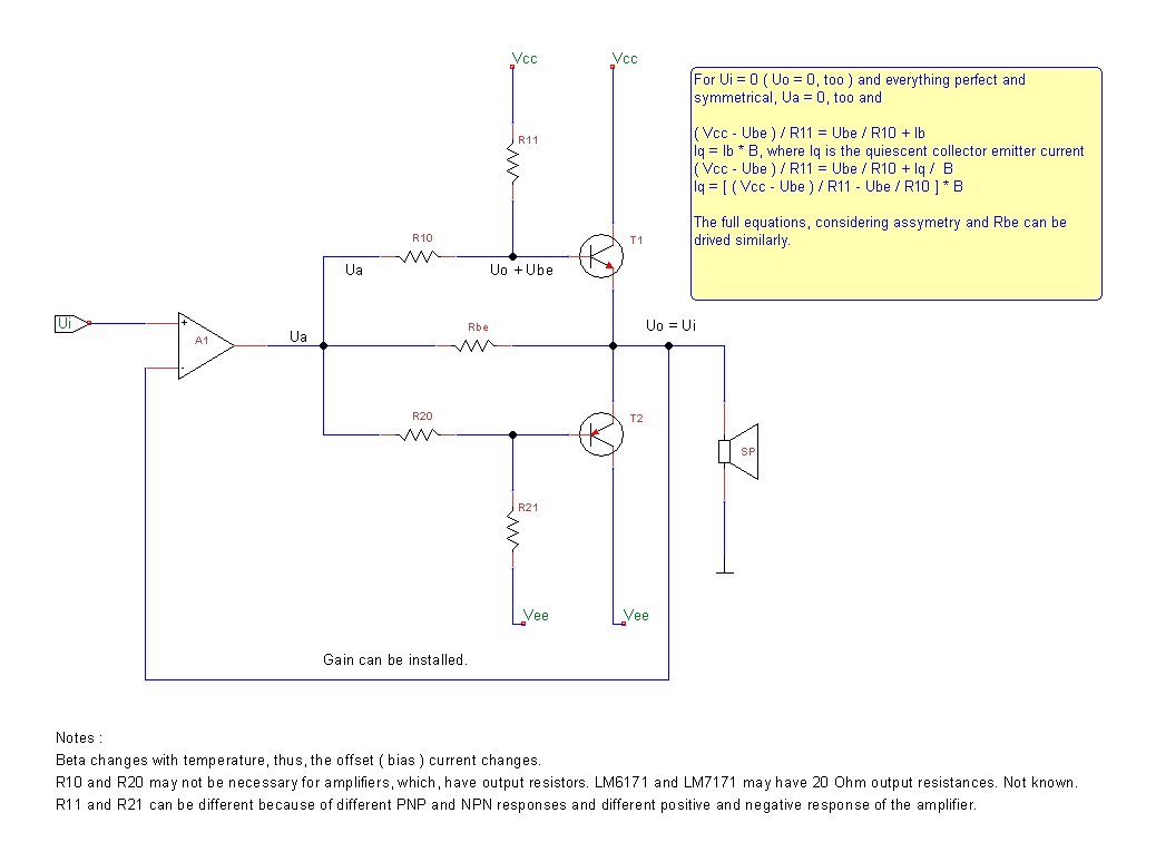

The direct circuit works OK in mono! No machine gun noise. Rbe improves the sound. The machine gun noise is present in stereo. Most likely, the reason is fast switching with high current, which, loads the power supply and capacitors and, occasionally, proliferates from one channel to the other.
The direct push pull circuit and the machine gun noise have been investigated. The circuit has been made to work. A document, called " Machine Gun.doc ", has been published. Please, scroll down to the " Addendum " and read a page and a half only, except when interested in more information : https://drive.google.com/drive/folders/19EGkuJHapxfTlS9T0iIIMLXz-E-U9-1r
More test revealed the great importance of all resistors, Rbe, Rce and Rcb around the secondary transistors. The lower the values the better. Another desired schematics, showing this approach has been added as Figure 23. towards the end of the document.
I have been through hell and back, fighting with Sziklais, with or without offset.
I have tested the idea of providing offset with resistors. The simple, direct circuit has been tested as well as a circuit with Sziklais. A Darlington is to be tested and the document updated. The Darlington will be tested when only the primary transistor is open at 0V and when the two transistors are open.
The document is called " Offset with Resistors.doc ", which, is here : https://drive.google.com/drive/folders/1I-gJFsjT1I2w7QNfagujAo1DXqRQrGxG
Scroll towards the bottom for schematics and conclusions.

I have updated the document. A Zobel network did help and was found to be sufficient, yet, the other resistors can still be used with high values. The document was updated with the Zobel network and some mistakes on one of the last schematics have been corrected.
The Zobel network was used with Sziklais only. No need to use such without, but, whoever wants can.
I use the Zobel network to, even more surely, prevent Sziklai oscillations. Other uses are to cancel the parasitic inductance of the speaker.
