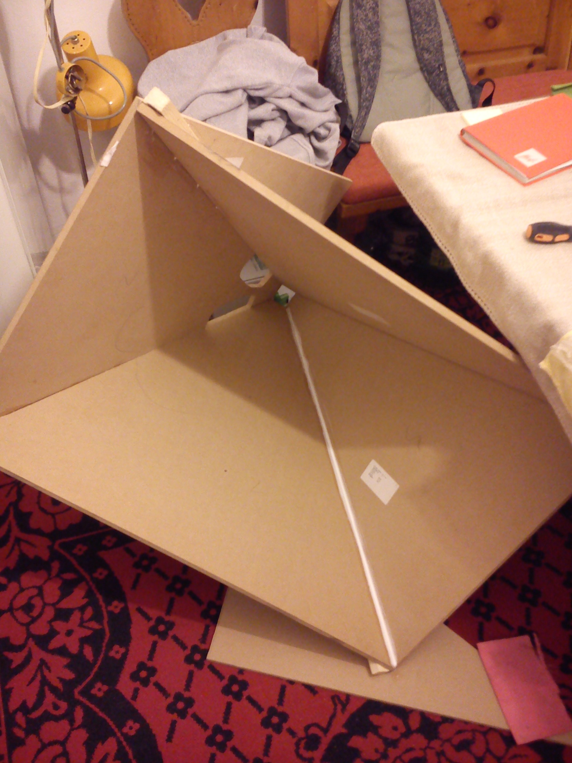

Horns are screwed and glued, now curing. A lot of glue was used... no special tools were available. Errors on sides were pretty big at some point (2-3mm)..
The horns are made of 12mm MDF.
Octagonal back chamber for the 12PE32 to be built next.
For errors in the wood, this glue do fit well, it swells when curing filling the gaps, it is THE glue for speaker houses.

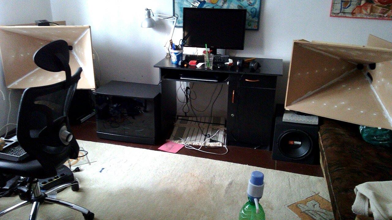

Yesterday I placed the sealed subs in the room. I was thinking of either doing a stander to place the horns at middle distance between ceiling and ground and then tilt them to beam directly to ear height, or just place them over the sealed subs and point them up to meet the ear level at listening position.

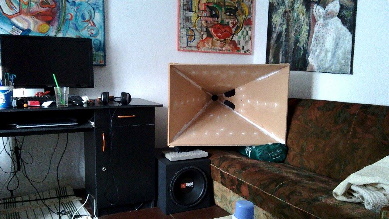

I have the 12pe32-3fe25 synergys working. The mouth is 90/60cm, 70cm deep.
I hope it is ok to post here some questions, if not i will create a separate thread.
I like them very much, the soundstage they produce is very good, good dynamics. Only thing to complain is that the highs of 3fe25 are not as natural as a dome tweeter. At the moment i will let them like this. No supertweeter soon.
Last evening i did some measurements but, as the speakers are heavy and could not move them alone, i placed the mic exactly in mouth center. I have doubts that this is the best way to measure them, in order to apply some EQ then.
So, for those who measured before big horns in room, I wonder:
-is it better to measure nearfield (say 50cm from horn mouth) or is better to measure at listening position?

Great work there Arcgotic! I would measure at 0.5m from mouth to allow sound to integrate and reduce room bounce effects if you don't have big room. Use frequency dependent window (FDW) in REW set to about 6 cycles. This will limit what you see to stiff actually coming from horn itself.

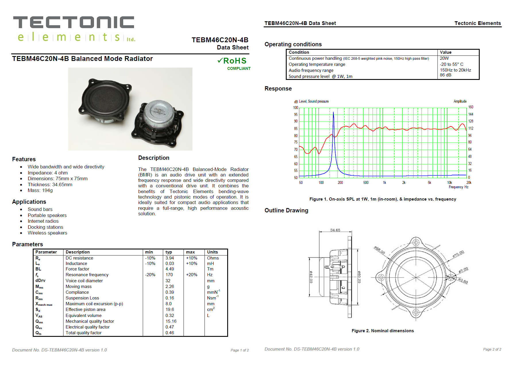

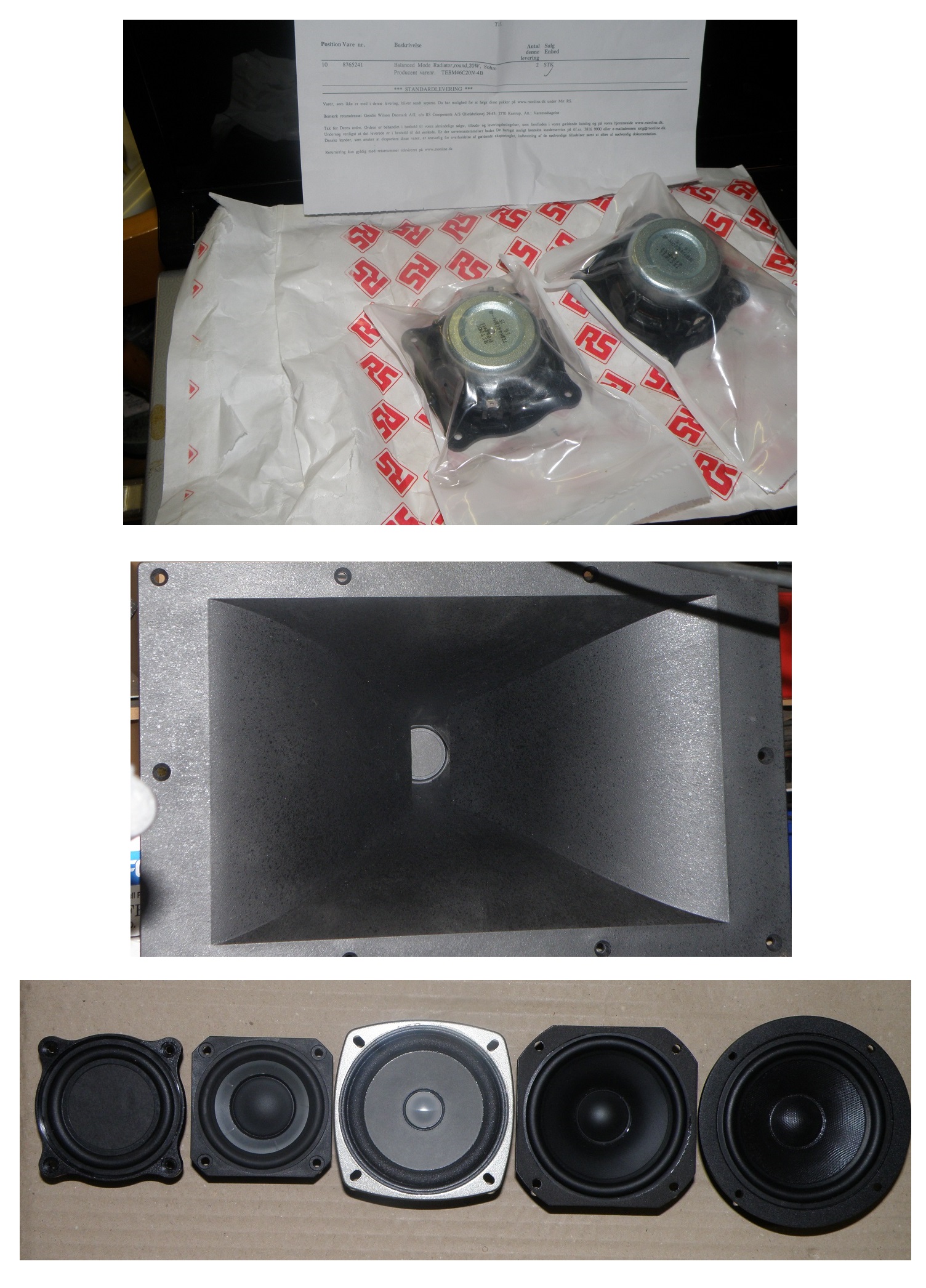

Yesterday did a subjective listening test half an hour for each TEBM46C20N-4B/SB65WBAC25-4/FF85WK/TC9FD18-08/10F8424G00 when they lay on a table listening for smoothness and off axis coverage, which for me leads to best but still different is TEBM46/TC9/10F, but bear in mind the personal undocumented procedure in this step.
For future test paring full ranger to a cheap 2 inch PH-4528 horn makes me think to have best HF integration size of TEBM46C20N-4B/SB65WBAC25 is the better ones to get some success. Will in a week or two share real data how these two compete each other, preliminary i tip to TEBM46 side because BMR is supposed to have better power response the higher the frequency meaning less EQ boost in HF where some amplifiers and DAC begin show there HD, and also because in all links below for SB65 it seems clear to have a third harmonics distortion profile, but lets see later how TEBM46 perform. TEBM46 rubber surround diameter is same as SB65 so they may very well be used to replace each other.
As seen in picture yesterday evening did hang TEBM onto horn with gaffa tape and foam sealing and listening to it actual made me stay up til next morning, it was new and positive subjective experience.
