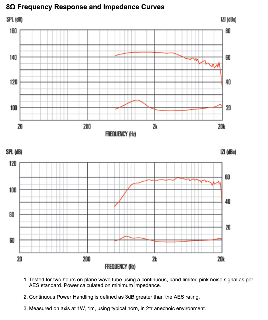

Any driver in a waveguide will respond directly than on a flat baffle. A compression driver has a completely different response when on a plane wave tube to a waveguide. This is why the combination of driver and waveguide is important some work well together some do not. I don't understand why you would think it should look the same.
Both designs in this thread have quite a lot of DSP EQ applied in the later graphs so some of the faults may have been smoothed over.
A compression driver on a plane wave tube is near enough the same response on a large constant directivity waveguide example jbl 2360a
Every wave guide will differ to a plane wave tube response size and shape changes everything
It's just exploiting the wave guide for your own use and matching of a particular drivers response

I was trying to use the example to show that that the response of any driver will be different when in a waveguide or horn.
This graph might show it better the bottom trace shows that the driver and waveguide work well together. The frequency and impedance plots are quite different between the horn and tube.
