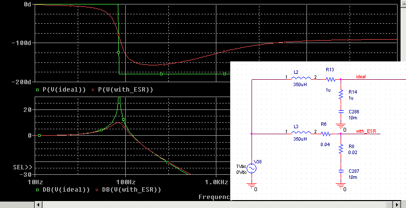

sovadk said:A LC filter will always have a phase shift of -180 degrees and will cause instalillity of osccilation if the gain in a closed loop is close to unity at this -180 degree freqyency. If the Q factor is large, then the -180 degree frequency will be the same as the roll off frequency of the filter. If the Q value is smaller then the phase shift will reach -180 degrees at a higher frequency. The point is that It'll will always reach -180 degrees.
A differential network will give you +90 degrees of phase shift and give you a 1order rising amplitude slope. Adding such a network after the LC filter, will reduce it to a first order (-180+90 degrees=-90), which will always be stable in a closed loop.
The SMPS here is not a special case. PID control is possible and will work much better than a PI controller. A PI controller removes steady state errors but increese instability.
I've attached a schematic of the PID controller I'm using in my Class D design. I've got the abillity to add 20dB more feedback at 10kHz and increese stability by adding R53 and C24 to the feedback network. I've found the values by trail and error in pspice.

I couldn't help it, so I designed the PID controller. Output filter is 350uH and 10mF. I persume that the SMPS controller has a gain of 130 (42dB).
As you can see the resonance peak of the output filter is removed and the whole thing is very stable even with no load.

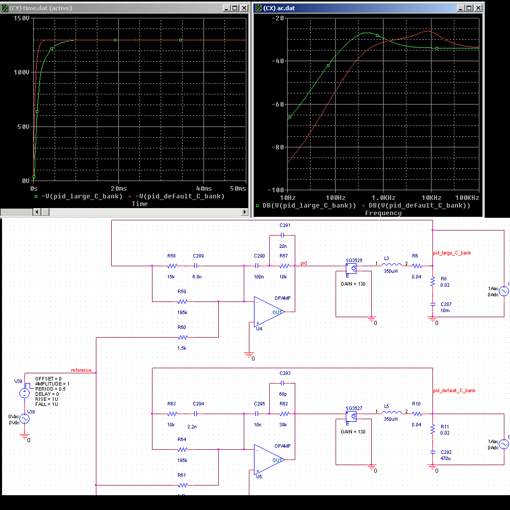

I've made a PID controller for a system with 10mF and 470uF output capasitor (see the attacthed picture).
The graph to the left shows the output behavior to a step reference voltage af 1V. The graph to the left is the output voltage ripple when the system is loaded with 1A sinus at different frequencys.
The small capasitor bank gives more than 20dB low frequency load rejection. The reason is that you can actually add more feedback when the roll of frequency of the LC filter is larger.
The only drawback is that the ripple from the switchin stage will be larger. Still 350uH with 470uF gives you -53dB (factor 450) of supression of the 75kHz carrier.

I've haven't tryed it on a SMPS but I'm using it on my self osscilating Class D designs to improve THD specs and it works very well.
I've just designed two PID controls for you, one with the big caps and one with the small. I can se on the schematic that they attenuate the output signal with IC3. You just have to take this into account when using the design I've showed you.
Anyway. I don't think you did you PID control right, when you tryed to make it work the last time. The one's I posted here are very tollerent to changes. A 5mF cap insted of a 10mF dosn't make much difference. Also changed Q factor of the output filter dons't change anything either. The P term ensures that the phase never goes below -90 degrees. The total system phase might become +90 for some frequencys if the LC Q factor is very low, but that's stable too. It can't go wrong.
Now you're affraid that the PID controller might pick up HF noise. I understand why. I've attached at graph showing how much gain the two PID controllers have (I've changed to small C bank PID controller a bit). One have unity gain at 6.3kHz and the other at 24kHz. This is well below the carrier frequency. And have in mind that the LC filter also attenuates everything a lot.

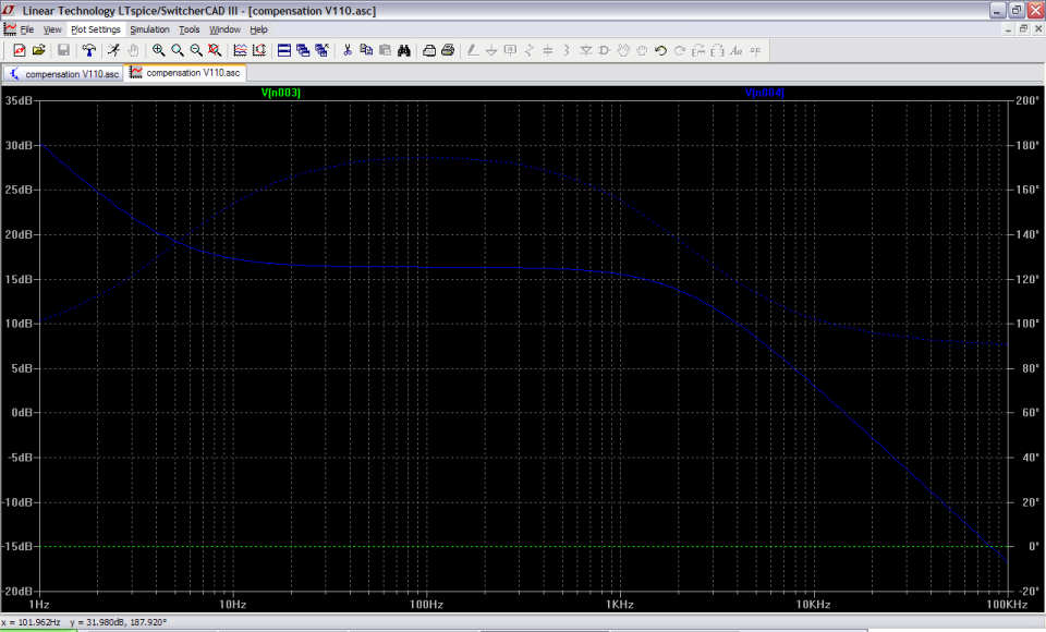

And here is the frequency and phase response taken after the output filter at the 470uF caps (blue lines) and after the compensation network (opamp output) (green lines).
You can see that with this compensation I get a perfectly 6dB/Oct roll of and 0dB gain at 100Hz and a very comfortable phase margin. The roll-of of the LC filter itself is also 6dB/Oct in the region of interest.
And the last picture is the response of the PI compensation network only.
This network has the maximum phase shift at about 100Hz so that I get the optimum phase margin at 100Hz where I have my 0dB loop gain.
I think the way I made this compensation is not too bad and done according to the textbooks I would say.
I don't think it can be done much better but I'm open for suggestions of course.
