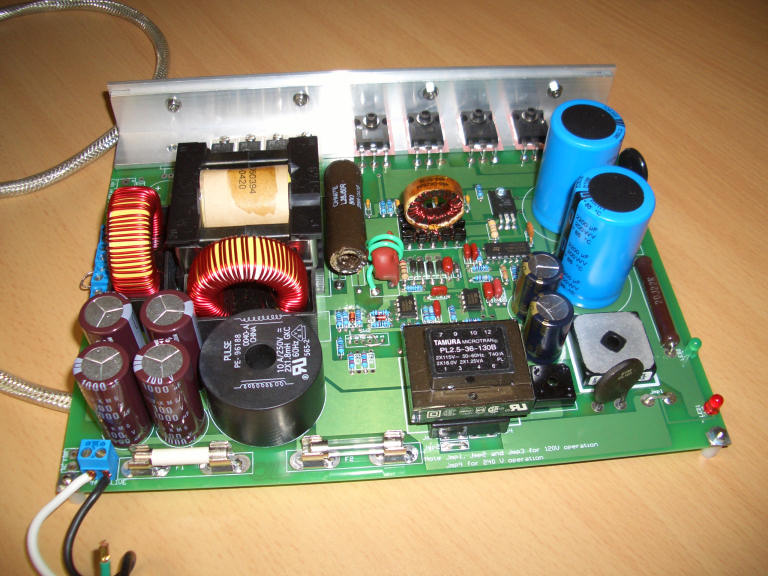

I have done some more experiments/mods.
As mentioned in an earlier mail, I changed R40 from 316Ohm to 1k to make the shutdown circuit work correctly. I removed Q5 to disable the recovery after a shutdown. The supply needs tobe recovered after a shutdown by powering down and up again. This is the safest approach.
I added an RC delay to the Vref that is going to pin 5 of IC2 using a 100k resistor and a 10uF cap, actually you can R24 and C9 for that since these are not needed when one disables the recovery. This results in a nice clean startup of the supply without any overshoots.
I went to Akihabara yesterday and found some 100V 1000uF caps that can be used to replace the standard 470uF 100V caps at the output. This would increase the onboard filter capacity to 2000uF per rail (from 940uF). This gives slightly less mains related harmonics and also slightly less HF rests.
I also found out that a large part of the HF noise that I measured before was due to the scope probes picking up switching noise. I remeasured the noise by using a shielded speaker cable with the + and - of the cable directly connected to the output caps and the shield directly to GND of the output caps. I guess this is the cleanest way. Then this cable went to the dummy load and the scope prbes were connected at the dumy load. This gave a much cleaner signal as you will see later.
Attached is a picture of the supply, it is quite big about 19x24cm and about 6.5cm high.
More pictures in following posts
Gertjan

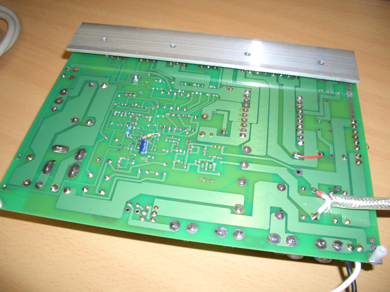

Bottom of PCB

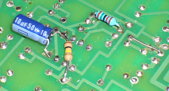

Shielded speaker wire connected at output caps
And the Vref RC filter with the cap between pin 4 and 5 of IC2, the copper trace under the resistor has been cut (not visible).
The other resistor is R25 of the feedback network, I increased it from 7k to 15k for the version with the 2x1000uF per rail, it is still mounted at the back of the PCB for easier access.
At the right, you can also see a blank wire. That wire is used to close the feedback loop. I had openend the feedback loop (by cutting a PCB trace) at that point to measure the open loop behavior in the past.

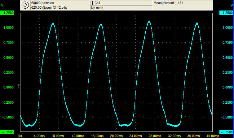

ghemink said:
This is the AC residue with a 23.4 Ohm load, almost 5.5A current. with the 2x470uF per rail and the 7k feedback resistor (original)
Much cleaner than in the past, HF components are very small and 100Hz peak to peak about 1.8V or so
This is for the version with 2x1000uF per rail and feedback resistor increased from 7k to 15k, this gives about a factor 2 reduction in 100Hz mains related ripply to about 1V peak/peak

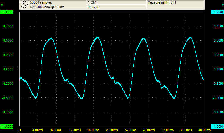

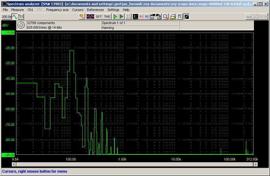

This is the spectrum of the previous figure
HF components at 75kHz and 150kHz are below -50dBV, this is about 3mV peak/peak for the 75kHz component, remember, this is at 5.5A load with the supply delivering about 700W power.
So very good HF behavior.

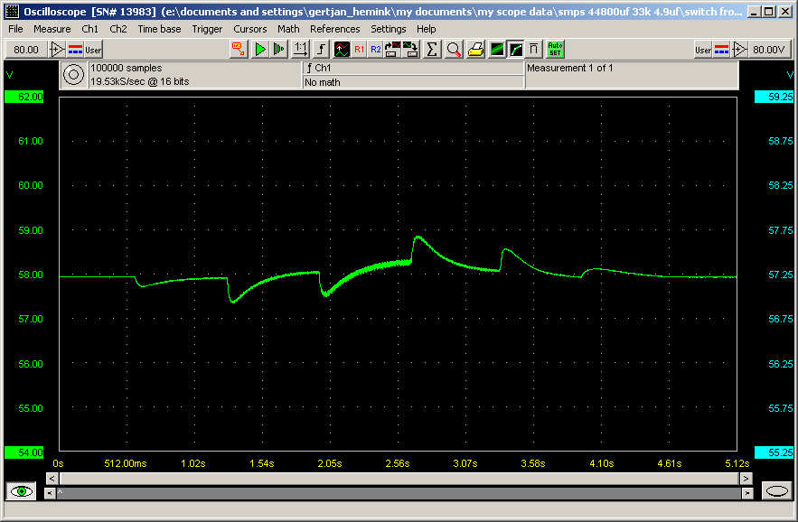

I decided to make this supply high-end. I had a whole bunch if 63V 8200uF caps at home that I originally intended to use for a conventional supply. I used 8 of them, 4 for each rail and I connected them via a R-C-R like setup in parallel. For the R, I used a value of 0.1 Ohm. I topped it off at the end with anothe C per rail. Those were Elna Cerafines 10000uF 63V. These caps I also had, so I'd better use them since they were pretty expensive.
So together with the 2000uF per rail on the SMPS board, this brought the total capacitance at the output to 44800uF. This brings the resonace frequency of the out put LC filter to 40Hz and with a very low Q.
I changed the R and C in the feedback network to 33k and 4.9uF (the original 0.22uF and a 0.47uF non-polar BG in parallel). (R=R25 and C=C25 in the schematics). This results in the integrator pole to have a corner frequency at 1Hz. This means that I have a lot of phase margin and slow regulation as you can see in the attached figure.
The attached figure shows the output voltage during switching of the loads. Initial current is about 0.35A, then switched to about 0.7A, then to about 2.9A and then to about 5.1A, and then back again in the same order. You can see that the integrator in the feedback loop tries to bring back the DC output level after each switching event, it does that very slow due to the low corner frequency. Current flows between both rails, so supplying about 600W max. Voltage drops during switching about 200-250mV per ampere load. Not bad I would say, can be reduced if you make the integrator faster, and drop will be less at audio frequencies anyway.

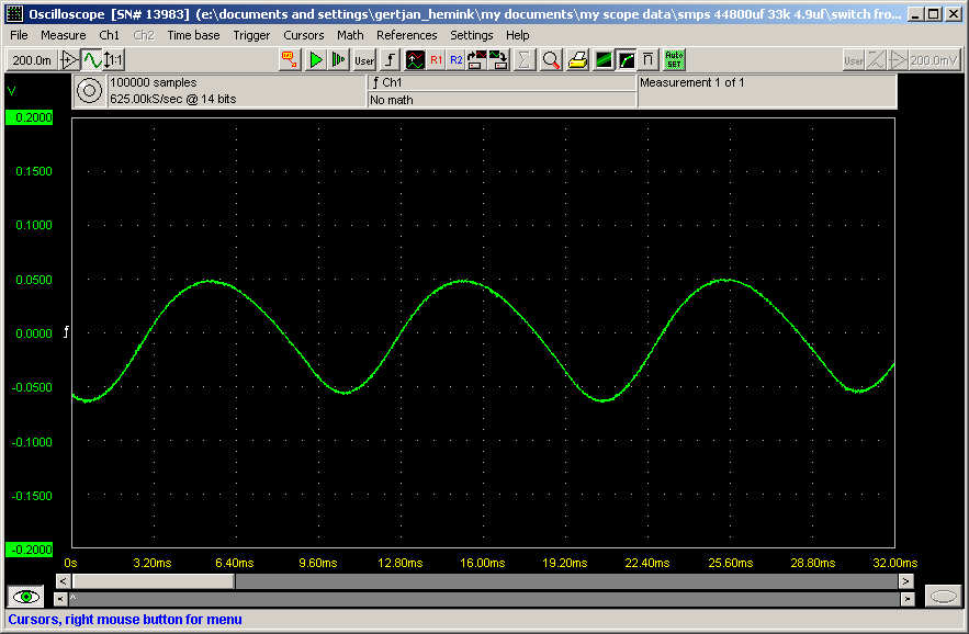

The AC ripple at 5.1A load is now much smaller than before, what do you expect with all those caps. It is about 100mV peak/peak and only has low frequency content. HF rests are very low.

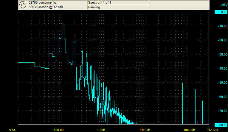

The spectrum analyzer view shows the 100Hz, 200Hz and a few higher harmonics. The HF components are below -85dBV, that is less than 50uV peak/peak for each HF component (75kHz and 225kHz). I used 14 bit resolution on the scope and 200mV range with AC coupling to measure this.

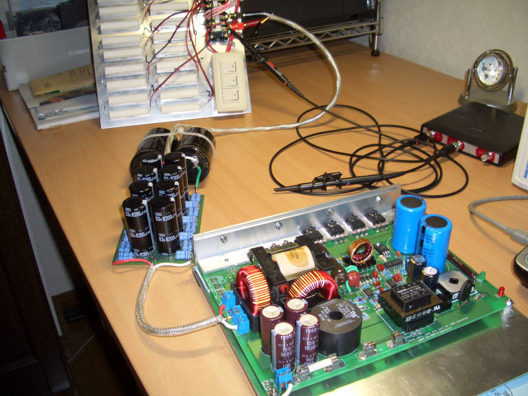

This was my test setup. In front the SMPS mounted on an aluminum plate of 25x25cm, behind that the output caps and in the background the dummy load. With the switches I can change the load resistance.
